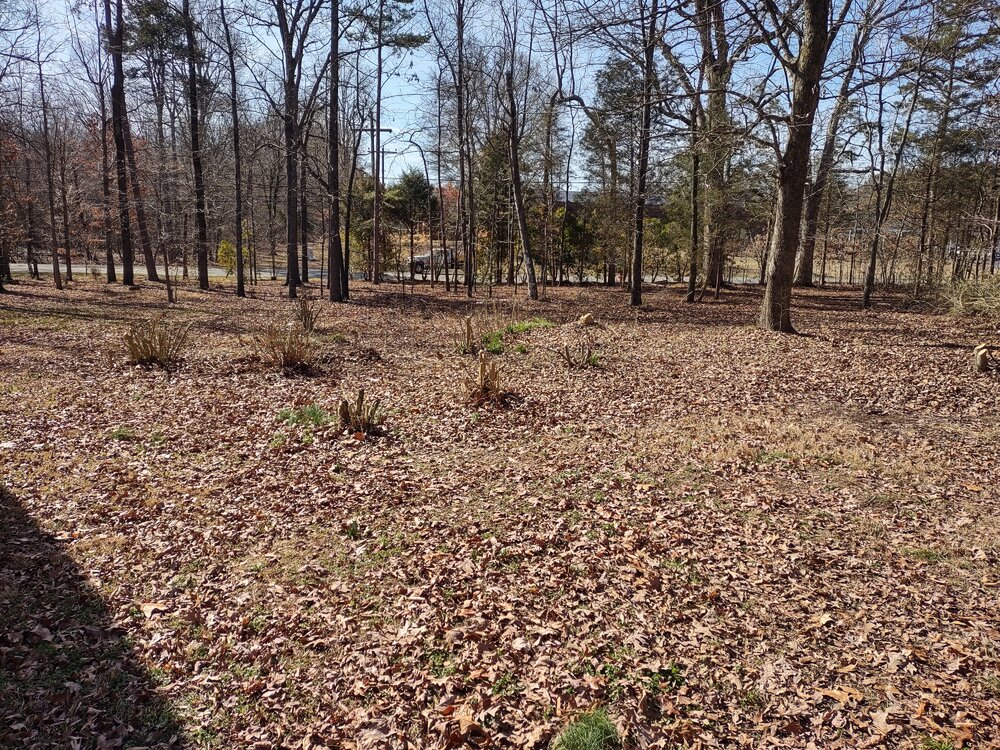

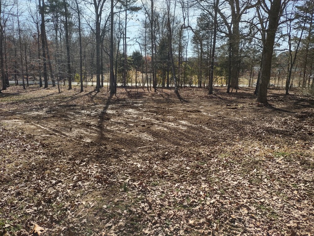

Well that’s super unfortunate. I finally got a concrete to answer/return a phone call, he’s gonna ride out tomorrow and see what we are working with here. Hoping I can get something going soon with all of it
Well I got you one step closer to your shop. Took care of that pesky grape vine too lol. Thanks again for the work.
