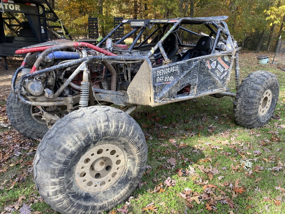

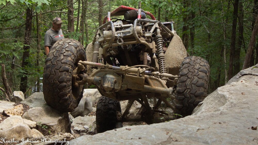

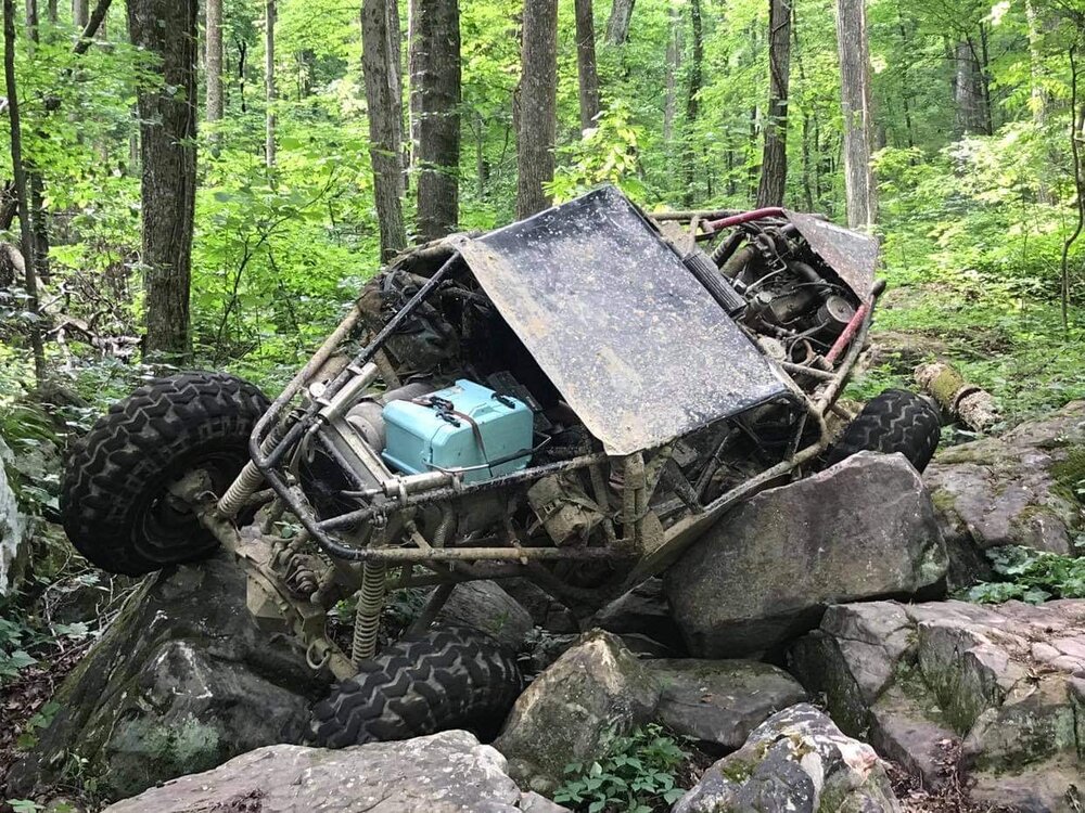

I finished up my M&M party wagon around September this year which left me with my old clapped out turbo buggy still completely intact. The question is... what to do with it? Ive been studying werock for a couple of years now and am a rock crawler at heart. That being said, I have decided to tear down old faithful, take most of the parts, sell the others I dont need, and build a small rear steer werock/trail buggy. Keep in mind, this is going to be a budget deal (if there even is such a thing). Currently looking at keeping the turbo big block propane 22r, lp60, and using the super shave 14b for rear steer. All kingpin parts because its what I have the most of. Looking at aw4 and atlas 5:1 behind the turbo big block. Will most likely end up with one of those JHF goat built kit car chassis's. I thought this would be a good place to document the build and get some opinions along the way. Go ahead and flame away :rockon:
Pictures of old buggy for reference… 😬😬

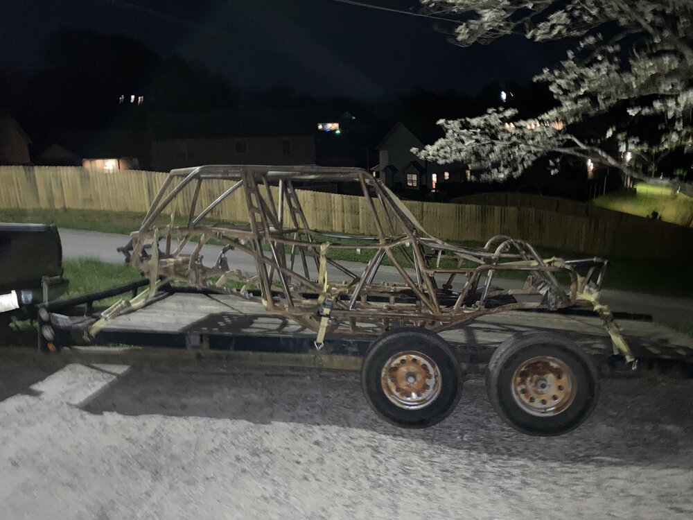

Little update here... making a 20+ hour round trip to Maryland Saturday to pick up a JHF Goatbuilt kit. It is complete kit except for lower link brackets and hood/grill. Getting a pretty dang good deal or wouldnt be making the terrible trip up there. Getting closer to tearing the old buggy apart, and have the dual yota cases sold already. Also thinking about changing directions on the motor/ trans setup for this due to figuring out some stand alone setup for the big block 22r. Was kinda leaning towards going the Holley sniper route due to price and simplicity but after doing a bunch of reading and friends with experience with it that have actually had it in a buggy and not just a hotrod, it honestly sounds like a shitty idea due to constant problems. The simple fix is LS and forget about it which is cost effective for the performance. Anybody have experience with standalone on something like a 22r that wasnt just stupid expensive?

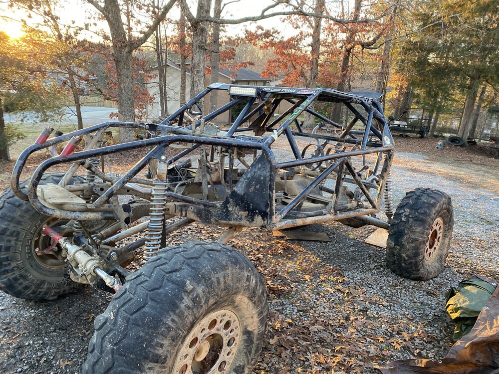

There may have been a tear shed tearing this thing apart but I’m getting closer. Everything is out but axles and shocks. Will have those out and chassis will be forsale by end of next week. Cleaning up axles, narrowing them, and rear steer 14b coming next.
