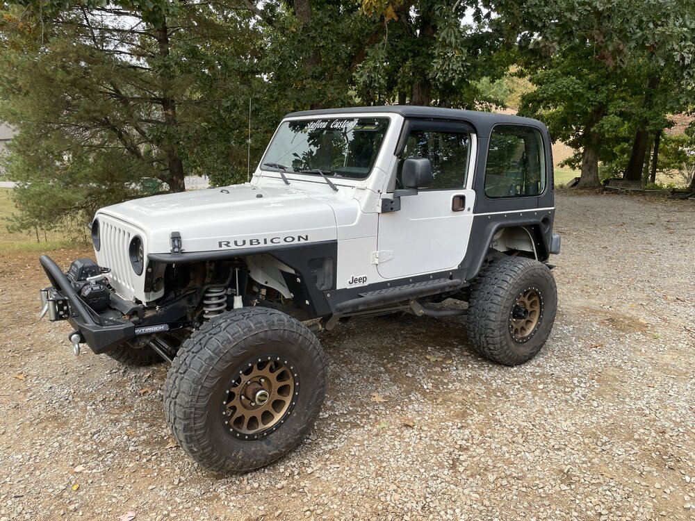

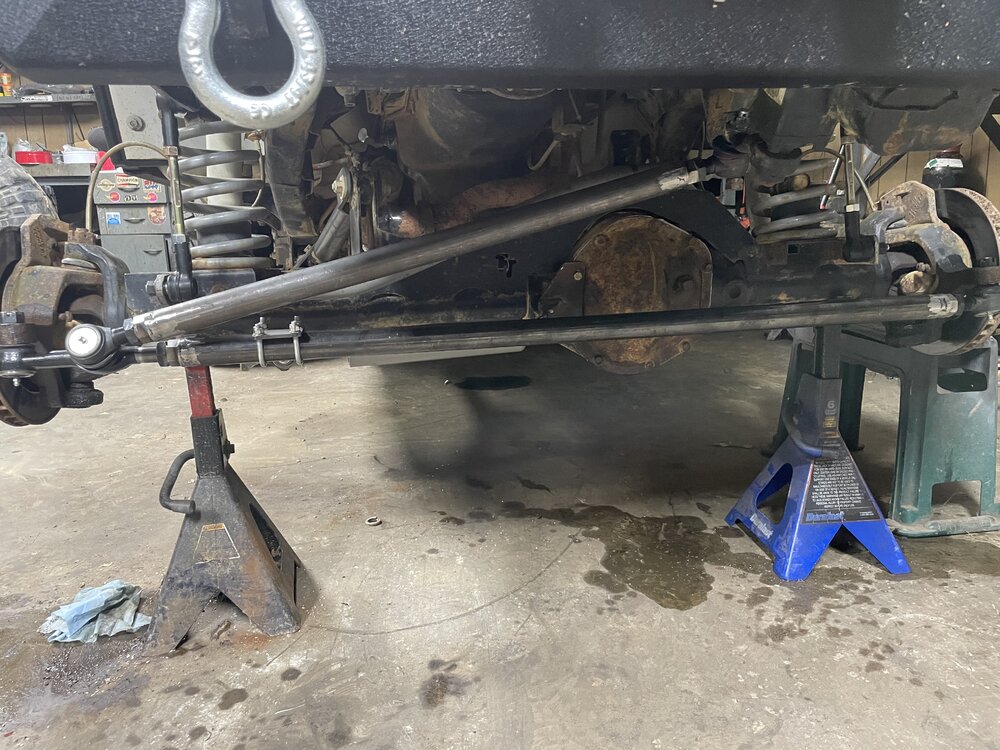

Update time. Bought a 2003 rubicon from a buddy that was a slight project. 90,000 miles, turbo 4.0, hp d44 and 9" axles. Rear 3rd was blew out of it, steering was a deathtrap on the road, typical jeep issues. Rebuilt the rear axle and went to a 4.56 gear and open carrier to ditch the spool. Same had to be done to the front, 4.56 and added an aussie locker. It already had a longarm kit so the suspension is ok for a street jeep/ mild wheeler. All the heims were wore out on the hp44 steering. Ditched all of that for a one ton tre kit from barnes, drives much better now. Went ahead and added an antirock tot he front since there were no swaybars on it at all. Removed all the turbo stuff so it actually runs good now and changed the trans oil to make 2nd gear happier again. Should be a fun little jeep and something to take momma out in some.

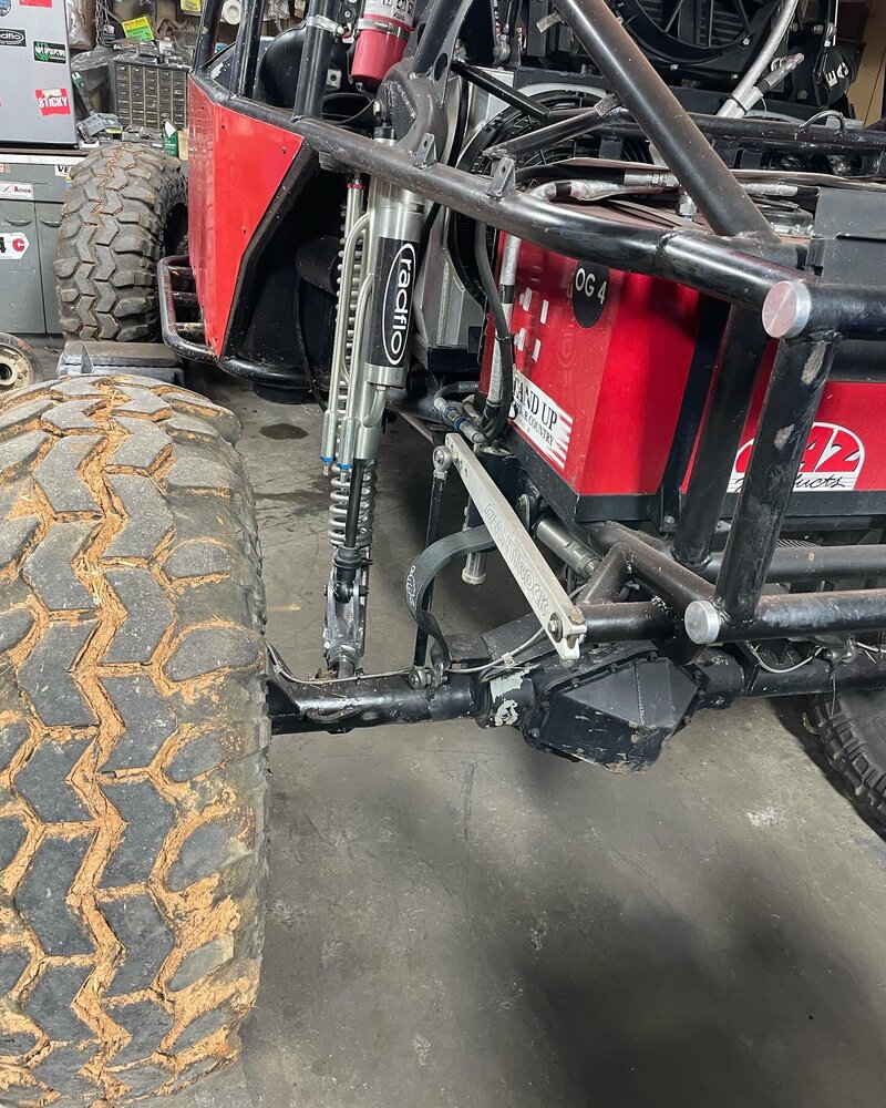

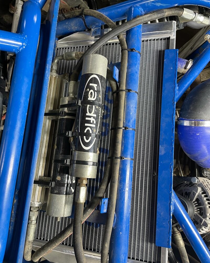

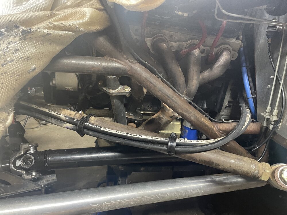

Can't tell you how nice it is for summer to be coming to an end and more shop time now. Getting closer on Clark's buggy. Steering done, all hoses and brake lines rerouted except the driver side, pinion bridge was Uber ghey to put together cause the guard had to welded up. Got some 2.5 radflos ordered from my homie Chris at Diddys Big Block Race Shop and should be here next week. Got some minimal welding to do still, set up bump pads, and set up shocks. Almost ready to party.

Got bump pads made for Clark's, driveshaft be here Tuesday, and should have shocks next week also.

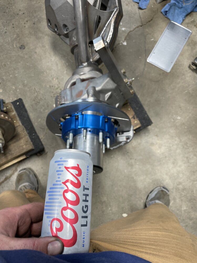

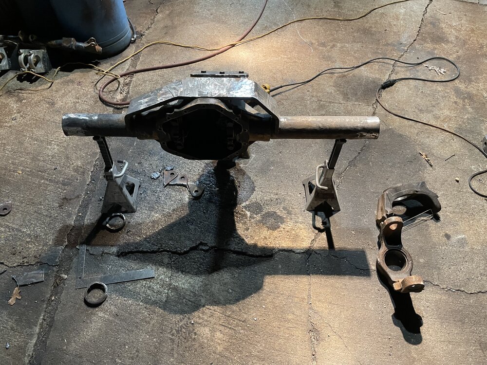

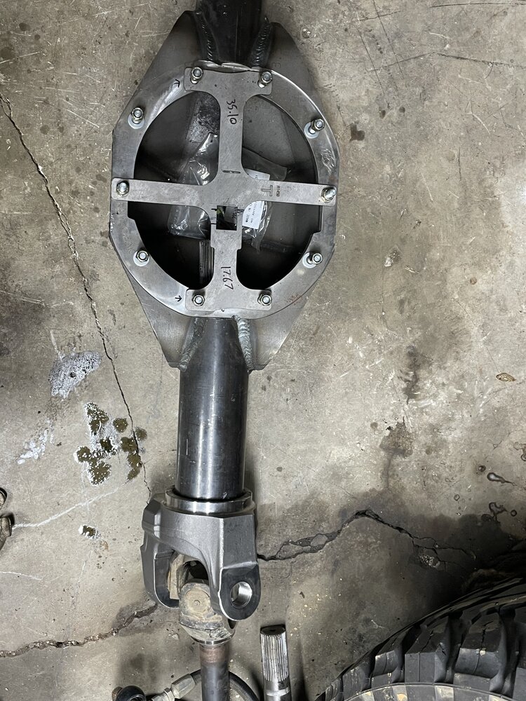

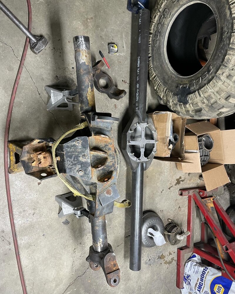

Back to building axles tonight. Cut the already set and tacked Cs off the rear steer axle and trimmed the housing another 1.25". Got everything set back up at 15* pinion angle and 7-8* caster. Should be around 66.5" wms. Started pressing bearings on the 40 spline china spool but much like my wiener, ran out of stroke before bottoming out. Hoping to have more progress tomorrow.

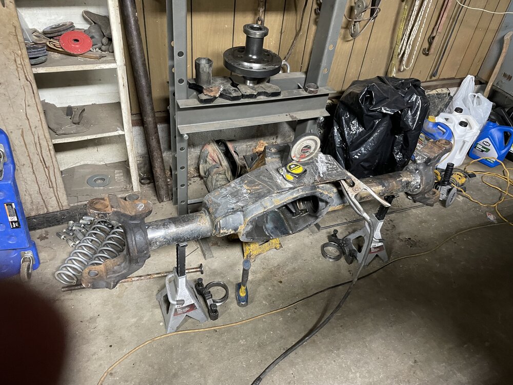

Basically and endless amount of measuring today. Carriers in and out multiple times and by the words of @Jody Treadway tight is tight when setting up used gears and reusing bolts :laughing::laughing::laughing:. All rear 40 spline shafts are ready to be ordered when I'm not poor.
Also after a stupid amount of measuring, I cut the short side of the fab housing. Everything lined up as perfect as I could have hoped and tapped one C on. We are ready to cut the long side now.

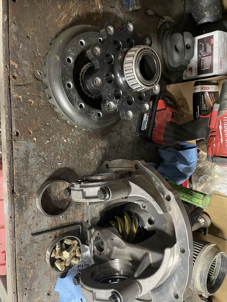

The front 3rd member had to come apart cause I was cheap and used a Yukon spool instead of a gear works so now the spool don't clear the load bolt. Good thing grinders love spools. Once the 3rd is back together, will be ready to set some kind of pinion angle and caster.

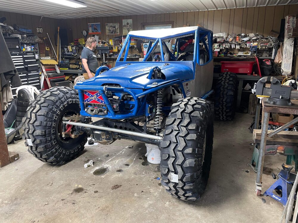

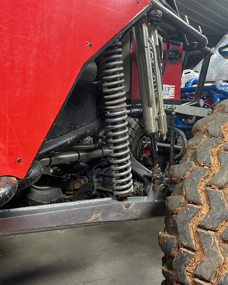

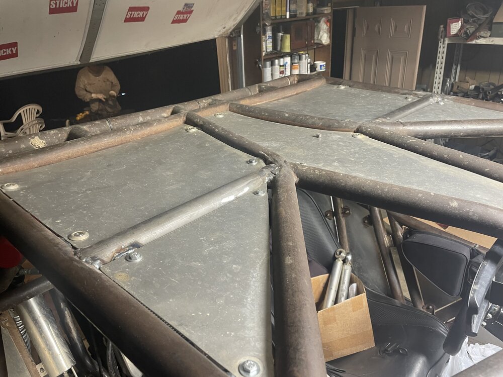

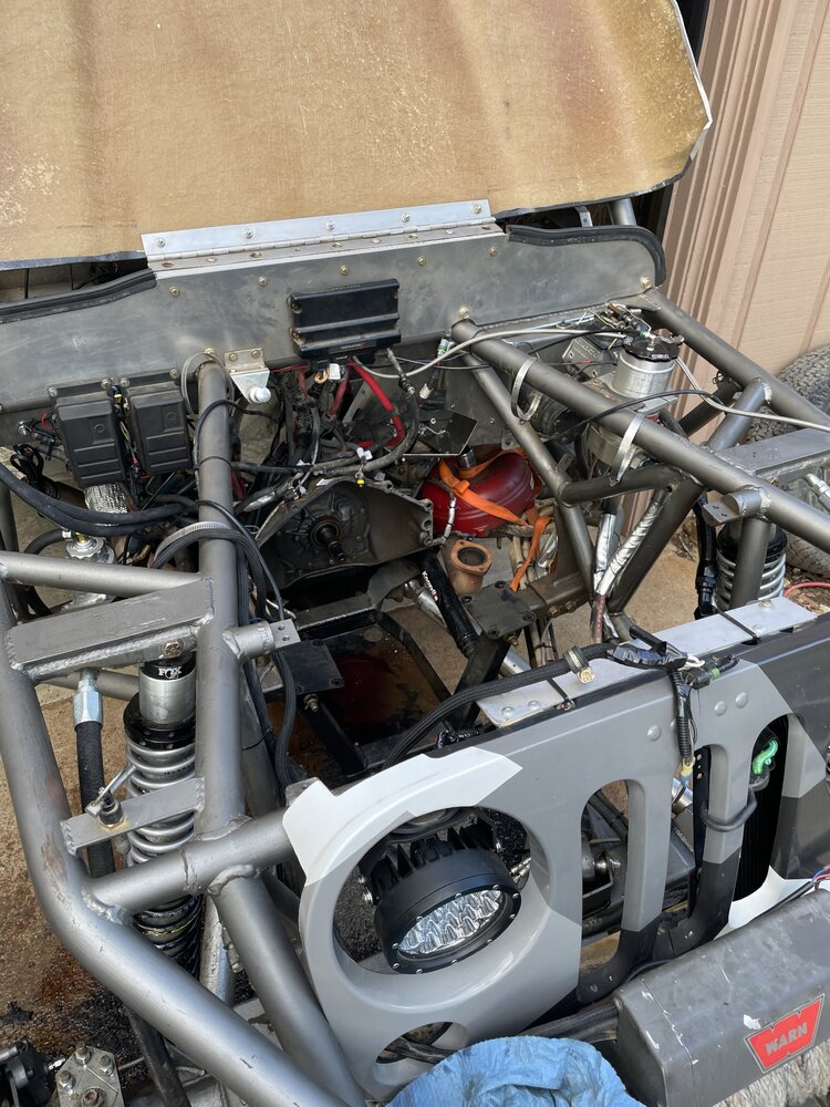

Back to Clark's buggy. Got the motor mount tie in he wanted fixed back. Drive shaft came in from Adams and it was perfect, great quality. And got the roof braces but in and panels cut around them. These are critical for support and not sure why most builders don't add them.
Had some major complications with the mounts for the new 2.5s but think we have a game plan now. Hoping to get that situated tomorrow.

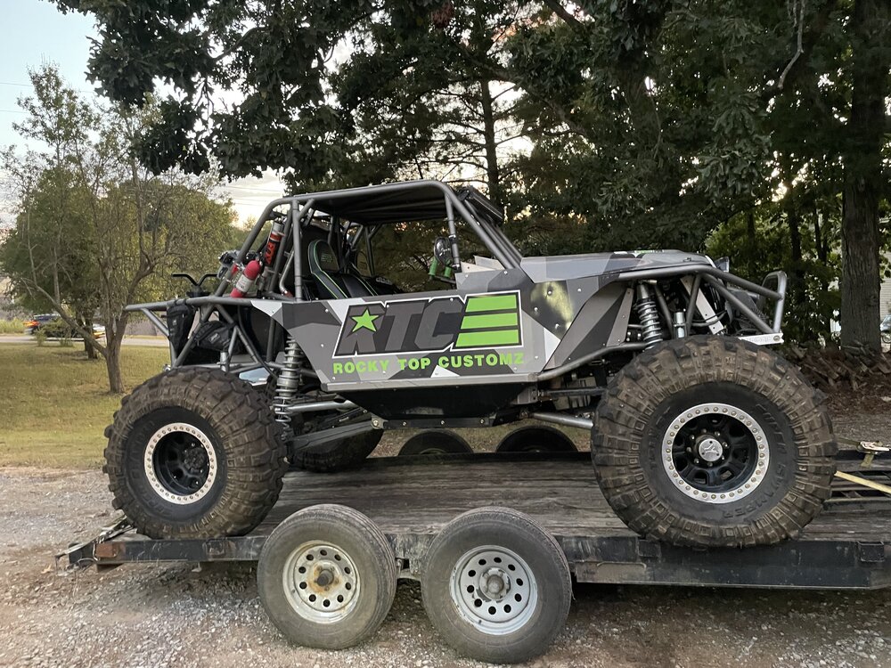

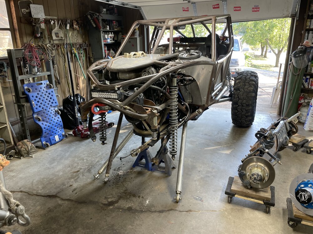

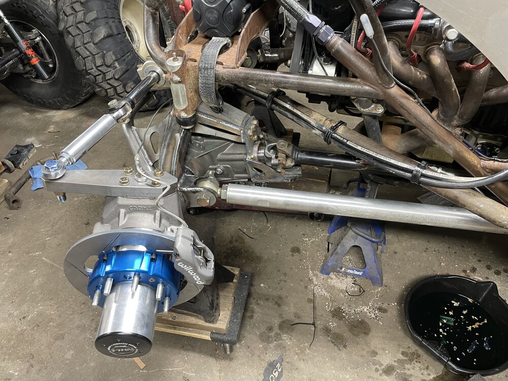

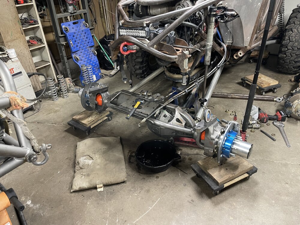

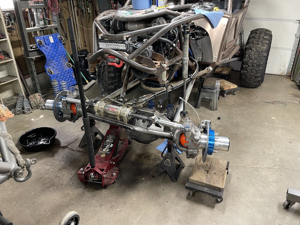

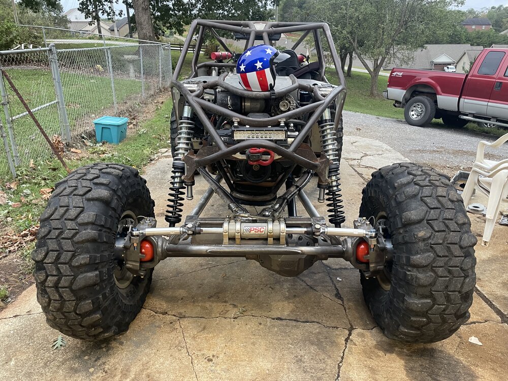

Got Clark finished up today just in time for him to come home Tuesday. Upper shock mounts fought up bad. Happy with how it turned out. Now it needs trailing arms and bypasses in the back.

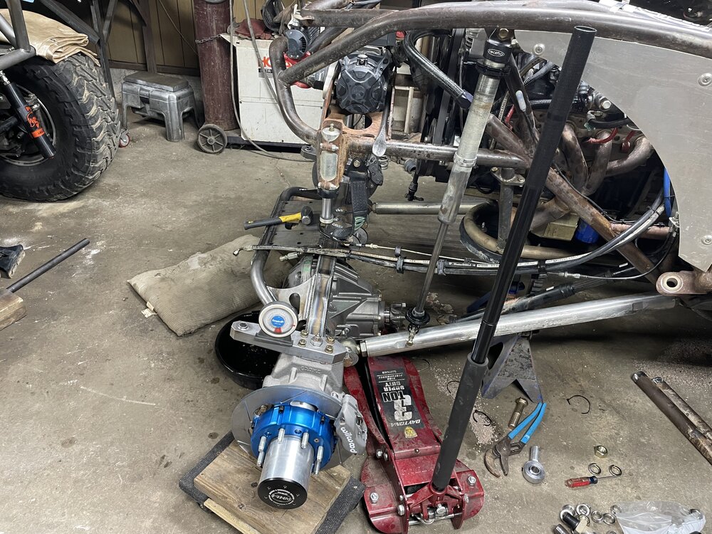

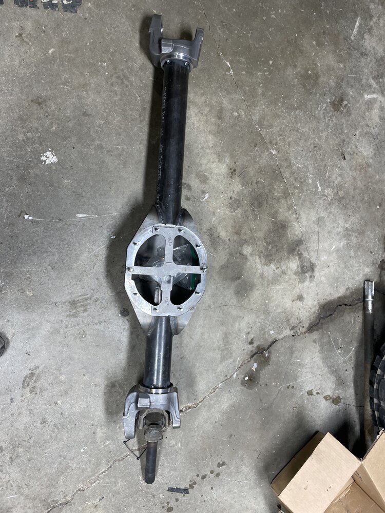

Got some Cs mocked on the trail mart housing. 13* pinion and 7* caster. I'm using a factory length gm60 short side shaft. Going to have to cut the C back off and cut the tube another 1/4" for some more spline engagement. It has 1.5" but I'd prefer a little more.
3rd is half ass back together and now the load bolt works. Need to set backlash. Also welded the Cs on the rear steer trash axle. Good day.
