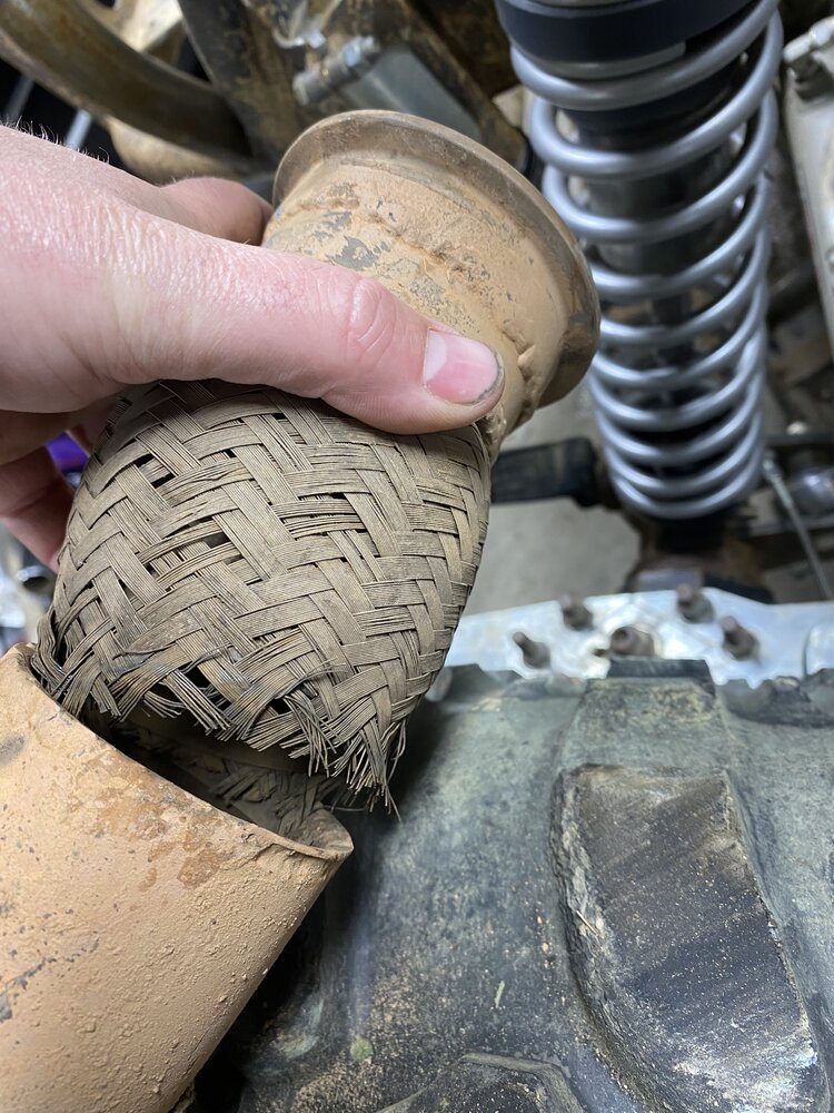

The exhaust flex joint was blew out like my buddies sister after a bad friday night cause it was cheap
No flex joint for me. Make a bracket to hold the exhaust directly to the drivetrain instead of the chassis and you won't need one.

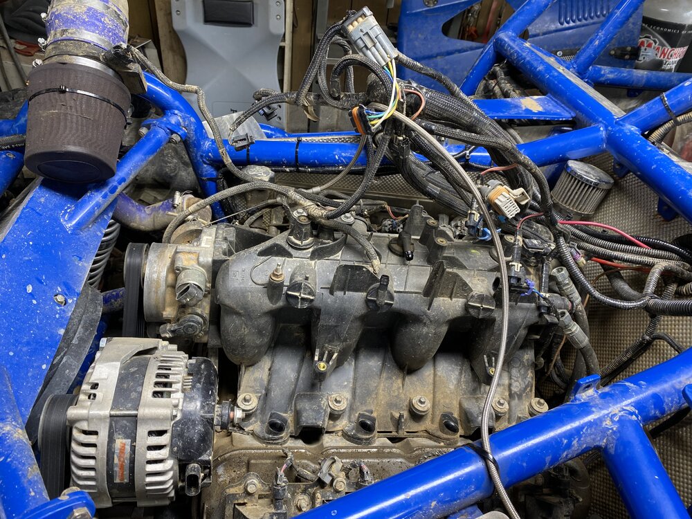

Makes sense on the exhaust joint however I have no desire to start bending exhaust tubing again at this point. Picked up a "good" flex joint from summit to weld back in this ones place. Trans coolers are the same, still running two. The "small" griffin below the fuel cell and the derale above the fuel cell for just a pass through. May or may not have to wire up the fan on the second one for summer.

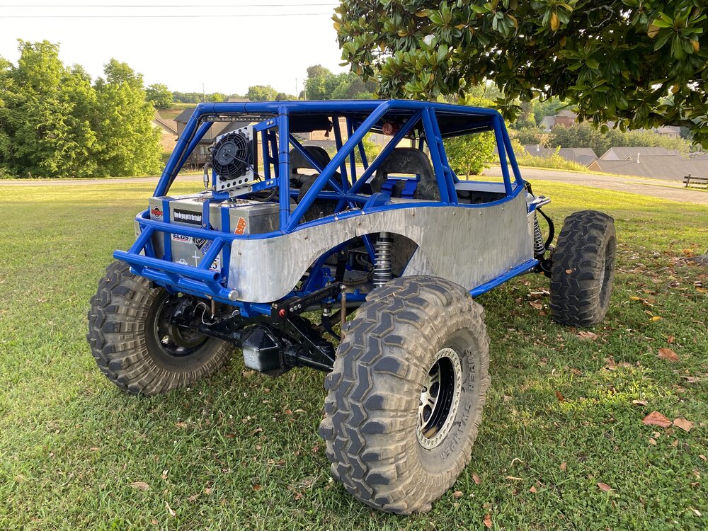

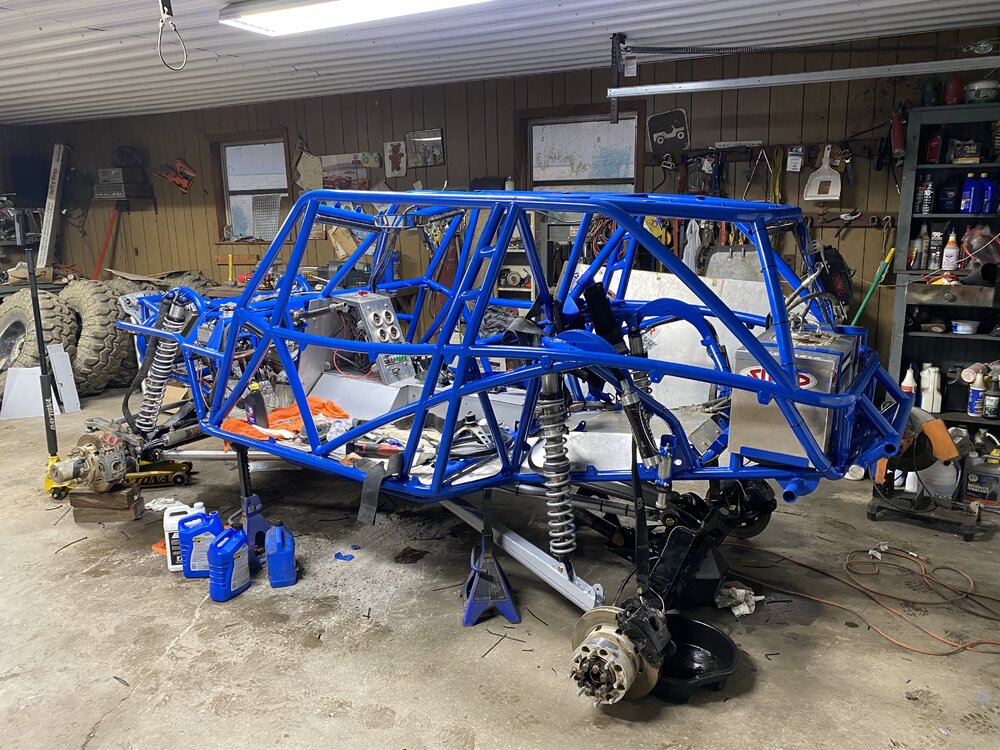

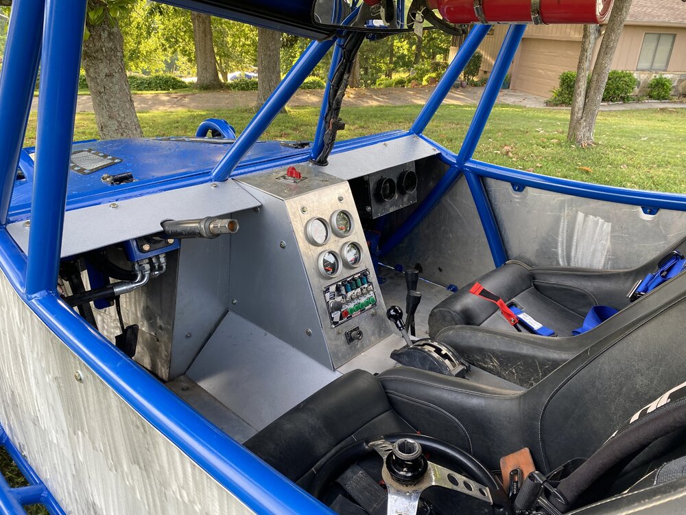

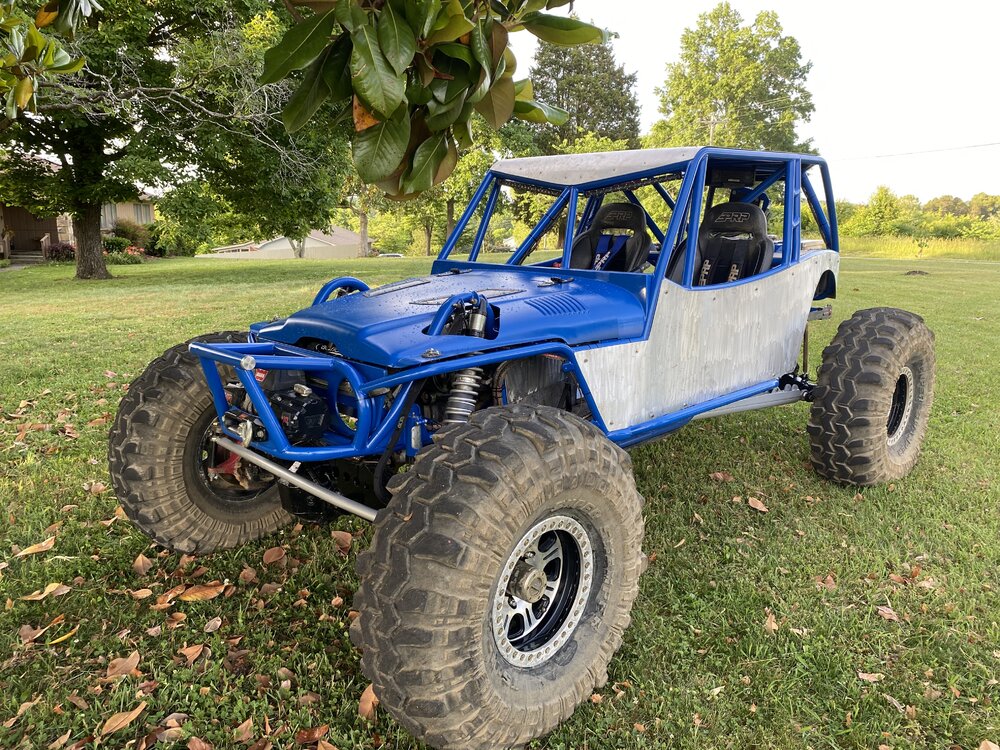

Almost done putting the party wagon back together. Got some wiring to finish up, seats, bleed brakes, load new tune, and put external panels back on. Still lacking paint for hood and grill also which isn’t a big deal being that it may be hoodless for summer months anyway. Motor sounds great with the cam and party muffler.

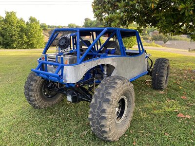

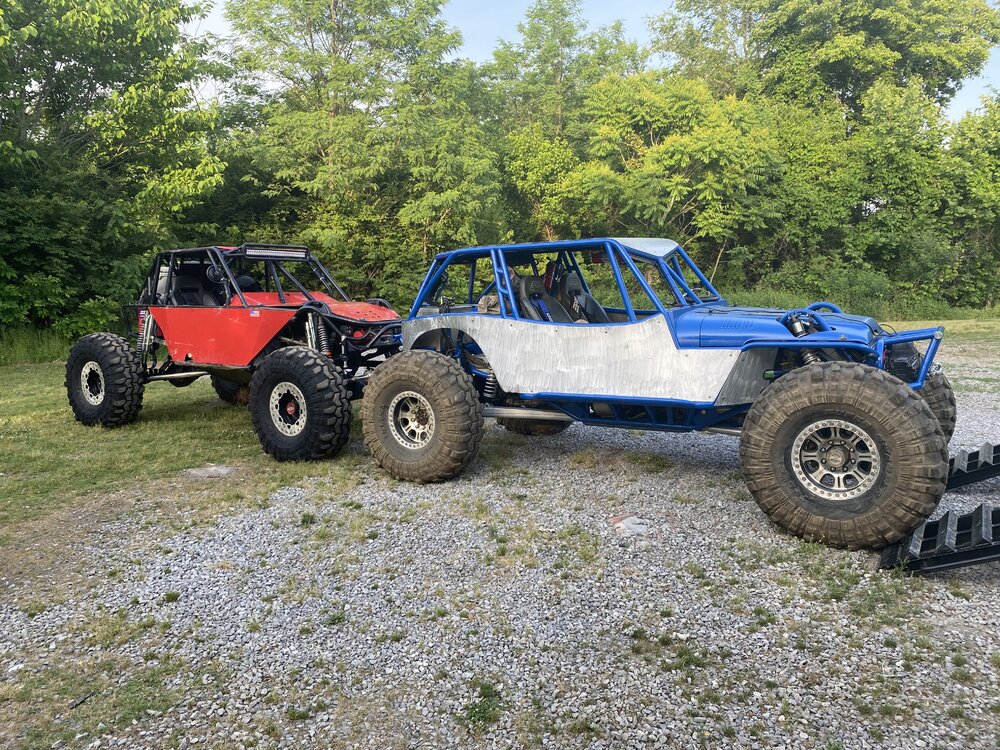

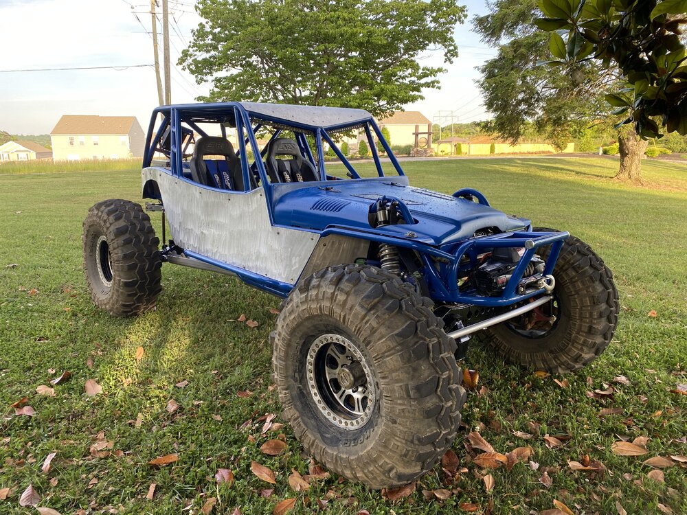

Got the party wagon finished up and made a successful windrock trip over the weekend. Covered somewhere around 50 miles Saturday riding from windrock campground to the sand mines and back. Currently looking into a bigger radiator and changing the second trans cooler to a bigger one. Got the sway bar fixed for now and what a huge difference that made on the go fast side of things. Really happy with how this thing turned out overall!

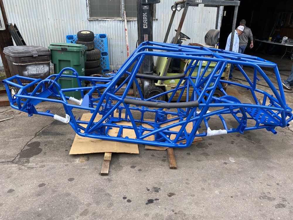

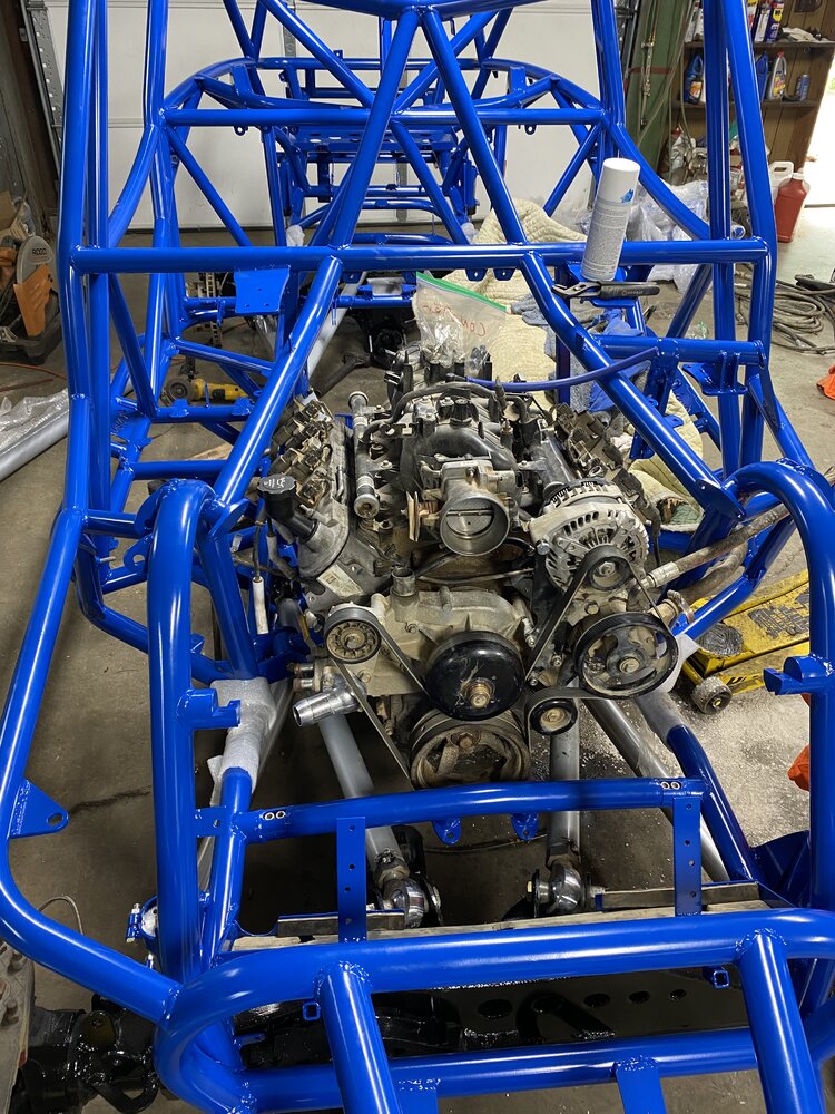

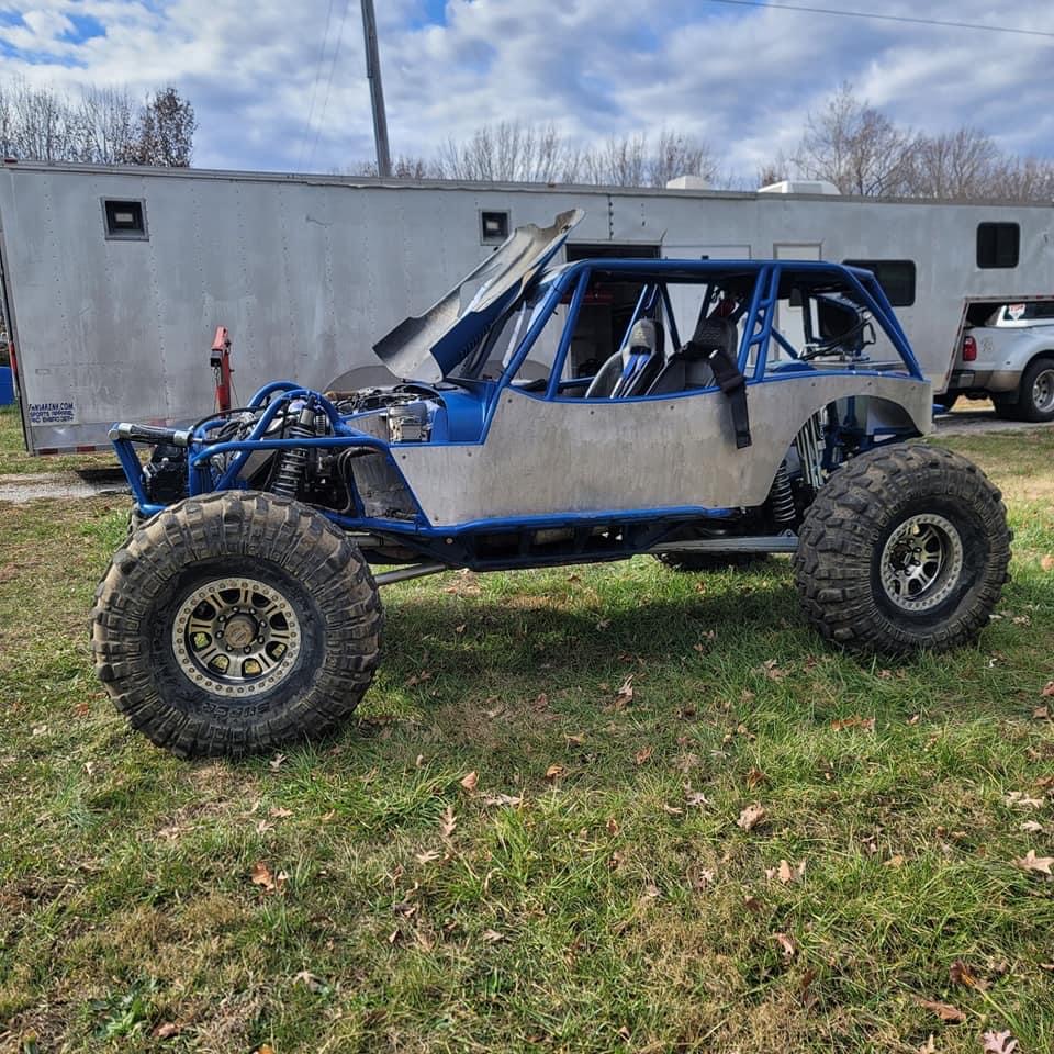

Small updates... the JHF chassis has been dropped off at Rev Limit Fab.

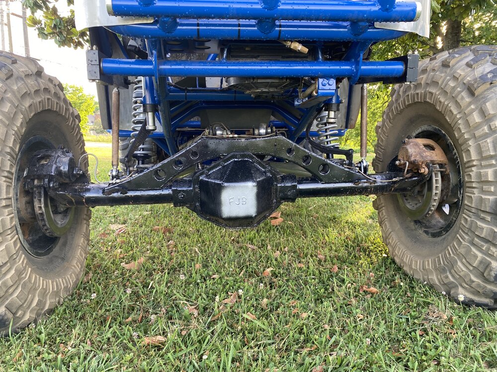

As for the party wagon, rear brake MC has been changed to match the front and improve brakes, bigger trans cooler to replace the small secondary is ordered and should be here this week, 4 tube bypass shocks are ordered for the rear, and 300m floater shafts from Branik have been installed in the rear 14b.

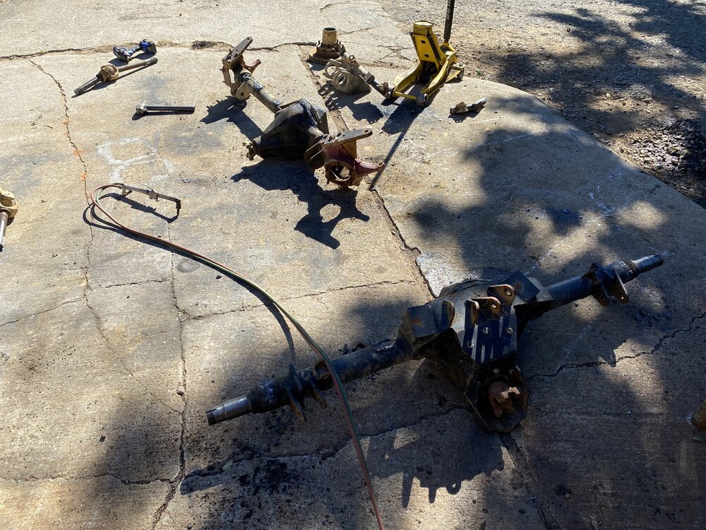

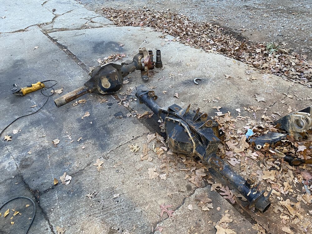

Nothing real exciting happening here but progress is progress. I forgot how bad I hated cleaning axles. Anybody know the exact measurement of the 05up stuff from back of C to wms??
Pretty sure @Chris_Keziah has one in the parking lot
Thanks! I had 12 7/8 so I wasnt far off. Hoping to get these axles clean sometime soon and start cutting on stuff. Shooting for 66"wms or there about on the rear steer axle.
Accounting for rotor thickness your probably right pm, I could easily see them being 3/8"

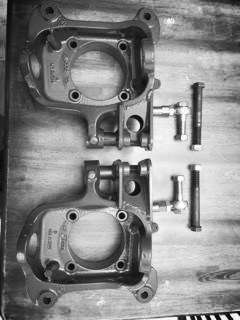

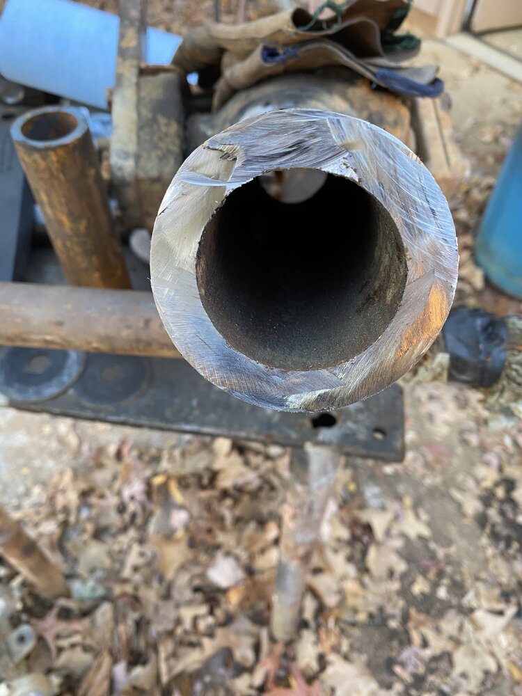

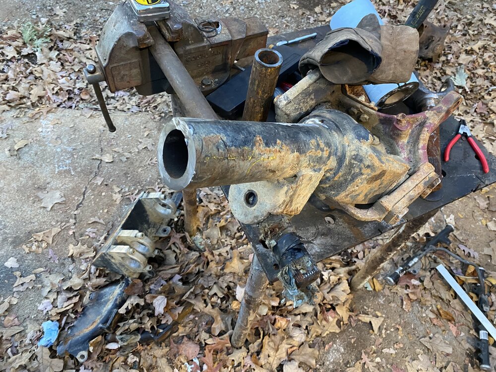

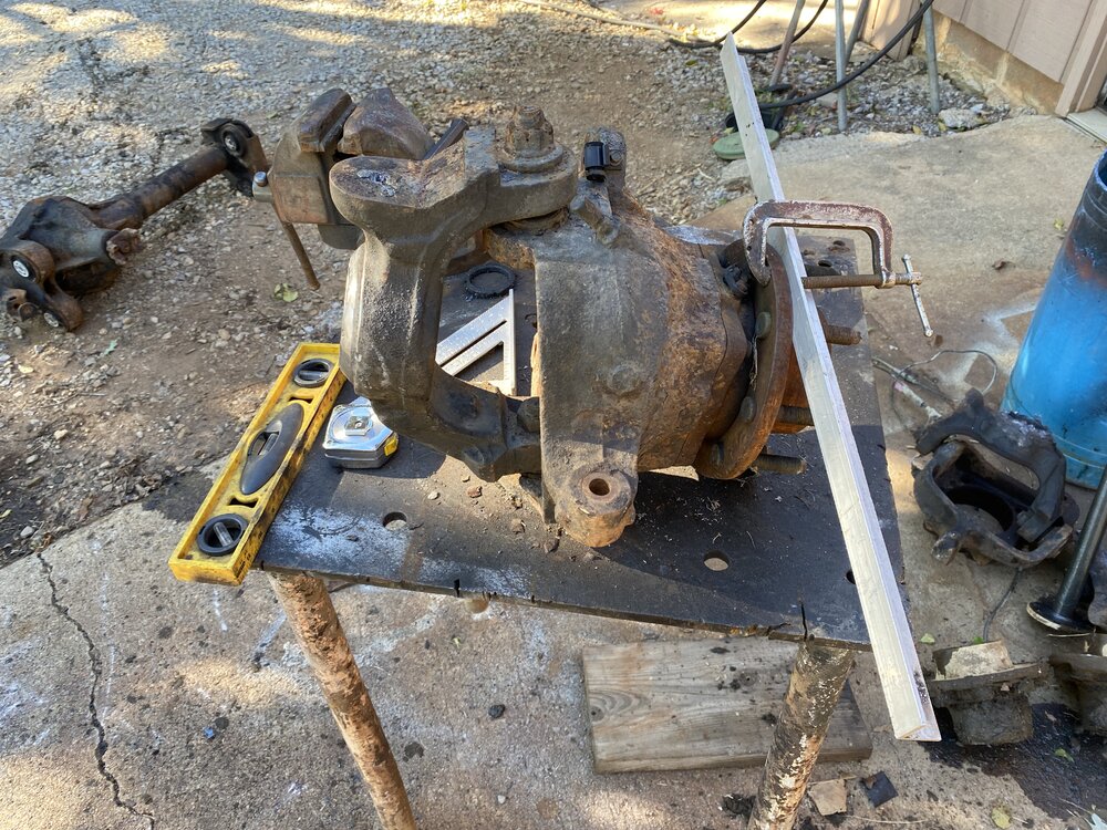

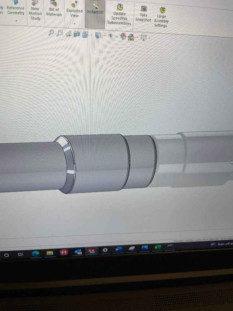

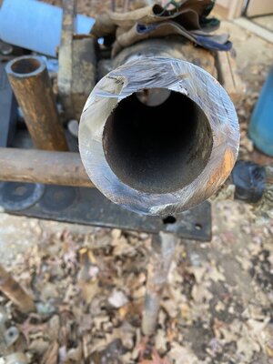

Little axle cutting over the weekend. We’re all of the kingpin 60s 1/2” wall tube?? Maybe this is a cucv axle? Either way I was impressed. 4” section is cut out of the gm60 and spindles are cut off the 14b. A buddy has drawn an adapter for the 14b tube to 05 sd C and will be sent to the machine shop probably this week. I need to find about 6” of thin wall 2.125” to slug the d60 back together. Wilwood pedals and a bunch of various tabs showed up last week for this chassis also. Trying to gather enough parts to make a good start on it before dragging it in the shop.
Had an extra set of hands Saturday and the actual measurements from back of C to wms on unit bearing for 05up sd is 12.5”.
Also rebuilt an old super joint for the short side shaft for this d60. That joint is OLD and has seen signs of a good time in the past but rebuild better than expected. I was pretty pleased it rebuilt as tight as it did.

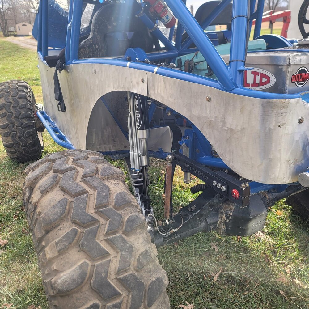

Triple bypasses showed up for the party wagon from Diddys Big Block Race Shop, and will probably be cutting dads buggy apart this winter for trailing arms. Stay tuned.

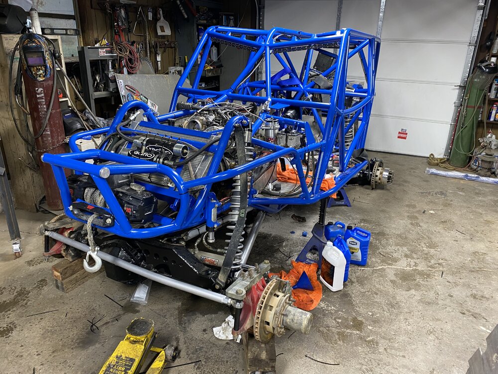

Not much to update but the wagon got rear bypasses from Diddy Big Block Race Shop, currently working on some injector madness, and my metal came in to splice the d60 back together for the JHF buggy.
