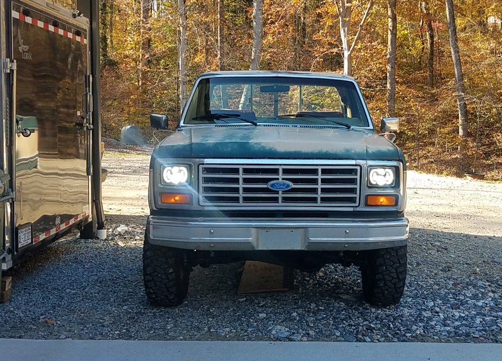

Buttercup
DRL
Low beam
High beam

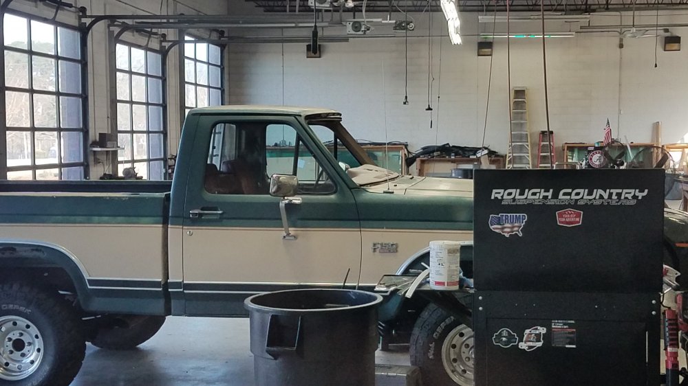

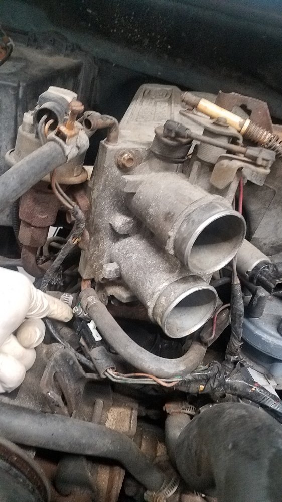

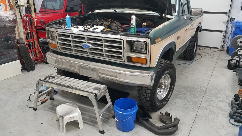

So returning from veterans I got to Denton and slowed for the stoplight. Leaving the light it stammered pretty hard after 1/4 throttle. But once up to speed I could cruise ok, so long as I didn't mash the gas too hard. Same thru thomasville. But the hills near the house had it bucking like a bronco. And by the time I got into my hill going up my drive it was ridiculous.

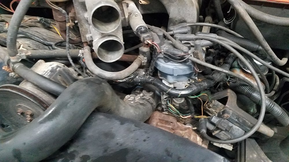

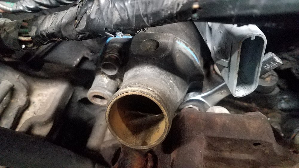

Consulting my more mechanically inclined friends @Chris_Keziah and @77GreenMachine it was suggested a TPS was likely crapped out. I intended to change the thermostat as well since the truck has NO heat whatsoever and I needed to remedy that, so I kicked Shaq out of the garage and got to work
The TPS on these 302s is stupid. I mean...who would design it where the TPS is down there like that?!?!
So you have to take the throttle body off to access it.

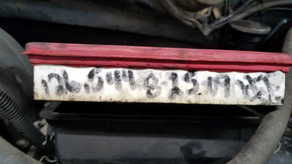

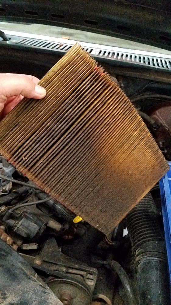

Checked the air filter...ugh
So with the TPS and air filter changed I tested it out. Wouldn't even turn over.
:kaioken:

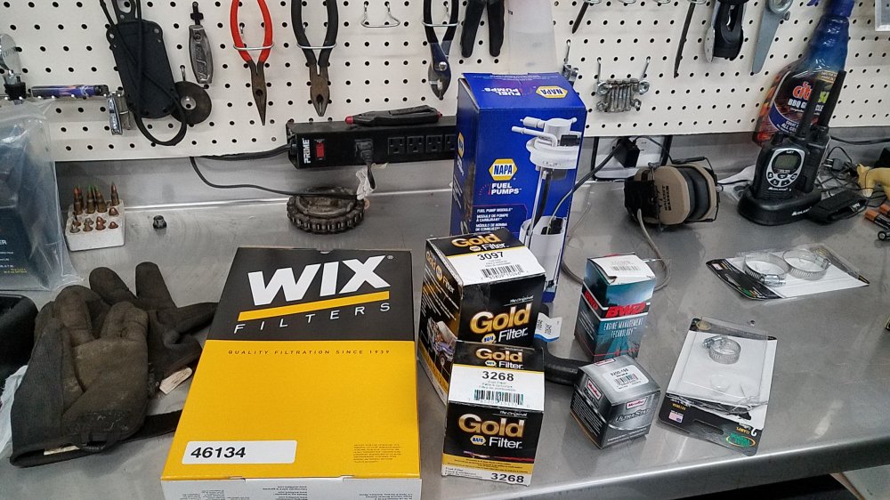

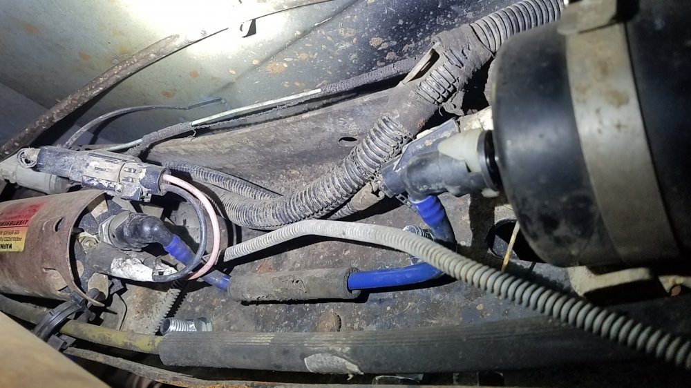

Consulted more mechanically folks and @Jason W. Said fuel pump. So I headed to napa in Greensboro...the big one on 68 because no other parts store had fuel pumps and filters for an 86 F150:rolleyes:
So in researching my info I found this thing has 2 filters and a frame side high pressure pump.
So I got home with all my parts
And went to town

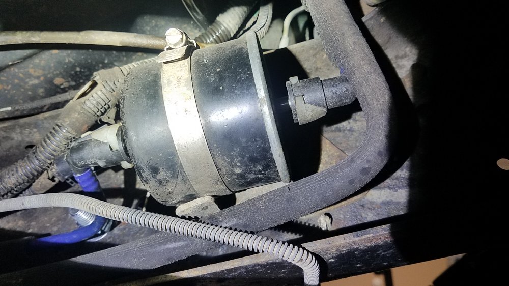

Pre pump filter

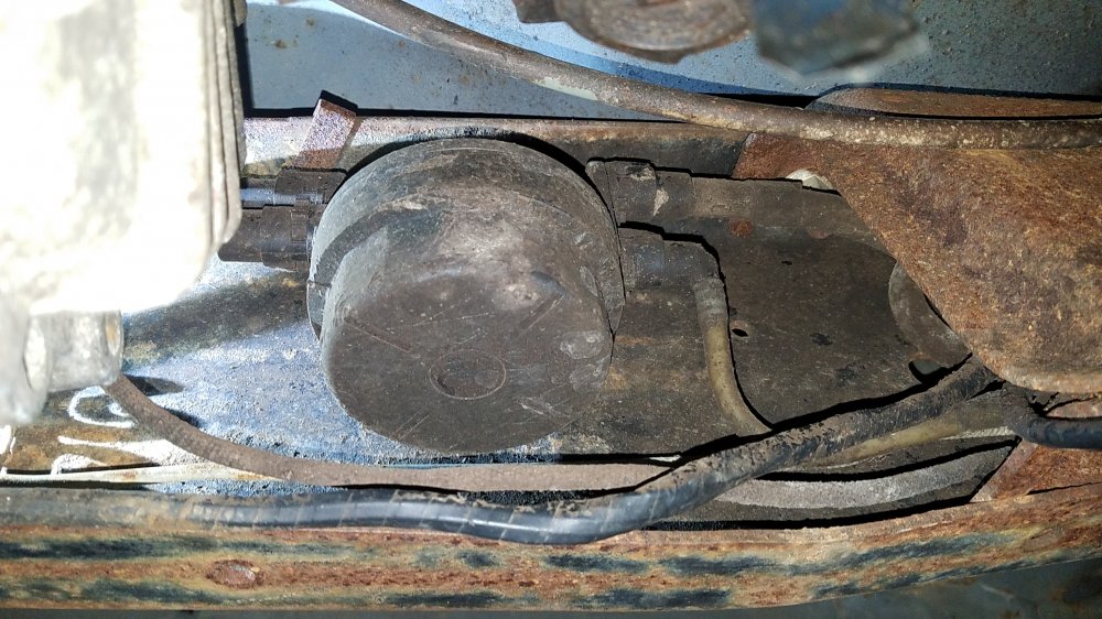

Hi pressure pump
Post pump filter
Time to give it a shot
Would not fire....SHIT

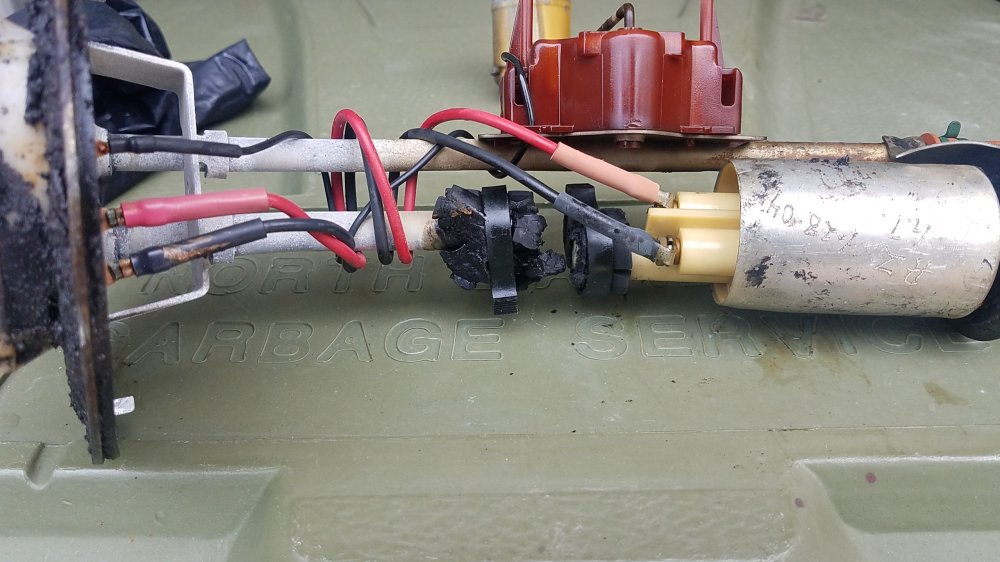

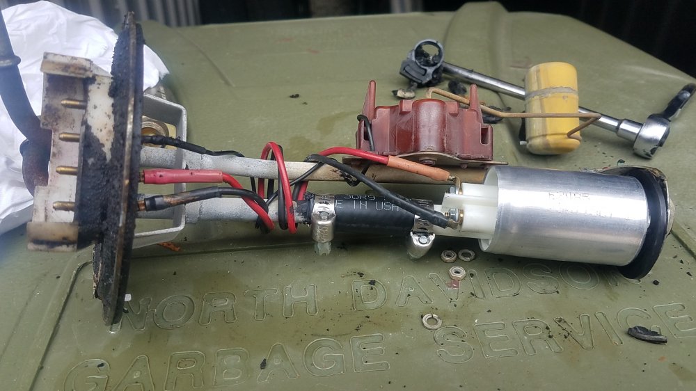

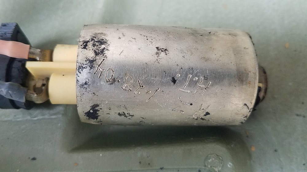

More research...discovered a SECOND fuel pump (low pressure) in the tank :rolleyes:
So BACK to napa on 68 :kaioken:

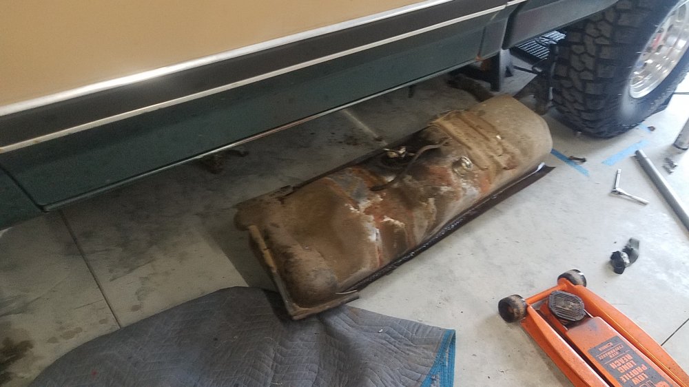

Time to pull the tank..I debated pulling the bed but the bolts holding the bed on look like the head bolts on titanic's coal engines
After lots if cussing the tank was dropped

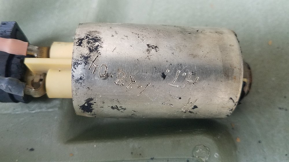

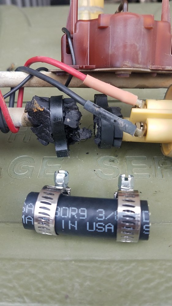

Pulled the assembly and noticed right away something missing. Old pump vs new pump and tubing/gaskets
The old hose had turned to jello
Once reassembled it fired right up

Now let's tackle the thermostat

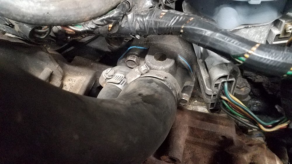

Whoever designed the thermostat housing (and TPS location) on the 302 needs to be shot. One of the bits securing the housing is behind the water pump.
I literally had to cut one of my 1/2" wrenches because I didn't have a shortie
Time to regroup
Thermostat replaced and hoses reconnected

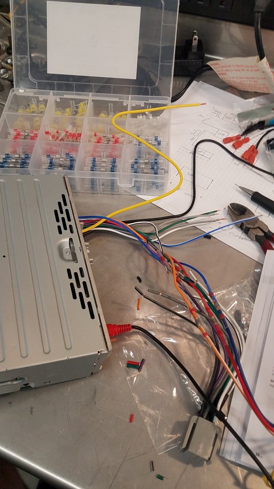

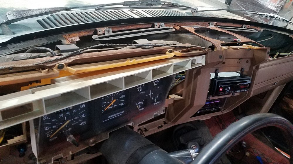

So the radio on buttercup was stock. And water damaged.

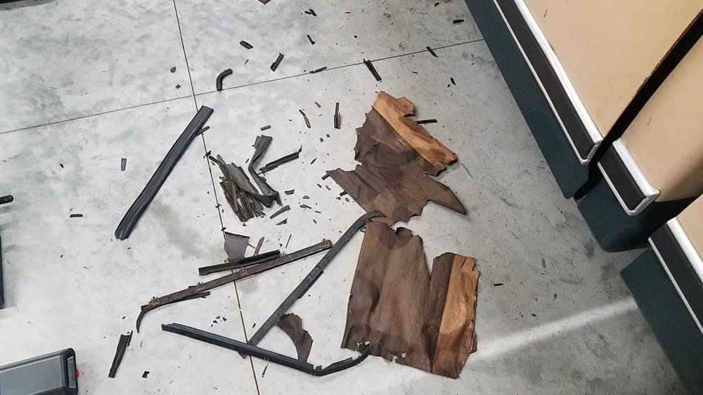

How? Well....turns out the last windshield installed was a bit lax on sealant from the center clear over to the passenger a pillar.
Thankfully Pfaffs auto glass was able to find the leak(s)
Bad news was the windshield had started delamination and was clouding up (under the trim where it wasn't visible)
Decided to go with a new windshield
$238 and 3hrs later I had a new windshield

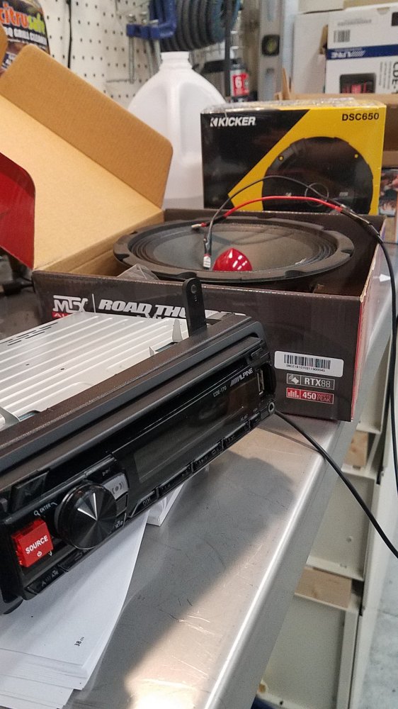

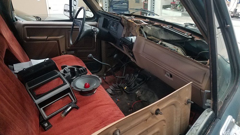

Did you put a sub in the dash?
Yes.....then decided that would be a bad idea if I parked it anywhere of questionable surroundings...so just ordered a new dash pad and putting it behind the seat
