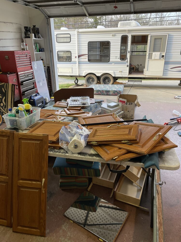

So my wife decided she wants to go wheeling and travel a lot more. But our truck camper on a gooseneck has reached the end of sheltering our family of 4. It is posted for sale, and we have decided a flat bed truck like a Kodiak, or large Cab & Chassis that can haul the Jeep on the back and tow a camper is the best route for our needs.
I scooped up this camper from a forum member for a solid deal and we began remodeling it right away.

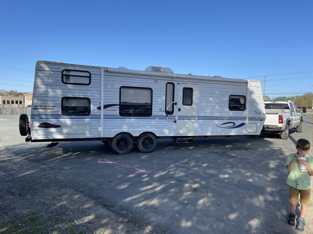

It’s a 2000 Jayco Eagle, 30’ with bunk beds in the rear and a private queen bed up front.
Look close and you can see my boy, absolutely enjoying a Sprite to the max.

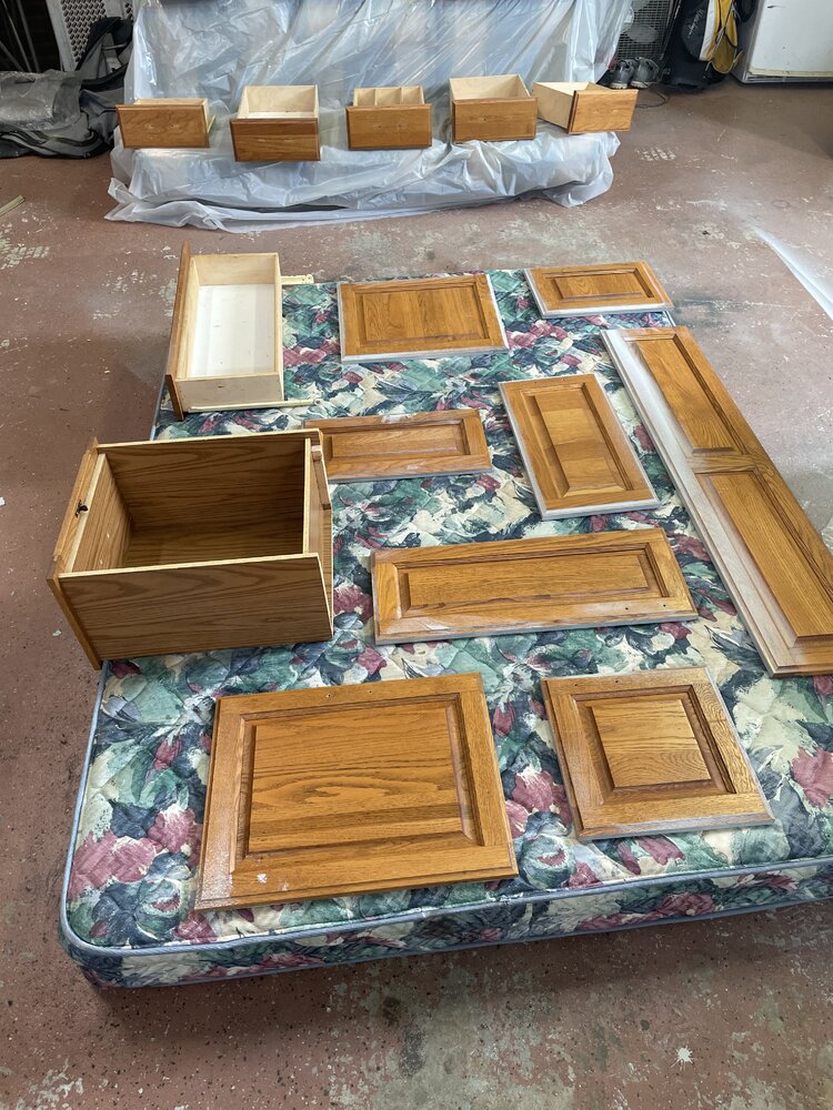

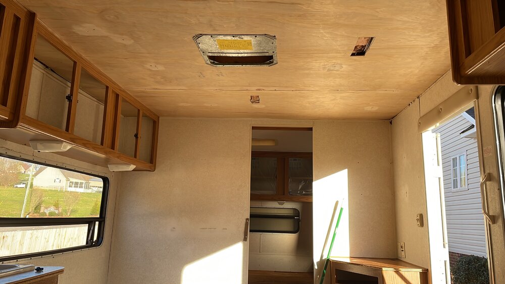

We wasted no time removing all of the cabinet doors, jackknife sofa, dinette and more to begin prepping for paint.
My garage is a wreck, and my yard is full of vehicles, kid toys, my toys and projects. I need to thin the herd
But instead I’m an idiot, and brought home yet another project, you know for all my free time. Least it has a big block and AC.

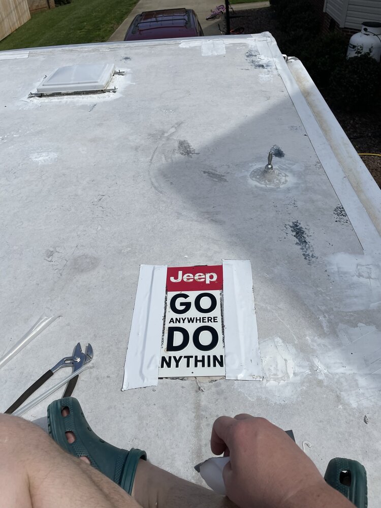

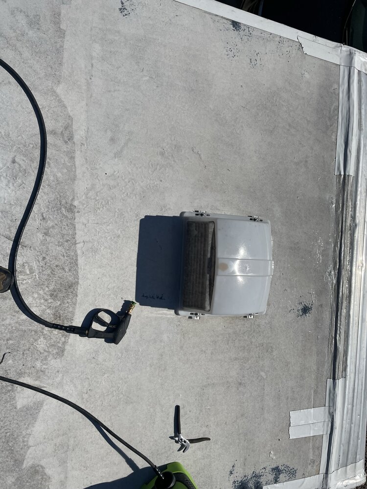

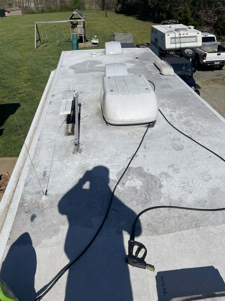

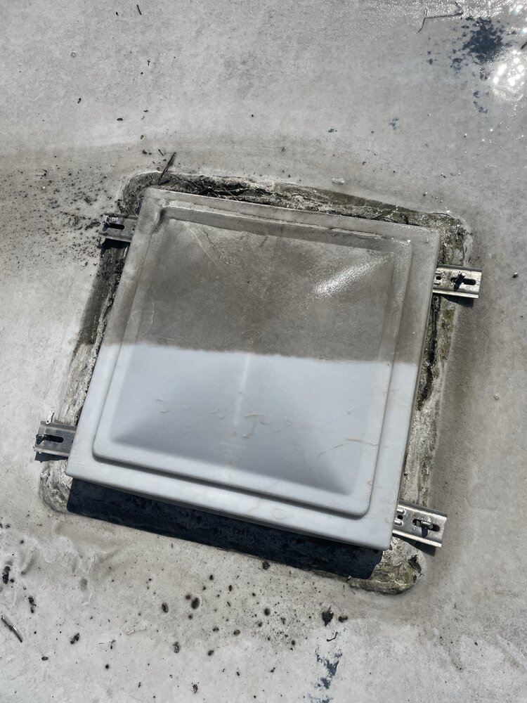

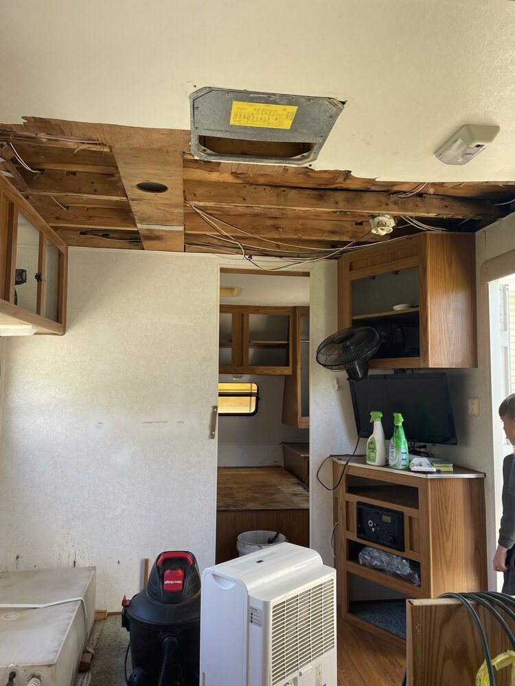

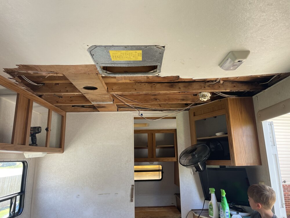

The light in the living room didn’t work, when I pulled it down to inspect it worked when I moved the wires, then I noticed the wires were wet, and the ceiling was lower than before (it was raining at the time). So that of course lead to ripping out the ceiling to find mold, rot, nasty insulation and more.

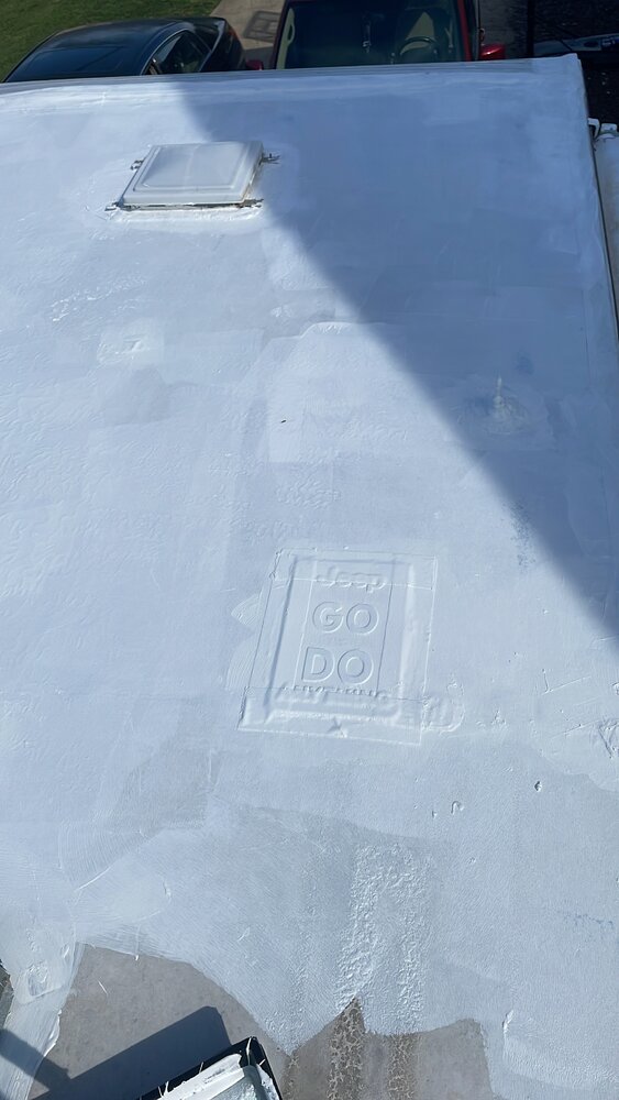

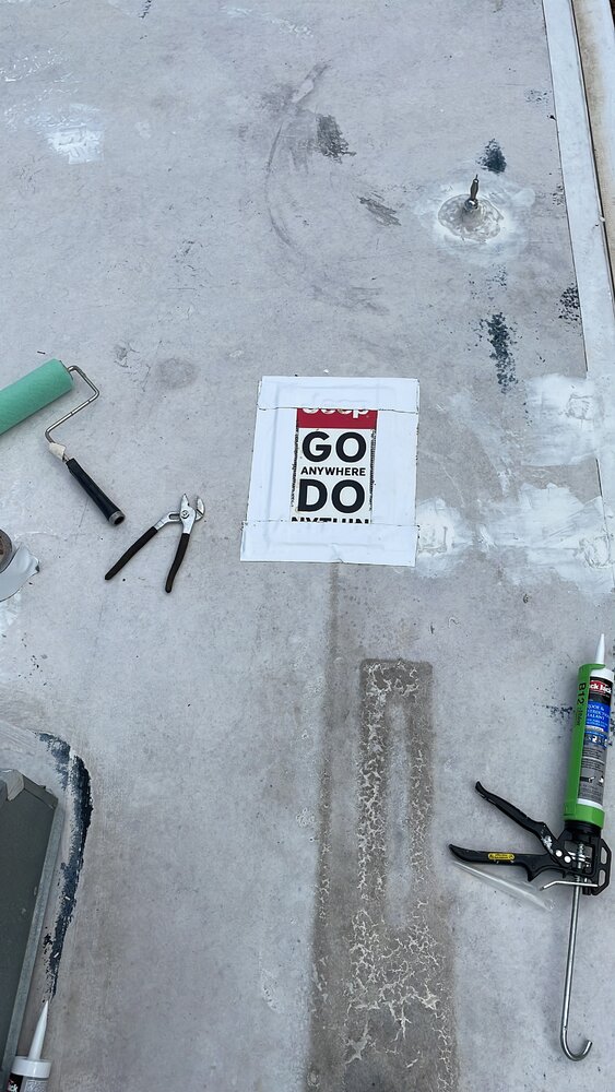

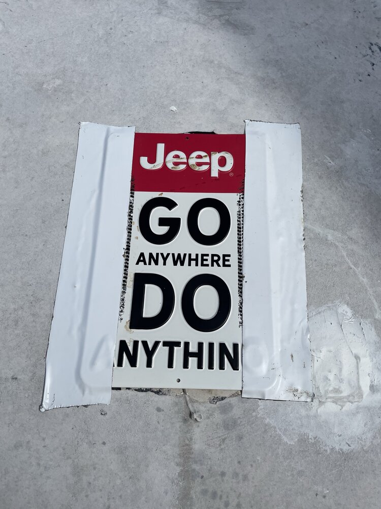

It turned out it was the wind up antenna thing that was leaking. Since that was entirely useless these days anyway I deleted it. But I had limited time to get the roof washed, patched, detailed with lap sealant and then cool sealed since this was discovered in a Tuesday night with rain coming on Thursday. The local hardware store didn’t have a small sheet of metal that I needed, and time was running out. So I did a thing.
I sealed the crap out of the underside of that metal sign that was previously on my garage wall. Then used EternaBond tape, followed up with a healthy triple coat of Cool Seal on the whole roof.

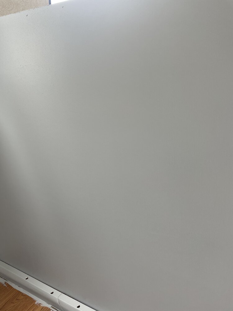

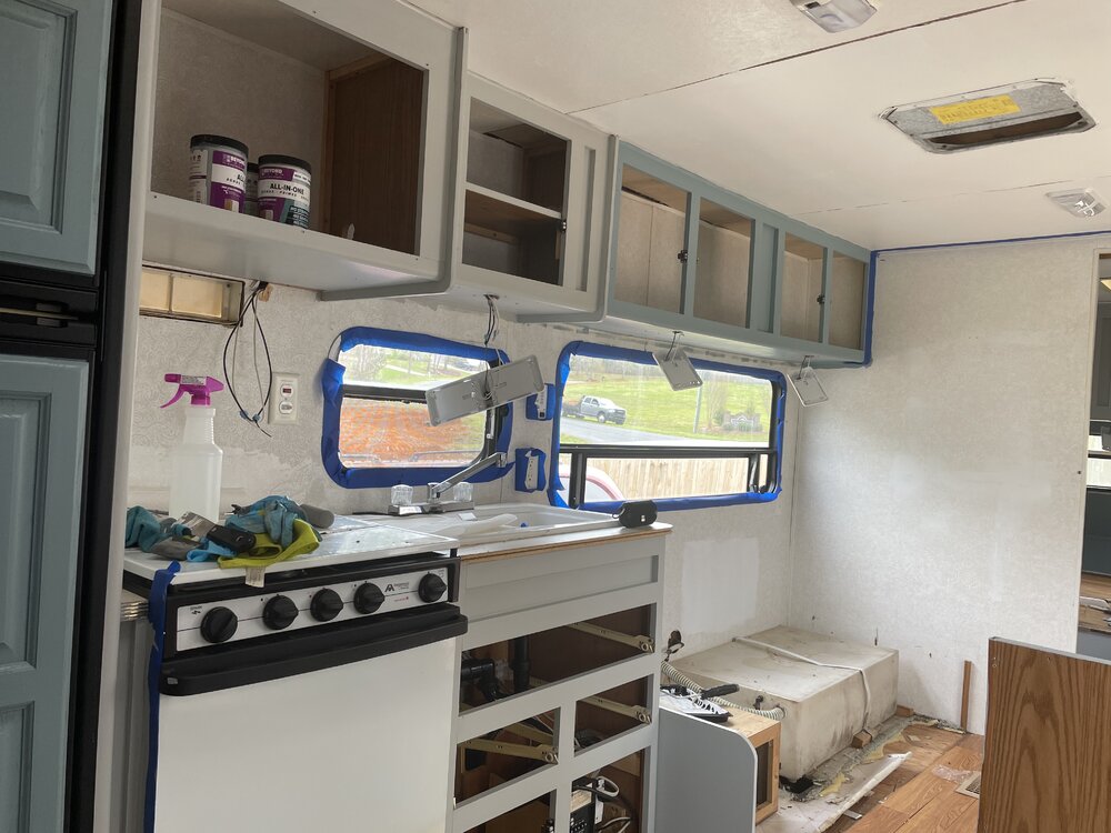

I got the inside dried out after running a dehumidifier and fan for a day or so, then got the insulation and paneling replaced. I also decided to ditch the corner thing up too that held the TV.
It’s all painted with new lights installed. But I forgot to pay attention to the AC vent (circular hole seen on the left side in the demo pics) so I’m gonna have to do some measuring and guessing with a hole saw.

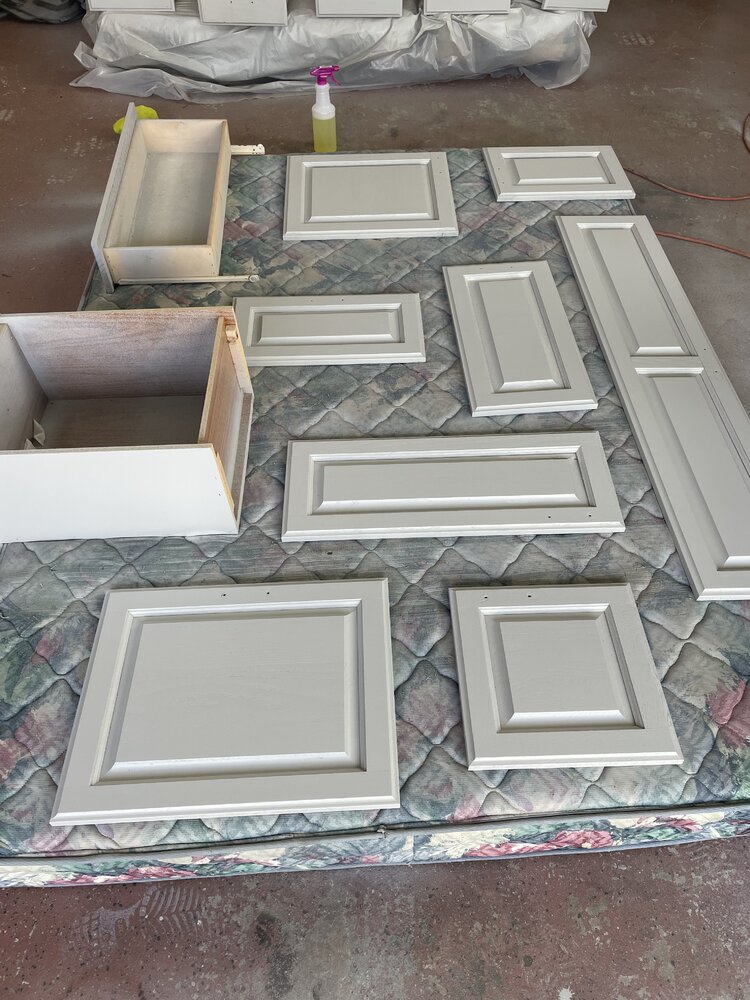

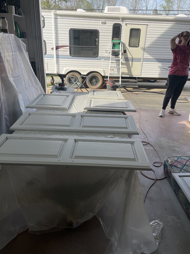

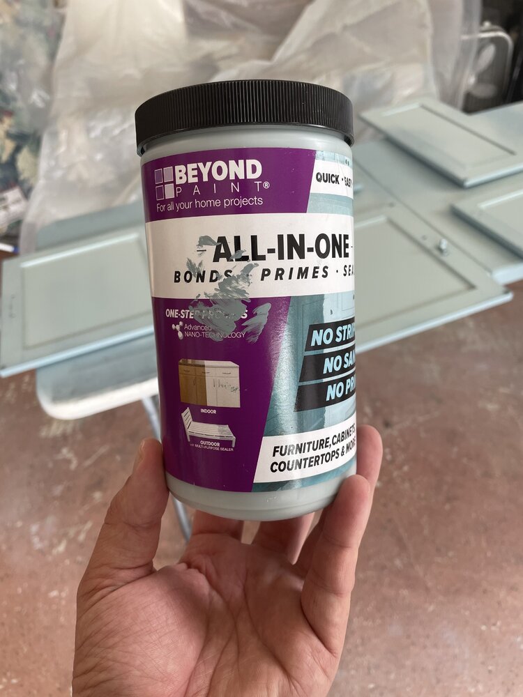

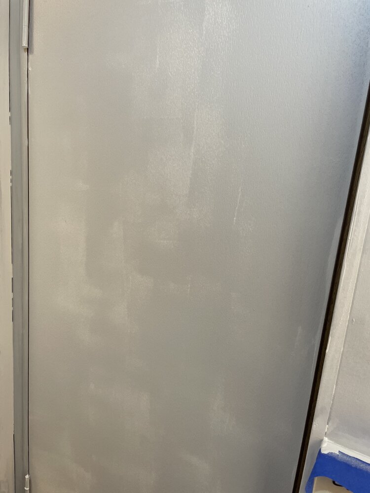

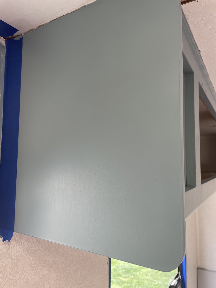

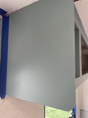

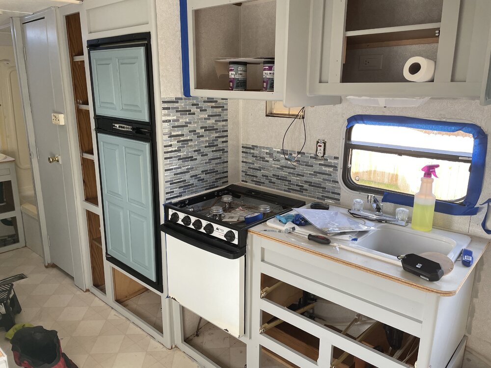

This is the paint we used. No sanding, no priming. Just clean the cabinets ready to roll.
You can see what a wet 2nd coat looks like vs a dry coat. It’s very forgiving and lays down nicely. We rolled/brushed the cabinet frames but sprayed the doors.

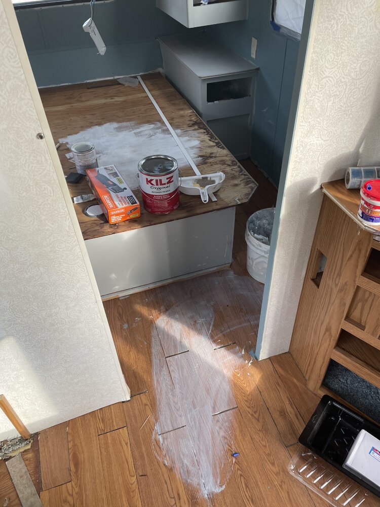

We are replacing the mattress anyway so it became a painting surface

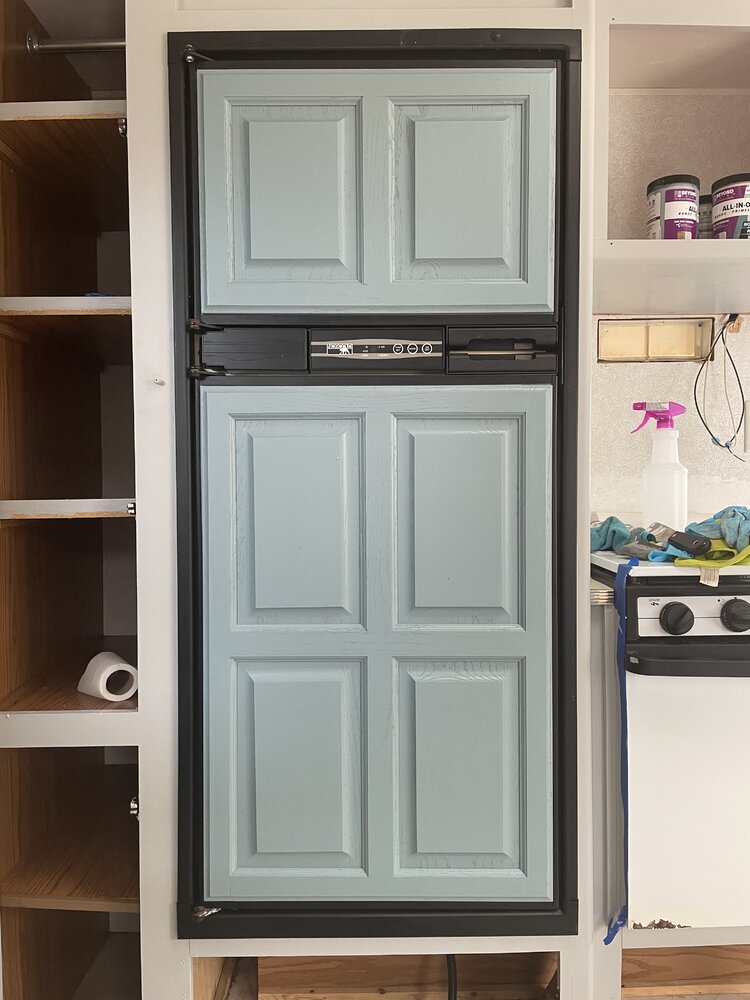

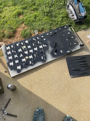

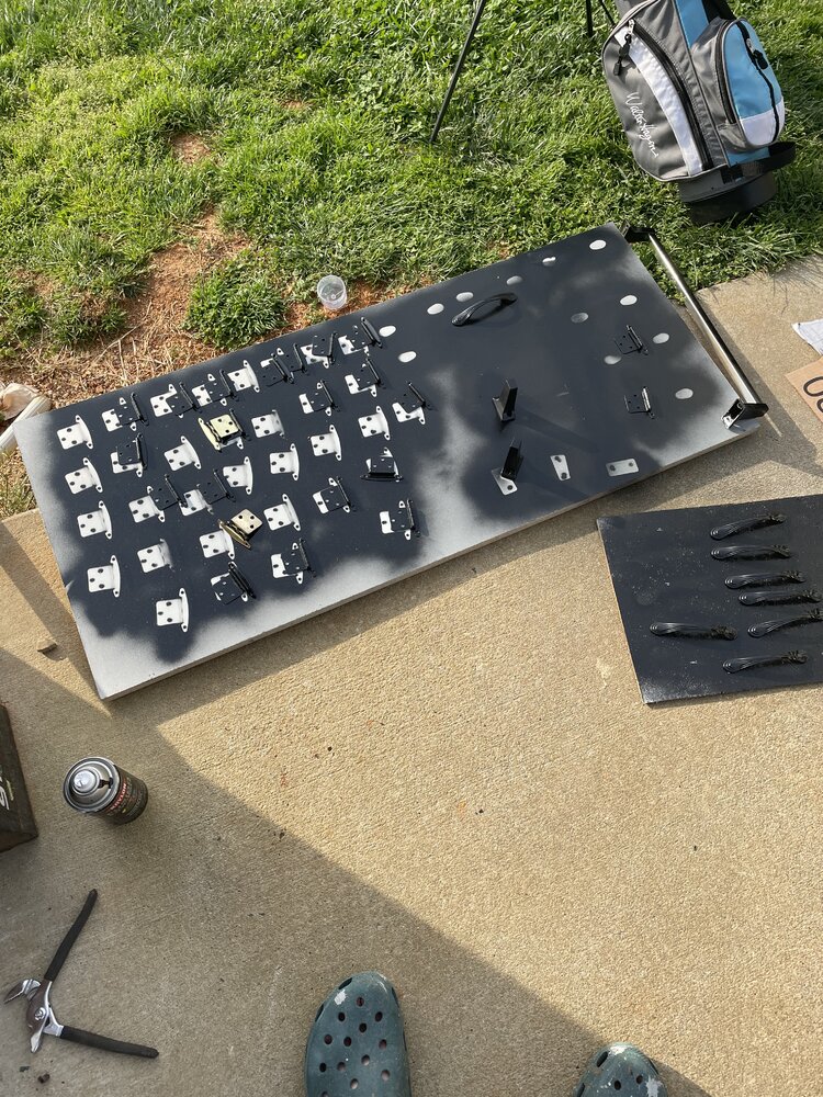

And I painted all the hardware, and will soon paint the oven hood as well. Started messing around with the backsplash my wife wanted as well.
Andddd I’m glad we planned to do the floors last, cause I dropped some paint
