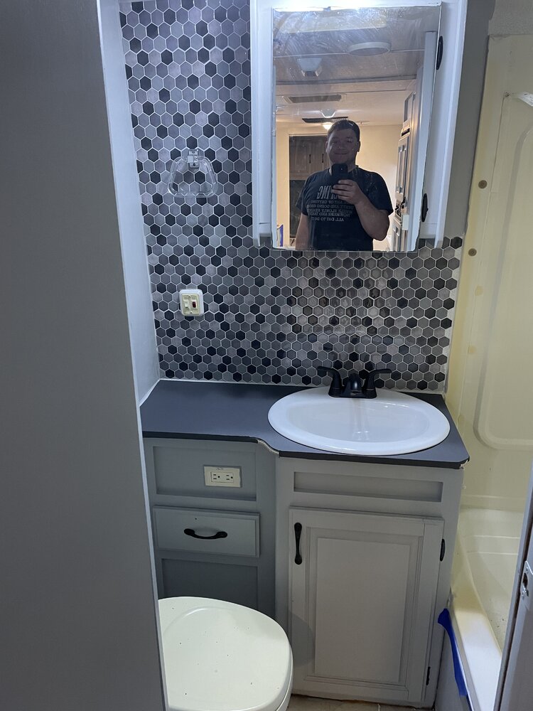

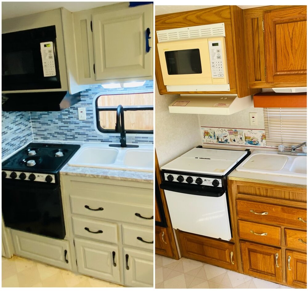

Pending getting some conversion fitting for the water lines, the kitchen is done. And painting the corner of the counter edge. Bathroom is nearing complete too. Pics to come
I need to rest. :shaking:
Bathroom is done, minus needing some plumbers putty for the drain. And the shower, which I dread dealing with.

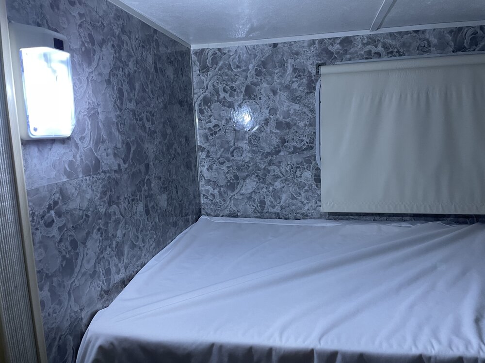

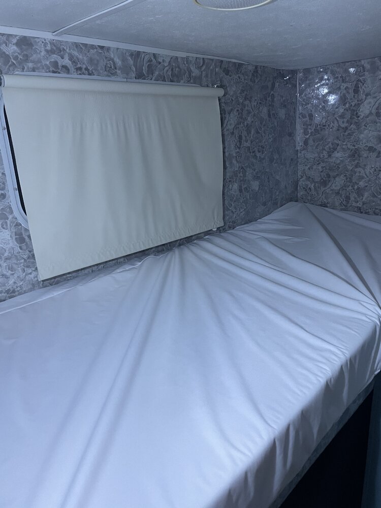

Got back in town yesterday and just relaxed. After church today we got right back to this thing and got a lot done today! The rear bunk beds are done with the contact paper on the walls.

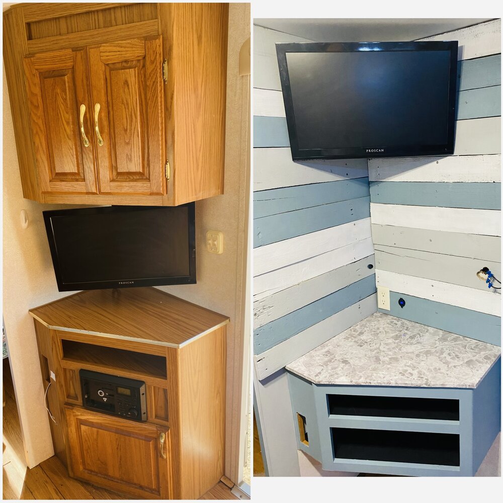

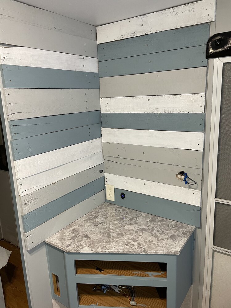

Pallets disassembled, cut to length and painted white, blue and gray the same as all the other colors. The kids helped paint these. These will go in the corner, placed randomly where the TV will be wall mounted and the counter top will be a coffee bar. Wife has already bought all kinds of decorations for that. If you haven’t watched, the YouTube link above explains things better. We are close, but it doesn’t look like I’m going to take it to The Ranch as I want to test it all out very well here at the house and not be rushed.

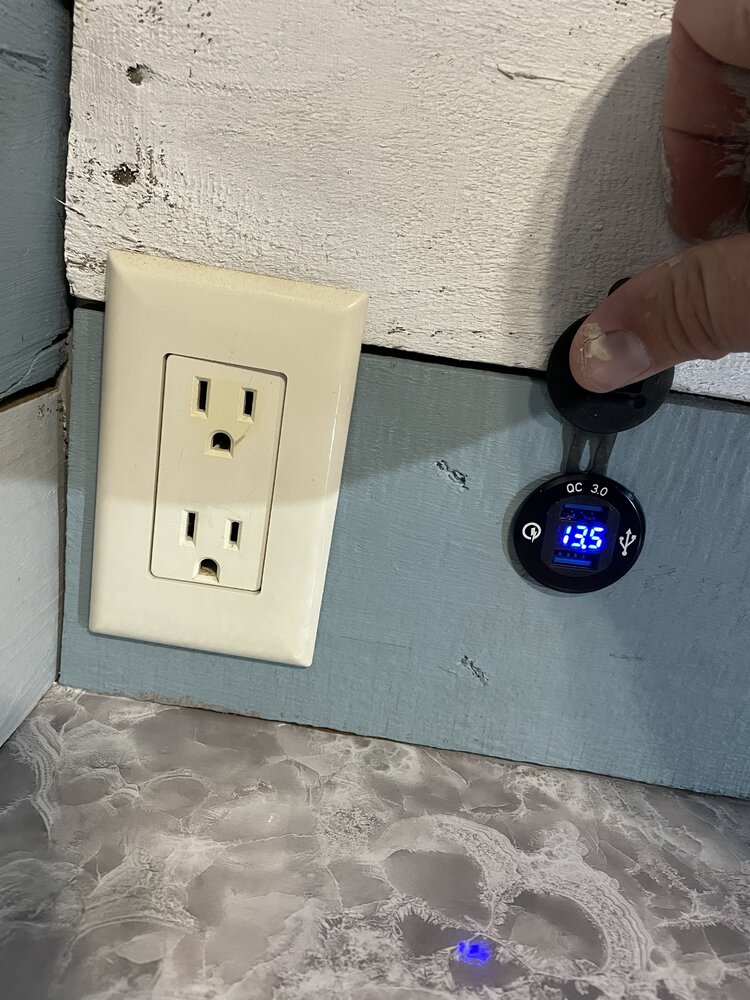

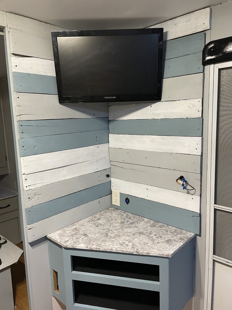

The corner TV and coffee bar thing is done minus the decorations. Since there’s a lot of 12V stuff, I bought a double USB port that also displays the voltage. I’ve had these in all my rigs for phone charges and voltage meter, once it actually saved my bacon in Harlan as I caught my alternator going in and out. But I figure this will be handy for charging phones and anything else USB and I can always measure the load and voltage on my battery.
Then the wife unit lined the inside of the cabinets with contact paper and I got the TV mounted. It swivels all the directions. I’m 76% sure it will be ok to ride there. 24% concerned.
The rear bunks are complete.

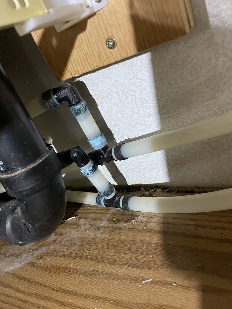

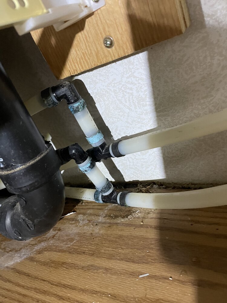

And if that wasn’t good enough, I have a 90° fitting above a T fitting cracked in the PEX pipe under the kitchen sink. It’s in an awful spot, not gonna be fun to fix at all.
if you use a ratcheting crimper with stainless rings it wont require as much room as a copper crimp ring. Might make it easier on you.
