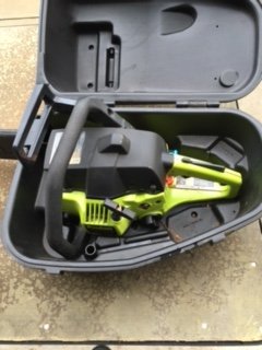

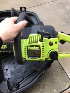

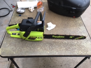

I believe I just got a deal on this saw. Yea it's not the best but hear me out.
Got it from a guy in Winston today. He said it didn't run right, rough idle, and would cut off after 10-15 seconds. It came with the plastic carrying case. I paid him $10 and left with it.
After I checked the spark plug, made sure it turned over smoothly, and didn't make any grinding noises, I put a fresh gas mix in it (40:1).
She fired on the third pull and ran for 10 minutes solid at idle!!!. She runs great! And now she starts on the first pull! I've never had a saw to start o the first pull.
Now for a new chain.

That's great to hear. I don't use a saw much so I don't need an expensive one. I think I came out ahead on this deal
