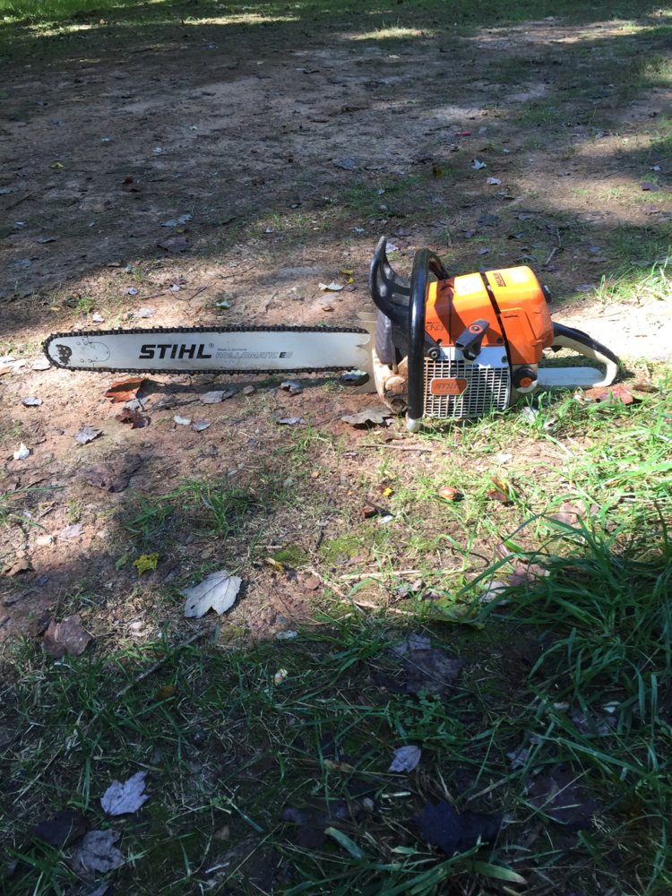

That's my ms440 with a 25". Power to spare so I think the weight is justifiable. The best investment I have made concerning chainsaws is the dremel sharpener attachment. Apparently, millennials don't have patience for files and such. I also have a 16" bar that makes it really manageable for bucking, uses 12$ chains and spits chips like a race saw.

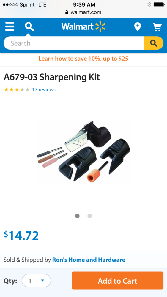

I use this kit on my dremel with the pink stone. Low speed to avoid heating your teeth and it works well. I do a 25" bar in about 5 minutes and no need to remove the bar or chain. I've never used a table top grinder though. @WARRIORWELDING
