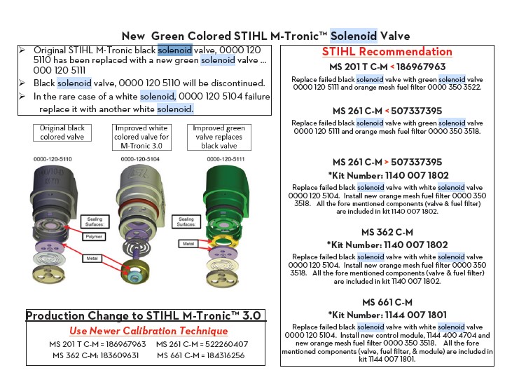

Mtronic saws are magic and I LOVE them because they are never out of tune, even adjusting themselves in the cut from the top of a log to the fat part.
