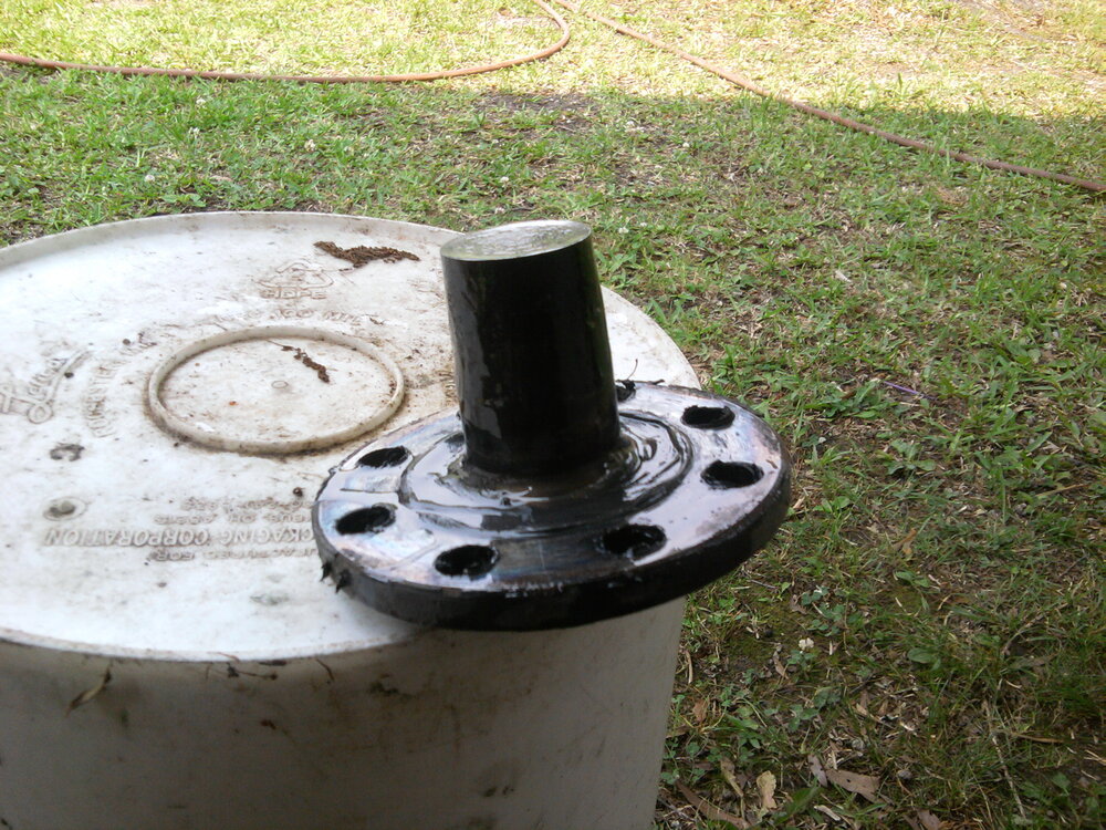

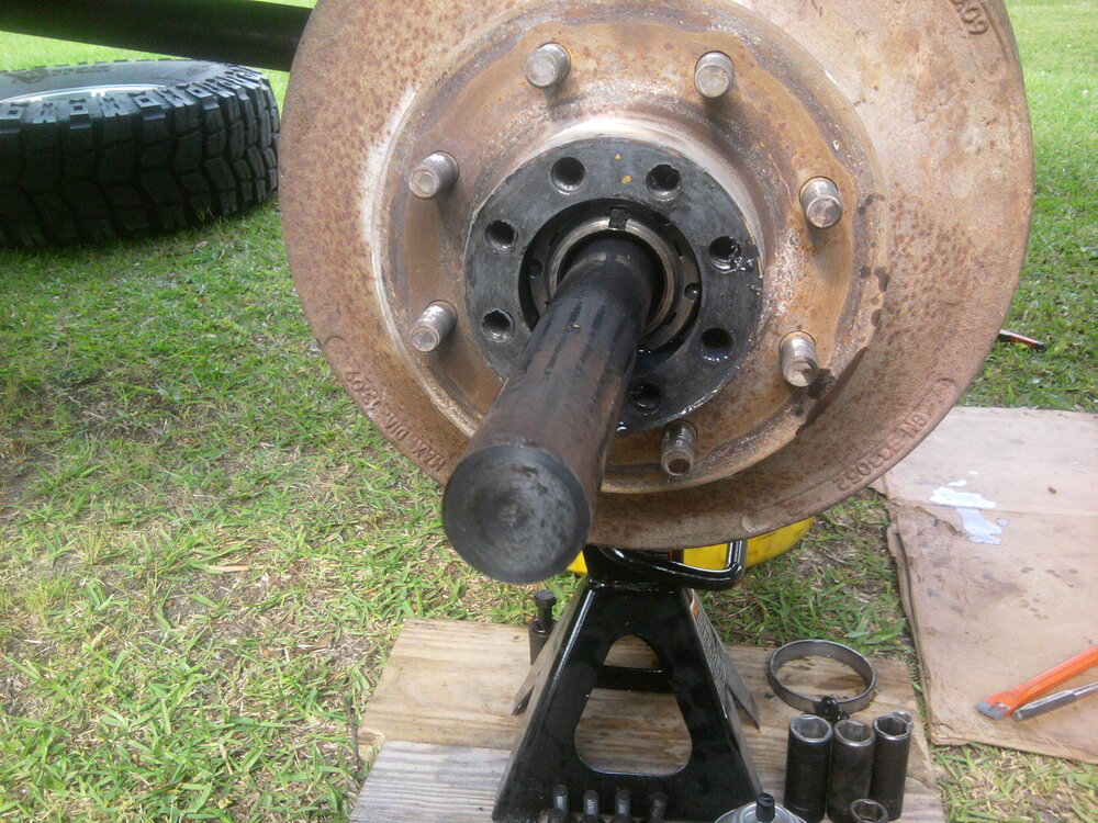

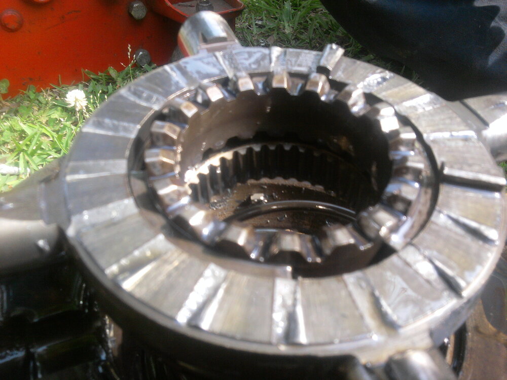

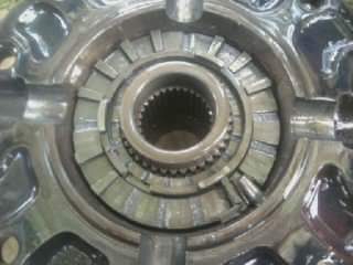

I don't have much of an opinion on which shafts to run, but I can tell (show) you what a shaft breaking will do to a Detroit! Or, perhaps, the Detroit broke and took the shaft out with it. Unsure, but the result was this. Granted, I was dragging a sled...
At least I had some spare shafts and it was a 14 bolt, so I just tossed it all back together with a new locker. Been fine ever since.
I seem to remember a rash of front 60 Detroits and shafts getting broken a number of years ago and a lot of guys swapping to a Lock-Right. I think there's a handful of similar ones now. Spartans and such? I seem to remember reading that if they ever broke after that, they didn't break shafts and usually got away with replacing the four drive/shear pins between the two halves.
Surely someone will have a better idea or say why that's a bad idea, but it's still an idea!
I don't think I have any 60 parts laying around or I'd offer to send them out to you.
Man, that sucks.
That crazy thing is I wasn’t beating on it hard or anything really. It popped super easy, I have video of it. The way the splines are twisted makes me think that shaft has been fatigued for a while before letting loose.
Time for some rockwells or axletechs :stirthepot:
Another vote for a spool
Detroit is garbage when axles break. Air locker or spool. I went through 3 Detroits before being a believer .
Pretty sure you or post on here are the reason I have a lock right in my front 60. I have seen way too many Detroit's and other "case" lockers over the years go boom when they loose and inner axle shaft. For the record I have never broken my D60 lock right pins. I have bound up a cromo shaft and snapped it like a twig though. I would recommend a lock right all day long.
I'll put a case of beer down as to the next thing that breaks
