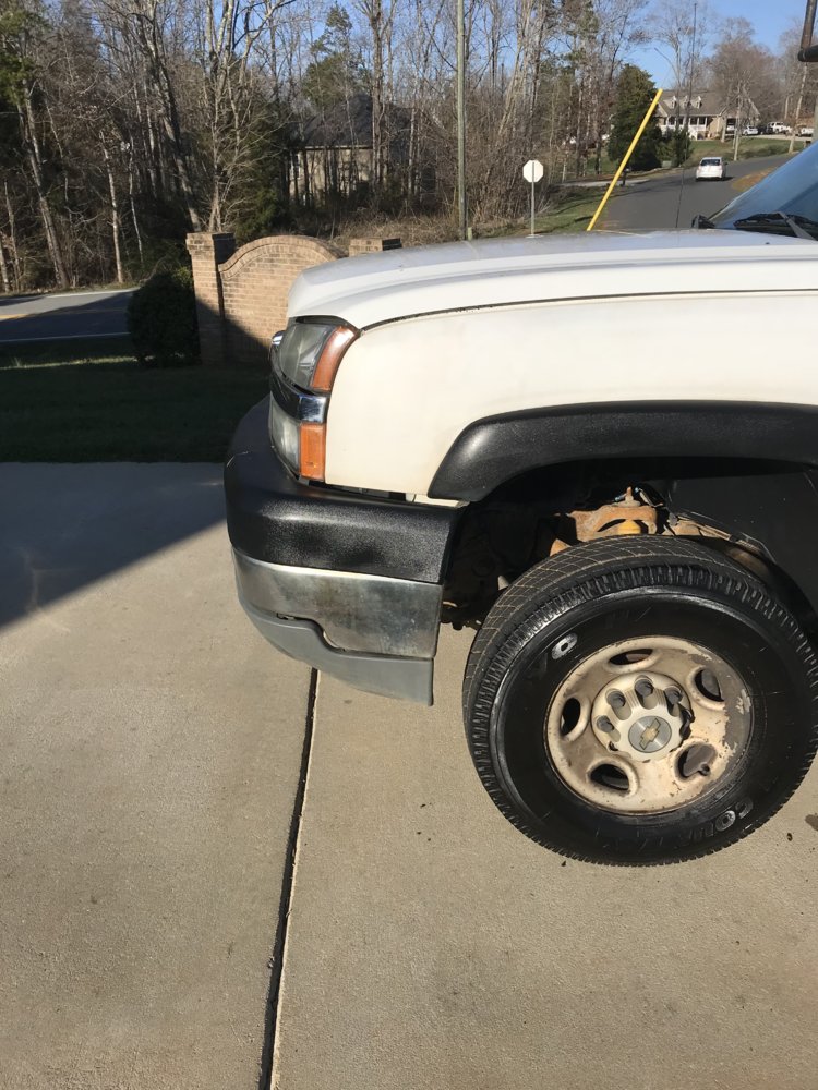

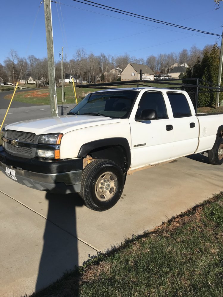

So today I cleaned this thing up a bit. Took all the stickers off and washed it good. Amazing what soap and water and some good tire shine will do.
I was also able to straighten out the front bumper which made it look a whole lot better.
Still undecided on keeping the ladder rack. @Chris_Keziah turned me on to a cheaper camper shell I want to get this week maybe.

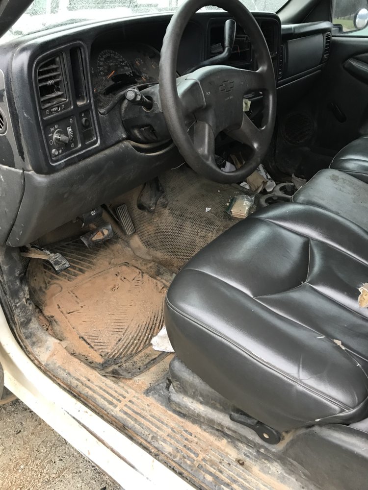

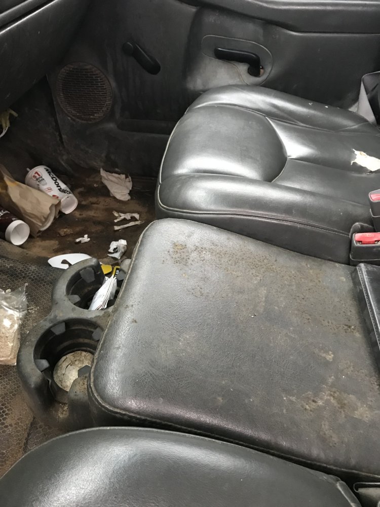

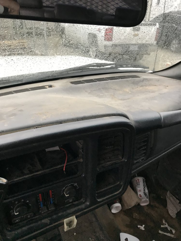

Here is the inside. Amazingly the seats are not real torn up. Just a few spots. I drop it off with my detail guy Wednesday evening. He is going to pull the seats out and clean it up. I will post some finished pics when I get it back.

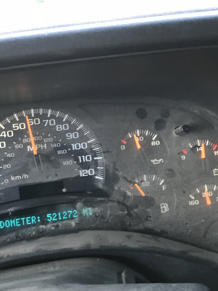

First of all I need to address one thing, it seems to have low oil pressure. I need to check with a mechanical gauge first, but if it is low I will drop the oil pan to check the O-ring on the oil pickup tube. Apparently it’s super common on the LS engines to cause low oil pressure.
nothin wrong with a cheap tow rig...been polishing my turd since 2008. Now I have a new engine,new seat,new headliner,new floor cover installed last year and now a new trailer. I still have less in my setup than alot of folks have in a daily driver much less a truck to tow with. Rock on my friend...rock on!
It's possible the o ring is the issue...if I was going that far, I might would go ahead and do an oil pump and maybe timing set too. Make sure you get the red o ring.
What's the oil pressure now?

refrain from just hosing out the floor and under the seats, the control module for the air bags is under drivers seat and NOT water proof. i worked on a few that had to have the modules replaced due to corrosion and water intrusion . Not cheap if you want to keep air bag function.
I never like to just hose them out since any opening allows water to be trapped and be in the insulation under it and cause rust. My detail guy will do it right I’m sure.
@Croatan_Kid it has 20psi at idle and barley seems to go up with throttle. I should have tags tomorrow/Tuesday so I will drive it again and see if it goes up. It seems like when I test drove it, it had closer to 40. The valves chatter at start up then go away in a little bit.

The rattle at start up is probably piston slap, but as long as it goes away, you're good. I'd definitely do what you were saying and check it with a gauge. You might even try a simple oil change...you never know. Obviously it can't be but so many things!
Check the actual oil as mentioned and change it out for cheap insurance, but it very well could be the sender in the back of the valley or the screen before the sender is clogged. This can cause slow gauge response and low reading. Much easier than checking pump oring and also very common issues.
I’m going to start with those simple things first. Oil change for sure. I will check the sending unit first though. Dropping the pan is pretty simple since it is 2wd, so I’ll probably do that when I change the oil. If the sending unit doesn’t change anything.
I did read that the oil pressure I’m seeing is pretty common and most people aren’t too concerned with it. I’m still gonna check it out since it’s not too much trouble. I enjoy tinkering with it.

Drove the truck to my detail guy today. Oil pressure came up to about normal when driving. I will change the oil this weekend. Can’t wait to post the pics after cleaning the inside. I took a video too but can’t upload it. I’ll put it on Facebook though, mostly just to help my detail guy out.
Normal would be 25-30 psi at hot idle and 55-60 psi driving. If you were idling and going 56 mph, then that's perfect :D

Yes the detail guy has some work to do. His wife helps him, and said when I dropped it off she’s been dreading it all week. She said the rubber floors are actually more of a pain than carpet.
