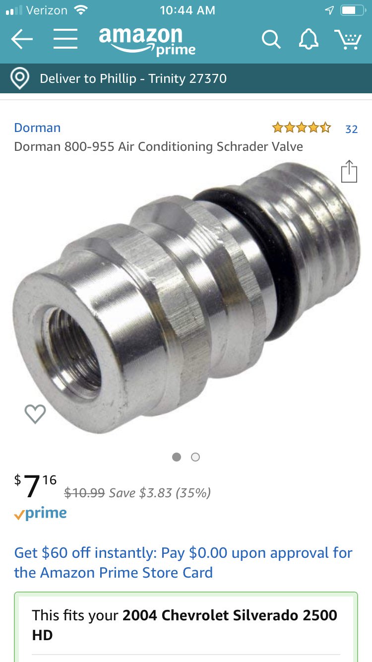

Yep, but I said it wrong. It's a low side fitting. At any rate, it makes it where both high and low have a Schrader valve and are MUCH less likely to leak.

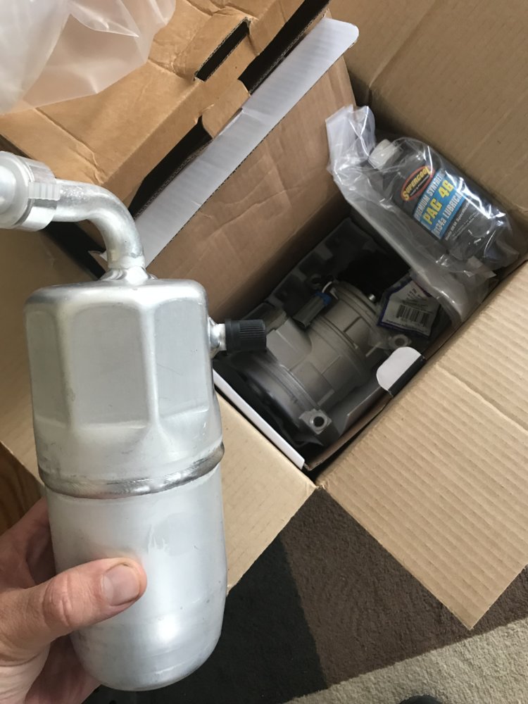

Props to @RockAuto for some fast shipping, and most of all, excellent packaging! They had the compressor and drier packaged in a box and into a larger box with padding around it, and a ton of padding within the smaller box to protect it all! I appreciate that. I didn’t open the condenser yet but the box is in good shape so I feel good about it.

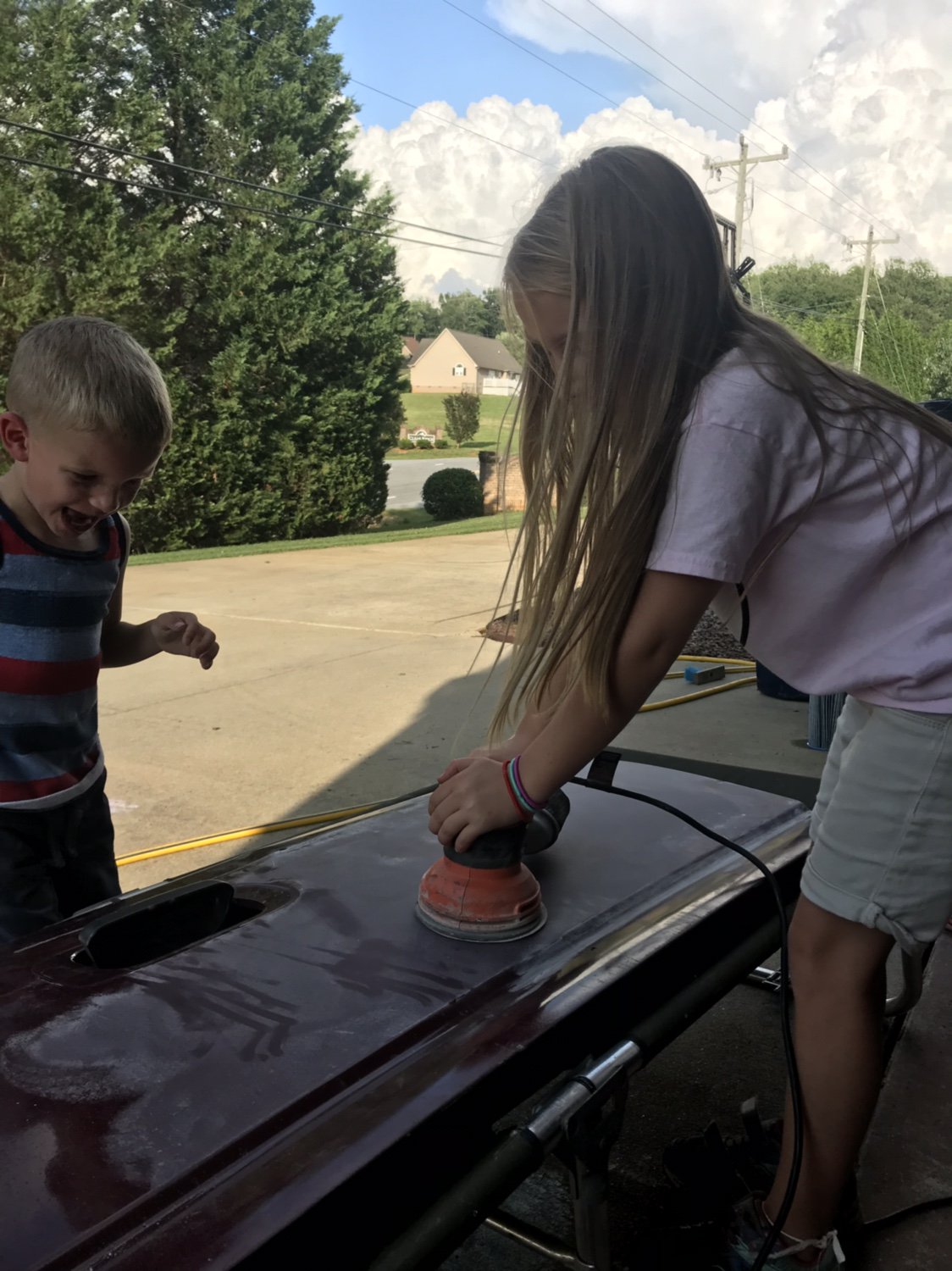

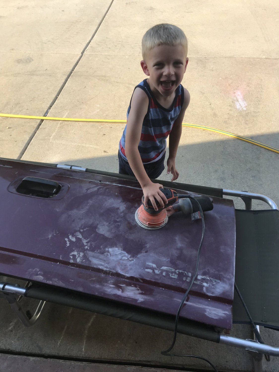

Needed a little help with sanding...

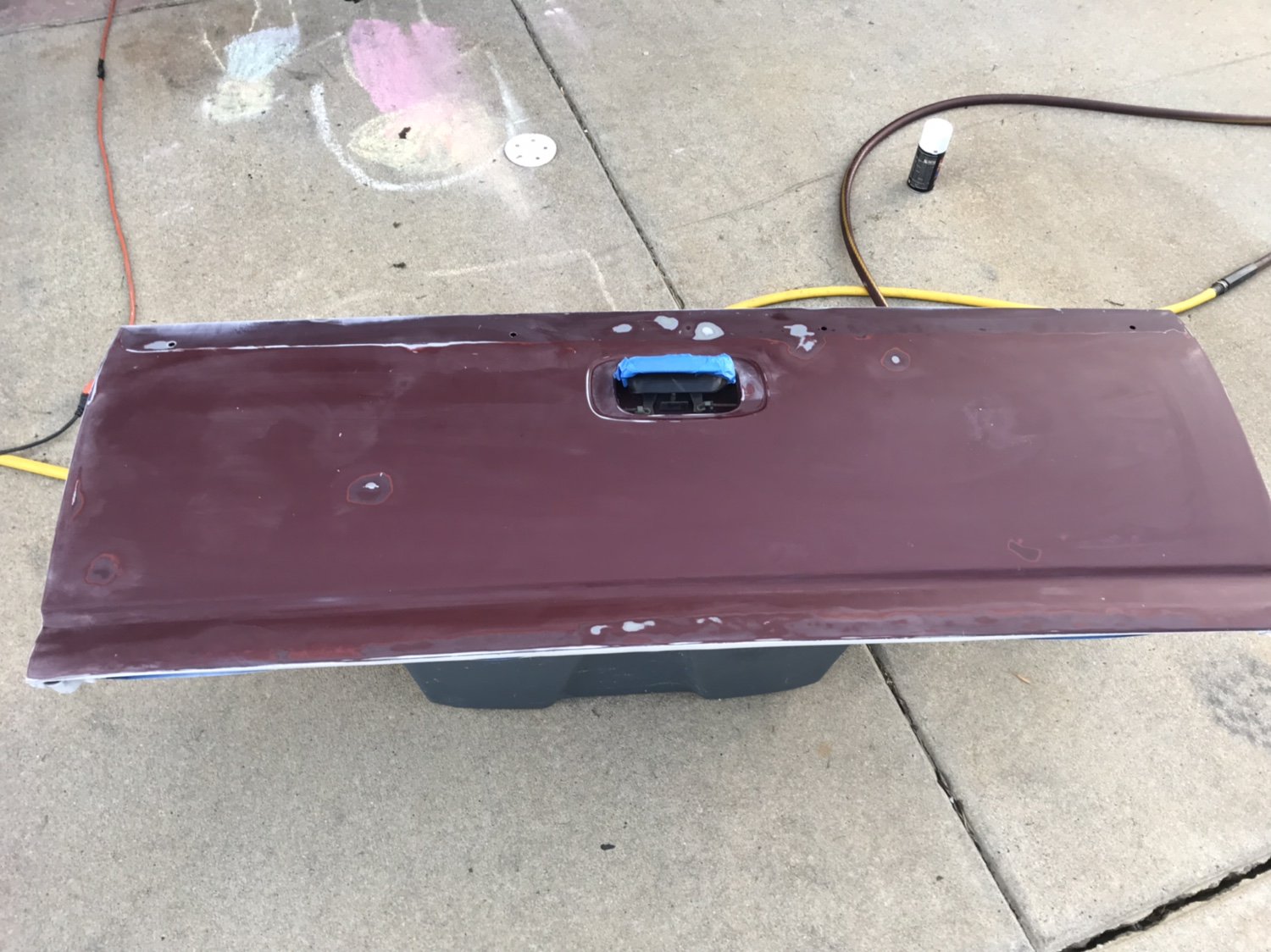

Got it all sanded smooth, was really just worried about sanding the clear off. I bought some bright white from oriellys, they let me carry several cans out to my truck to see what matched the best. It’s still gonna stand out, but not nearly as bad as burgundy did!

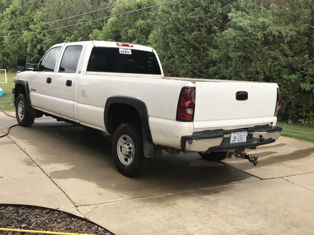

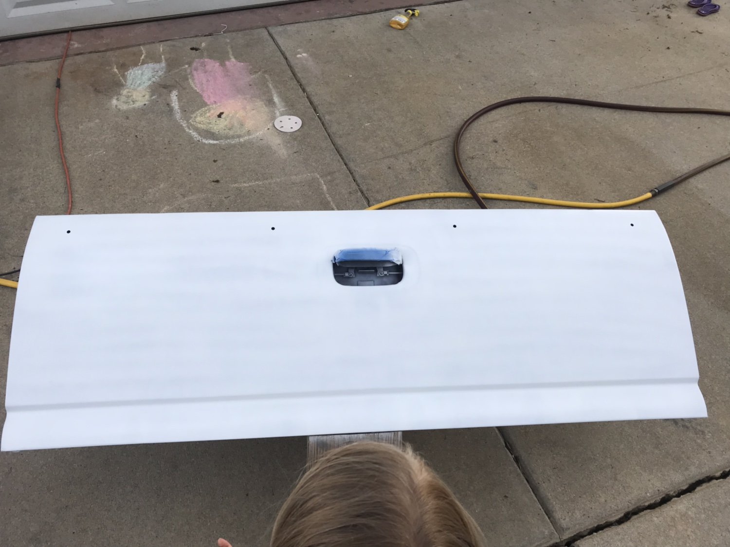

Turns out 2 cans wasn’t enough. I need another can, maybe even 2 more. I can see the streaks in it, downside of spray paint. But hopefully another coat will hide it for the most part.
And I knew that @Croatan_Kid wouldn’t be my friend no more if I didn’t get a tail gate bezel, so just for him I also picked one up today for $9. I’ll throw another coat on and snap the bezel on tomorrow.
Can’t decide if I will reuse the emblems I took off, just go without them, or order newer body style one from Amazon. Decisions decisions...
That's just because the rest of the truck is grungy :D
The tailgate definitely needs some kinda decals back across it.
Yeah I think I’m gonna go with a a black “Chevrolet” sticker across the back, should help take the focus off the fact that it doesn’t match at all.

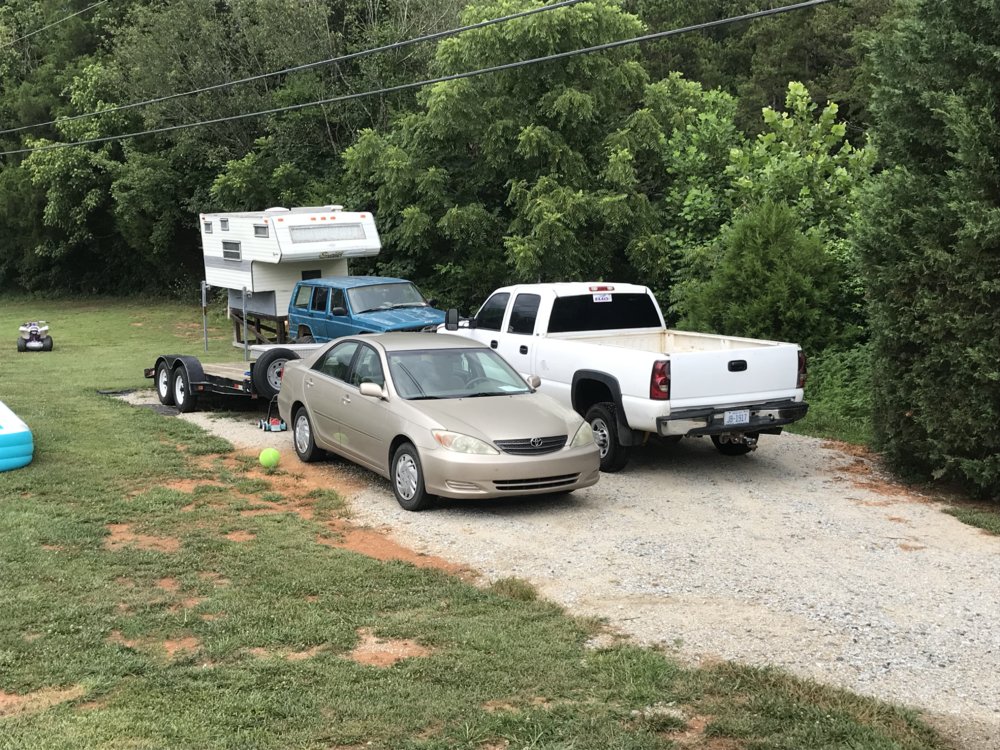

So I just came back from a 4 day trip to Potts Mountain with my whole family. We took the YJ, the camper, and lots of gear. No idea what the weight was but the truck handled it all great. I knew the camper would hurt my mileage but it was worse than I thought at 7.5mpg. I didn’t need fuel on the way back so I haven’t checked the return trip but I know it was a bit better coming back.
That is some sucky MPG, but at 5-7 trips a year I’m still ahead with no payments!
Having the camper is a game changer! My wife loved it, it made everything so much easier. We were even able to put my son down for a midday nap in the AC.
