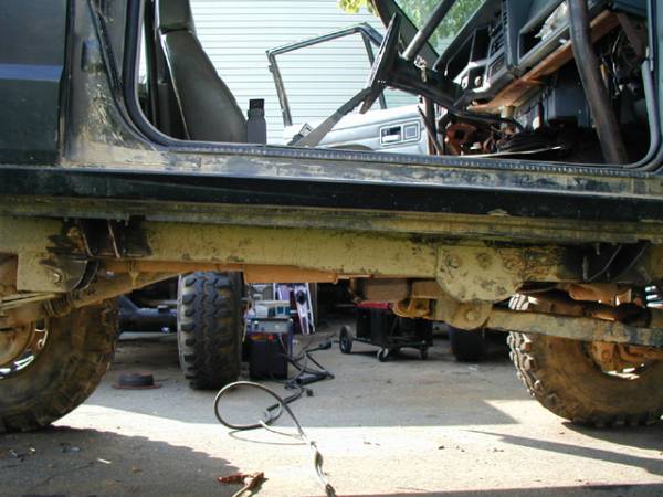

Smaller tires and a 44 rather than a 60, but here's what me and a buddy did to his. Unibody sleeved in 3/16 wall C-channel. Plug welded every 6 inches and a 2-3" stitch every 3-4" accross the top of the channel. The cage tie ins made the biggest difference. Makes the chassis so much more rigid and let's the suspension work.

With the cage bolted through the unibody(6 points) to mounts welded to the sleeved section of the unibody we haven't seen any cracks yet. It's been done for 2 years now and beaten nicely. There was a problem with the tracbar mount coming loose up front. Bolts kept backing out, that is until I ran a ~2" stitch down each side of the bracket to the UNIBODY.

I mean w/e welding to the unibody may be sketch, buuuuut pretty much everyone does it, and I have yet to see a situation where it cause's problems.
Besides if it does cause problems you can just weld more metal to it.
I don't see the unibody failing being an issue at all, because it takes bout 10 minutes, a few peices of metal, and a welder to fix :driver:
