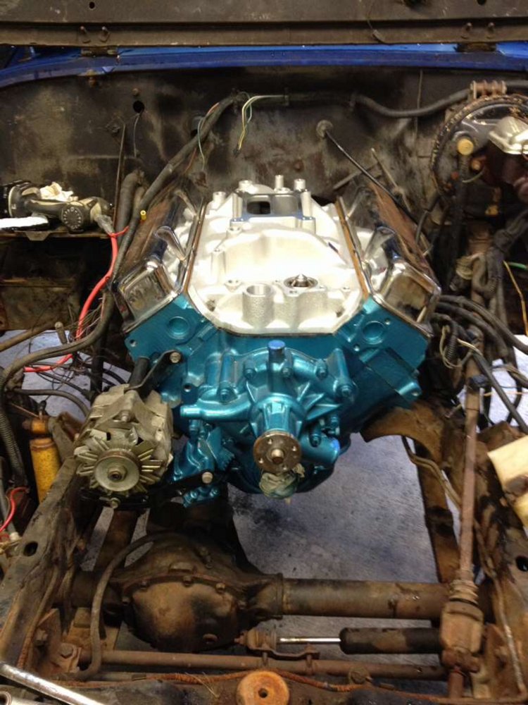

Well this thing has just been sitting and I finally got sick of tripping over stuff in the garage so I dropped the long block in the frame yesterday. It's a little off center I need to adjust the right side motor mount. Still need to pick up an intake and start putting accessories on the front of the motor.

I sand blasted the alternator mounts and painted them black, installed the intake manifold and threw a thermostat in it. I also sandblasted the crank dampner and all my pulleys and painted them as well. I started making a parts list and decided to call it a night. More to come soon should have the motor fired in a week or 2

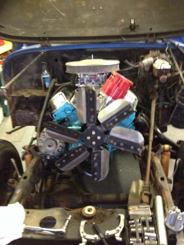

On that note I just picked up carb studs, radiator, and an hei billet distributor for this thing so hopefully this weekend I'll be able to get all my pulleys on, the radiator installed, distributor in, carb mounted and a few other little things done.

Mounted pulleys, fan , distributor, and carb than I yanked the motor back out so I can mount my transmission and transfer case.

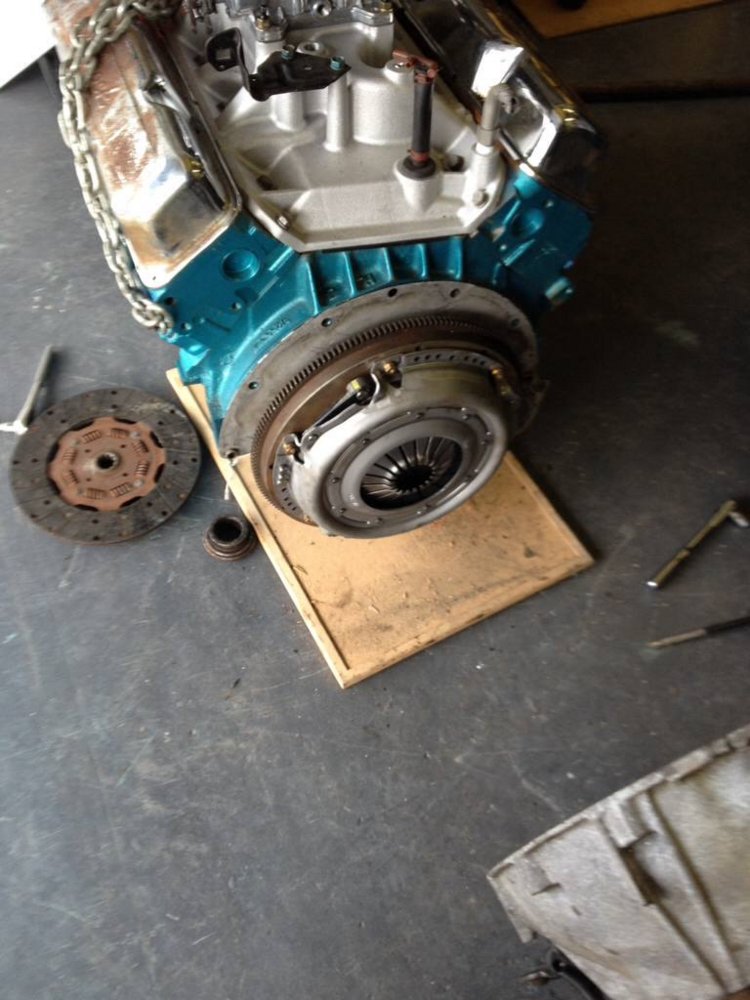

On that note I ran into an issue with the bell housing. I thought I was good to go but turns out I had the wrong case. I snagged the right one and machined the bearing retainer on the lathe rather than rebore the bell housing. Than I used a piece of poster board and transferred the bolt pattern to the new bell housing and drilled the holes on the drill press.
I had to order the pressure plate and pilot bearing but I had everything else. So when I finally get my pressure plate delivered it'll all go back together and back in the frame rails.
Ok so pressure plate finally showed up. So I put my clutch on. Had to turn down a Chevy pilot bearing on the lathe to make it work.

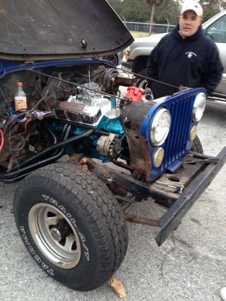

Than I rolled the jeep outside and used the fork lift to slide the drivetrain in place. I put the grill back on and tossed a couple bolts in the headers to check how they fit. I also dropped the radiator in place.

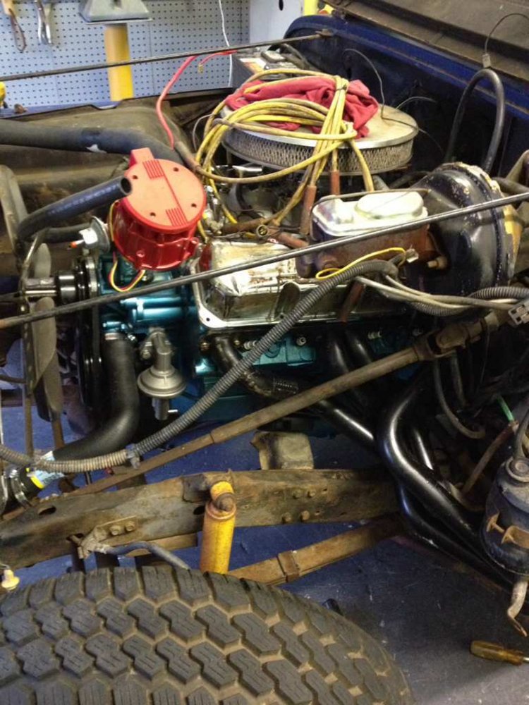

Worked on it some more this afternoon. Put the starter on, both headers, spark plugs, and both fenders, and I was playing around with a grinder and my skid plate. I think I notched it just enough to clear my transfer case if I put a little spacer on the frame rails before I put the skid plate on.

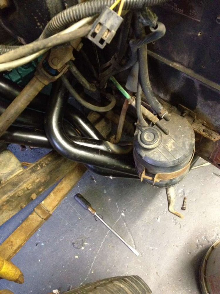

I had to heat up the drivers side header and massage it a little bit with a hammer to clear my clutch linkage.
Starting to look like a jeep again!
They are headman headers. Picked them up on Craigslist for like $100.00 new in the box.
Alright I finally finished buttoning up the engine and fired it up. Thing sounds great I took a video but I got a new phone and can't figure out how to upload it via tapa talk. Does anyone know how to do that with a galaxy s4?

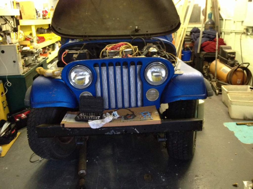

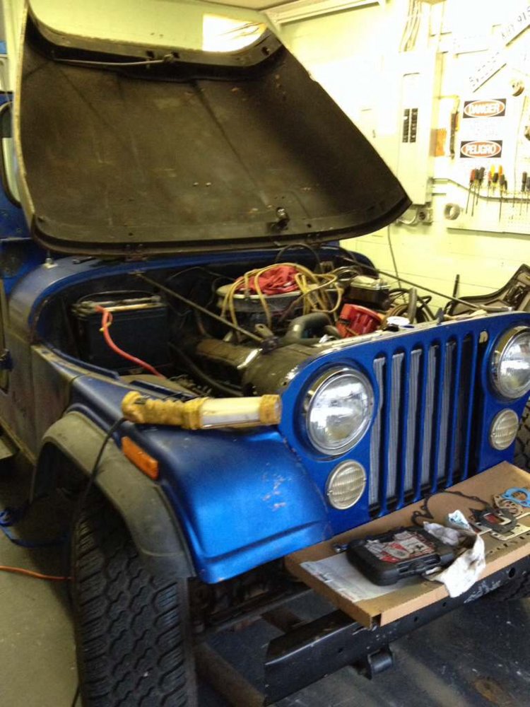

Rolled it out of the shop tonight to make room temporarily for another small project.
Pulled the gas tank out to inspect it and make sure it didn't have any bad fuel so I don't trash my fresh motor. Replaced the sending unit and should have it tucked back in there tomorrow.
Still need to sand blast and paint the mounting brackets for my seats and install them. I need to swap out my steering column for a used one in good shape kicking around the shop, and start tackling the wiring. So far I've got a head light and both tail lights that work. Need to make sure it'll be road worthy. Some of the 36 year old wiring needs updating/replacing.

MIght want to consider just taking all the old wiring out and ordering a new 12 circuit one. Would be much easier, not to mention safer and more reliable.
Thanks for the advice I'll look into it.
