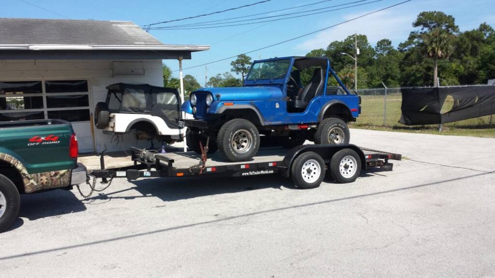

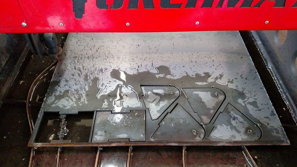

Tomorrow the jeep is getting trailered to over the top off road and they are going to fab me a transmission cross member and skid plate. When I get it back from that it can get dropped off to have my custom shafts made so finally it can move under its own power.

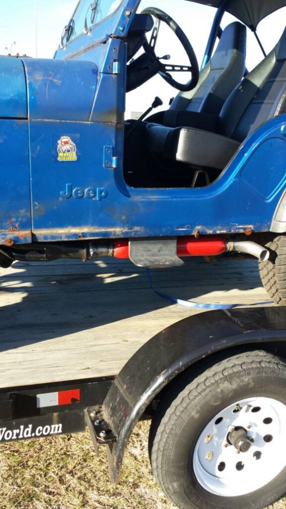

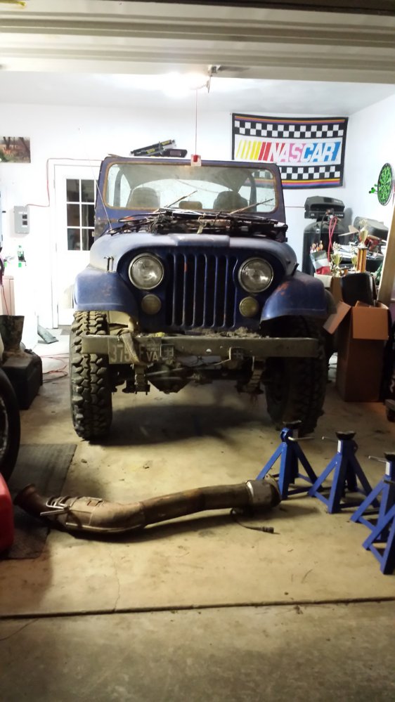

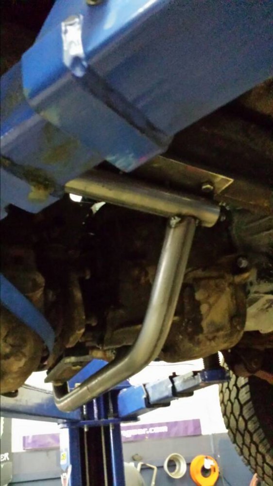

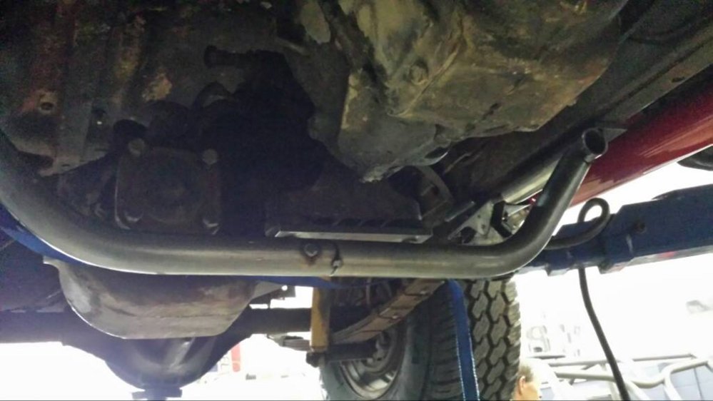

Put a cheap exhaust on the jeep yesterday and dropped it off at over the top offroad for the cross member. I might have then put a blue torch fab stretch kit on it and run xj leafs for 6 in stretch. If I do that I'll have to mount a fuel cell in the back. But 6 inches would be nice for drive shaft length
Over the top offroad fab building me my transmission cross member.

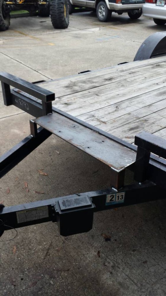

Built a winch plate for the trailer. I have a warn 5k I'm putting on it.
Well I made a decision to ditch the np205 case and go back to the original Dana 20 and refresh it and do a twin stick. I have to order the adapter kit from advanced adapters because right now it's a lot cheaper than stretching it. I wanted to drive it so I welded up a front drive shaft and put it in. My hubs were locked but not catching so I pulled them out and cleaned them and put them back in fired it up and it worked. I took it for a ride in front wheel drive. Have a video but tapa talk is smarter than me so I don't know how to upload it.

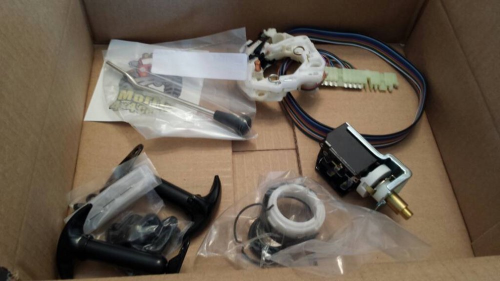

Well I got transferred to Virginia again so I am now back to living in my house with the wife. Put some antique plates on the jeep. I've driven it to work a few times and came up with a few things that need to be replaced. Steering column bearing, headlight switch, directional switch, and new hood latches so I put in an order at Morris 4x4

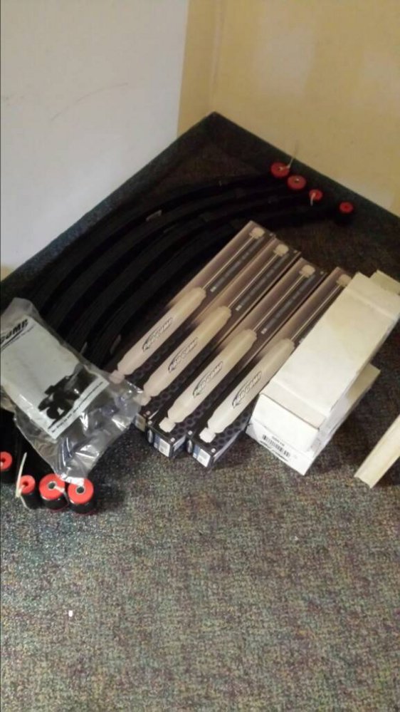

Just picked up this 4" pro comp lift for the jeep with es9000 shocks hopefully have it in sometime this week.
Swapped the original 3 speed back into threw some drive shafts in it. Than I installed the 4" pro comp lift and now she's loaded up for a shake down run

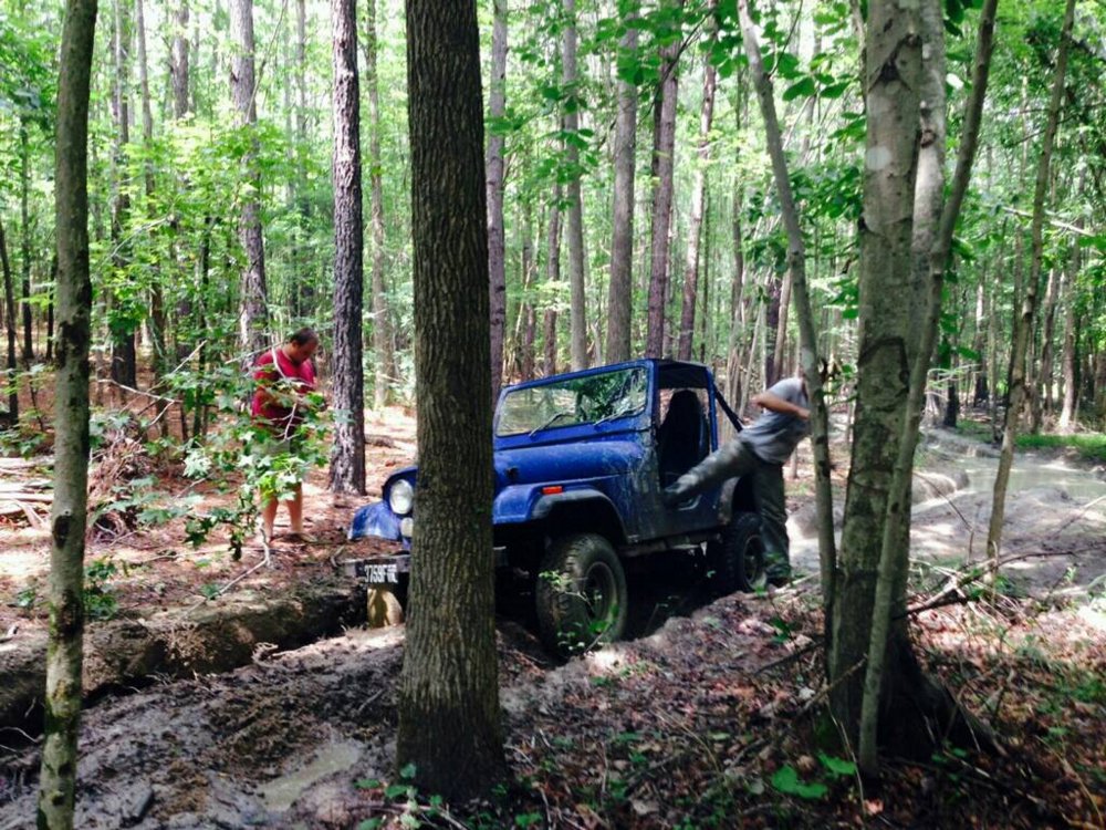

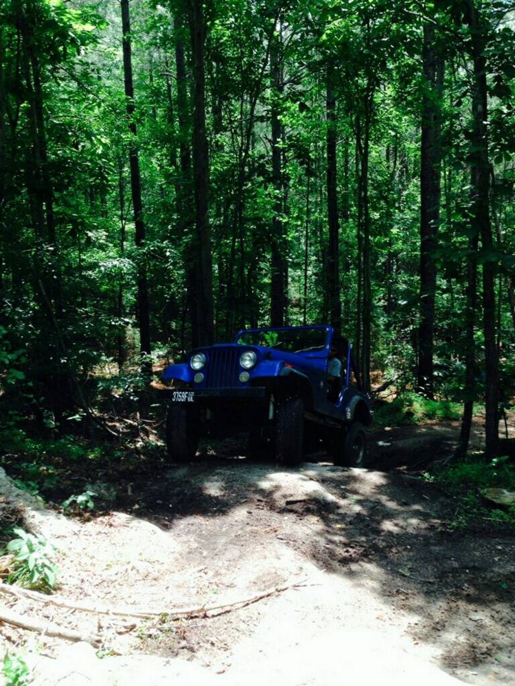

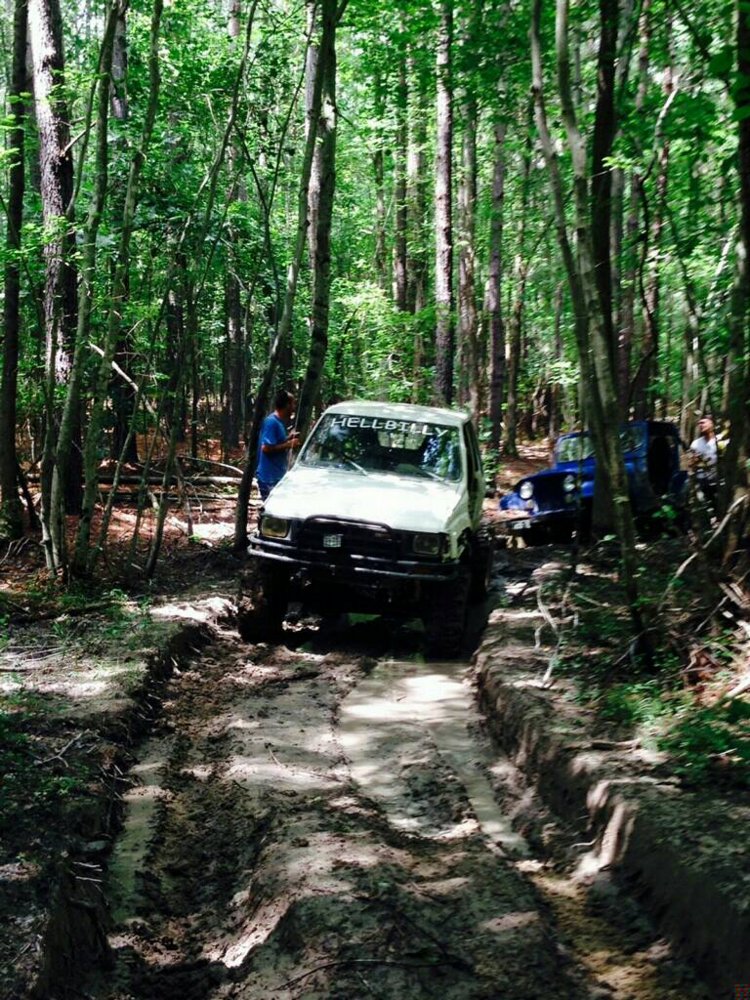

Here's a few pictures from yesterday wheeling in luisburg. I have to work out a few kinks but overall it did well
Well took it out last night and looks like the tranny is coming back out. It's stuck in 2nd gear I believe.

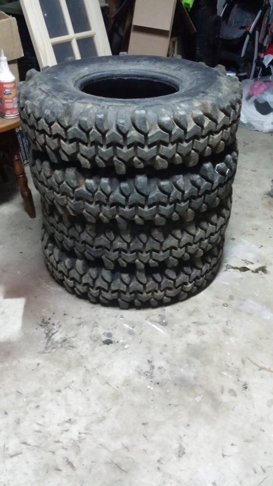

Ok so I rebuilt the transmission and its working great. I picked up some 34x9.50x15 super swamper ltb's and they seem to be a pretty good fit.

I'd post up a pic of the new tires but can't seem to get it to upload.

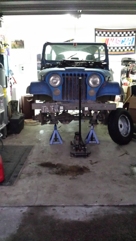

So I got the tires home. I threw the jeep up on jack stands and took the wheels and tires to work with me and swapped the tires on to my stock CJ wheels. I threw them on when I got home. They look like a pretty good fit for how it sits as of now. I haven't had a chance to take it out yet. I did notice that 3 of the 4 aren't holding air (dry rot) so I bought some tubes from production offroad in VA Beach, VA to solve that problem. I also got a marine radio for Christmas to toss in the jeep but haven't gotten that far yet.

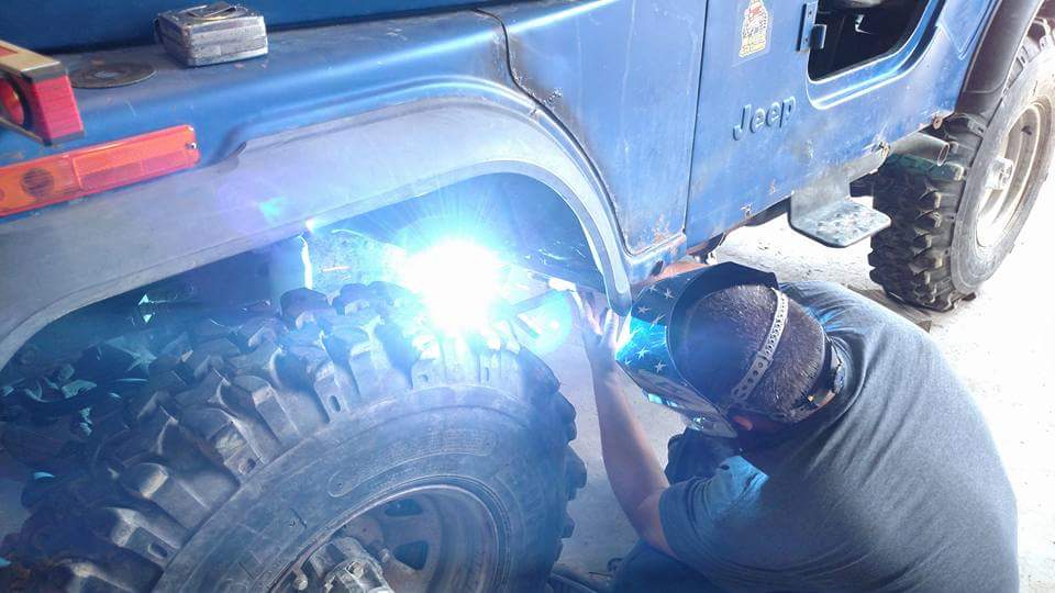

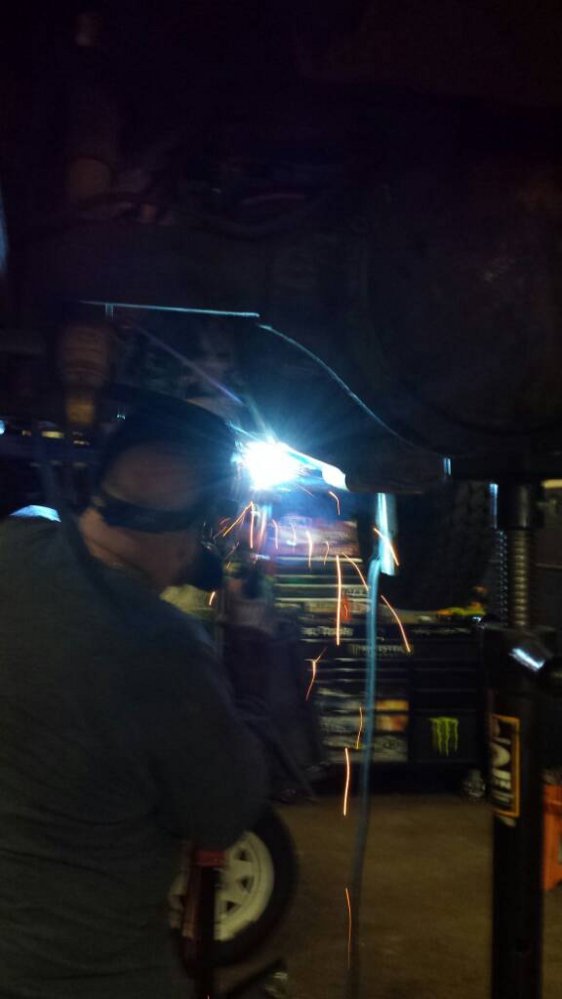

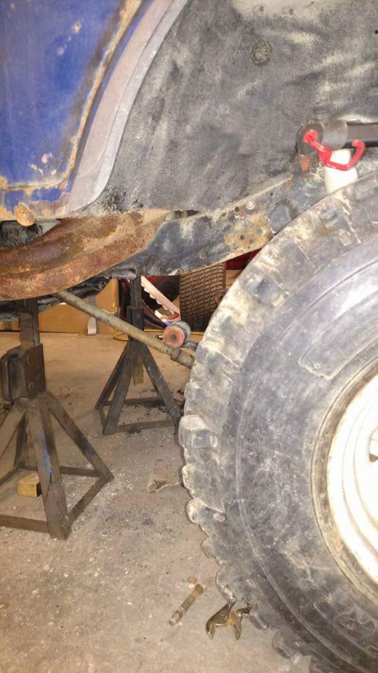

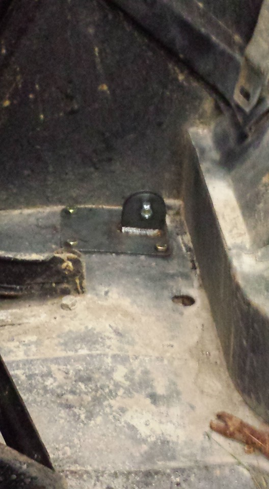

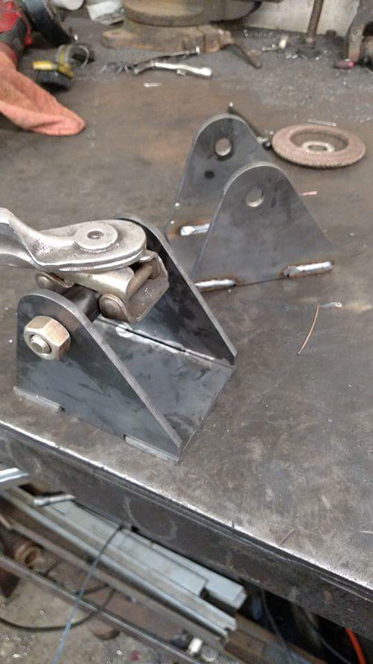

So the 4" lift that's on the jeep is a procomp and rides like hell. The front shackles were inverted and every time I try to crawl up on something they would flip back and hit the frame. So I took the jeep to a buddy who does fab work on the side and had him hook me up. He moved the shackles forward a few inches and stretched my driveshaft. Here are the pictures.
Cut the old shackle mounts off.
Cutting out some new mounts.
Welding them up.
welding them on the frame.

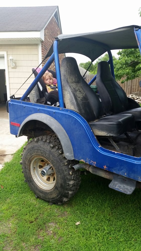

After Alex got it all together and I got it home. I took my 1 year old daughter Haleigh and my Wife out for a cruise. It was my daughters first time riding in a jeep and she loved it.

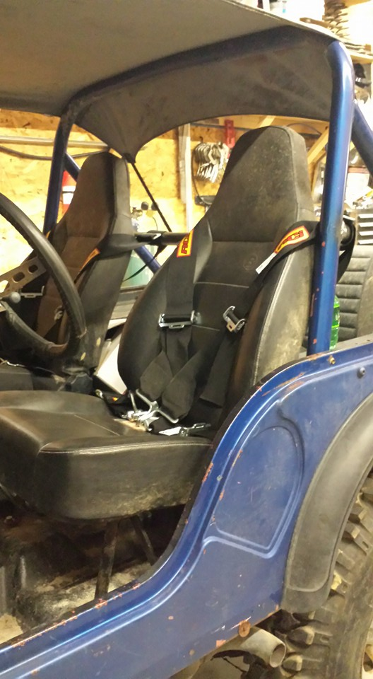

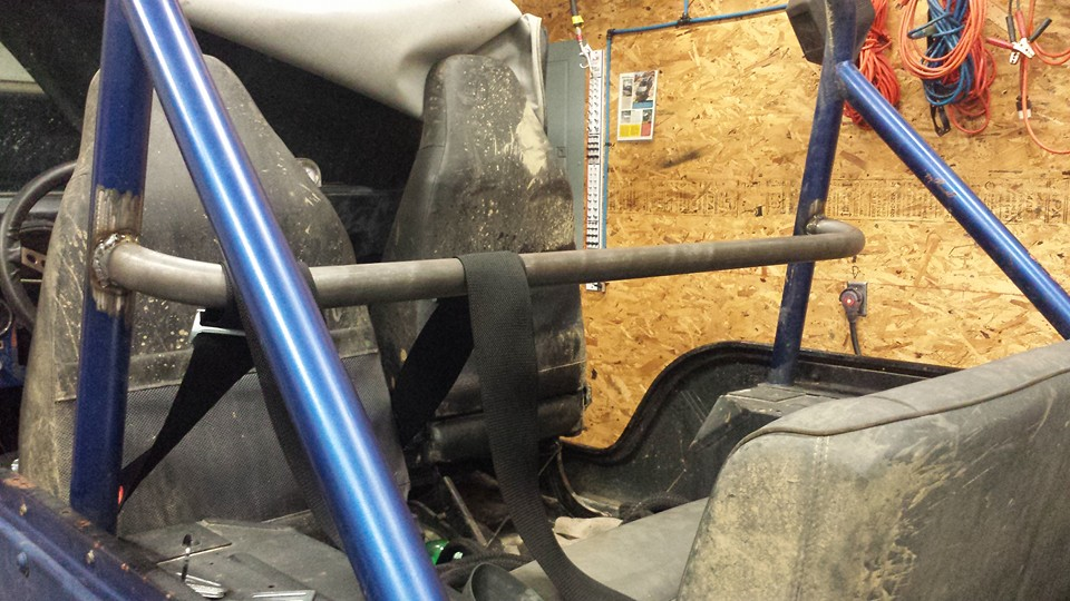

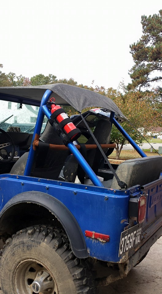

Jeep has been running great and I've done a little wheeling here and there but my wife didn't like going because she didn't feel safe. So I bought some harnesses and called up my buddy to help me fab up a bar to mount them to.
bar for the shoulder straps.
brackets we made for the lap belts.
finished product.

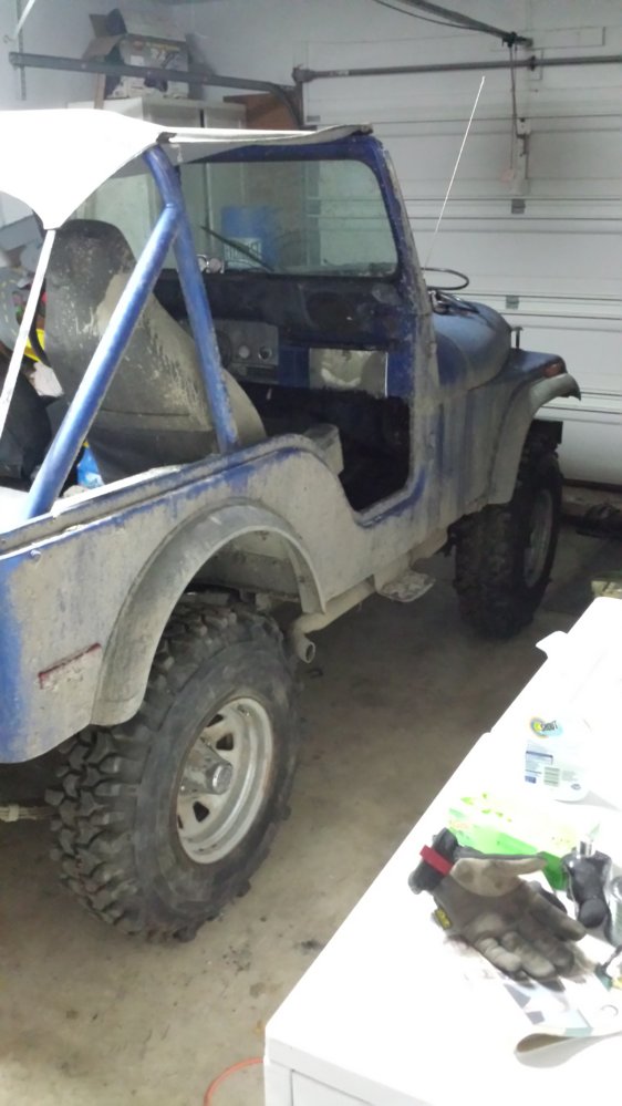

Now the wife feels safer to ride. This is only a temporary fix until I can get time to build a full cage with suspension seats.
Than I figured with this being an older jeep its probably a good idea to have a fire extinguisher handy, so I bought one and tossed it on the roll bar where it's easy to access.
Don't mind the harness bar it rained before I had a chance to throw some paint on it.
