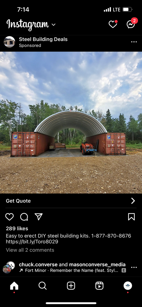

I snapped this screenshot the other day. Idk how cost effective this would be over a regular building but I would like to have something like this in time to put the truck and such under. Could add one across the back too. For me the value would be that I could do this in stages. The containers are useful from day one.
I need a forty footer and a engineer to lean on to design me some trusses and I'll do it Johnny Cash style minus the thieving, :D
I would straight up be a guinea pig for mutual ideas because I'd love a lean-to off the side of mine to park my BIG trailer and dumptruck under.
I'd love some welded "pockets" to support a 2x8 for a header so I'm not bolting wood into the con-ex
Your already on my wave length.
I snapped this screenshot the other day. Idk how cost effective this would be over a regular building but I would like to have something like this in time to put the truck and such under. Could add one across the back too. For me the value would be that I could do this in stages. The containers are useful from day one.View attachment 405878
They used two dedicated containers decked out for storage with a very large canopy over the open center. The canopy was fabric and prefab. They servic d and repaired highway building equipment on the interchange of 77 and 40 for several years.
A bridge repair outfit near me has several crude all steel arrangements for storage and parking.
Edit: written with too little coffee, you get the idea...
I thought of doing something similar with 2 20fters in the back yard and some R&R trusses between them to park trailers under. Gotta be pretty simple.
