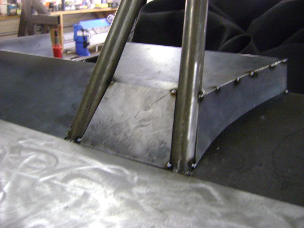

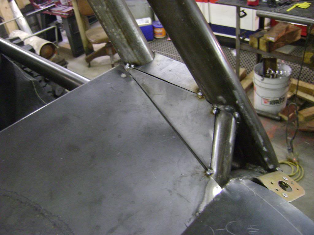

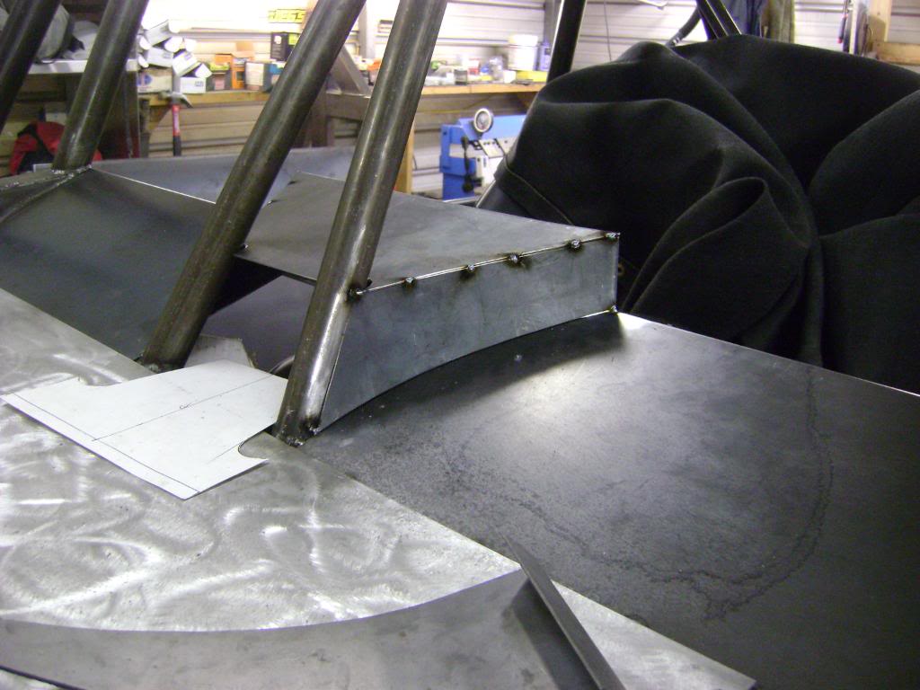

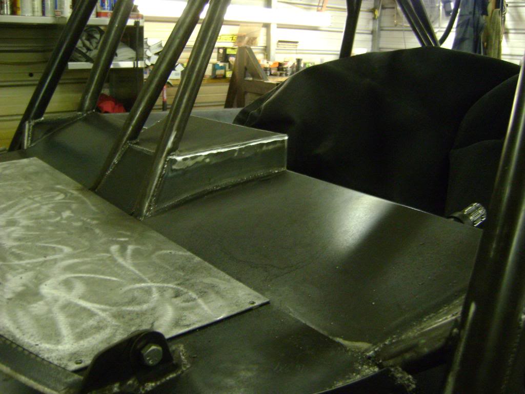

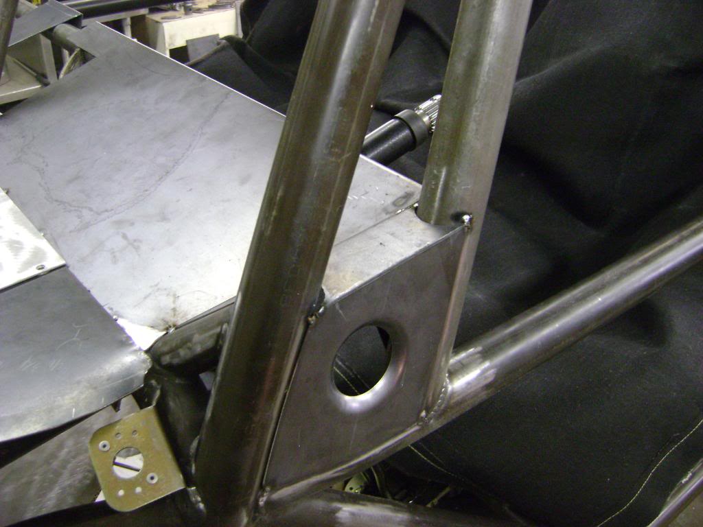

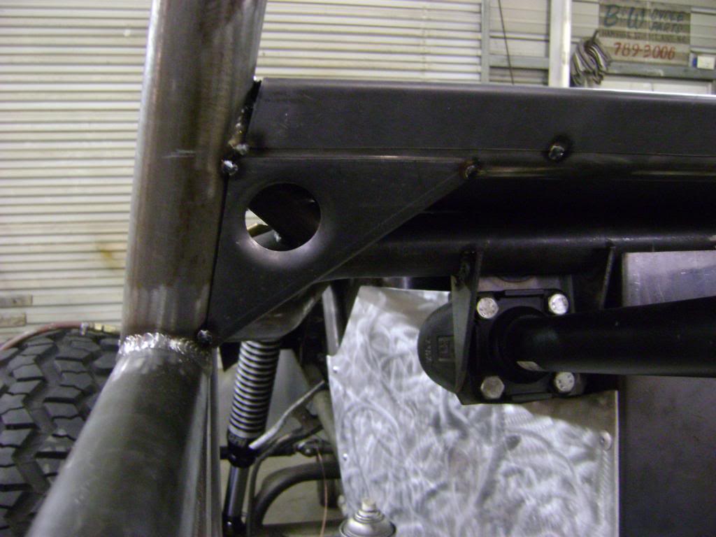

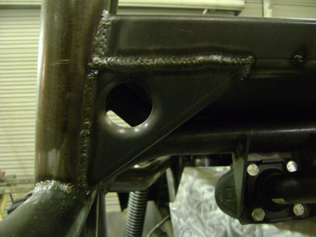

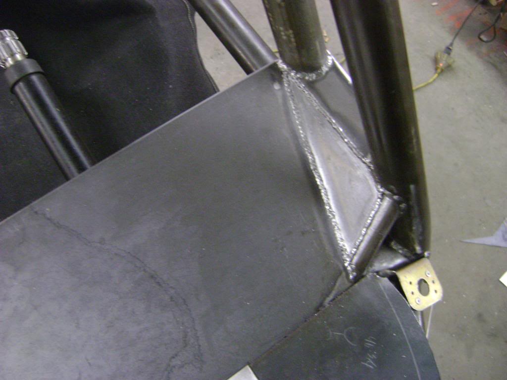

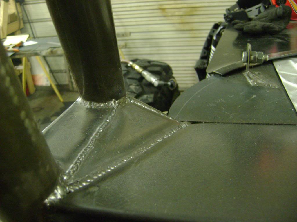

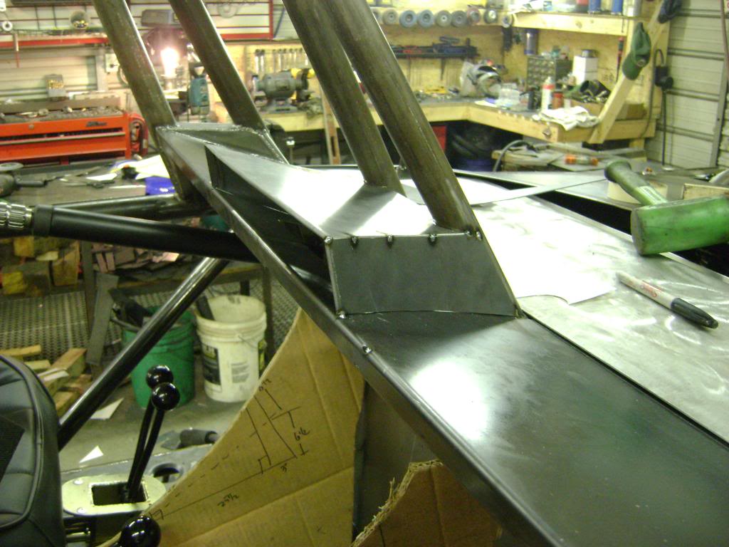

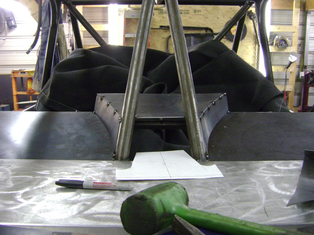

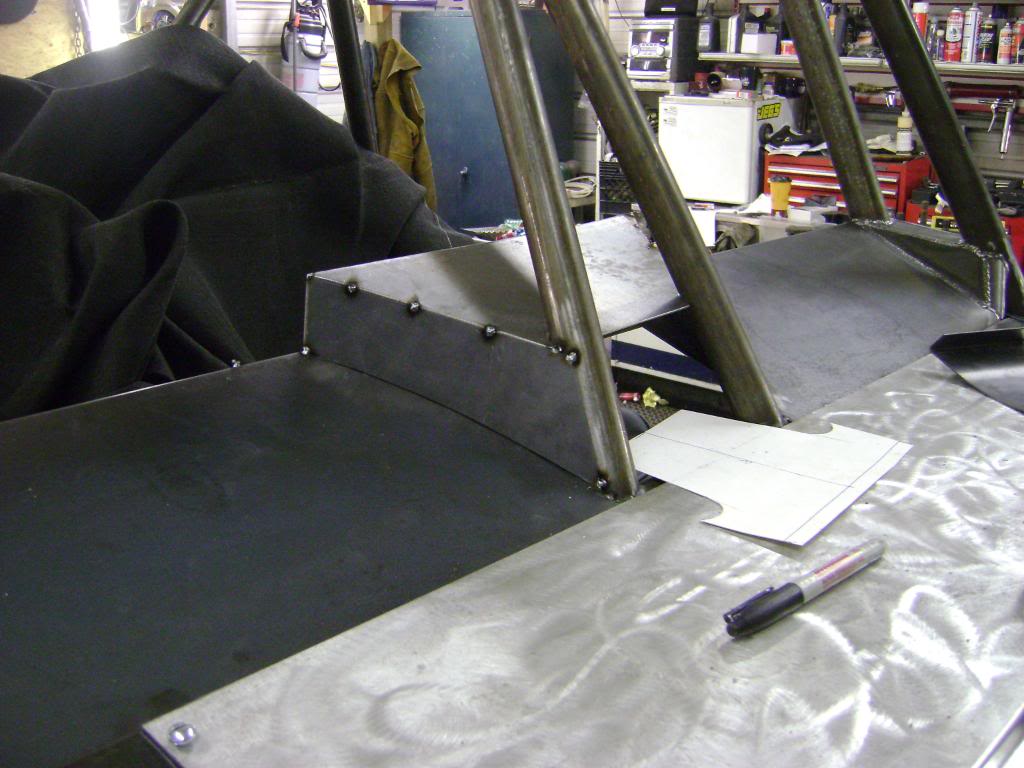

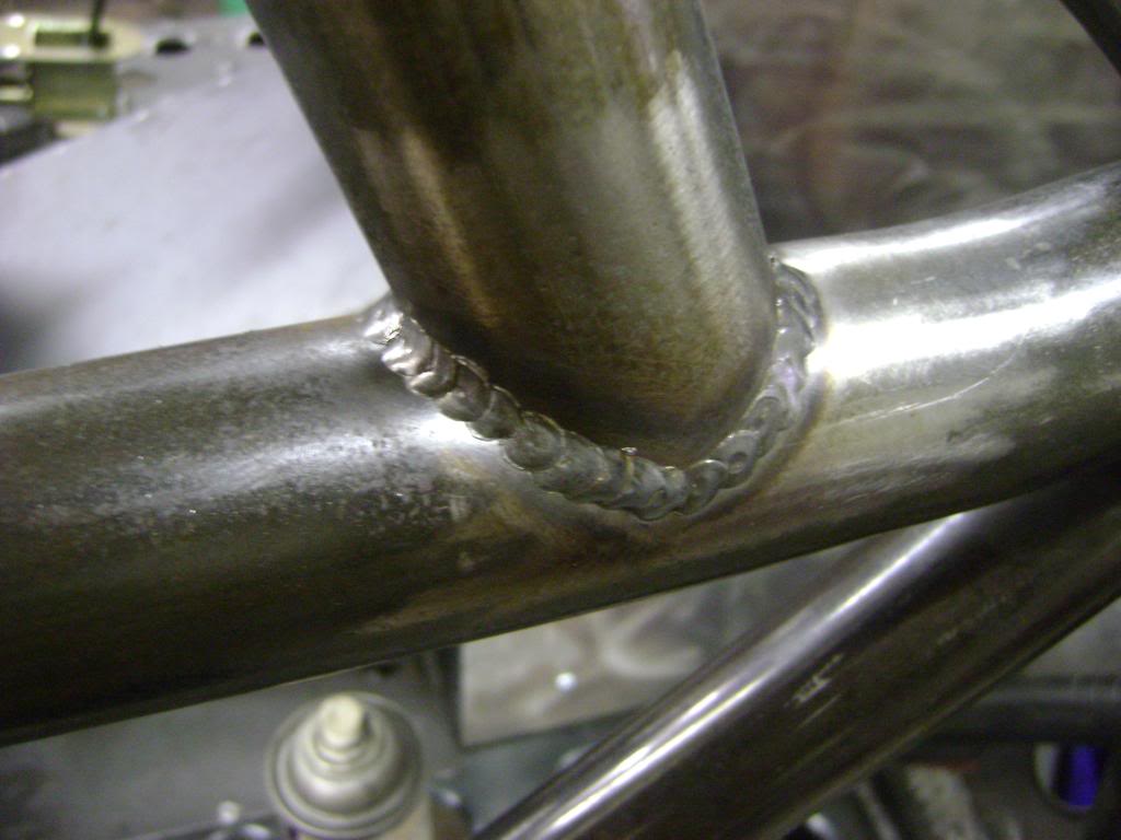

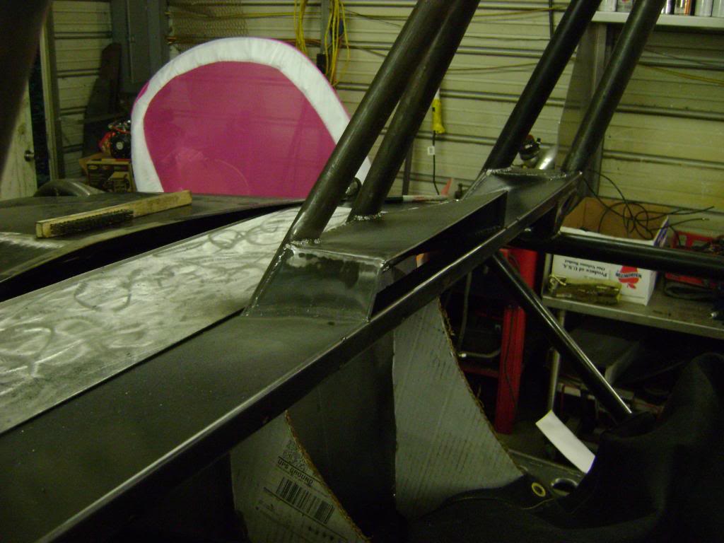

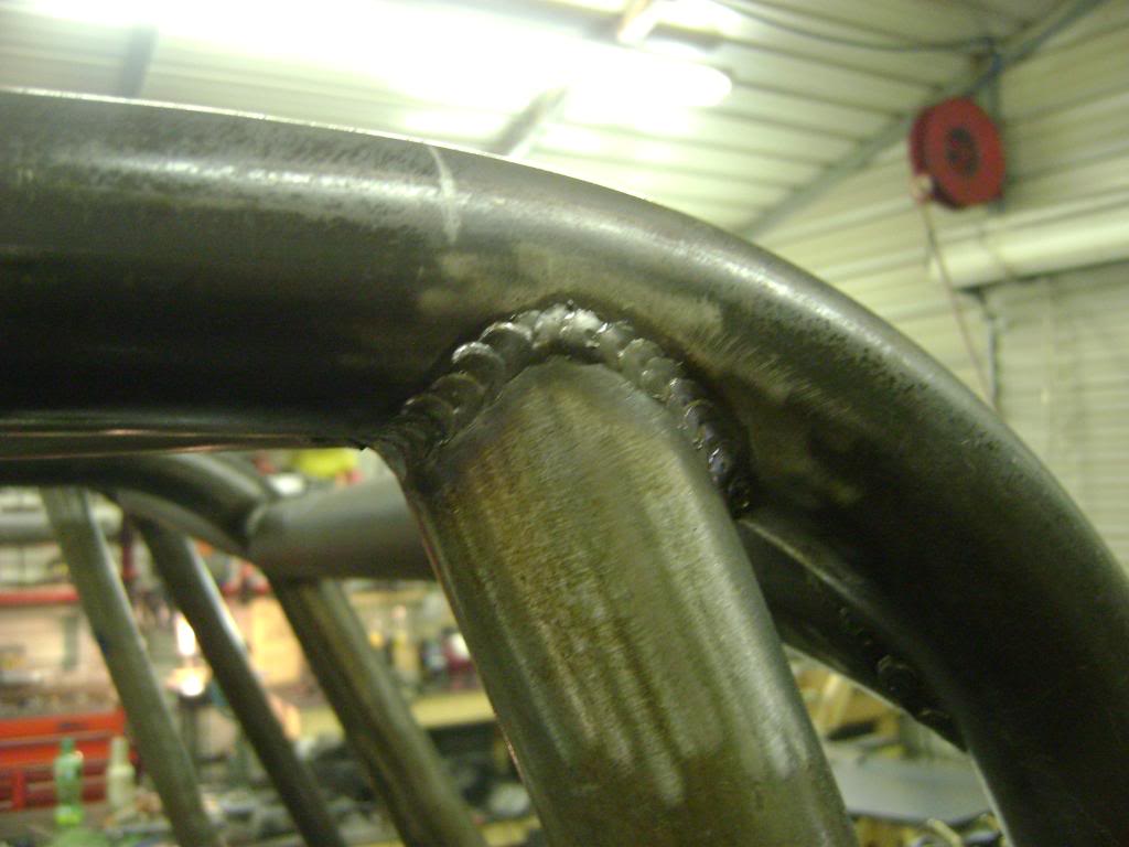

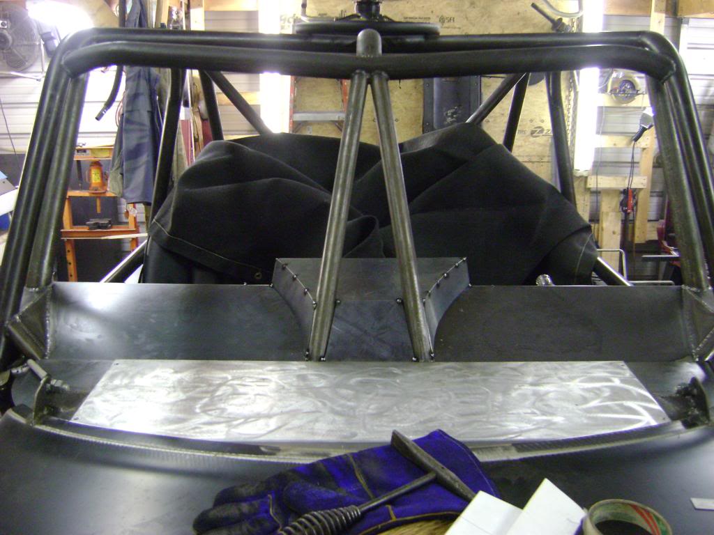

fix that crap and get back to building this bada$$ buggyi was really digging this build untill i seen the tat tat tat weldsfix that crap and get back to building this bada$$ buggy
that works best for me on the thinner guage stuff, guess got alil carried away on those two tubes. i'm self taught, and do what i can. thanks for the comps. u going on the group ride with us to golden mountain?
theres nothing wrong with those welds. when welding thin to thick it's a nice way to do things. there is no crap about this build.
I respect and like both you guys alot. Even though like most people on this board I rarely meet face to face and cary on a conversation. I also respect both of your builds and really appreiciate the different ways both of you approach things. So here's some constructive advice and is by no means a method of disrespect toward either of you, also on another note please delete this if it detracts from the build thread. The method of joining any weldment with stitched tacs is very undesirable. Each start and stop is entirely encompassed by a cold lap zone on unfused material. These zones weaken the entire weldment and rip appart much like a zipper being torn into. I only say this because of the close up photo's that clearrly shows cold lap between each tack, in welding terms there isn't any presence of the tack being tied together by actual melted or fused material. The misnomer is the weld should look like a stack of coins layed down sideways. A very good discription, however each of those ripples should be completely fused or "welded" to its related surfaces. The edges should fully blend into one another where base material and filler become fully melted. This blending is the weldment. Notice I didn't use the term bonded. Bonding occurs in soldering and brazing through capilary action. The reason most self taught mig welders develope bad habits: they don't properly read what the weld is telling them in appearence. A proper lapped tig weld or stick weld running a whip technique will show the ripple stacked affect but will be quite smooth in tecture.i am very impressed with Cutlers attention to detail and fab skills.

is that a hint toward fiber-glass race skins!who cares about the welds.......i cant wait to do some crazy glass work to the side of this thing!!!!
