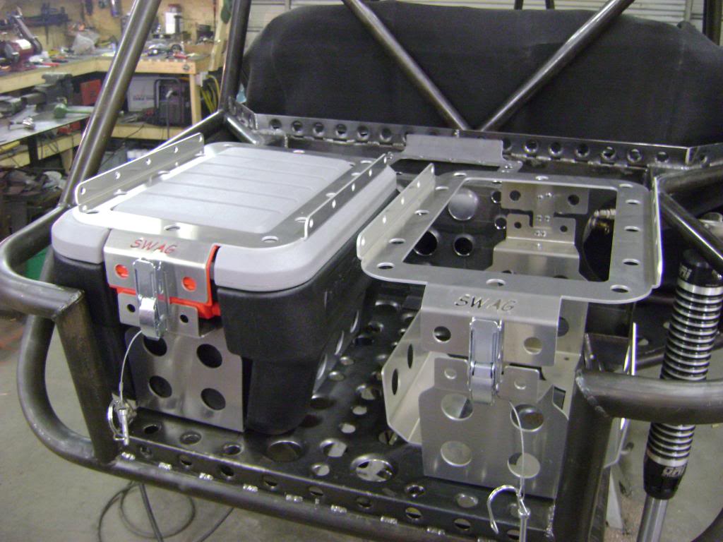

where do those action packer totes and mounts be seen online for sale?
pretty sure he got them from swagoffroad.com
thats right chip,http://www.swagoffroad.com/Action_Packer.html

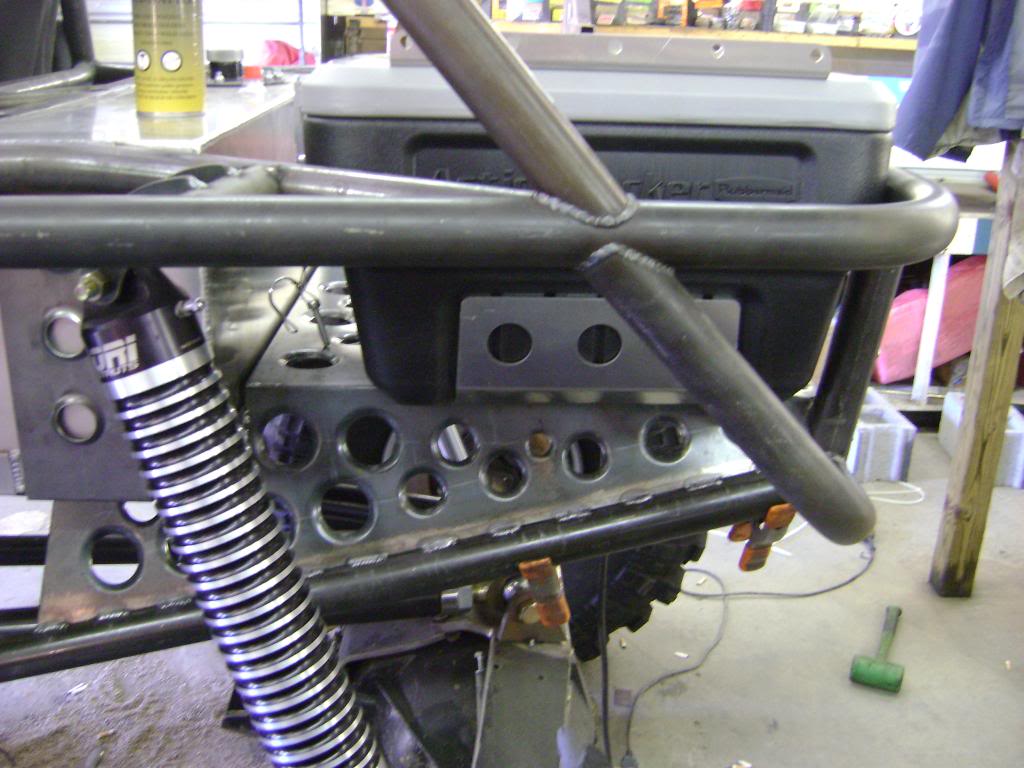

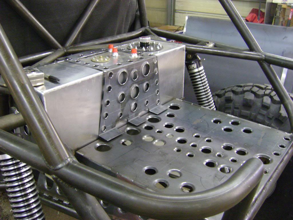

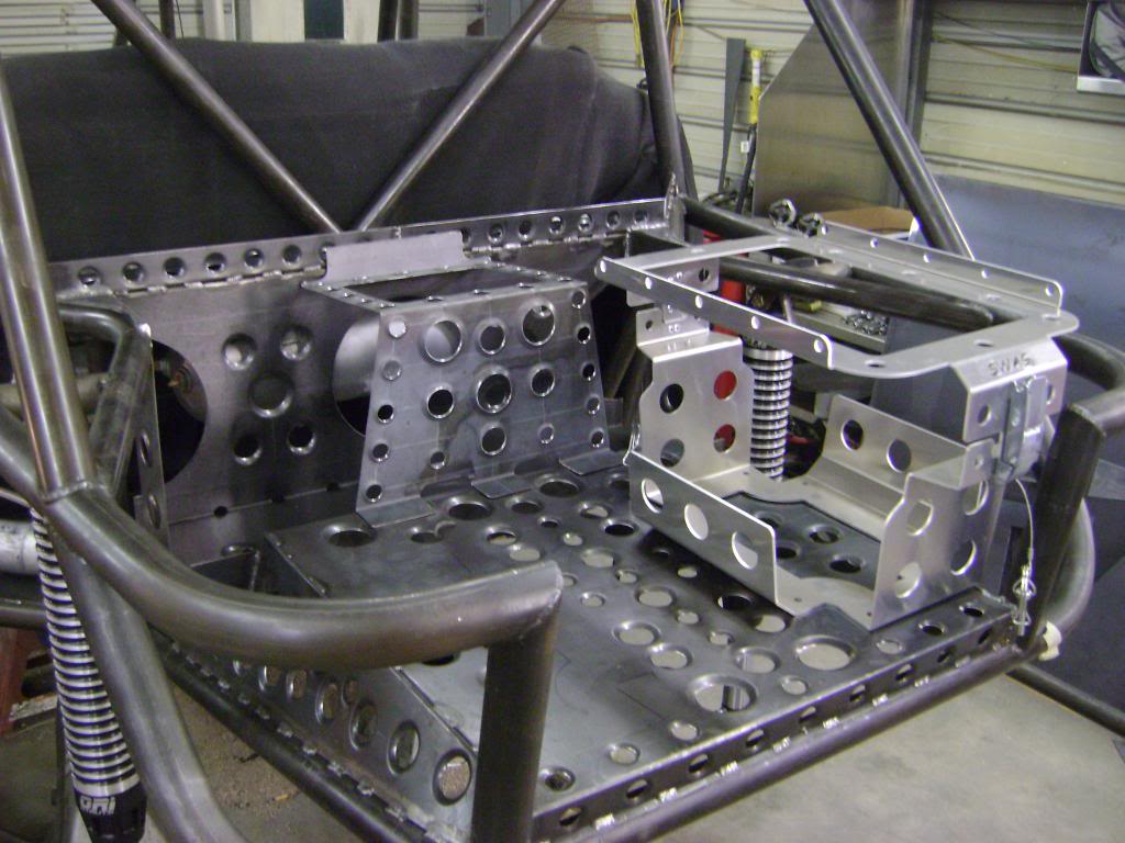

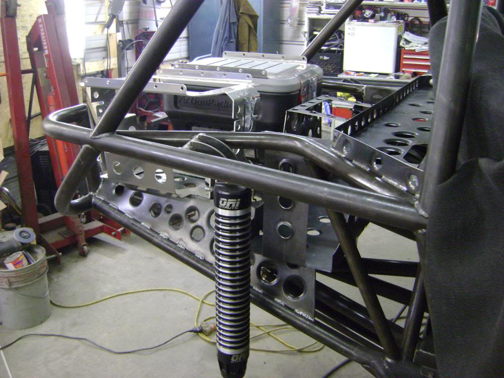

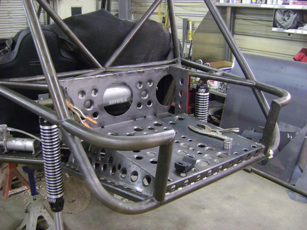

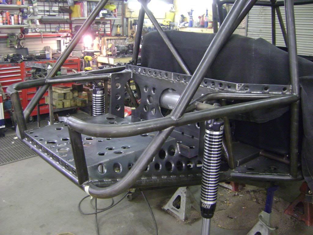

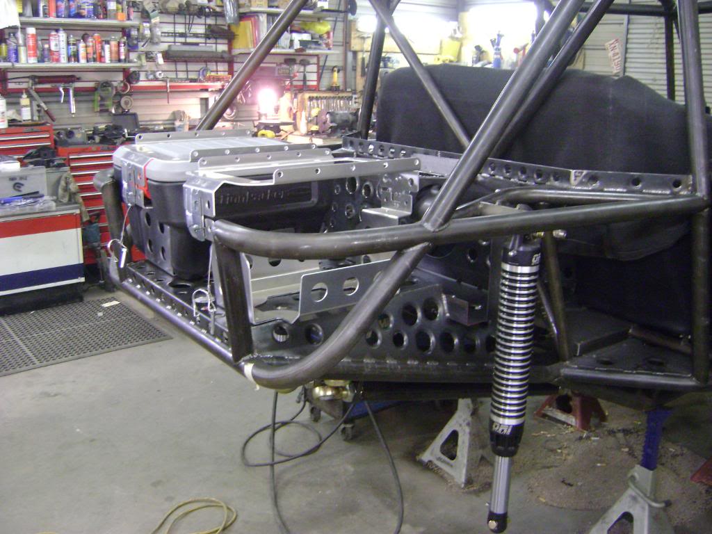

the totes can be purchased about anywhere, wally world, target, etc, bout $20 dollars each. the cages, can either be hinged or dbl latch like mine, bout $120 each. sounds pricey, but i had those tool chests in my old (yours now) chassis built, before i purchased a metal brake, and they were over $400. I like this better i think, because i can take the entire toolchest to the busted up junk rather than make 5-10 trips BACK to the tool box to get whats needed. I feel this will be more efficient, when needed. Plus, watertight!

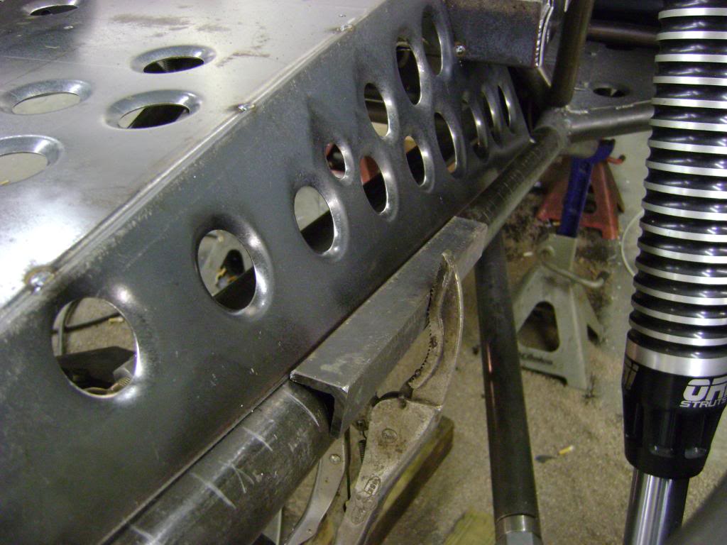

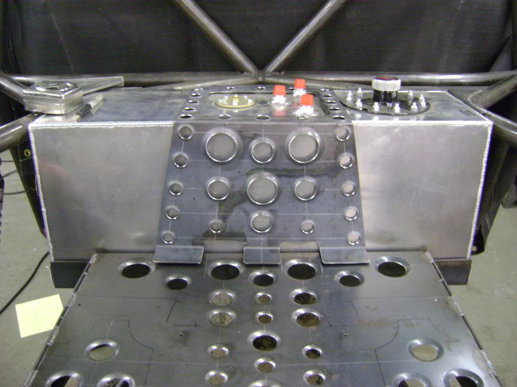

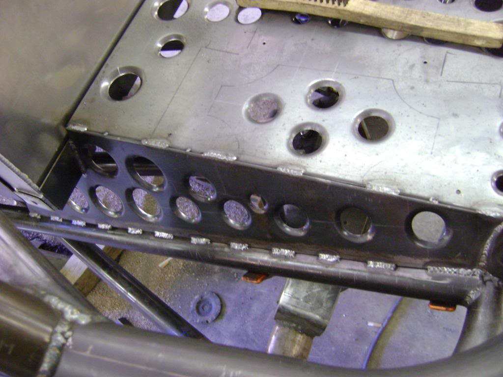

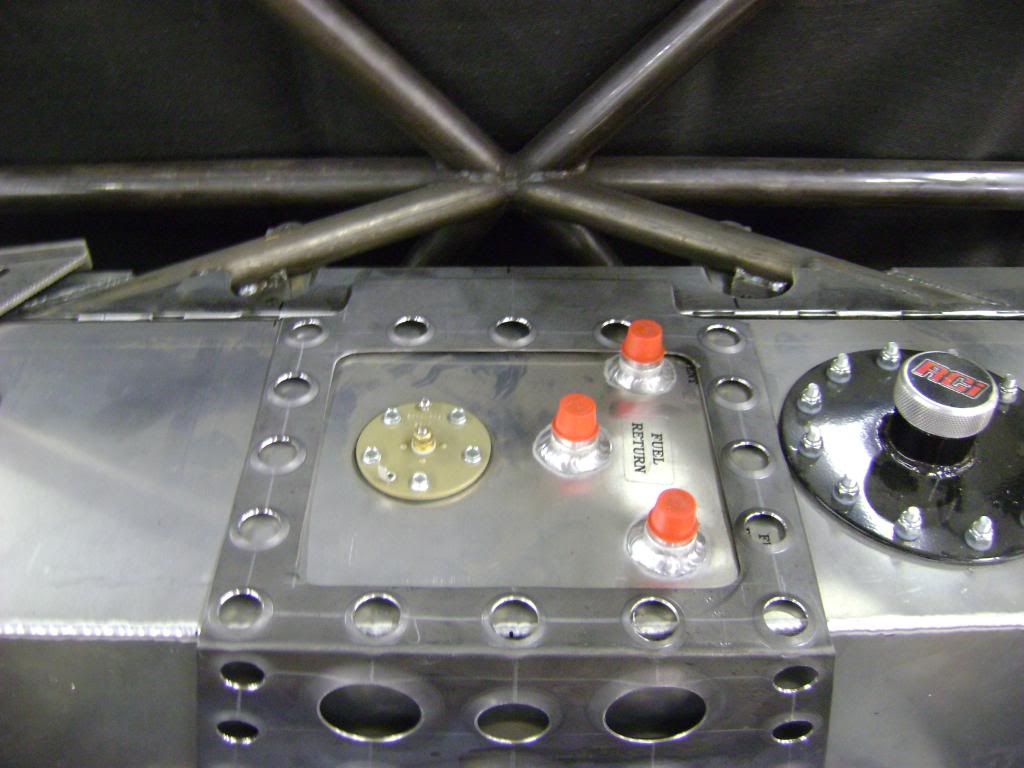

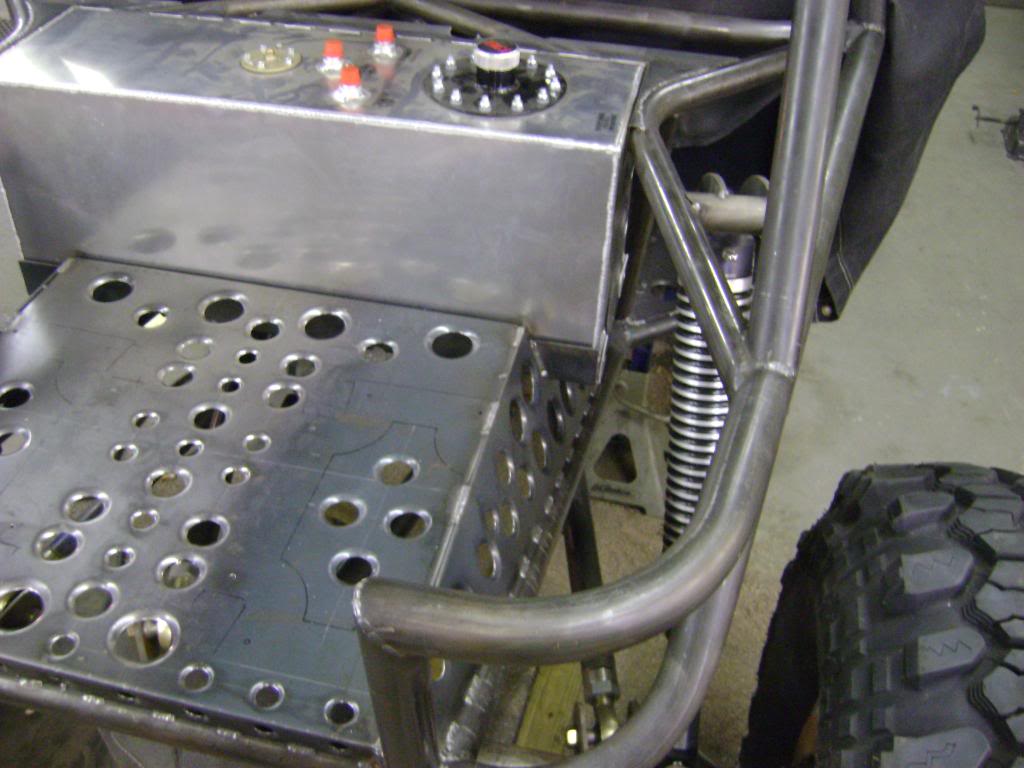

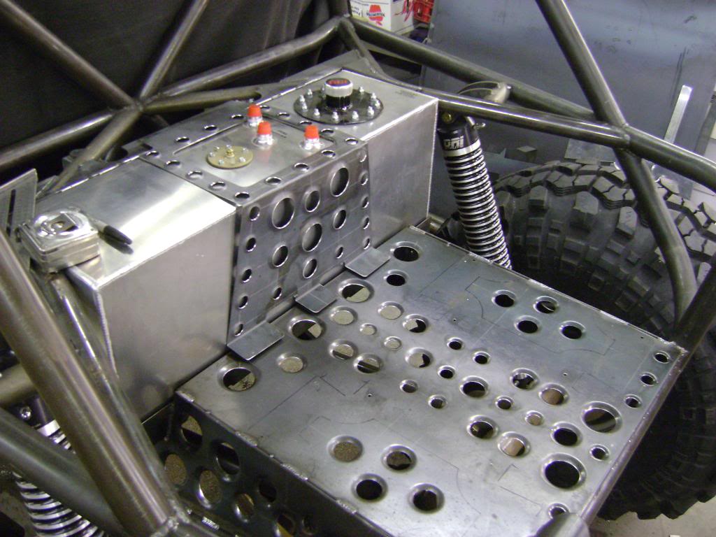

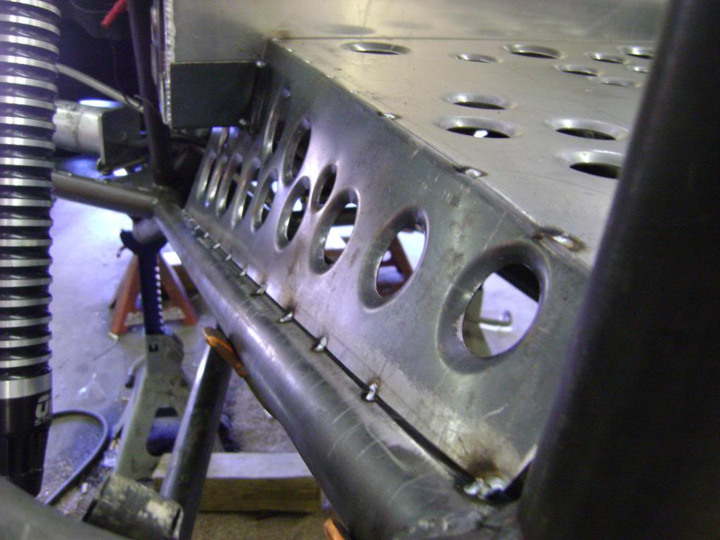

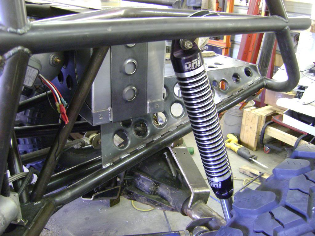

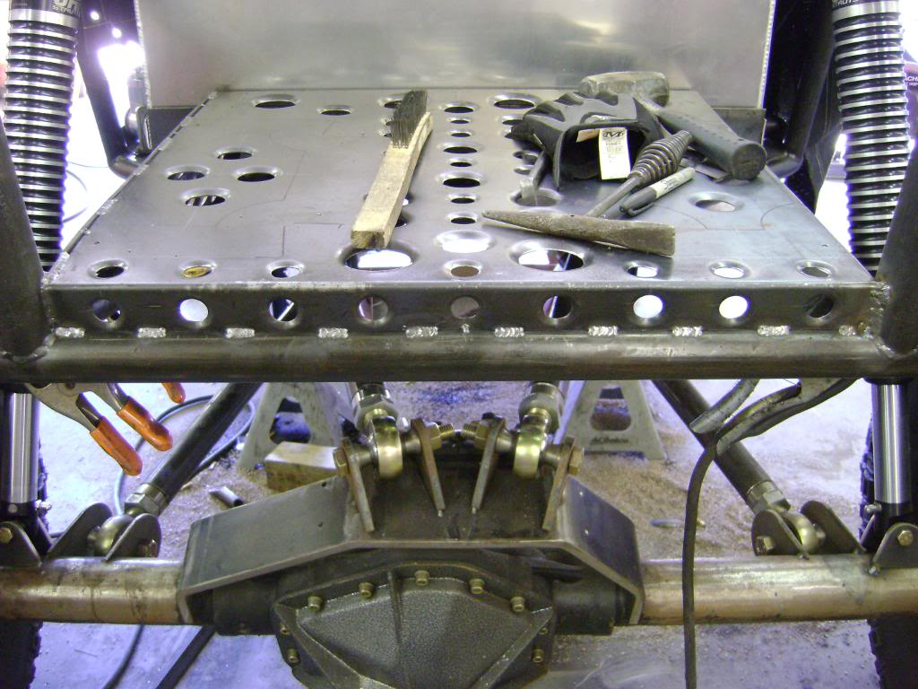

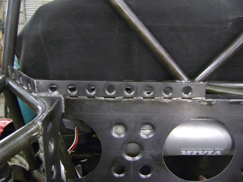

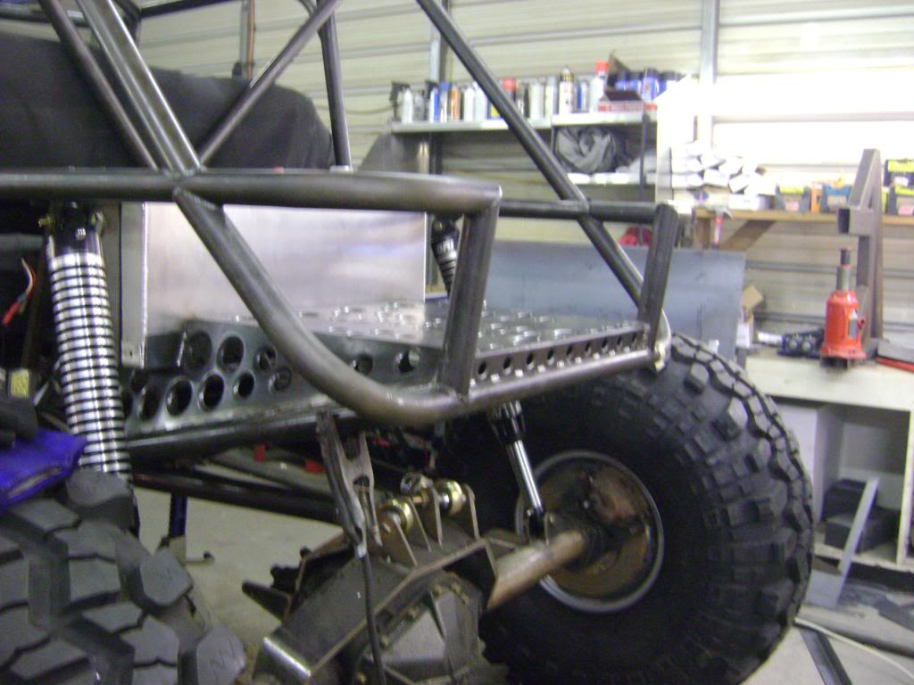

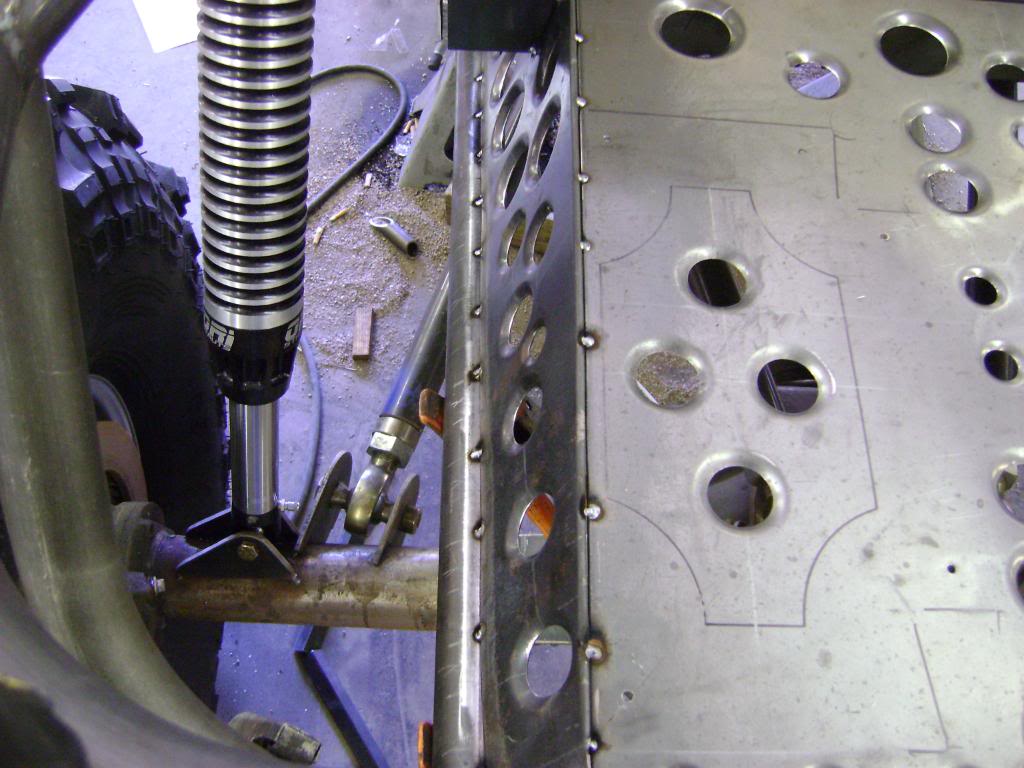

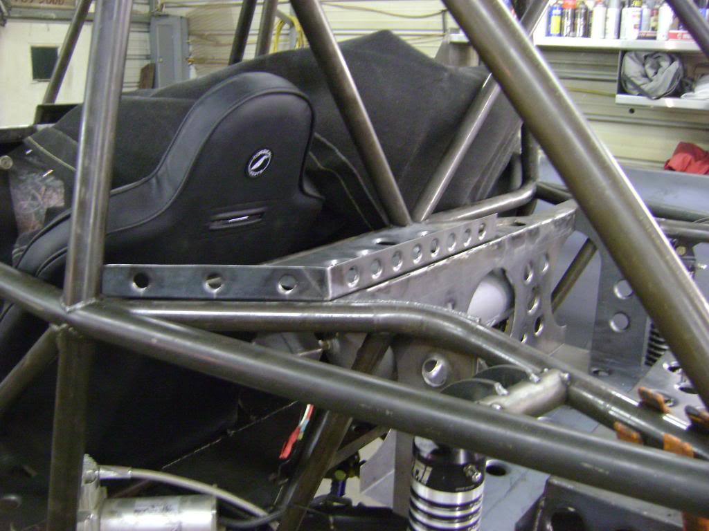

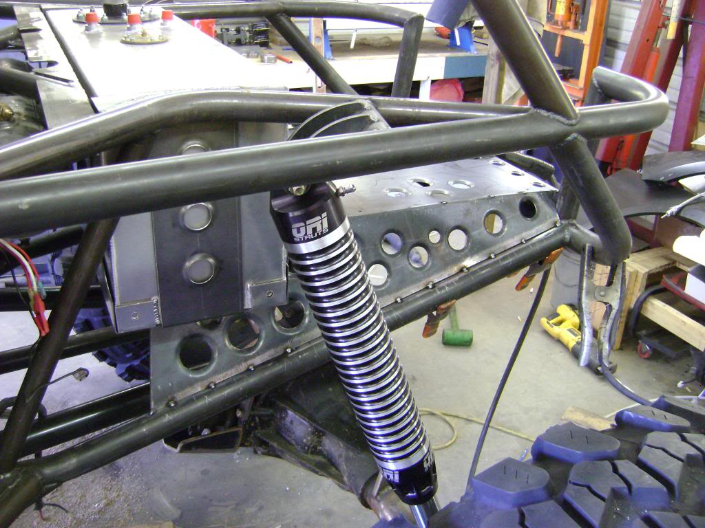

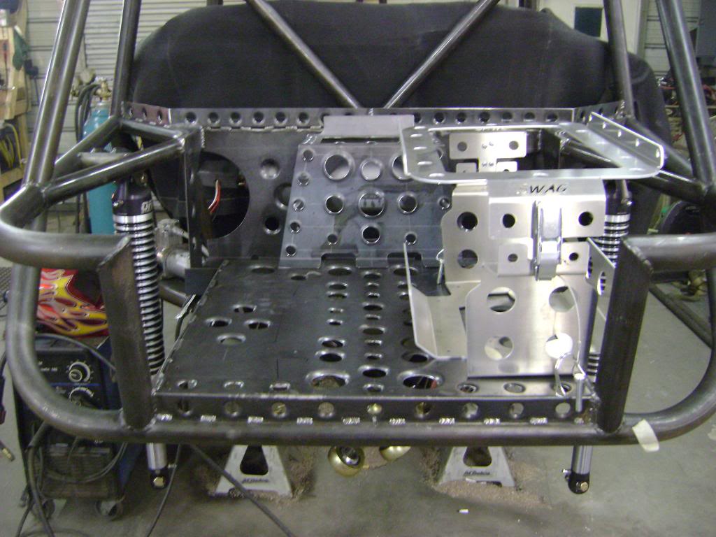

got fuel retainment completed other than bolting it down, (have damn near worn my drills out). also skirts under tool tray. just alil bit more sheet fabrication then all the minor tabs, gussets, etc, and fabrication will be complet, not to say that wont take another week or to on the small shit!
ai1222.photobucket.com_albums_dd489_mcutler1_copper_20crawler_20buggy_fuelstrapskirts001.jpg
ai1222.photobucket.com_albums_dd489_mcutler1_copper_20crawler_20buggy_fuelstrapskirts004.jpg
ai1222.photobucket.com_albums_dd489_mcutler1_copper_20crawler_20buggy_fuelstrapskirts005.jpg
ai1222.photobucket.com_albums_dd489_mcutler1_copper_20crawler_20buggy_fuelstrapskirts006.jpg
ai1222.photobucket.com_albums_dd489_mcutler1_copper_20crawler_20buggy_fuelstrapskirts007.jpg
ai1222.photobucket.com_albums_dd489_mcutler1_copper_20crawler_20buggy_fuelstrapskirts008.jpg
ai1222.photobucket.com_albums_dd489_mcutler1_copper_20crawler_20buggy_fuelstrapskirts010.jpg
ai1222.photobucket.com_albums_dd489_mcutler1_copper_20crawler_20buggy_fuelstrapskirts013.jpg
ai1222.photobucket.com_albums_dd489_mcutler1_copper_20crawler_20buggy_fuelstrapskirts014.jpg
ai1222.photobucket.com_albums_dd489_mcutler1_copper_20crawler_20buggy_fuelstrapskirts017.jpg

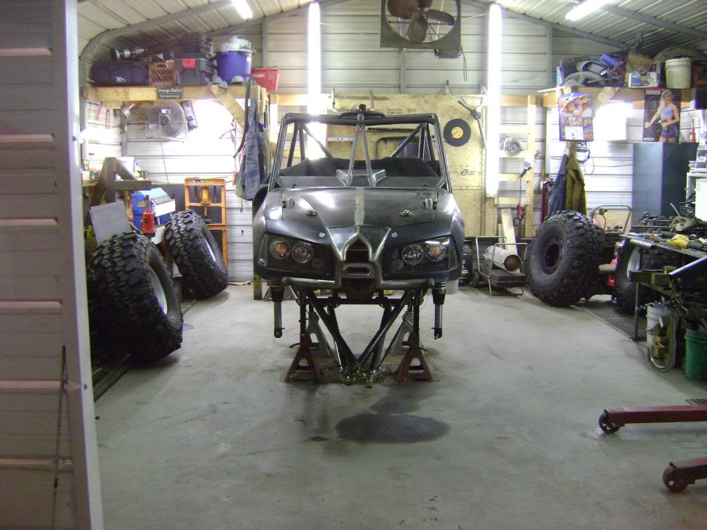

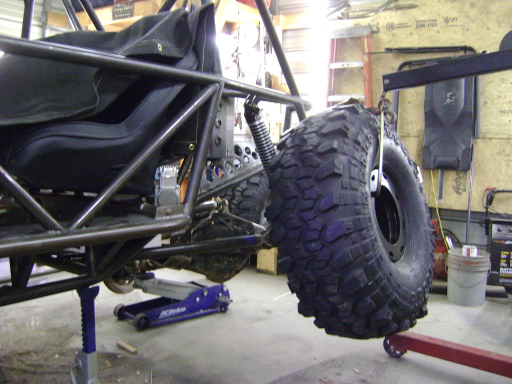

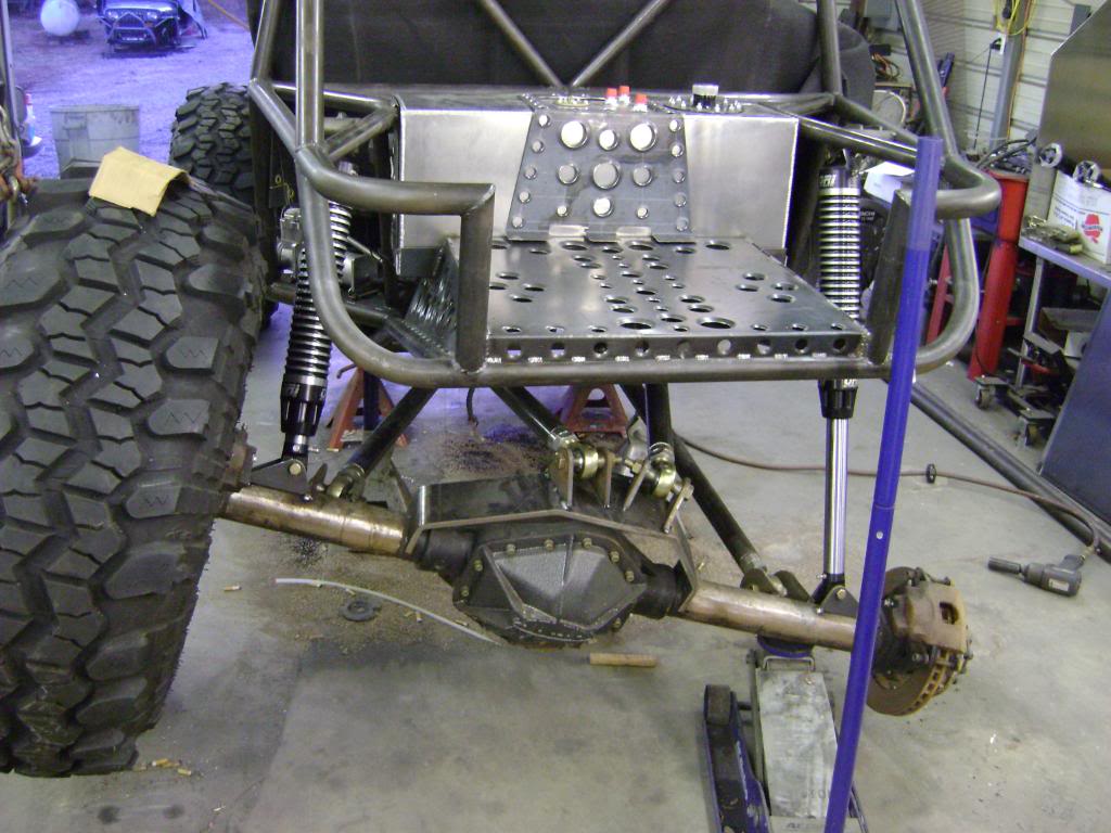

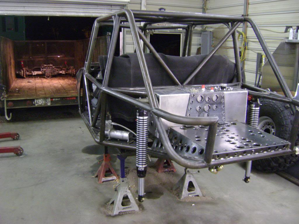

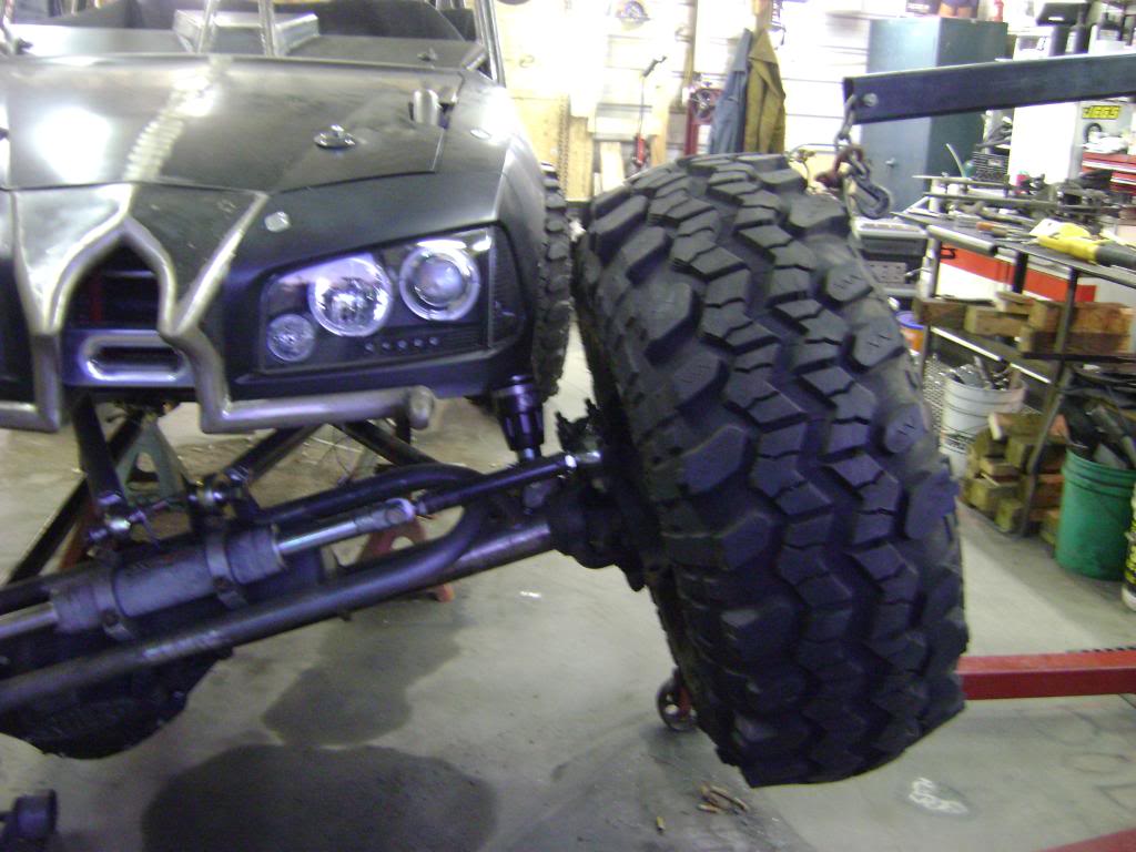

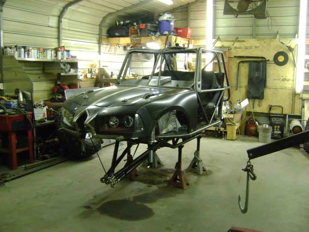

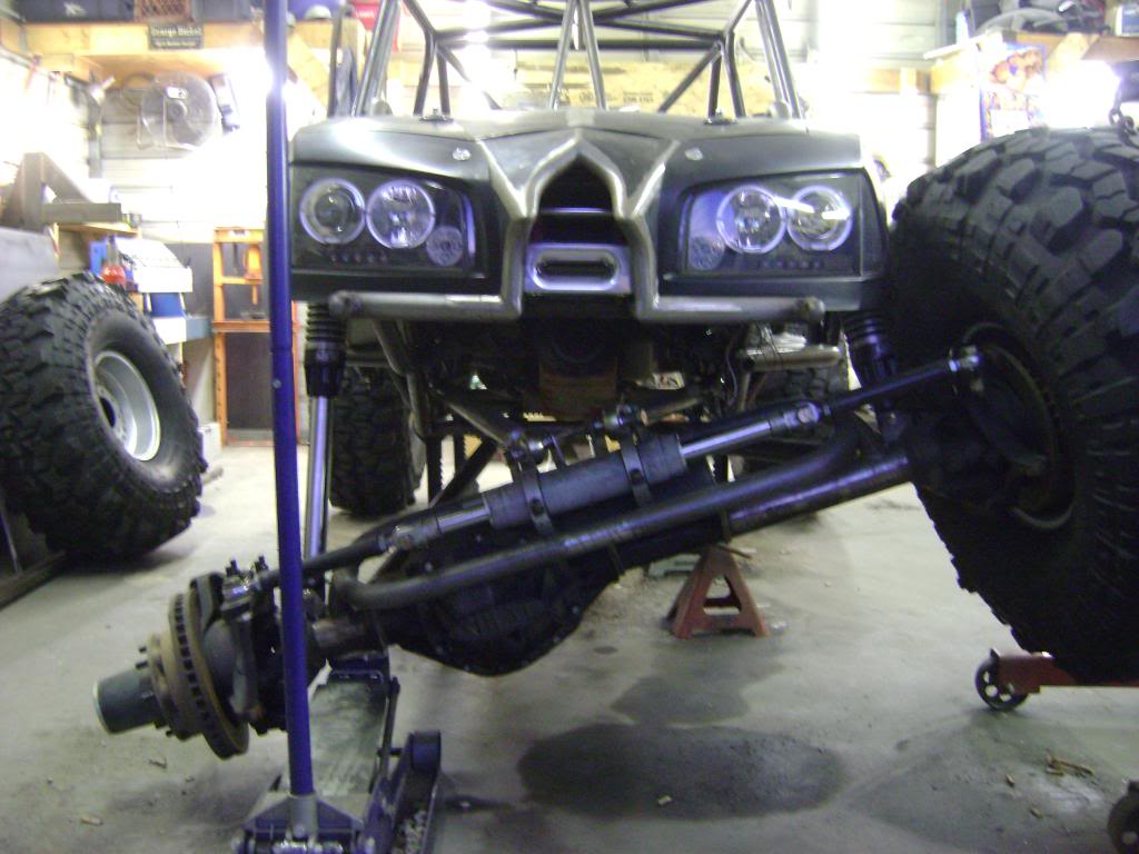

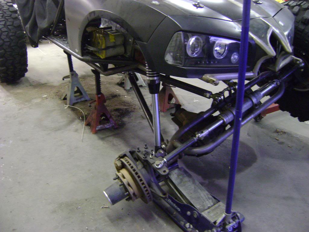

no real progress on sunday, my ass is whooped needed some rest sunday; stretched out one final time before burning link tabs in, pulled axles for delivery to RIDES today

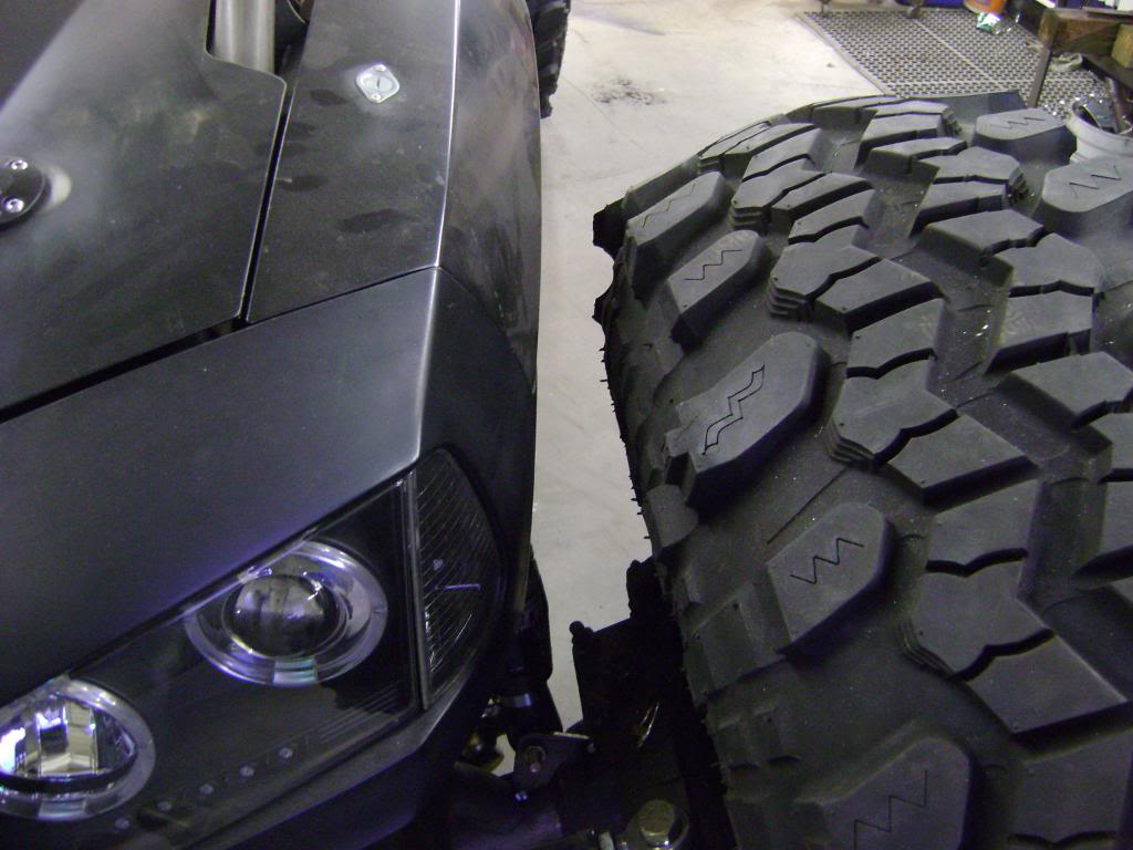

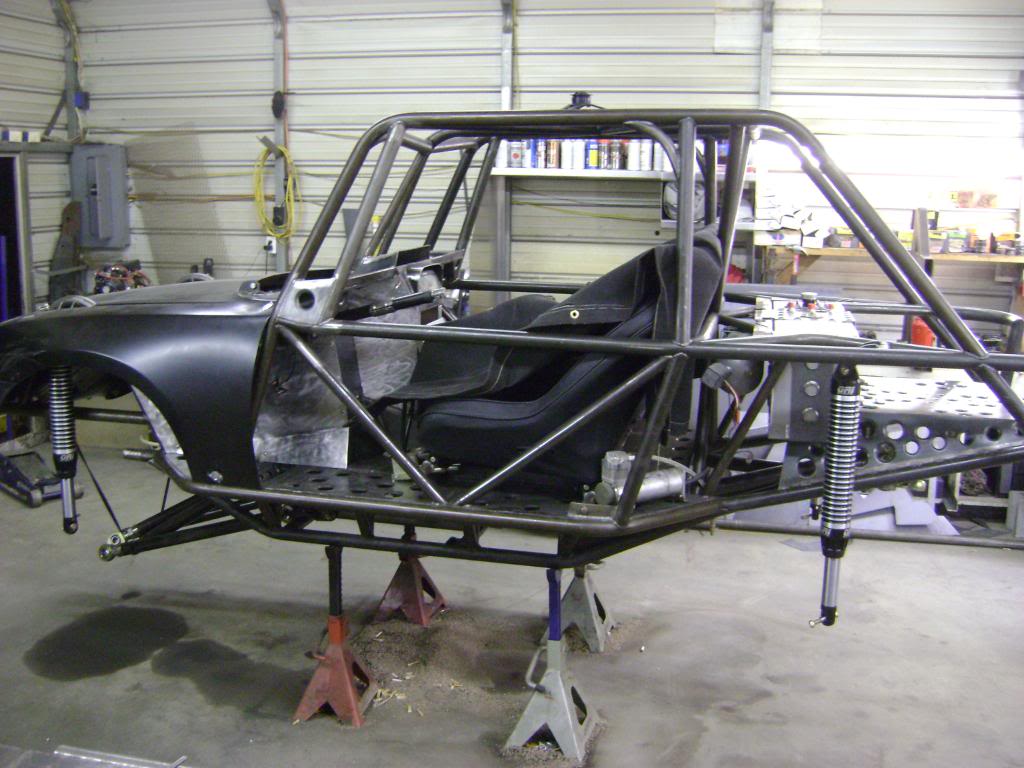

there will be a slight trim to fender in wheel opening, very minor, pretty pleased that the front clip fits so well with axle placement.
looks pretty sad with axles gone,
more to come tonight
Your right it does look funny without axles but i cant wait to see it on the trails and see all this charger can do

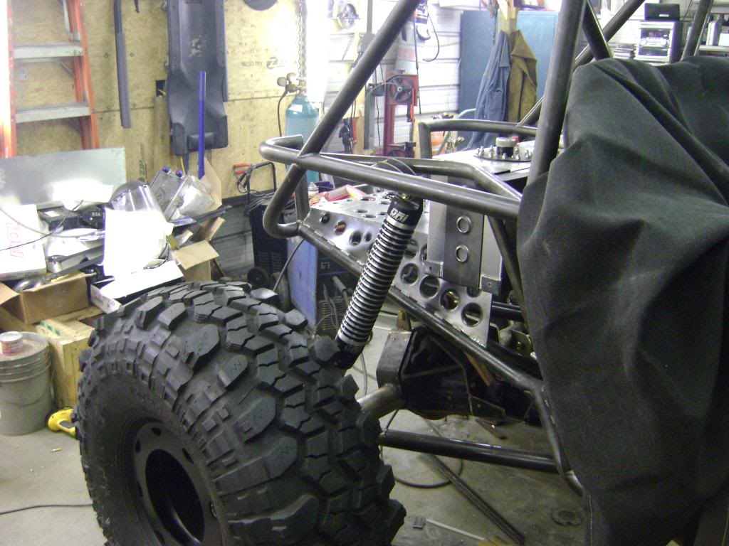

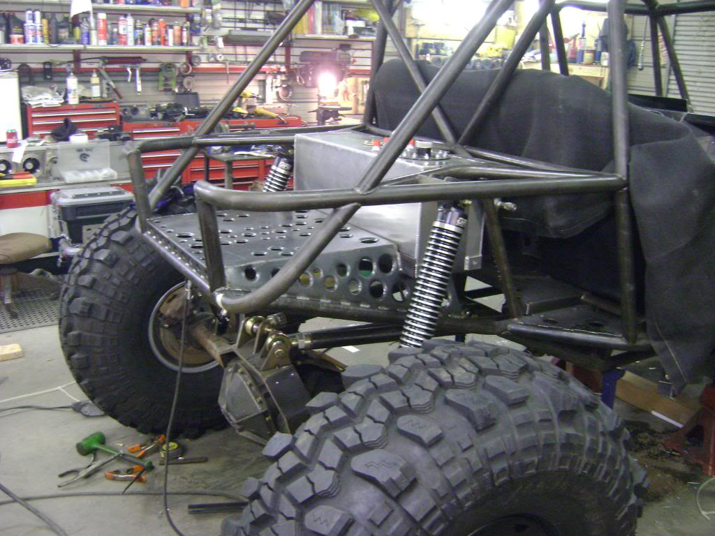

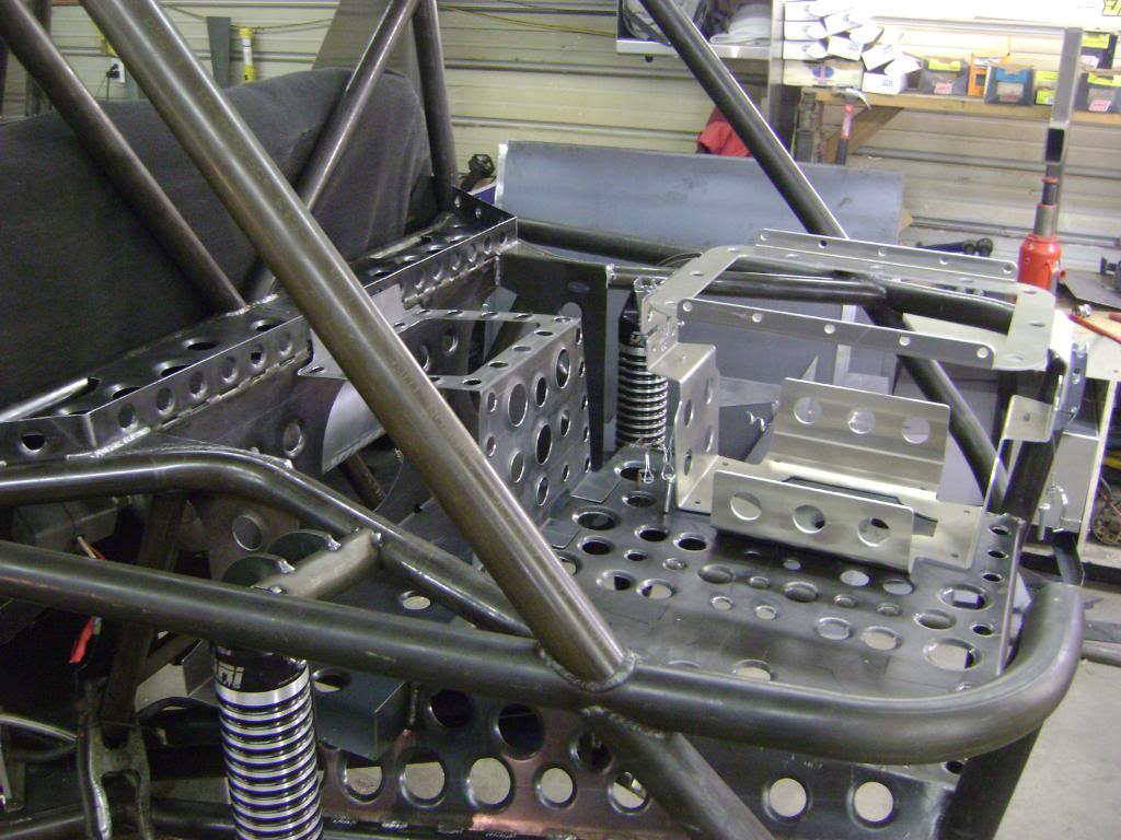

back end is almost complete, just need to double up the c pillar ontop of strut mount, trans cooler mount, fire extinguishers and tailights, hmmm, maybe more than i thought, lol.

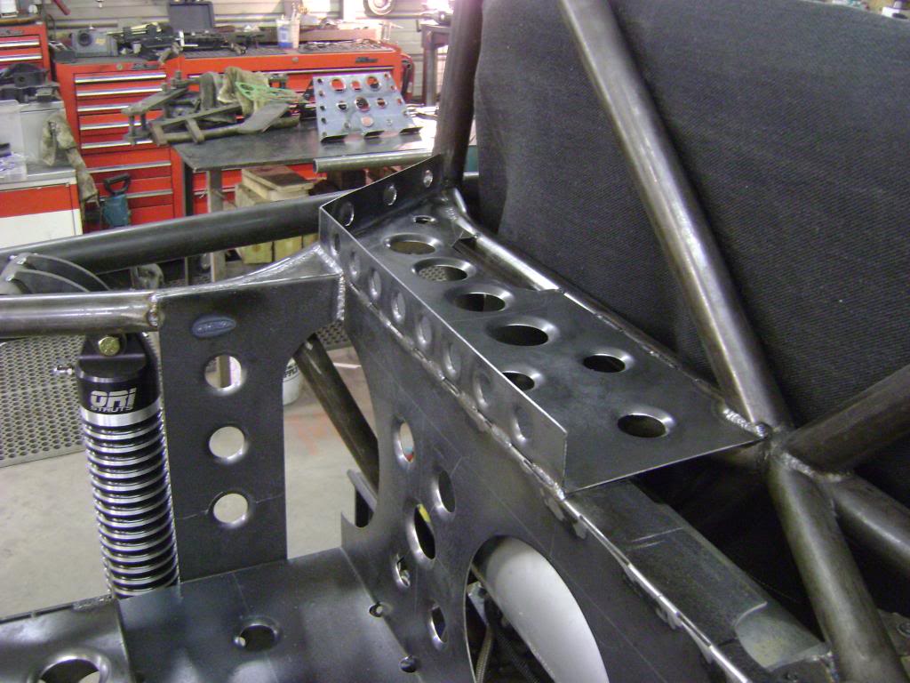

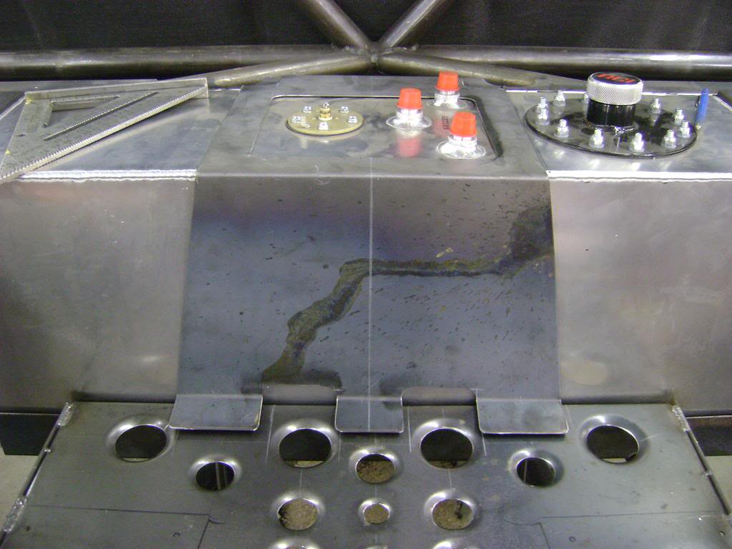

fuel cell removed

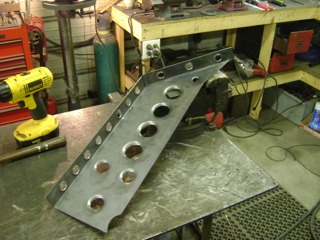

ai1222.photobucket.com_albums_dd489_mcutler1_copper_20crawler_20buggy_traycomplete003.jpg

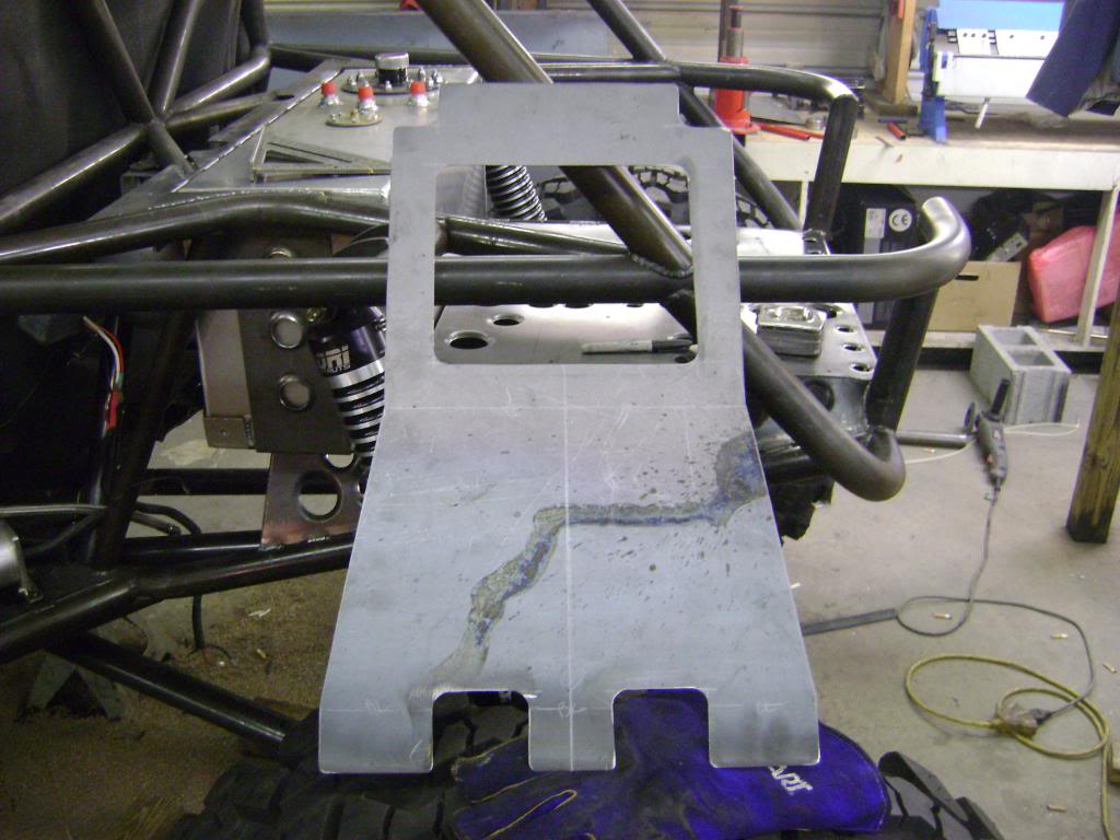

this is a small tray to allow quick access to tree saver and tow strap

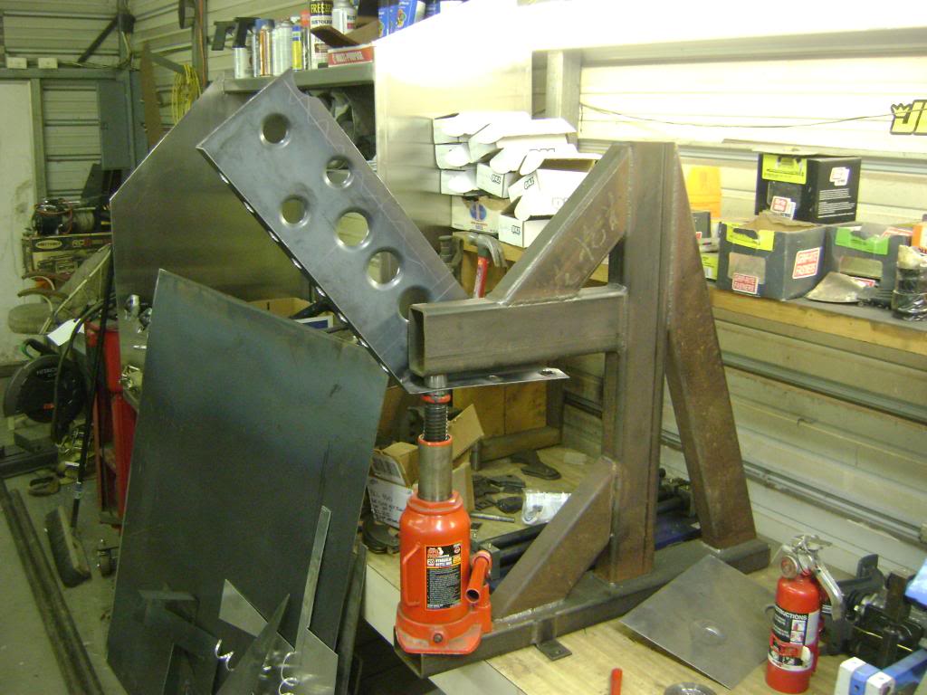

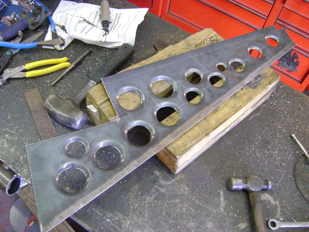

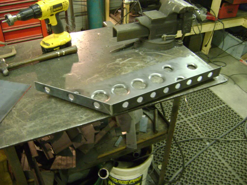

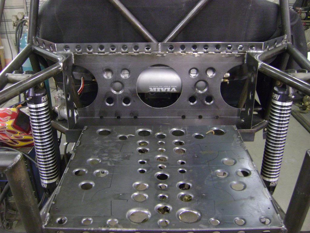

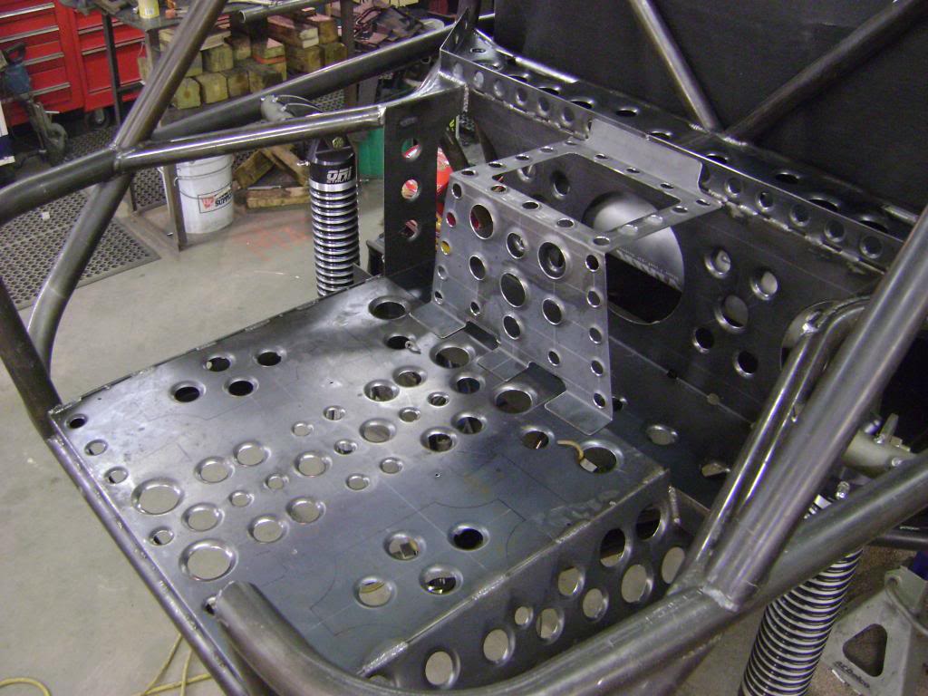

thanks kid and novacayne. yep, i drank the koolaid, i dig the dies, makes fabbing sheet more fun, although double the work, but a terrific looking and functional finished product. you should have multiple drills on hand, (i have 5 loaded), and be prepared to replace one or two after a large project like this.
PINKSTON- dimensions on stag cage/action packer 21"L x 15" W x 13" H. that is with lathces closed, need 3" clearance on each end for opening of latch.

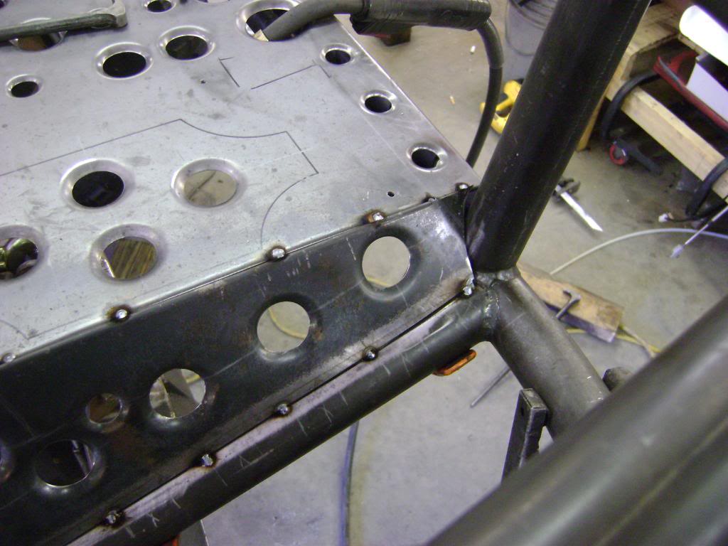

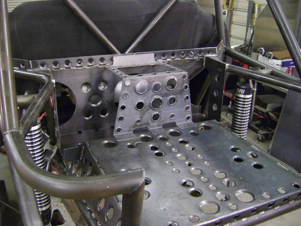

Holy shit there are a lot of holes. Bet that was fun to make.
yea it really was, and i personally hate drilling, but this isn't the same for some reason. i suppose its the promise of the end product that makes it fun. although it certainly promotes carpal tunnell.:shaking:
there are 54 holes just in the main pan, i haven't made a full count of entire rig to date but guessing around 200 so far!
