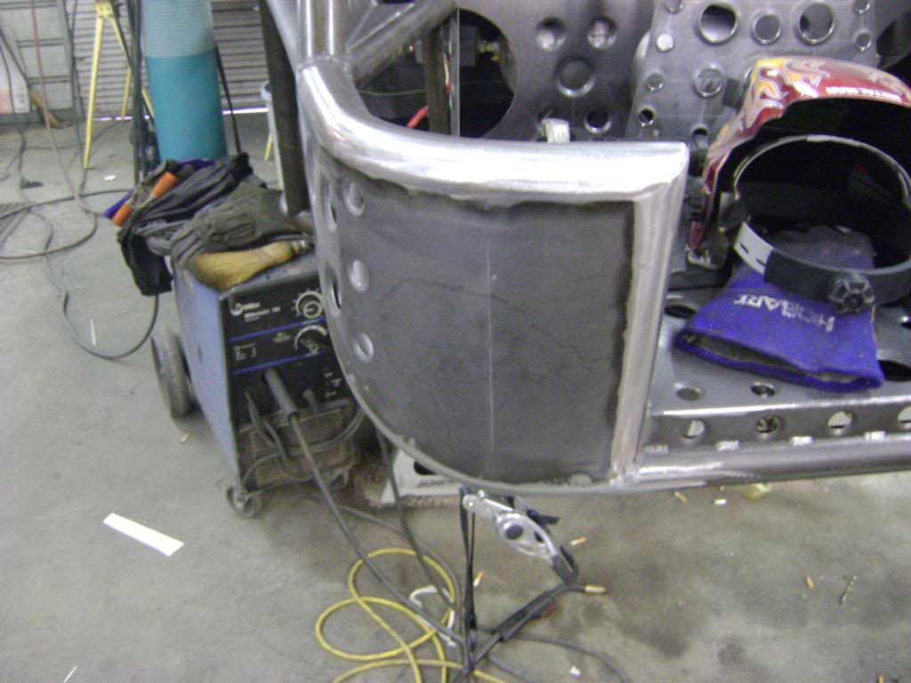

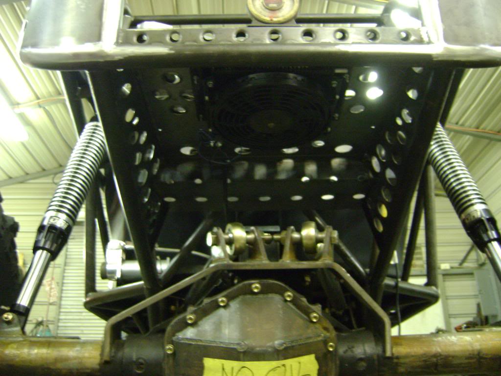

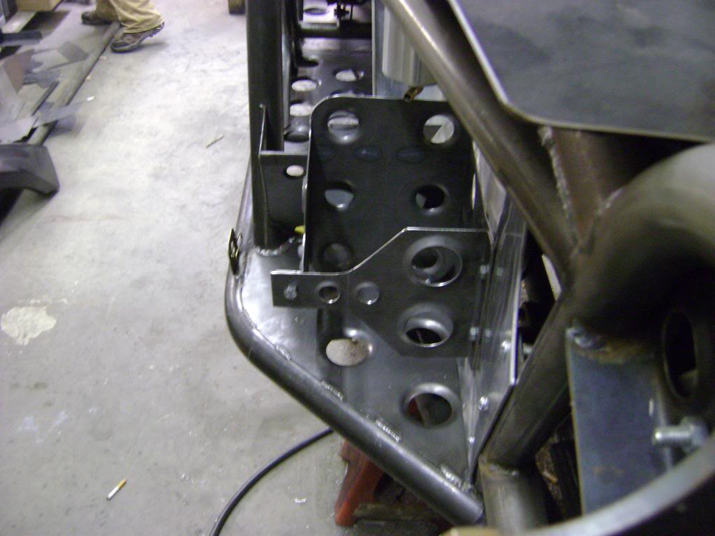

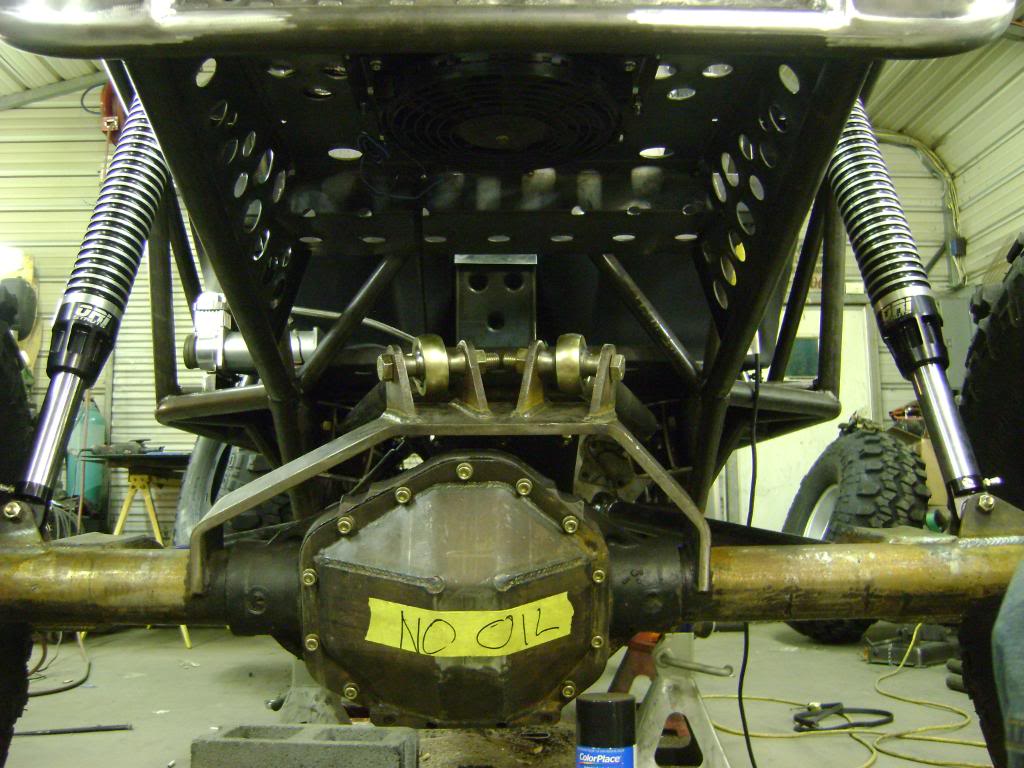

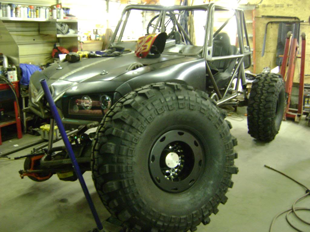

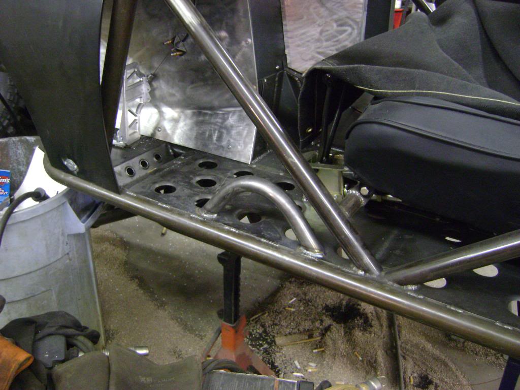

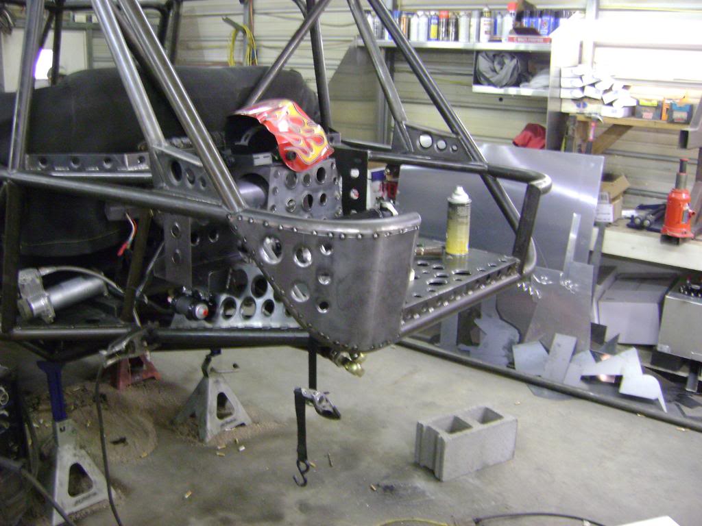

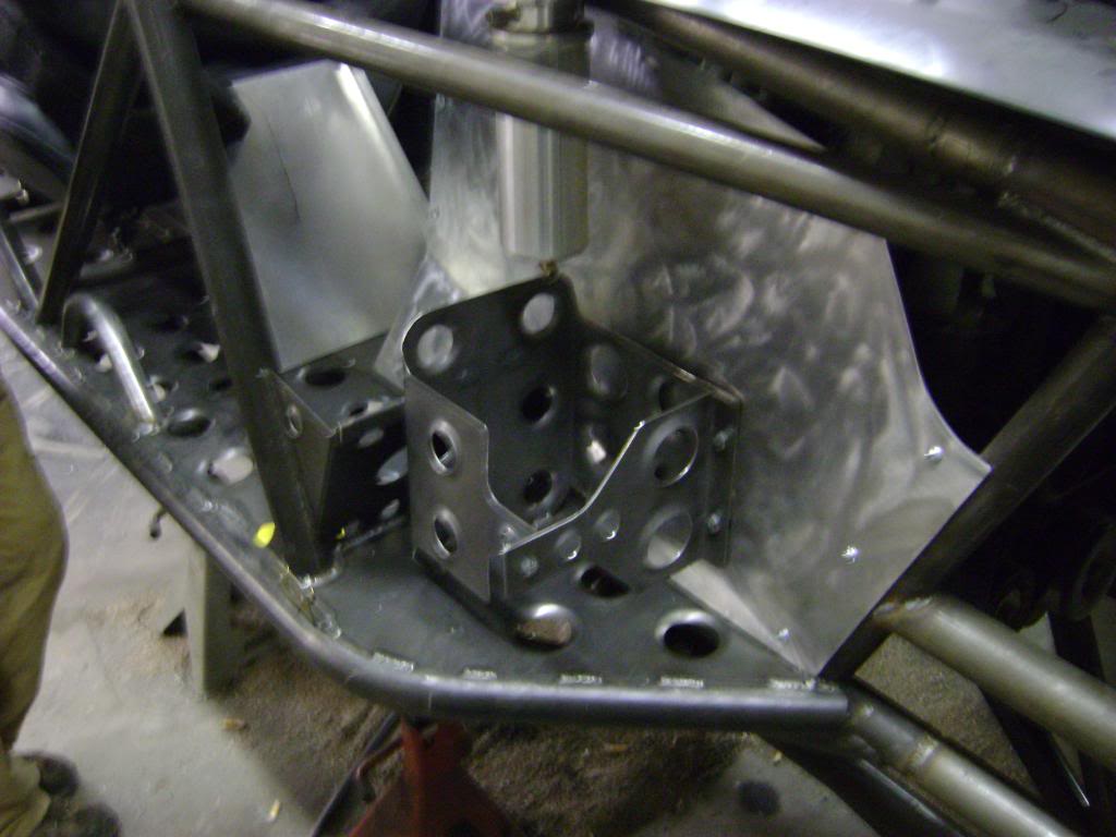

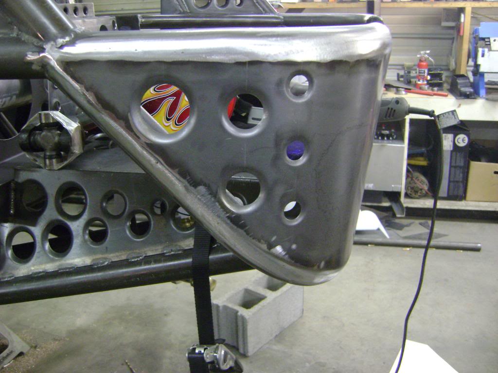

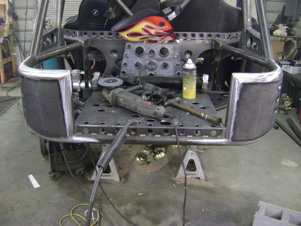

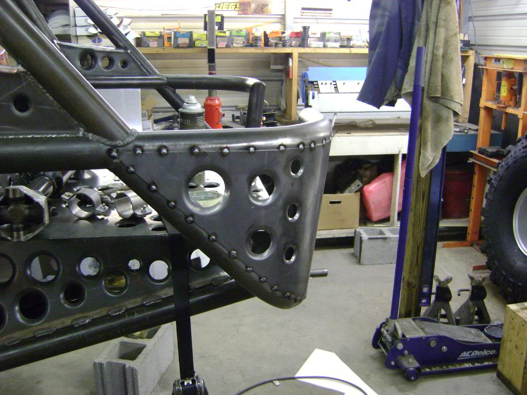

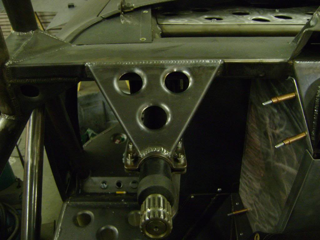

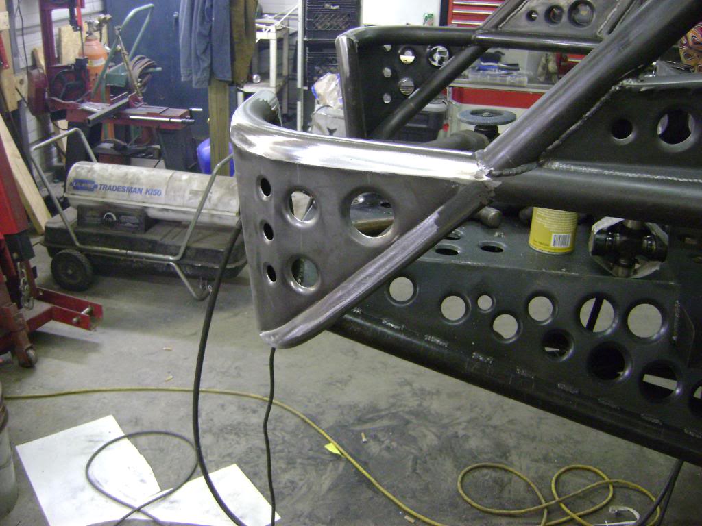

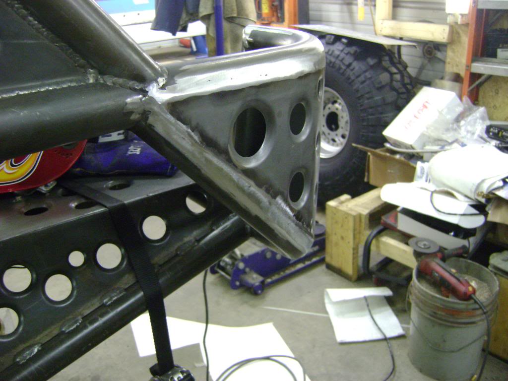

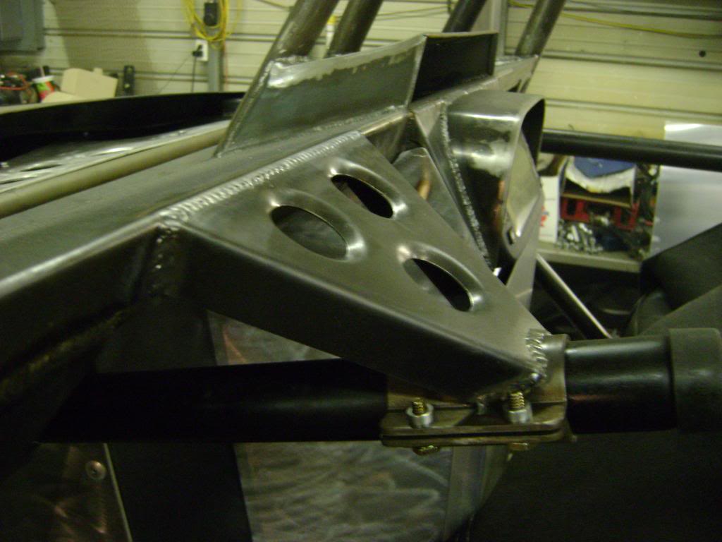

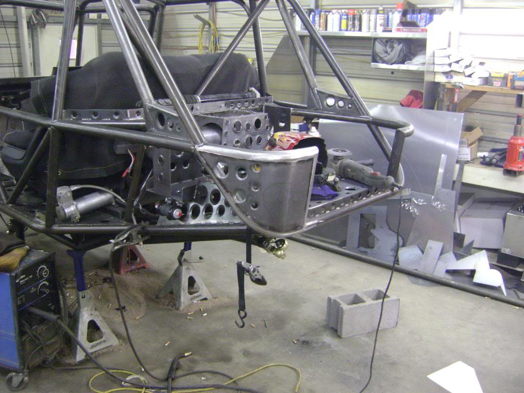

Those are killer gussets. I like that alot. I might have to steal that idea. . . . :D
hell yeah dude, looks great!

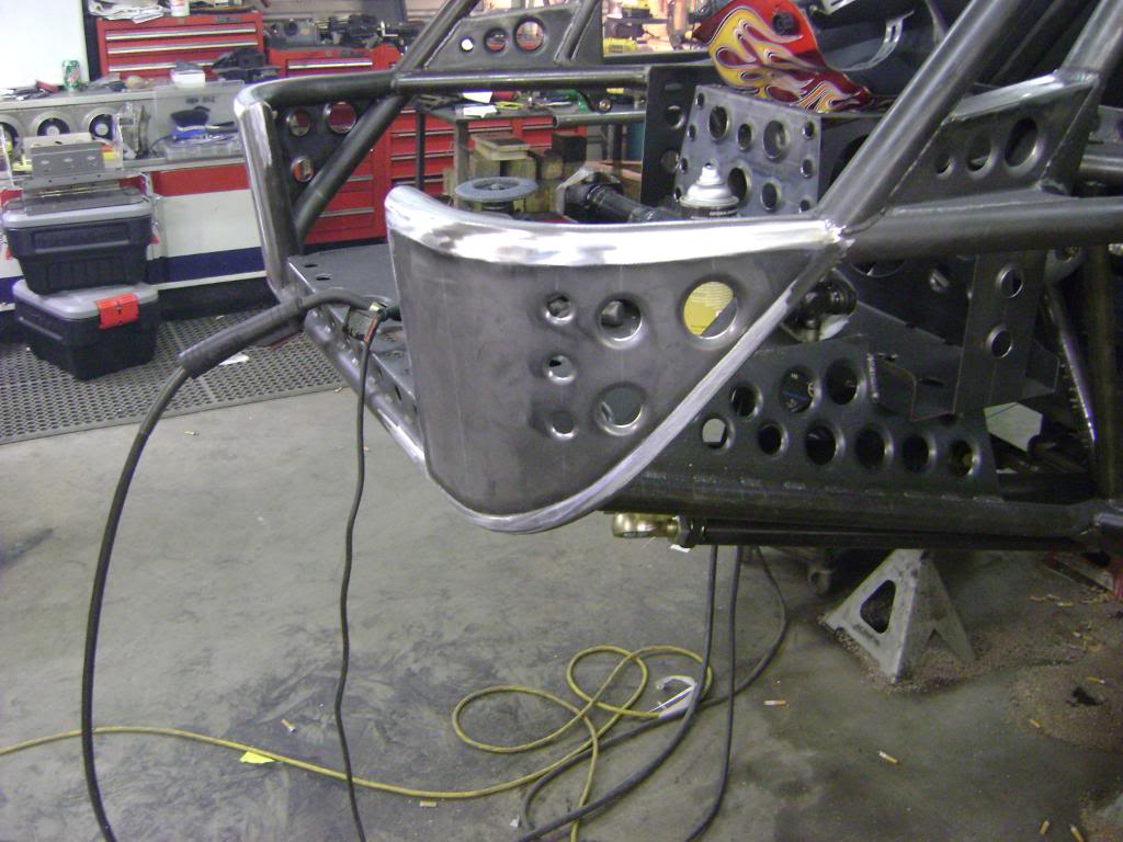

How the heck do you blend the sheet into the tube so well?!?!
Oh yeah, looks killer btw :D

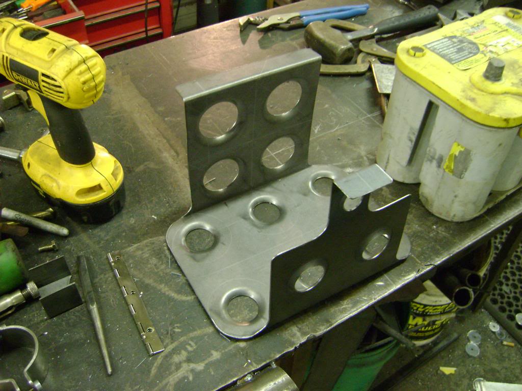

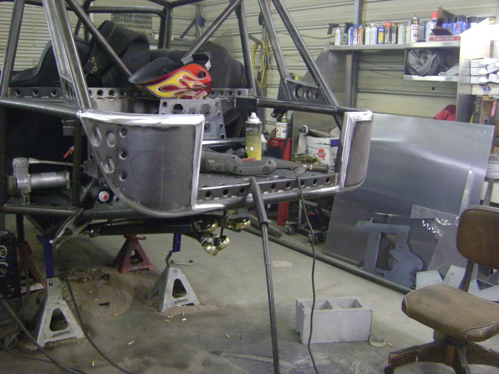

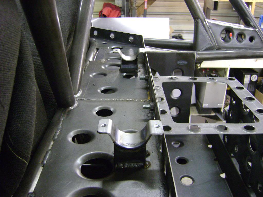

I really dig the use the dimple dies. I'm curious as to how much weight you lost doing that and how much strength (stiffness?) you gained.
yea i am too, i shoulda put em all in a bucket and weighed them upon completion.
the blending just takes patience and a good flap wheel and i keep multiple grinders (4) loaded with different wheels all the time saves switching discs.
just wore out my second grinder of the build tonight.

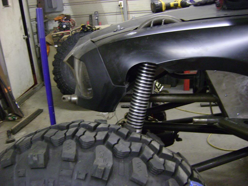

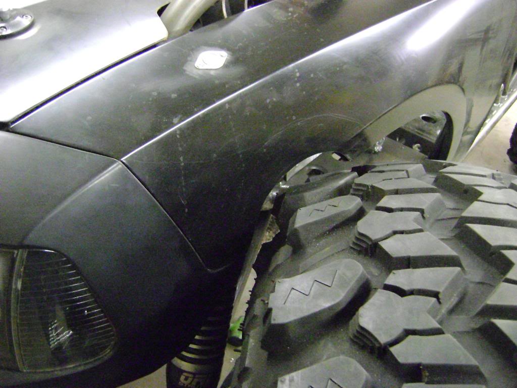

yea that was my initial plan. i had hoped they would fit in these openings if they were switched and inverted, but they would have been very vunerable and look like a second thought, therefore going with the typical buggy ovals. using the lights from rides with the reverse white leds around the circumference. plan to keep my eyes peeled for a tailight in the future that may fit the "car" in this opening, i can always modify later.

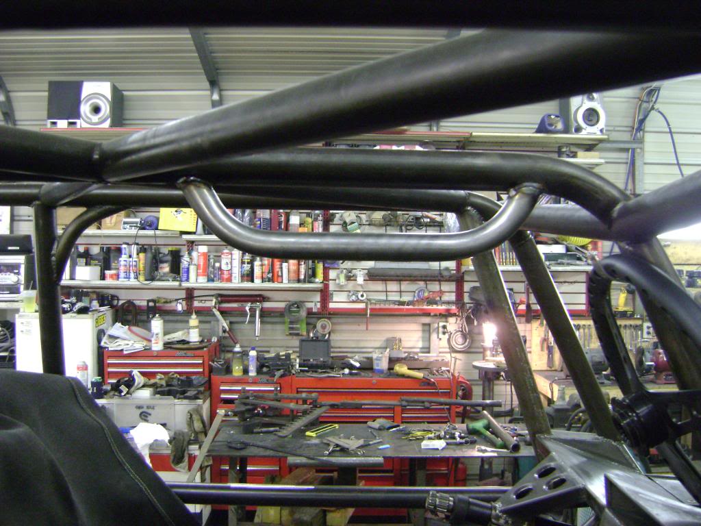

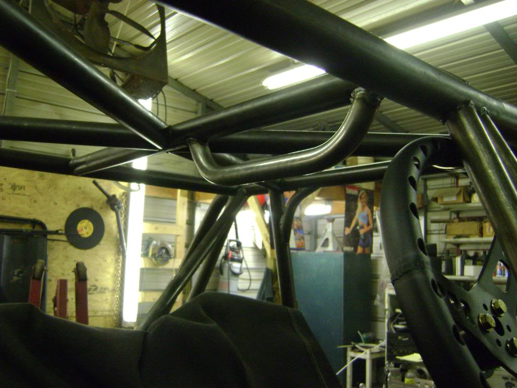

dude your getting so much done, stuff I've probably forgot until a pre run (like oh crap nothing to grab onto)
