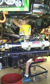

Getting ready for the farm! My lil helper Carter giving me a hand with clean up and dial in the crawler.
And tomorrow new shoes....racelines, 43" SX stickies...!!!
He fits between the crank and radiator much better than I do.
I think he's had enough and ready to wheel!
