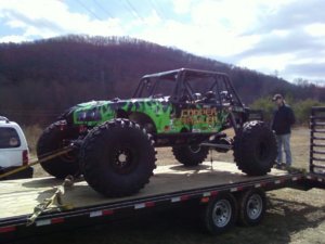

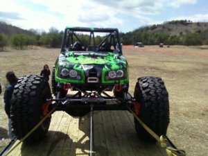

Well I'm at the flats now w the buggy. Not fully operational yet. Haven't bled any fluids or topped of. Just a trailer queen this weekend due to a bad fuel fitting and other associated crapola. Terry, wish the wife a great bday! I'll post some pics of the crawler n a bit. It at least looks finished. Lol.

thanks for all the kind words guys. had a great time at the flats this weekend! again, nice to put more faces with screen names and make new friends. unfortunate that we couldn't wheel the buggy this weekend, but at least jason and i won't have to eat dust and mud while we finish it up this week.

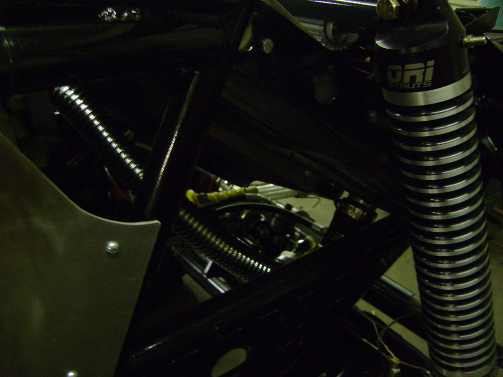

we unloaded at GMP friday morn (mar 25). recharged the ORI's once more for trail riding fine tuning. Started with a very soft rate; searching for the "cloud of titties" cushioned ride. ended up with 185 over 90 on all four corners, which by the end of day (or night i should say) ended up alil low on the belly height i was looking for; roughly 19". the ride was superb! no more rubber chicken neck bob, very smooth flowing ride. as far as performance of the links; IMO excellent!! disclaimer----this is my first link setup, and my experience with building and/or riding in a linked rig is very virgin. with that said, i feel that the link geometry works damn near perfect for my style of wheeling; I am certain some other builders with more experience may find flaws ,as will i with more seat time, but first impression was spot on! there was ZERO lift upon throttle application, as well as Zero squat, very neutral. along with no noticable/uncomfortable body roll on sidehill or heavy cornering. Zero hop on climbs on either axle as well. i was overwhelmingly impresssed with the ease at which the buggy climbed, articulated, and hooked up for excellent traction; with the assistance of the 42" SXII's which to date are the best tires that i have ever hit the rocks with, even with the slippery conditions and wet weather we encountered that weekend.

saturday DavidG4x4 met me at the park to do some ORI testing/tuning. we reset the shocks for some go-fast settings and played with pressures and dampening while doing some hot laps on the gravel around the park. it didn't take david long to get me running twice as fast thru some medium radius 90 degree turns. with every adjustment we went faster. we also got the ride height more dialed in and stiffened up the dampening substantially, while maintaining full use of the chrome on the shaft. it was an eye opening learning experience for myself, as someone with no experience with shock tuning. i'm a rock crawler by nature, and in the last year have just begun using more throttle in climbing, but damn; fast is fun!
