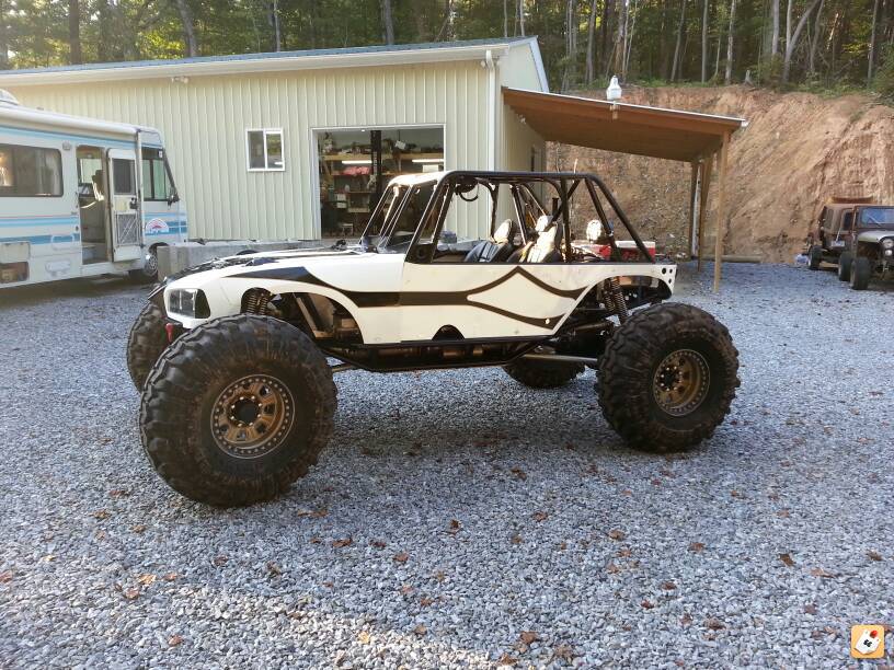

Well, 3 years since I began the build on this buggy. Not much has changed since original completion. Biggest would be the motor. Lt1 gave up after a big jump at the flats, quickly sourced an ls2.
Breakage to date: aside from aforementioned engine and related problems with said engine=== ZERO. No links (some have slight bow), joints, belts, hoses, driveshafts, not even a u-joint; one stazworks wheel bent in the race at Uwharrie, but that's it. .... well there is that short on my cigarette lighter. ...:eek:ops:
And I don't baby it-ask redneck, brittan and landcruzin bout the 11pm crackhead run...
So really only changes have been asthetically and Armor;
New color scheme

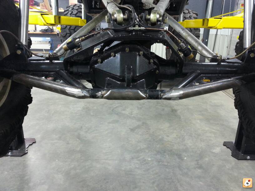

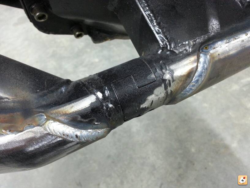

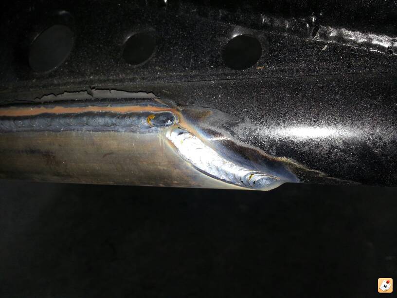

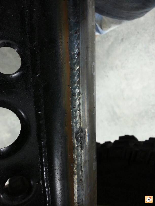

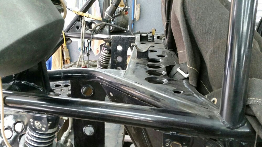

And alil recent armor on my much abused rear truss. .
2" .120 split over the existing 1.75

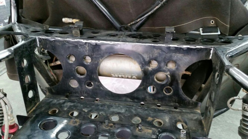

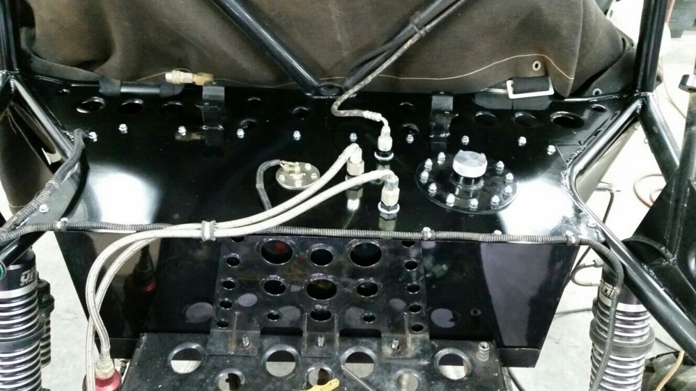

Fuel cell replacement;
Rci unit split at Dixie run and they replaced it with a poly tank with steel container. Had to rework a little bit for fitment.
original set up :

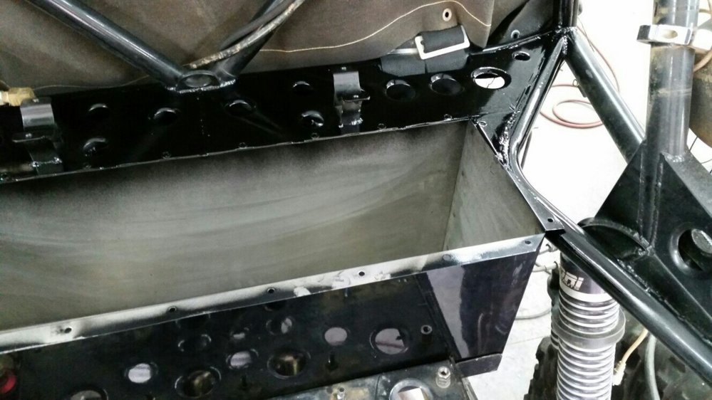

Removed the tray to flush mount the cell with nutserts across the back

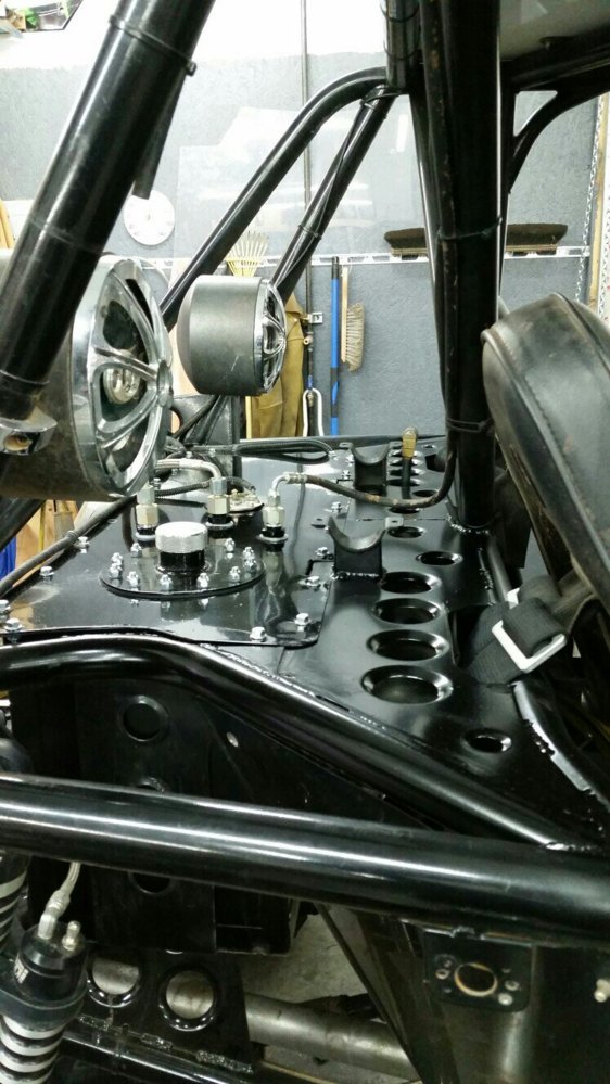

Completed
