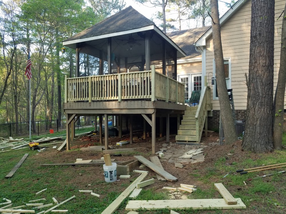

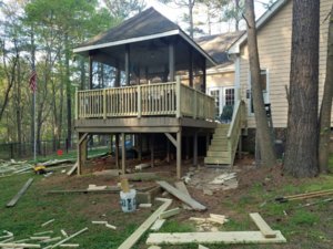

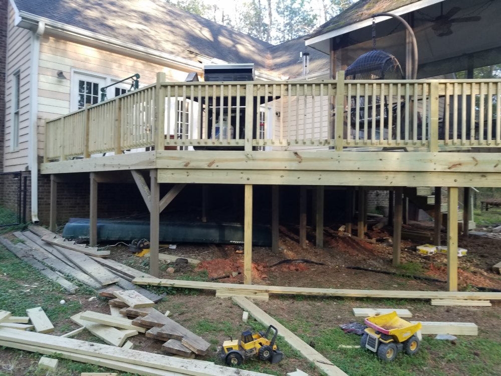

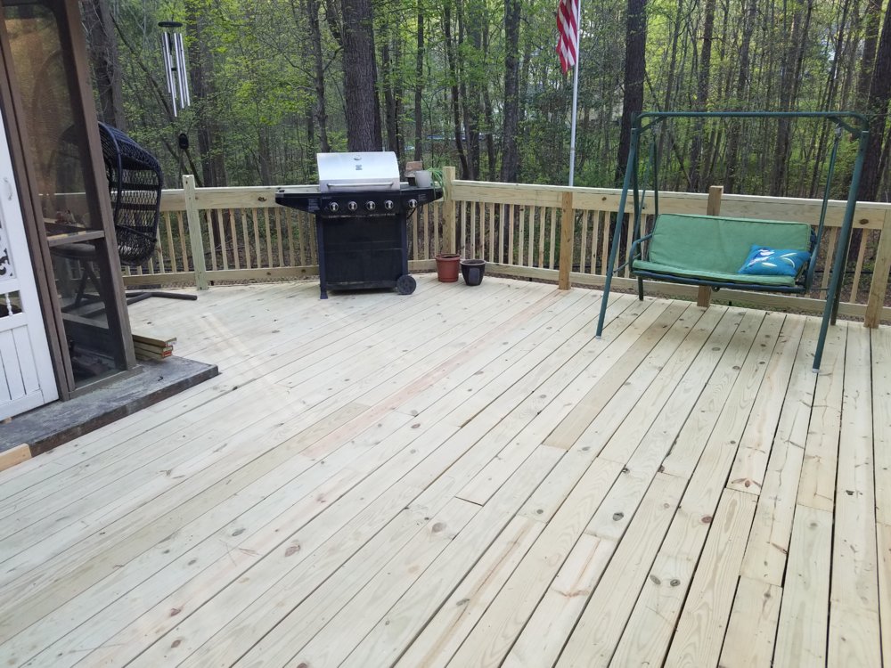

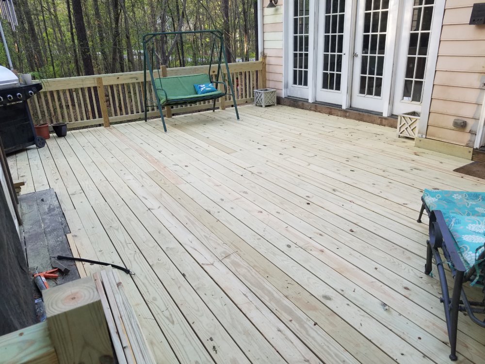

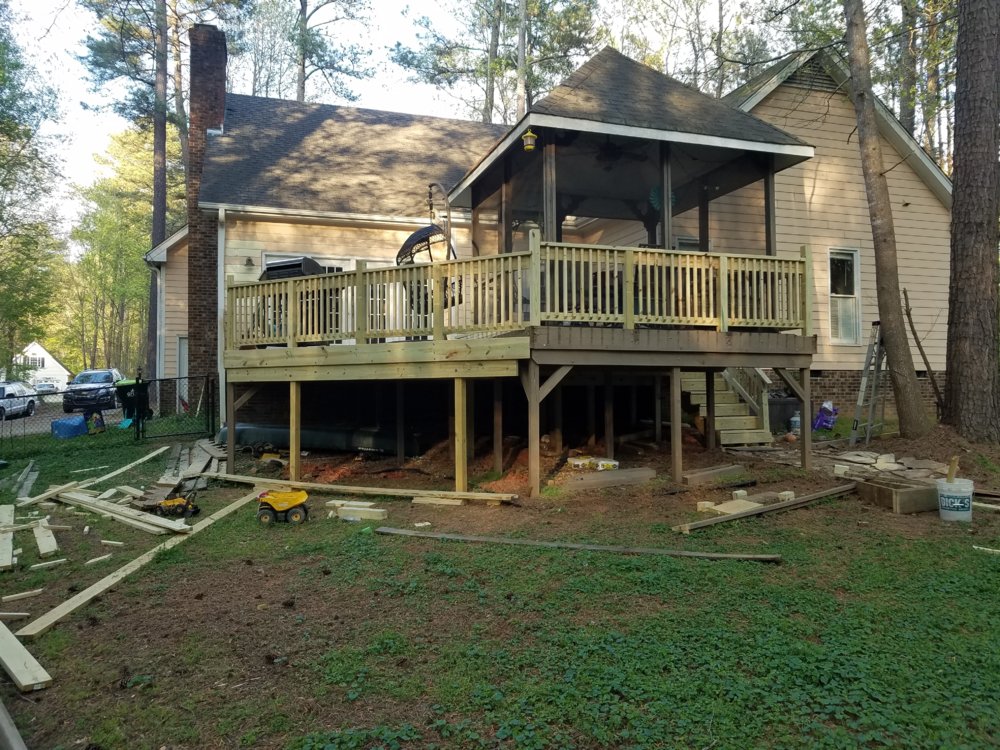

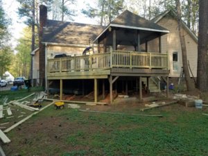

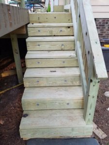

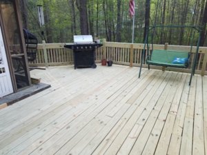

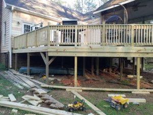

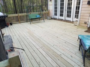

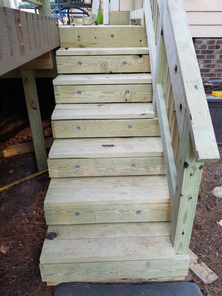

Deck is done! I have a few odds and ends to do and still waiting on the lights to get here, but for the most part it is done. Grilled out some steaks on it last night. We went from about 260sqft of deck space (not counting the screened area) to about 500sqft. The screened porch also used to be this weird little poke out off of the old deck, looked really dumb. Now we incorporated it into the layout of the new deck so it really fits in nicely now.

This was my first time doing any screen. We used Screen-tight system from Lowes. It definitely got it tight and should be easily fixed if it gets torn or loosen up
Do you have any up close pics of how it went up? Screen-tight system that is?

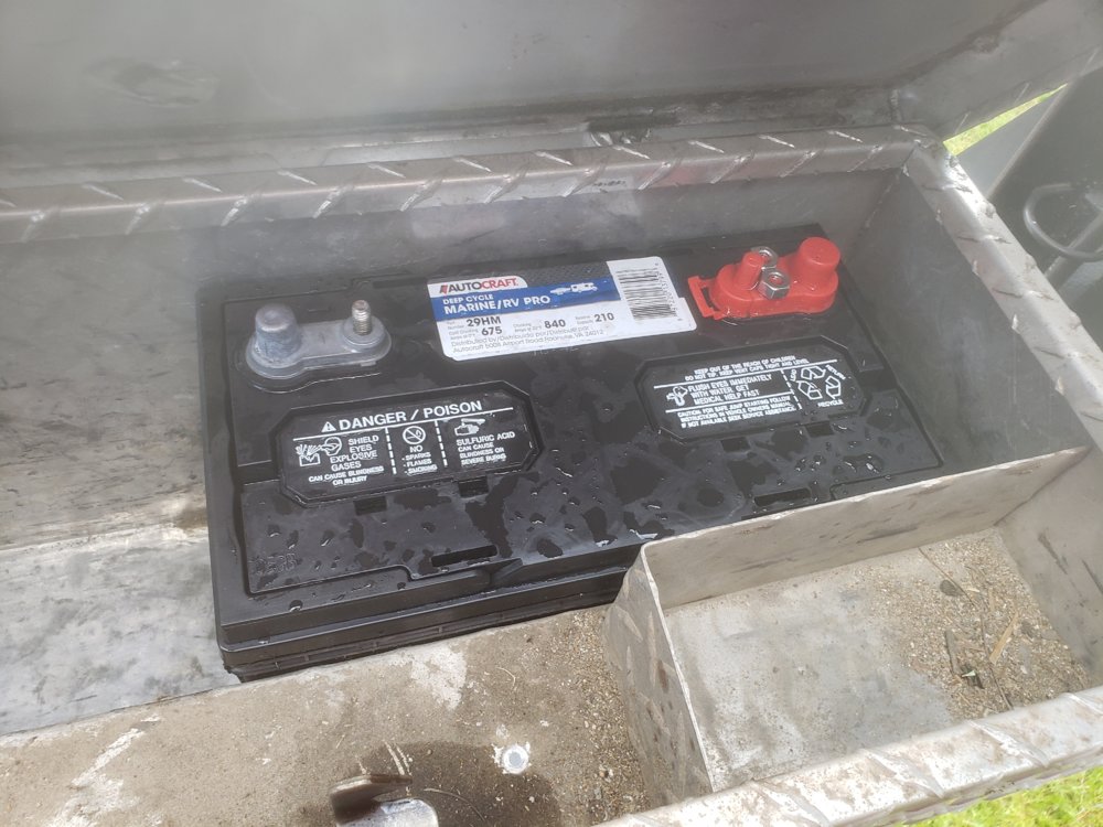

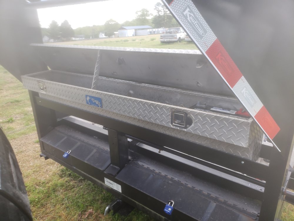

Wanted more storage on my trailer so I mounted up a FB special side mount tool box between the uprights. Battery fits perfect. Now to order the quick connects for the winch and wire up some loading lights and a solar battery tender.

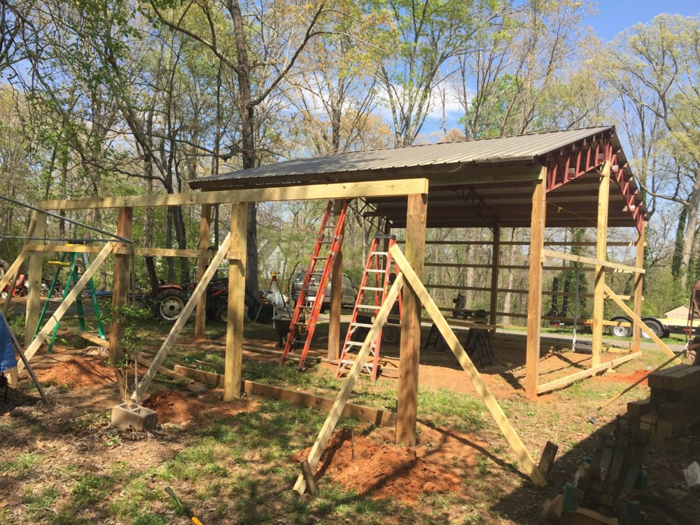

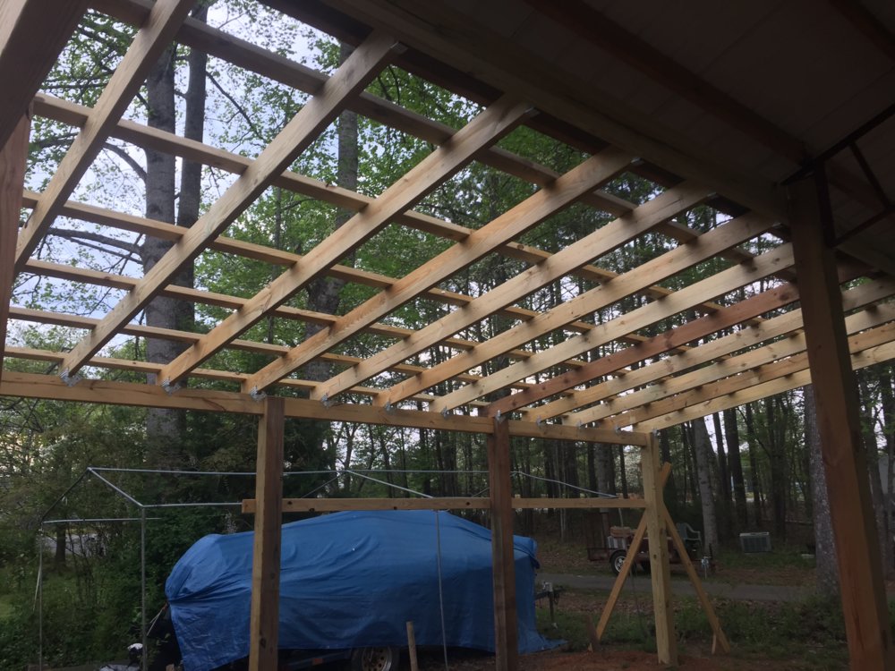

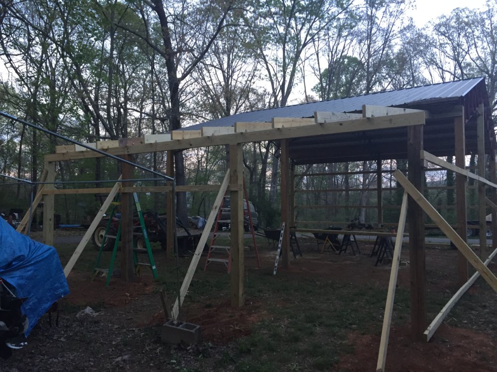

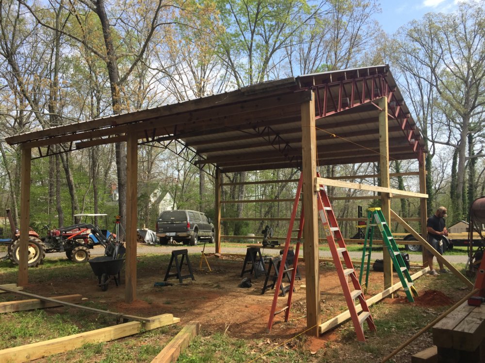

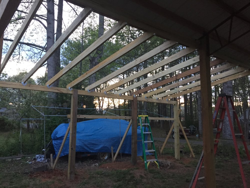

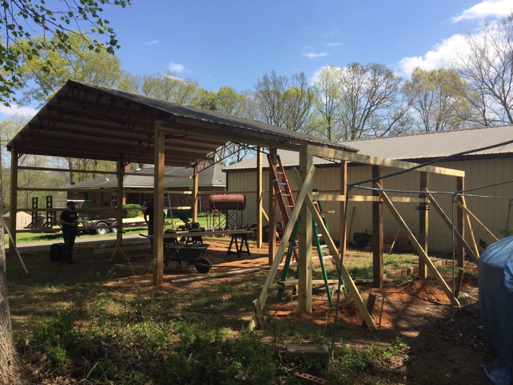

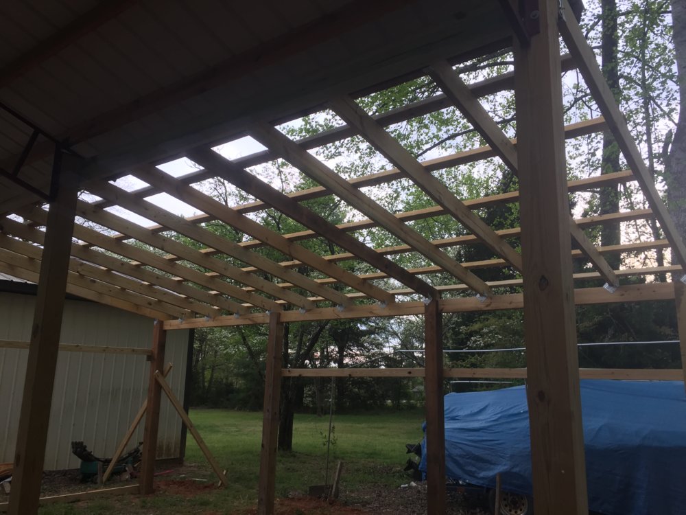

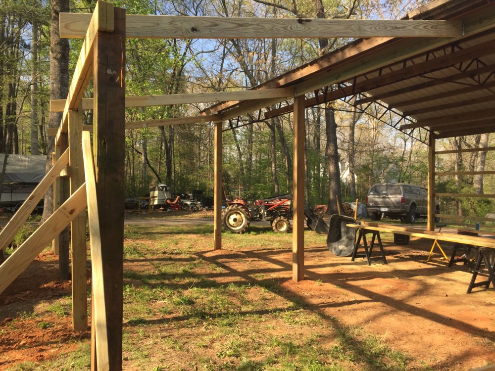

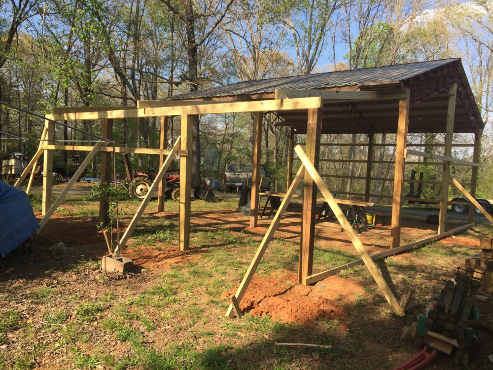

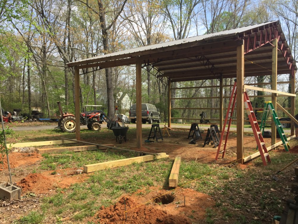

Little more progress this evening. Ordering metal tomorrow. Hope that check gets here soon... lol

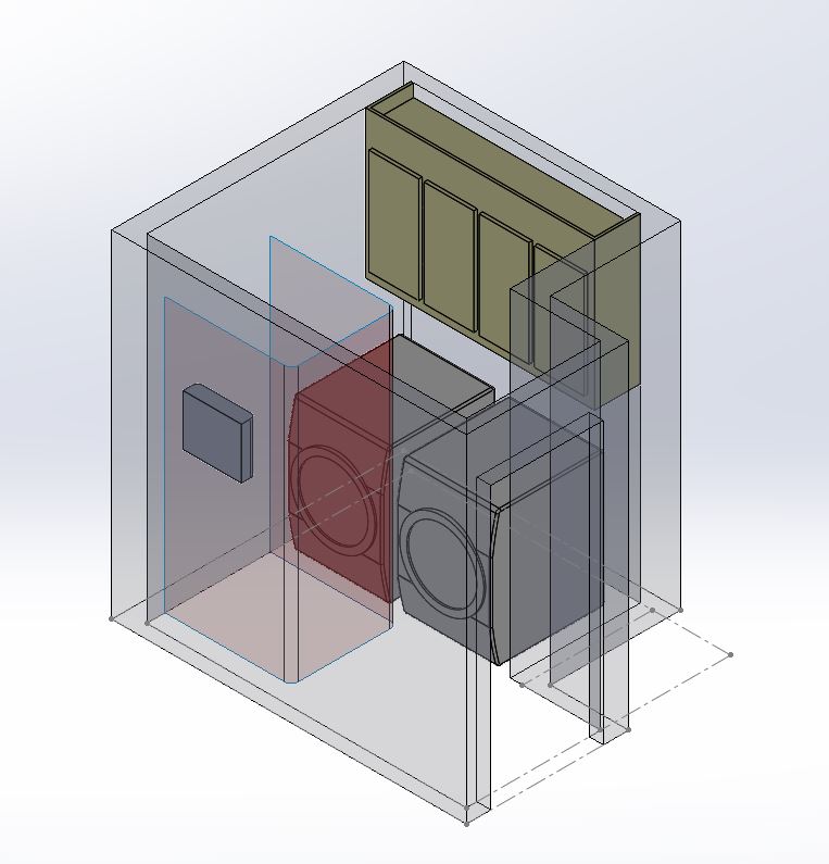

Reconfigured laundry room in CAD while watching Netflix. It's a pre-project for my project.
This is Rev 5, believe it or not. Everything fell into place when I decided to go with an electric tankless instead of gas tankless, because the gas tankless wasn't going to fit. Too big, too much depth off of the wall, bad options for venting on exterior walls, and was interfering with everything (the door swing, the breaker panel clearance, whatever).
But it all fits, including the inswing of the door that's not shown.
I think the entire room is about 6x7 minus the notch, I can't remember exactly. Most houses have bigger walk-in bedroom closets than this laundry room.
  • Add storage cabinet
  • Relocate washer and dryer
  • Remove and patch up the disintegrating exterior mudroom door (the room barely big enough for the washer and dryer, not to use as a mudroom)
  • Move the breaker panel inside the house (the pink box is the 30x36 panel clearance footprint by code; panel not shown)
  • Add the electric tankless water heater (small gray box on the wall, not sure what final position will be)
  • Double-stud that small section of wall to make a wet wall to relocate the toilet and shower drains in the master bathroom (directly above this room).
Now I have to figure out the details of patching up the wonderfully shitty Thermo-Ply sheathing and beaded wood lap siding. I need to find a source for that siding profile that's closer to me than Raleigh. :mad:

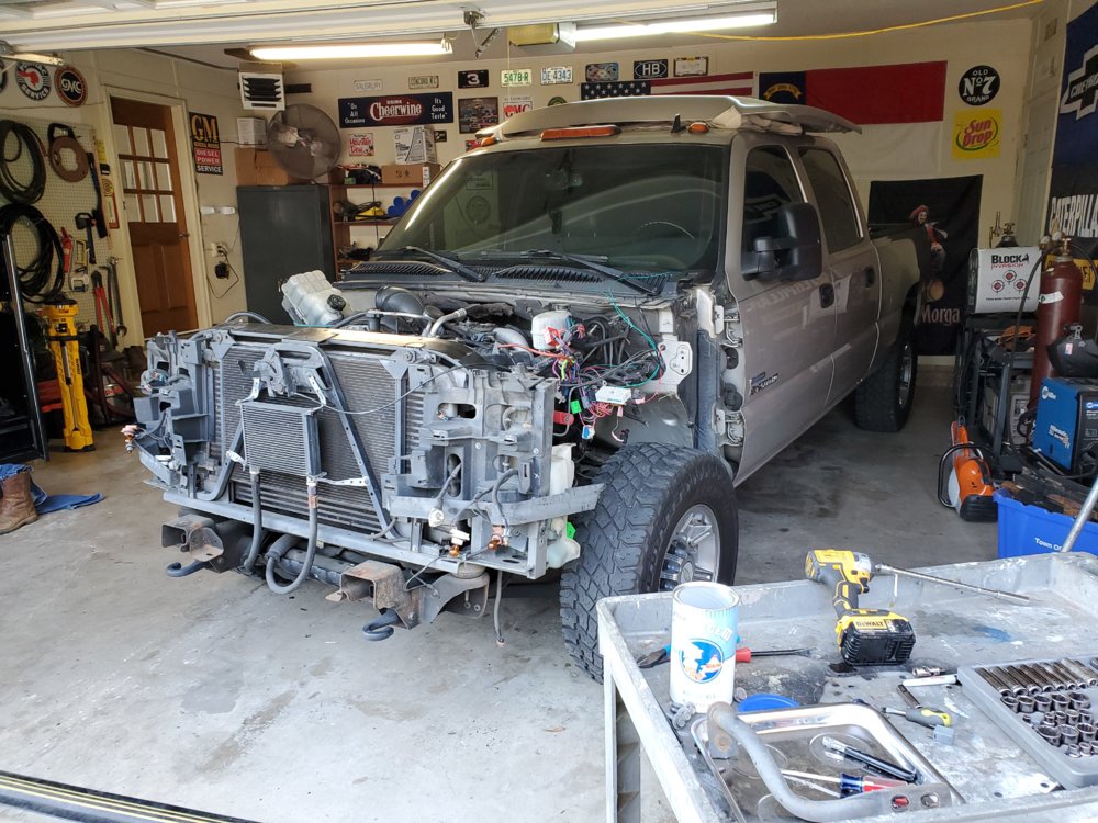

Trying to help a buddy with his daily, lbz duramax needs headgaskets. This is why I discourage anyone from owning a diesel that doesn't need one and cant work on it themself. Local shop quotes were around $7500 and up, new gm long block is $6300... should be back up and running for ~$2000 just in parts :shaking:

Add 50% to your projected cost of this laundry room remodel. This will be the only $200/sqft laundry room in 3 counties when you get done finagling it.
Nah, just a laundry closet, but I definitely got a laugh out of that. The whole point of CAD was to make everything fit, not to make it really nice. It's getting new drywall because I have to modify 4 of the 5 drywalled surfaces (it's just easier to replace it all for a room that small), and it's probably getting some glue-down Marmoleum tile because I love Marmoleum. The existing 30-year-old linoleum is about 20 years past it's replacement date I think.
The concept of a Pinterest-worthy laundry room has always baffled me. I'm not doing ceramic tile, or wrought iron shelf brackets, or a reclaimed barn wood accent wall, or painted letters that say "Home" or some bullshit like that.
Who knows when I'm going to start on this, because I'm not going anywhere close to a Lowes or Home Depot right now. I've never seen their parking lots so full, and that's during a mandated stay at home order........
No I didn't take any of the install or any up close.
It's pretty simple. They make tracks for either 2x4 or 4x4 framing. I made 1.5" frame that went inside our 6x6 post and screwed the track onto it. Two man job putting the screen in and rolling the spline in. Then cover with the trim piece.
That's going to cost a fucking fortune.
How much is a fortune? Do you think the $1500 rough quote that I got was too low?
Sounds like a bargain compared to what it would take to keep it in the current location (right where the garage will join to the house). It's part of the garage budget, and a good upgrade for the rusty old panel full of failing breakers.
Electric water heater is like $600, which is probably what just the gas line plumbing for a gas unit would cost. The electric WH is probably about 1/3 the price of the Rinnai with gas plumbing ($1800-ish)
And probably double the operation cost
