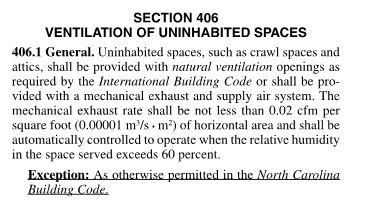

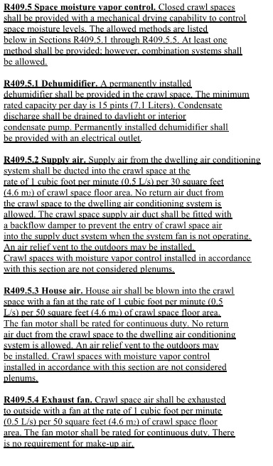

You ARE installing mechanical ventilation then, correct?
I don't see where it's a good idea for the crawl space to be negatively pressurized.
Absolutely not.
But at the rate required by the NCMC it's a fart fan and 10x18 intake/exhaust louver at worst case. Unless you're treating the space like a "finished area" (which it doesn't sound like he is)
I just did an apartment complex at Elon College with 6100 sq ft crawlspace, and the calculations required a 12x18 intake (250cfm) and a 250 cfm inline fart fan ducted to a 12x18 exhaust louver (miniscule air movement). We DID however use (3) Ebac EIPL CS 60 dehumidifiers linked to humidistats. Commercial, yes, but still, ventilation/humidification in a crawlspace is a must unless you LIKE mold
It's not that big of a deal. You're going to want a dehumidifier down there, anyway. Just buy a cheap one and pipe the condensate to the exterior. Then provide a bit of air from the HVAC system to positively pressurize the space.

Part of the install is a 109 pint/day (max) dehumidifier. They put that in today along with the Zoeller sump, after the electrician put in a new breaker and two outlets for them. So I'm covered by NC 409.5.1 it looks like. The dehu isn't going to do much except suck moisture out of the bare clay for a few weeks until they do the liner install, which was their goal apparently so the liner would be easier to put down and position.
