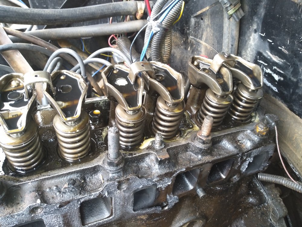

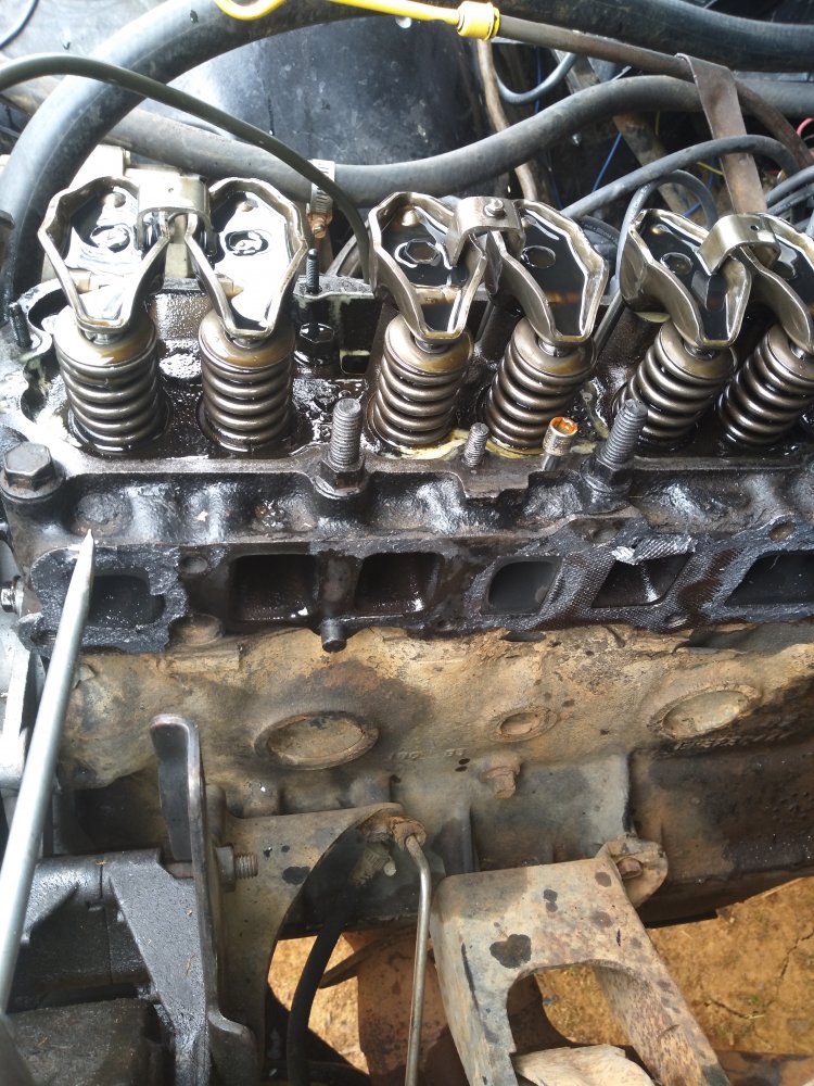

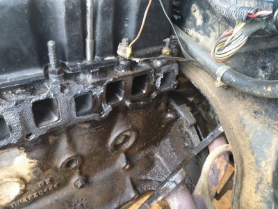

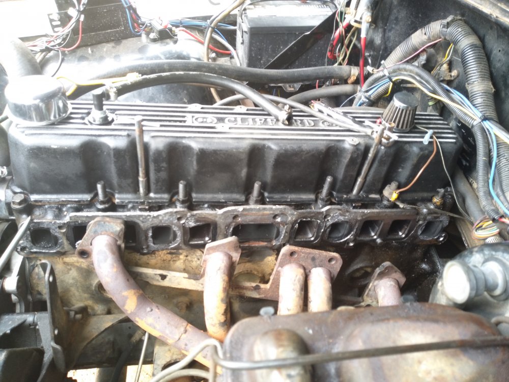

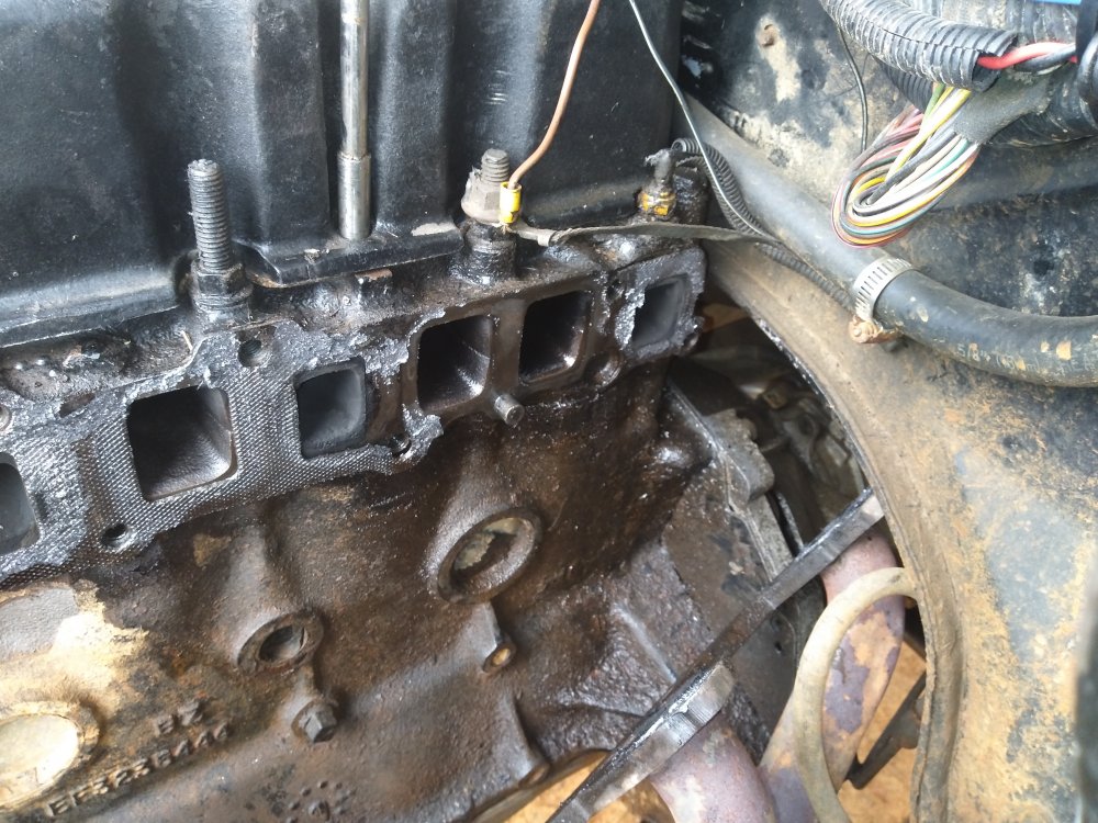

Decided to take the leap and R&R the head. As mentioned it already needed a new manifold gasket whether I could fix the crack in head or not. After removing intake and header I could see that the rear portion of intake had been leaking on the block.

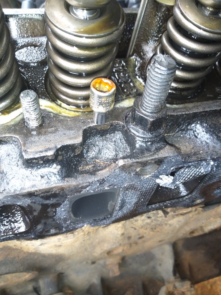

In the pics you can see where tip of screwdriver is pointing and just below small socket. That's where PO welded 3 cracks. I expected to see more emulsion/mayonnaise under the valve cover. There is some due to sitting and short drives all winter.

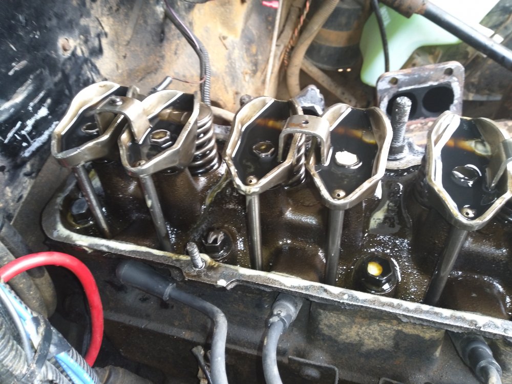

Lots of oil pooled on top of rockers and pretty clean. Oil pressure is about 55psi cold and 40-42 warm at idle.
I got everything done down to pulling head bolts and removing items connected to it. I broke bolts free in reverse of mounting procedure that I found. I'm going to install a rebuilt head since I don't want to do it again. I won't break head free until new one arrives. I don't know if that matters.

It won't matter either way but good on ya for tackling it. It's really stupid simple. Follow the torque sequence with the new head and head gasket and all will be good. Same goes for the rocker bolts. I was right where you are not 2 months ago and all is still good DDing mine.

Personally I'd just swap rockers and bridges. If you haven't taken your rockers off yet don't be freaked out when the bridges bend. Just straighten them back out. You'll see oil grooves in the under the bridges. Make sure they line up on every rocker. Itll make sense when you see it. As for the pushrods, I could be totally wrong, a few thou wouldn't make a lot of difference on this engine. I would probably be wrong to do so but I'd clean them and run them. These engines are just sloppy with tolerances.
