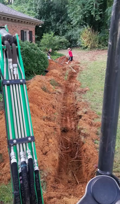

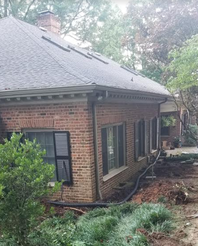

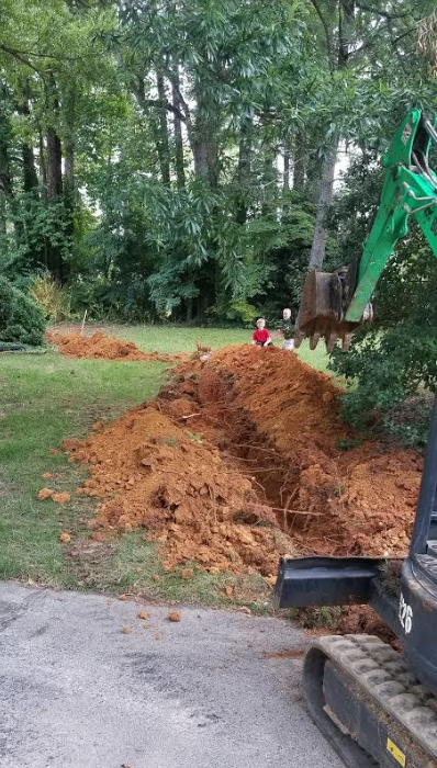

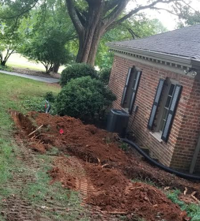

All good man, I'm working on getting all my down spouts draining away from the house. Trying to eliminate some of the moisture problems that already exist first.
