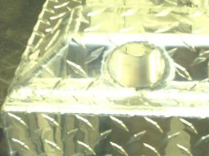

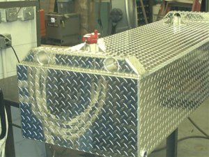

Just finished. 3/16 Polished Diamond Deck, 100gal capacity

diesel fuel, A/C Tig set at 230amps 220 Hrtz and %bal At 60
(Dynasty DLX) with hand control It's 3/16 no need for pulse.
Mig was done with Dedicated wire machine with a Python push pull feeder at 21.5 volts and 415 on the feed
looks good but who has enough money to fill it up with diesel
He's grading contractor and his perfectly fine steel tank wasn't purty enough for his F550 and diam/deck sideboards I fabbed for him.
