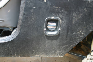

Hey madssjeep, can I get more info on that fuel tank and mounting?
hey bubby, Its a stock CJ 15 gallon tank, I wanted a YJ tank but it did not fit my application( too wide). basicly before I built the tub I finished the suspension, flexed it with the tank in several locations and once I found one that worked, I fabbed some brackets and welded it in. The fill is located on the side beside the opening The hard part was clearance. I had to design my floor up about 2" above factory location so it would clear. You can't tell by the pics but only a person about 5'6" or so will fit in the back. My head is equal with the cage and I am 6'1".
