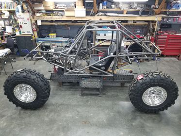

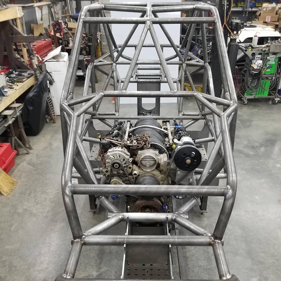

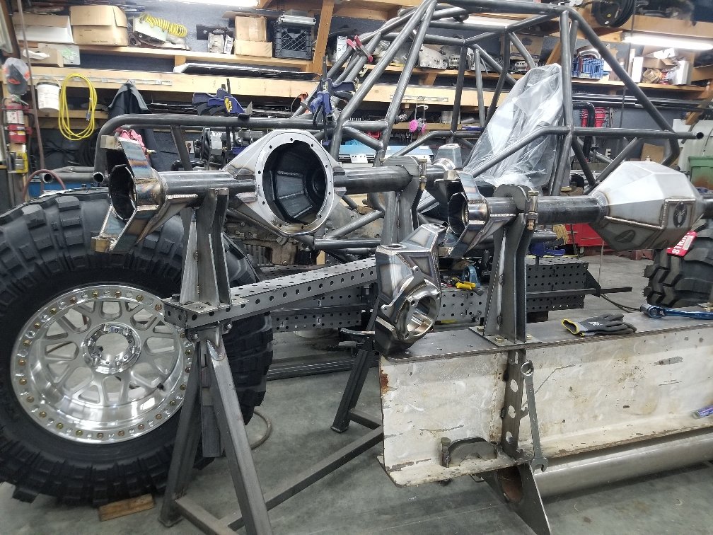

Coming soon... CutlerFab chassis #001 RCT- right coast trail
Taking inspiration from many of my favorite chassis designs, dating back to the OG #twistedcustoms classic roof lines, #jimsgarage simplicity, and as late as #reddot brilliant packaging- with the similar door, because bad knees
Drew Burroughs

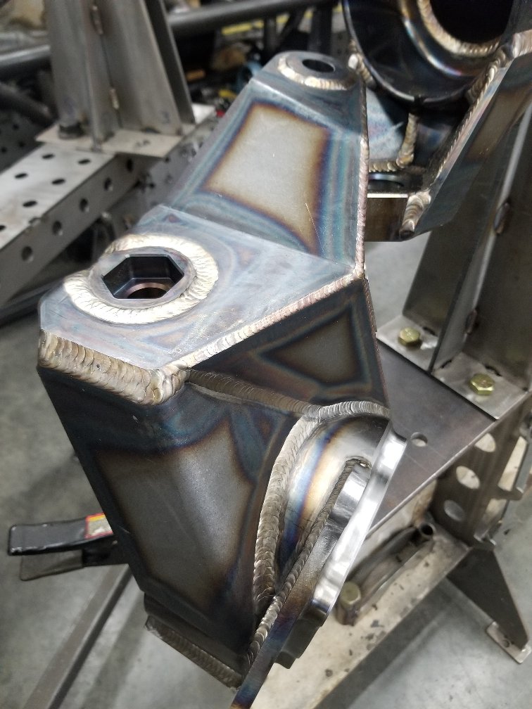

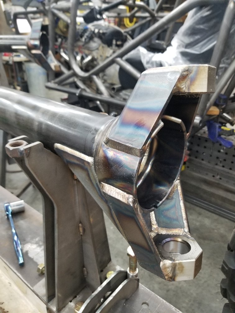

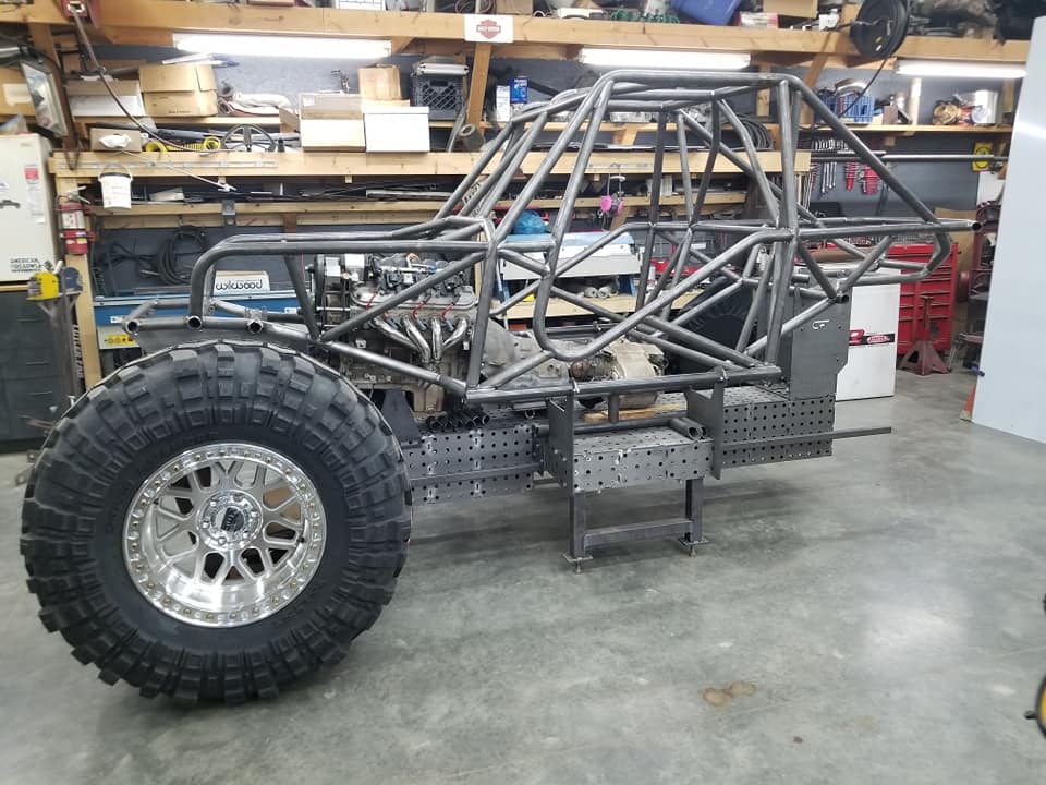

@goatbuilt jumped in with the jdsquaredinc #dragon and his CNC expertise to bring the 50", chromoly chassis to the NC mountains. I then designed a fixture for my certiflat @weldtables and we had it lasered as well. There is a generous mix of 1.75" and 1.5", with varying wall thickness from a .188 subframe, .120 mains, and .093 supports. Fully tig welded with precision in the laser cut chassis fixture, with my duet of @everlastwelders.

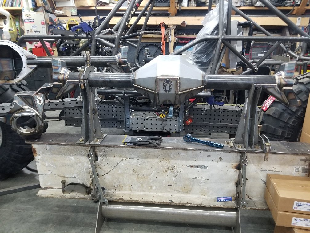

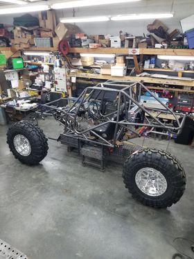

The #001 ship flagship build will be complimented with 71" Spidertrax housings with pro knuckles, 40 spline 300m shafts and Gearworks HP" thirds.
Scott Trimarco

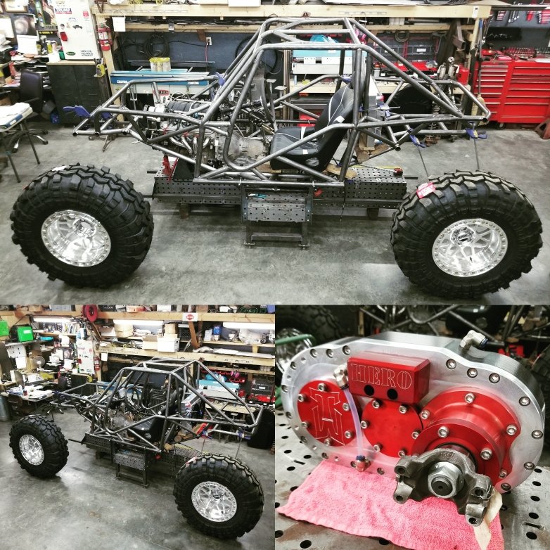

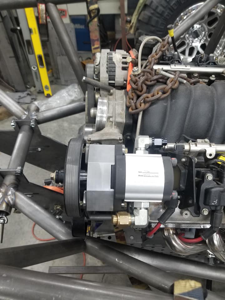

, #scottscustomoffroad gear pump and @psc_performance_steering rams and orbital. Cooling designed by John Lehr-Webster @johnnyscustommotorsports_ and @crracing . And of course the standard rolling stock of the east, @intercotires 43"x20 sticky SX, wrapped around @kmcwheels #235 grenades from Scott Goforth @goforth_motorsports_inc and stopped by @wilwooddiscbrakes. @prpseats to keep me comfy and safe, suspended by @fox 2.5 coil overs and dsc adjusters. Standard powerplant of LS2, th350, and atlas tcase.
Looking for it to hit the trails in late spring.
DOM and chromoly Chassis pricing to land by 2021.
#maketrailridinggreatagain #firstchassis #weldeverydamnday #fabricationlife #shoplife #cutlerfab #eastcoastView attachment 328587 View attachment 328589 View attachment 328591 View attachment 328594 View attachment 328595

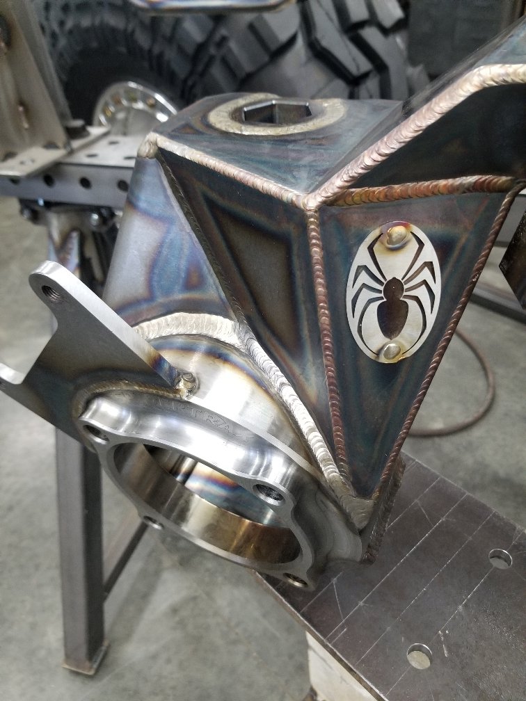

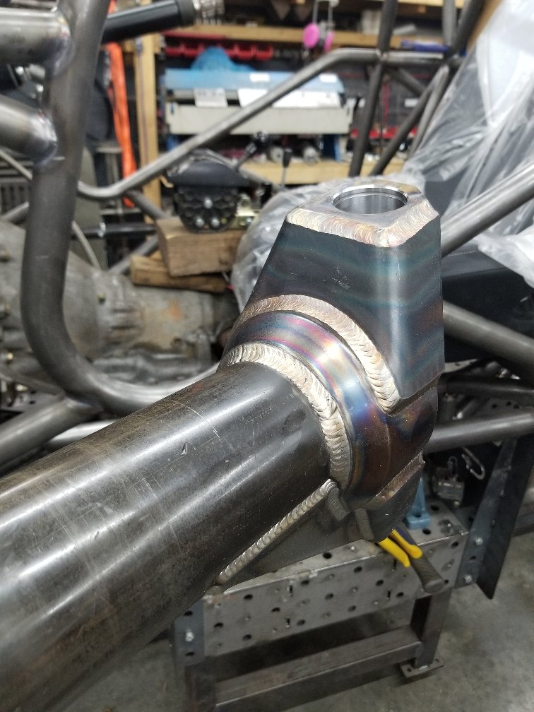

... and I remember a year ago when you told me you were gonna “keep your head out of it” and build a simple buggy just to get back in the woods. I told ya your OCD wouldn’t allow that. Glad to see another work of art in progress. You know I’ll be following along.
I’m an avid MiG welder, it’ll look ok most times and fantastic other times. Won’t win any awards but I’ve never had a weld fail so I trust them.
The other night over at Rev Limit Fab I had the chance to try some Tig for the first time. Having tried it now myself now gives me an entirely new level of respect for your welds. I can’t imagine laying tig welds like that in some of the awkward positions needed to go around tube and other places you must wind up in.
Beautiful work, I love the way you made it easier to get in and out with the swept down bar, Most have a straight bar that you have to climb over. What's the wheel base?
-Thanks RQ. My knees aren't getting any younger... no more flat door bars for me. I'll offer the chassis with a straighter option for those who are not a fan.
-wheelbase will be 115-117, trying to get equal length lowers. I have a little wiggle room.

- It is a glorious aggravation :D. Tig is certainly a different skill level, with a plethora of variables that can make or break a successful AND aesthetically pleasing appearance. The challenge is enough to drive you crazy, but once you have enough hood time and find that CLICK, it all starts to come together. I'm happy with my bench work, my out-of-position is getting close. Cannot be in a hurry, ever. I've invested my time and money to get some training from three of the best in the nation. Money well spent, because I don't have the time to get where I want to be on my own, like I did with mig.

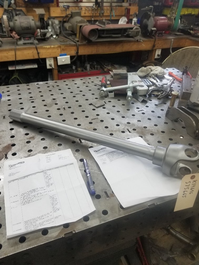

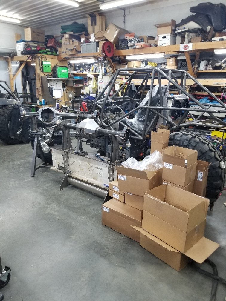

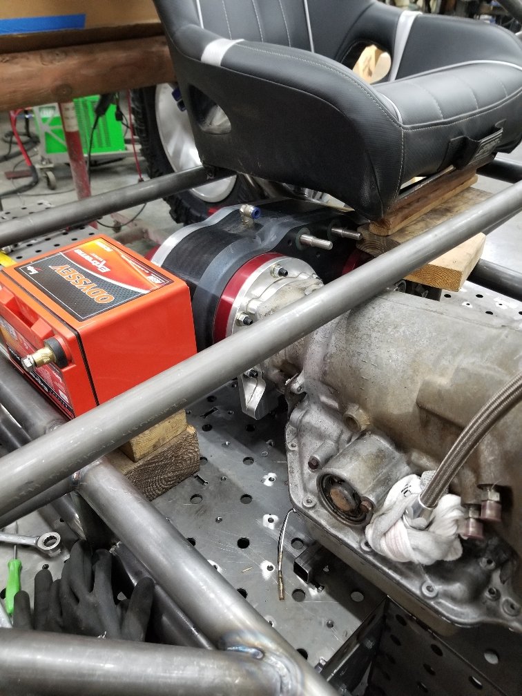

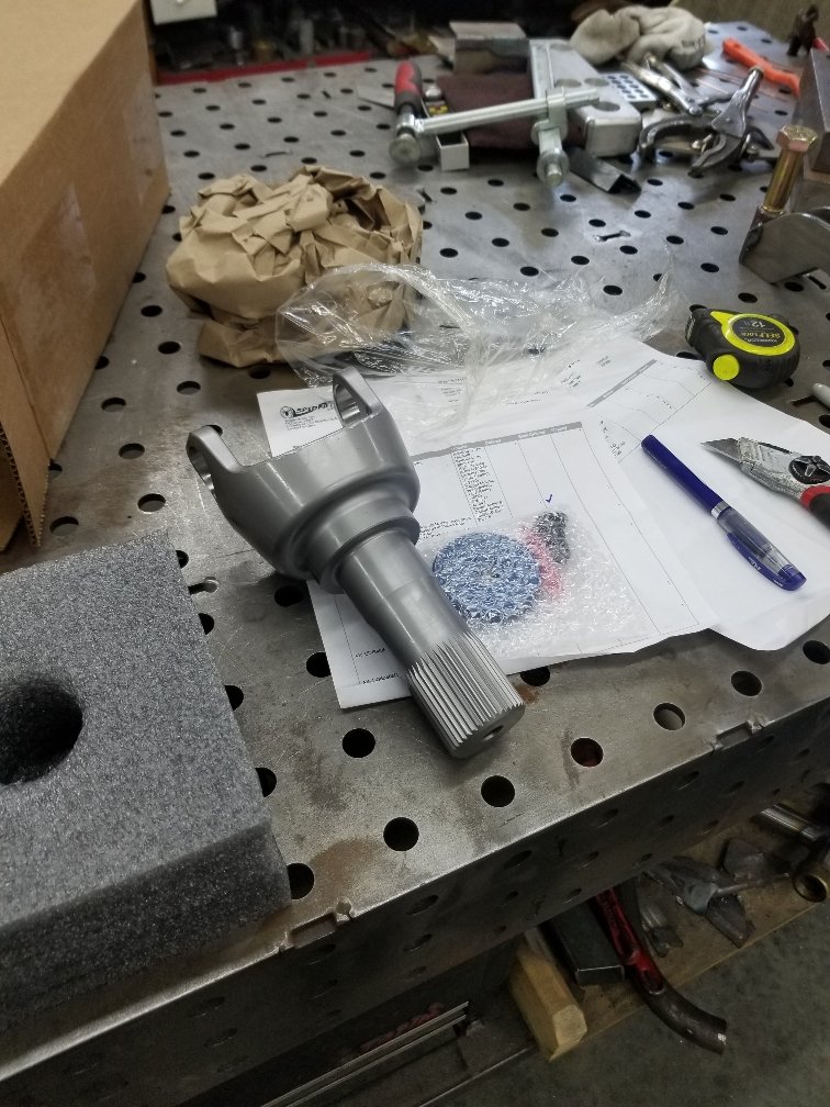

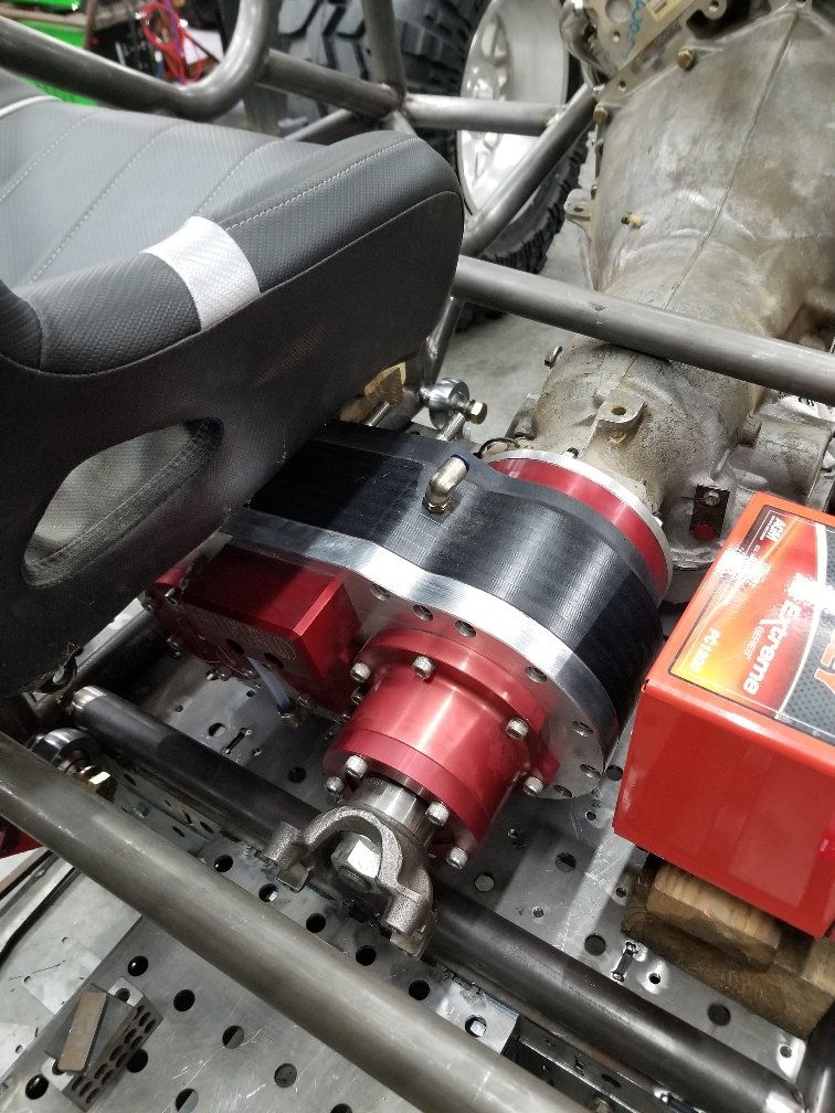

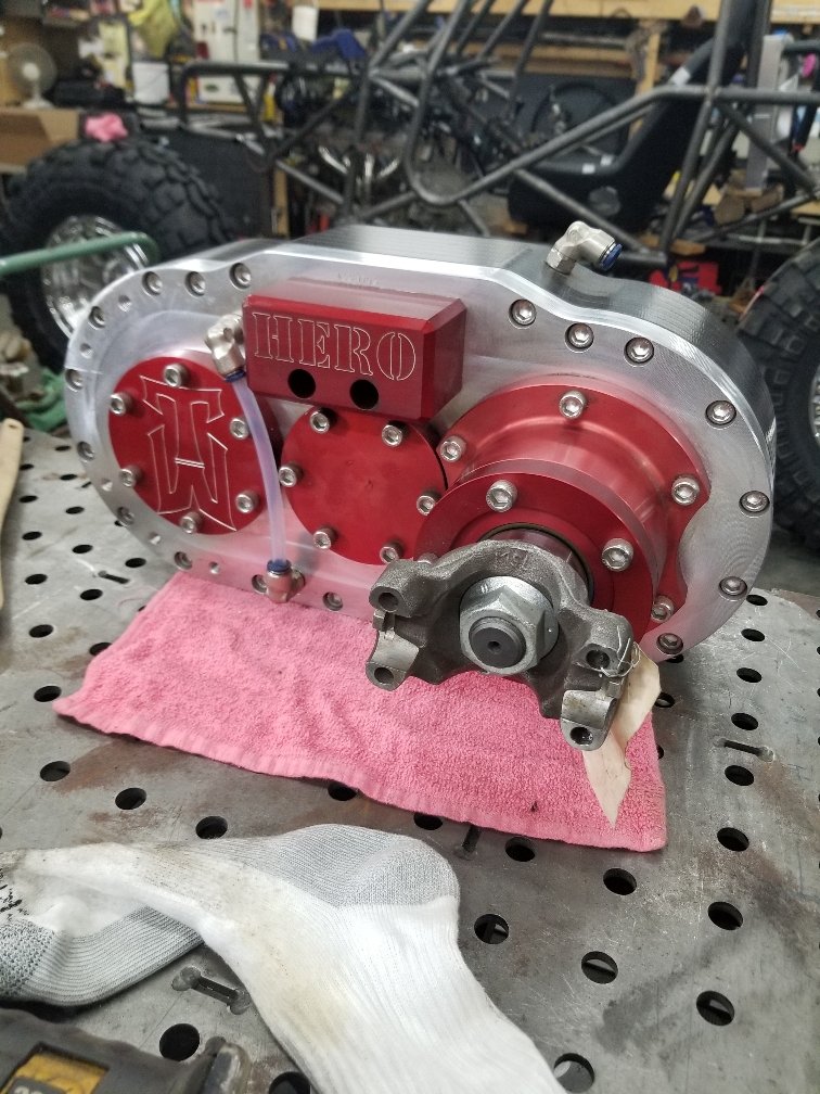

My 45th b-day present to myself arrived today...[emoji7]
40 spline candlesticks in 300m...
Complete hub- hub ST assemblies. Gearworks Hp10's arrive shortly.
