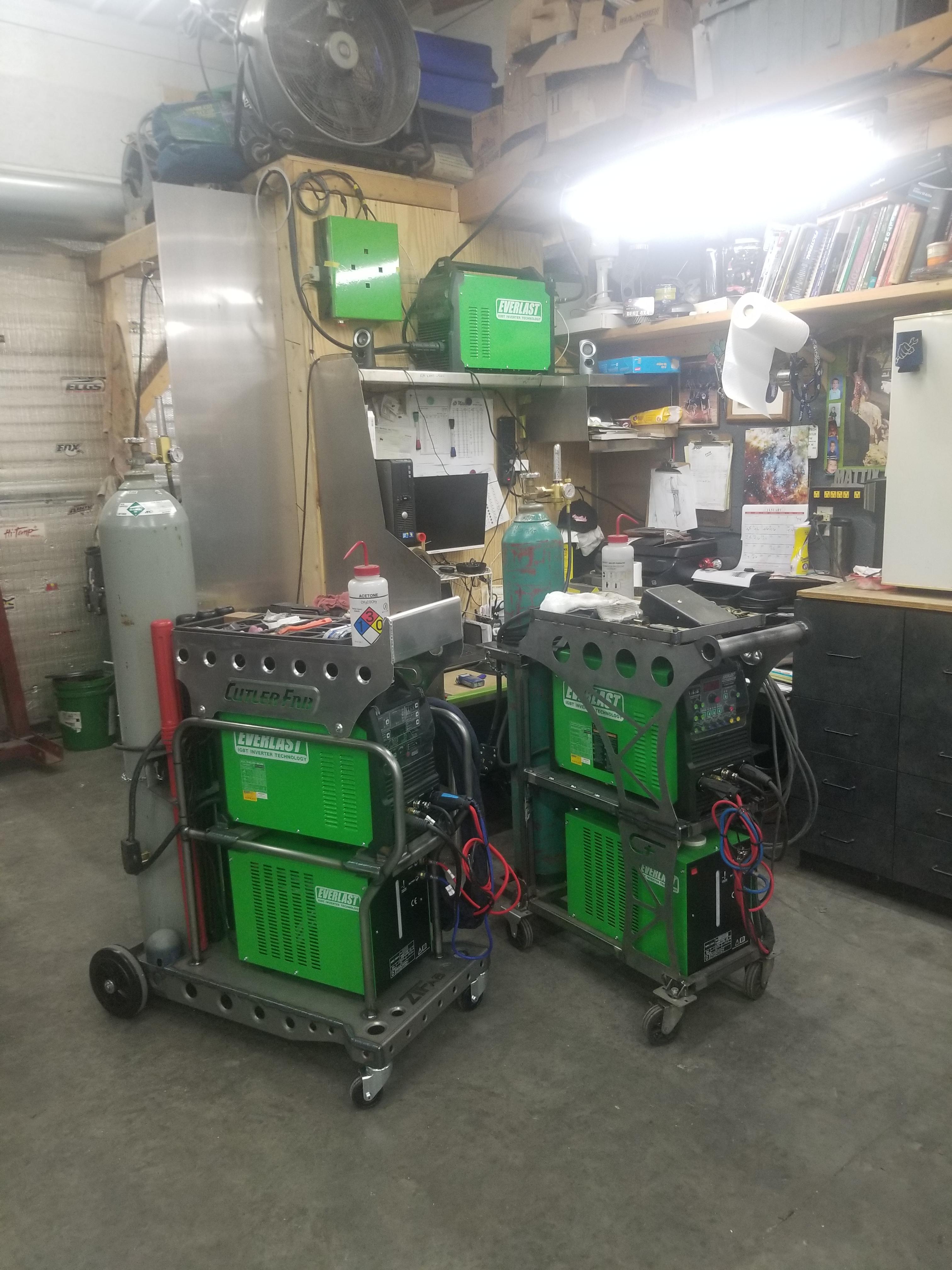

Must have a big shop to rotate 12-16' off chassis. I intend to fixture a rotisserie to the table soon for final welding of future chassis. Weld out, with the chair in one spot...
I actually had two everlast water cooled machines set up on each side of this unit, so all I had to to do was walk to other side, rather than drag hoses and pedals all day
Always fun to have good equipment to work with. I've never used that particular brand of welder, but a water cooled combo like you have looks like it's hard to beat. I like inverter welders. Their easy to move around. Always have a heartfelt for the little water cooling machines they match with. I feel like they produce a some extra play. Basically, you have 60 hertz of electricity coming out of the plug on the wall. The inverter type welder amplifies the hertz to probably 400 hertz or something. I've found that the extra hertz allow for more strategic puddle placement. Maybe more importantly, I also believe that some of the more strategic, well known "badass" welders I know, don't know how to tap a welding machine. Guaranteed, I know people trying to figure out the difference between a Dynasty 200 and a Dynasty 700. Never rolling over 175 amps, they'll boast the 700 machine welds better. It's ridiculous. I think the inverter welders use less electricity than the transformer welders. I have a big badass, old 1995 transformer welder or something corner model syncrowave 351, and the only way I can figure to make it work better is to put a longer lead on it than the 25 foot lead I have on it now.

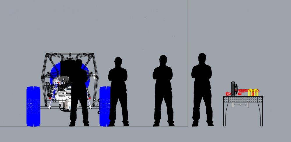

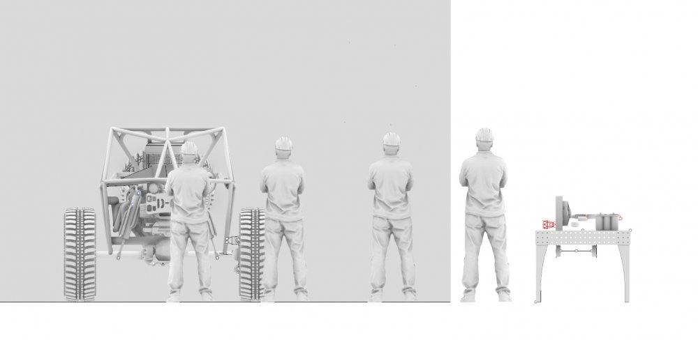

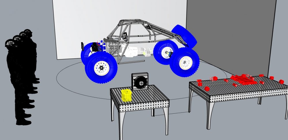

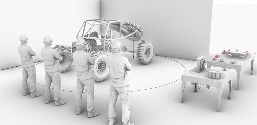

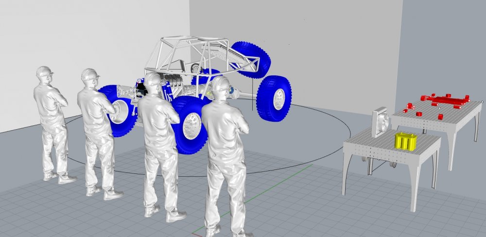

I was able to get two of the standard issue Moto-Bilt welding tables lined up in the shop towards the side of my rotating frame table to potentially build some fixtures for my control arms. I could move the tables 3 to 5 feet closer to the car because it rotates on a frame table bearing.
