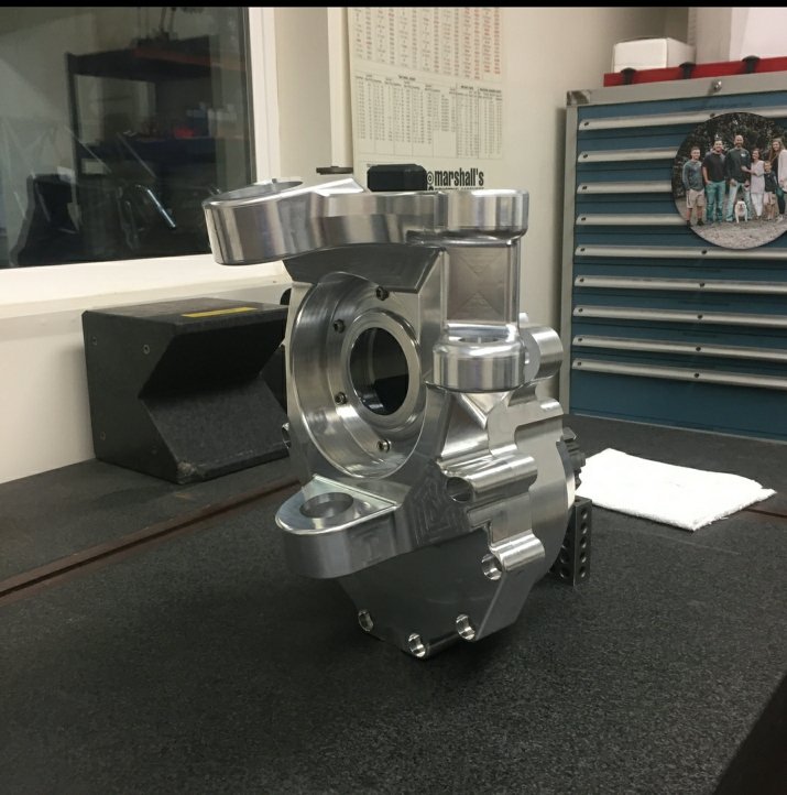

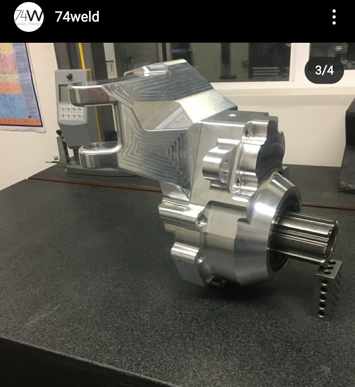

My long time friend, Big Tommy, who runs C&S Machine works in Mocksville, NC told me that if I want to design this knuckle, I will have to draw the machined edge .0005 to .001 smaller than the bearing races I want put in it to press them in.
It looks like if I embark on machining this knuckle, the Spidertrax unit bearing is gonna be thrown out the window, and I will have to start from scratch with either an existing stub shaft or a custom one.
So I guess now the question I'm gonna have to work through is how am I going to make it a full float design.

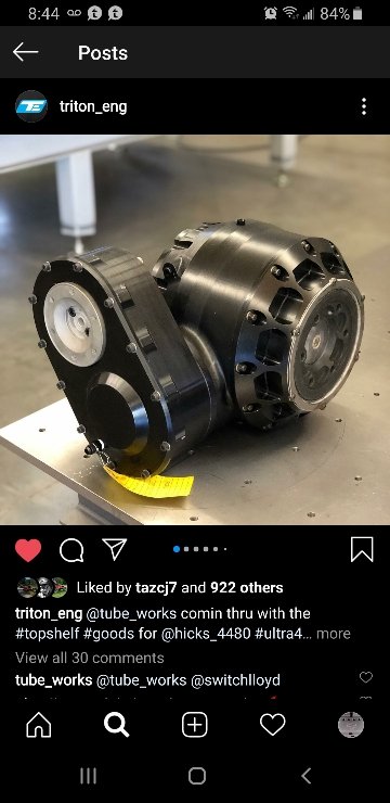

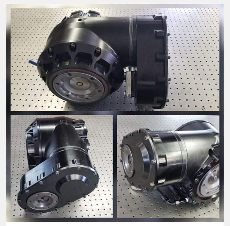

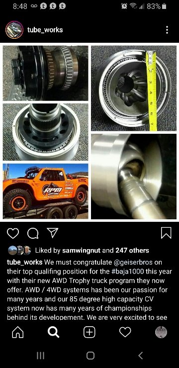

Tubeworks says their differential will accept a 10 inch ring gear and a 9 inch ring gear. The face to face width is 9.3 inches. The height is 11 inches. The pinion will be connected to the ring gear at the bottom for a two-wheel portal design. The stub shafts on the inside are 35 spline, and the differential can run 934 CV's and series 30. The price is $18,500.

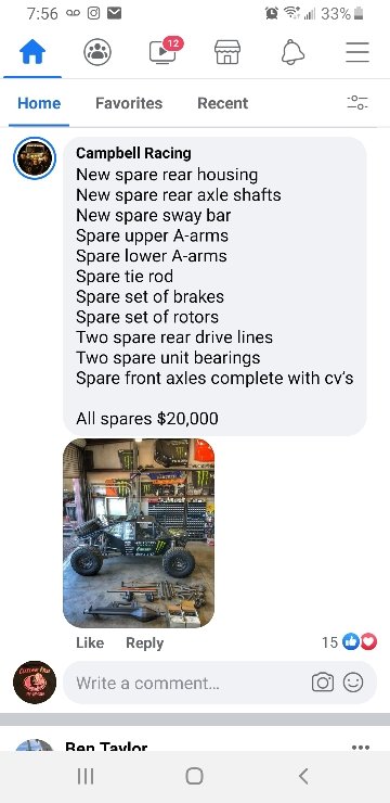

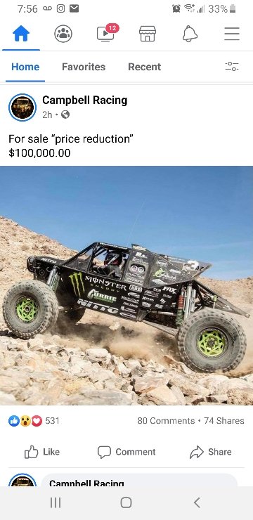

That's it, the original. On sale to build mirrors of the new cars that bailey, wayland, and Brian crofts, that were built in the last two years. Parts/ team shareability... smart co-op racing on PROVEN components and platform.
I wonder who's personal rig that is. Thinking that was 2 cars ago for him. I don't know. Maybe they still have it. I saw lately, he had the Dragon Slayer on the cutting block for $275,000, or something. I think something new in the industry spooked them. I feel like their full on deck building a new car.
You think they have been spooked ? I'd say that's pretty obvious.
I'm thinking the Campbells have found this thread and are so scared by what's going on that they are promptly selling all their cars to retire and not be blocking your way on the lakebed.

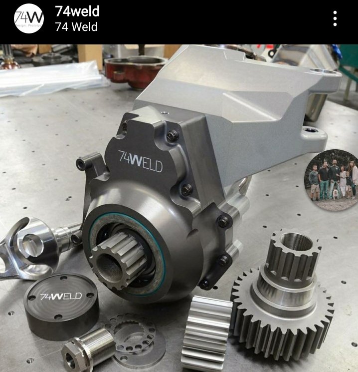

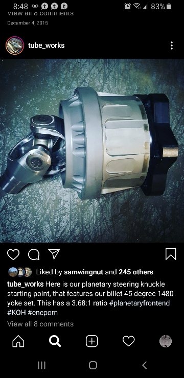

Portals are fun; you need to plan all your suspension geometry around them, use fancy high BS wheels, plan for much higher stresses on links and pivots, higher COG, etc. You don't just slap them into a design. My Axletechs created a whole host of issues that needed to be designed around and dealt with. Independent suspension adds even more complexity.
Thank you for the comforting words. I feel like you said a lot of things that were real world correct other than the BS big wheels.
