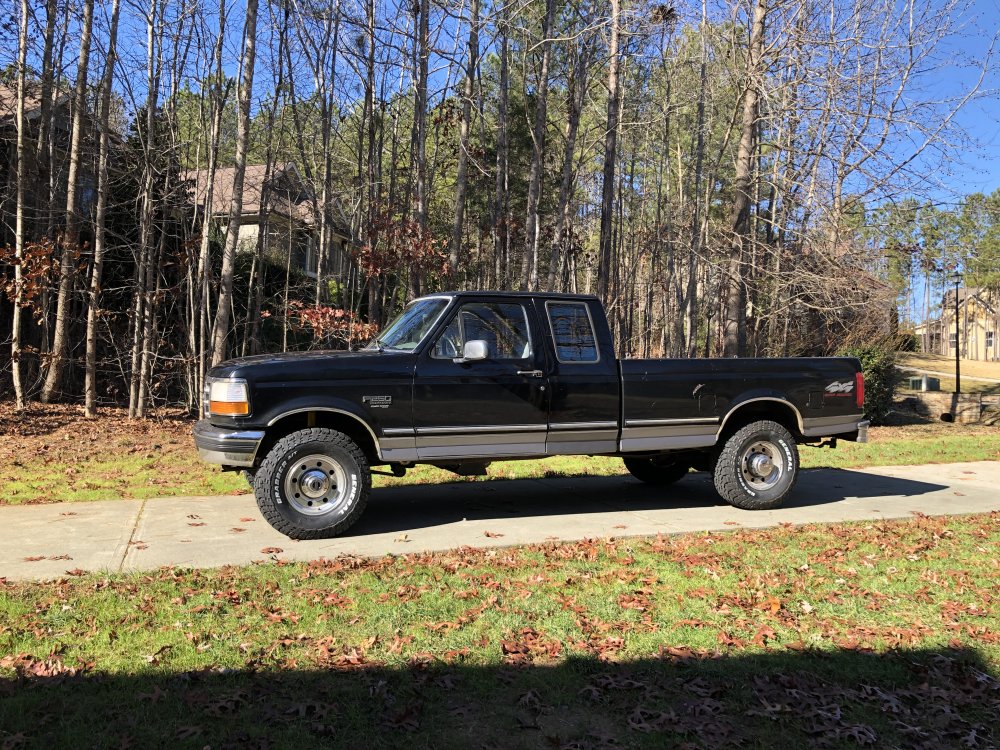

If you pull the rear diff cover to change the gear oil, I'd obviously make sure the ring gear bolts are tight and the tone ring is in good shape. It likely is though since you said the speedometer works just fine.
Sweet truck though! That was one of their best body styles!

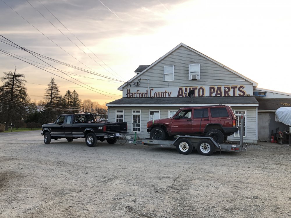

Dale is getting driven all over the place! Drove up Friday to Maryland to visit friends and race the mini bikes. Sunday morning I woke up and helped a friend pick up a new roof for his FJ60. Unfortunately my transmission problem came back on the way to Long Island to get a d60 for Dale on Monday. I found out it was the PSOM module on the back of the odometer. Found another cluster on marketplace on our way there and swapped it in a Wawa parking lot and kept on motoring. Speedo jumps a little still so I’ll change the VSS for an OEM one and check the tone ring. My original cluster is getting sent out to be rebuilt.

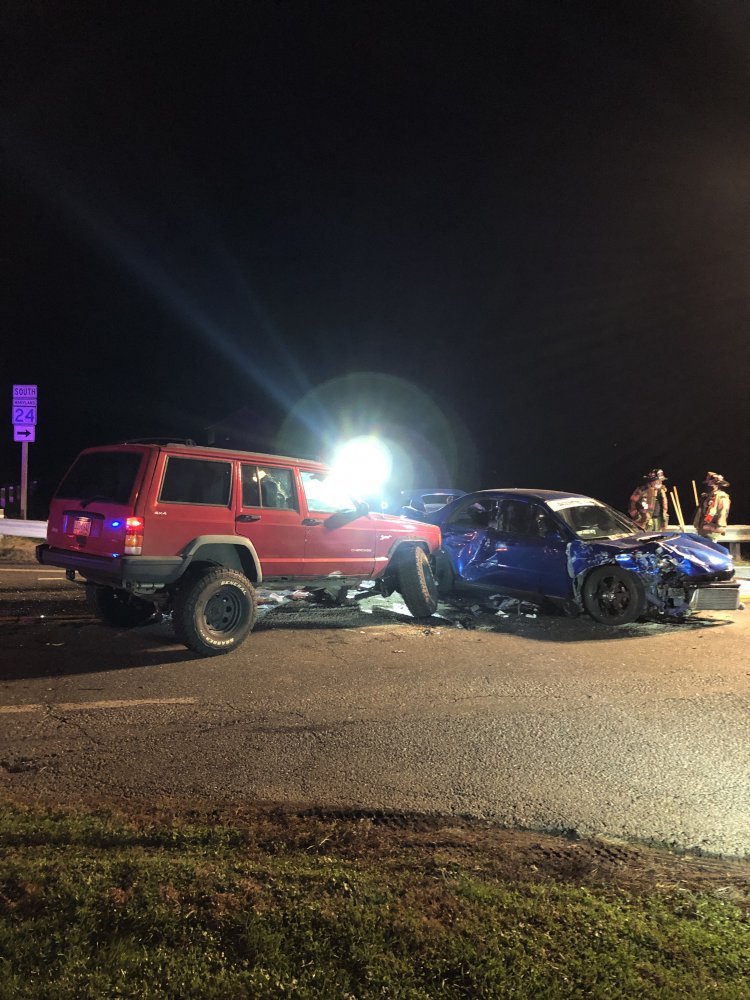

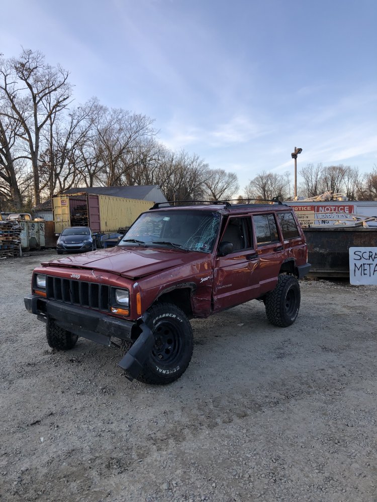

Amongst the Saturday night shenanigans my friends girlfriend wrecked his XJ on her way to work. She walked away with only bumps and bruises. The Jeep did it’s job and kept her safe. With only liability insurance and her admitting fault we had to go recover it from the towing company. Tuesday we rented a trailer from sunbelt and hauled it back to his house an hour away. Needless to say I think dale earned his keep this weekend.
Anyways here’s pics
Good job Dale.
Glad she's OK, but it looks like another XJ bouncer is born!

So somehow I missed responding to this. :lol: I wish the xj could be saved. My friend offered to give it to me. The hit was so violent it bent the unibody in and broke not only the motor mounts and block brackets but also bent the distributor shaft. We had an entire scheme to bring it back as my beater with all the spare shit I have laying around for an xj, but the unibody makes it almost impossible to save. I don’t think we can pull it out enough to mount the motor again :(
Bring it home. I have a solid chassis.

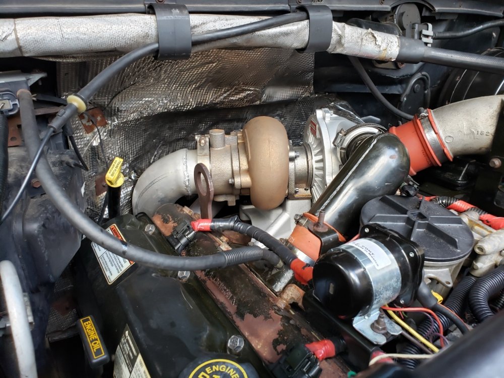

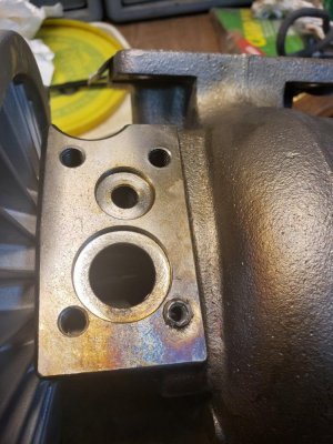

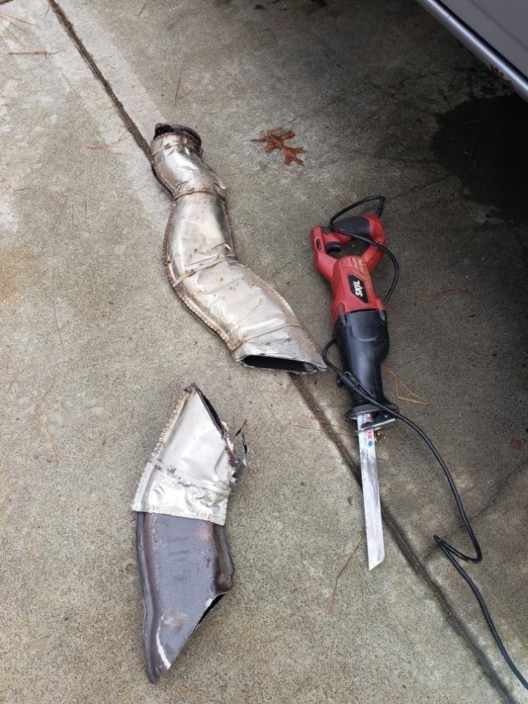

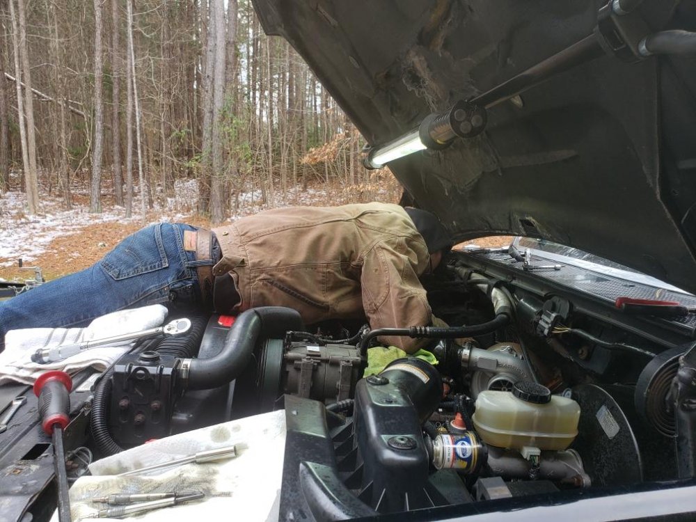

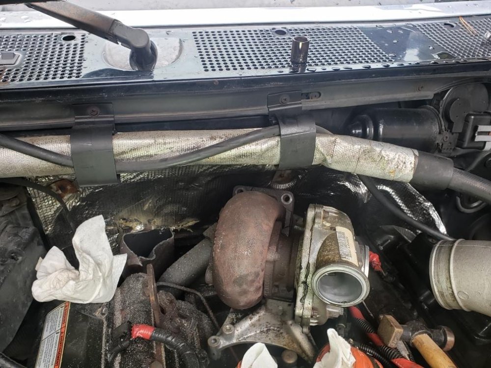

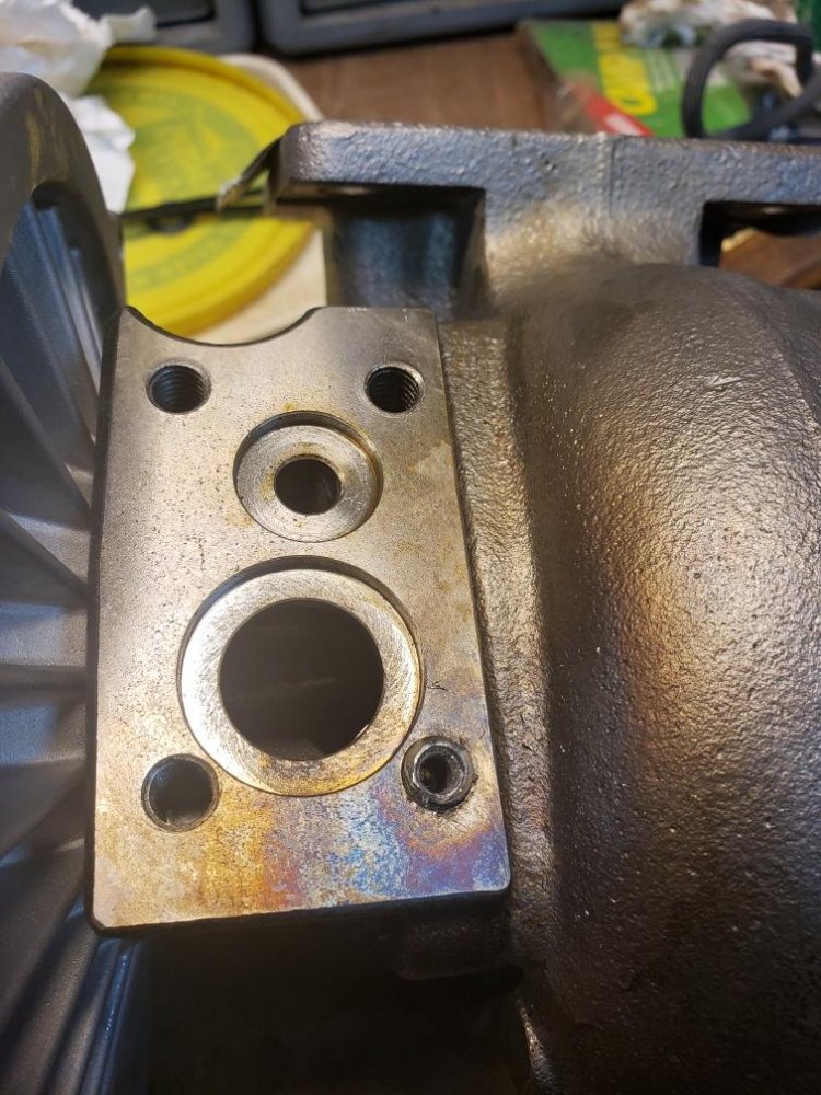

While I’ve been working in California since the new year, Dale got a new turbo! When I’m on the road I tend to order lots of parts to fill the void of being away from friends and family. Anyone who has had one of these trucks bone stock knows it’s a turd below 2000rpm. The turbo was high on my list of things to make not suck. Pops works for Advance and has the hook up for turbos. He talked to his rep at rotomaster and they were able to build a reman turbo to my specs. 1.0AR back housing, upgraded 360 degree thrust bearing, billet compressor wheel, and with the EBPV delete outlet and pedestal. It won’t pick up any power but it will broaden the power curve. Ended up getting it for a great price so I can’t complain.
This is where the great ended. First off, I will forever be grateful for my old man. This job SUCKED and I feel awful he tackled it without me there. Dad and I have done some big jobs together including multiple drivetrain swaps, engine rebuilds, axle swaps, you get the idea. According to him, swapping the turbo on an OBS 7.3 was THE worst project he has ever done on any vehicle. The amount of headache involved from both removing the old turbo and installing the new one is a new level of frustration. He swears I would have set the truck on fire if I had the displeasure of being there to do it myself. Seized and overtorqued bolts, broken stuff on the new turbo, the missing pipe plug that allowed it to puke 2 gallons of oil onto the driveway in about 10 seconds..... it’s a long list of shit. The good news it it’s installed and leak free now.

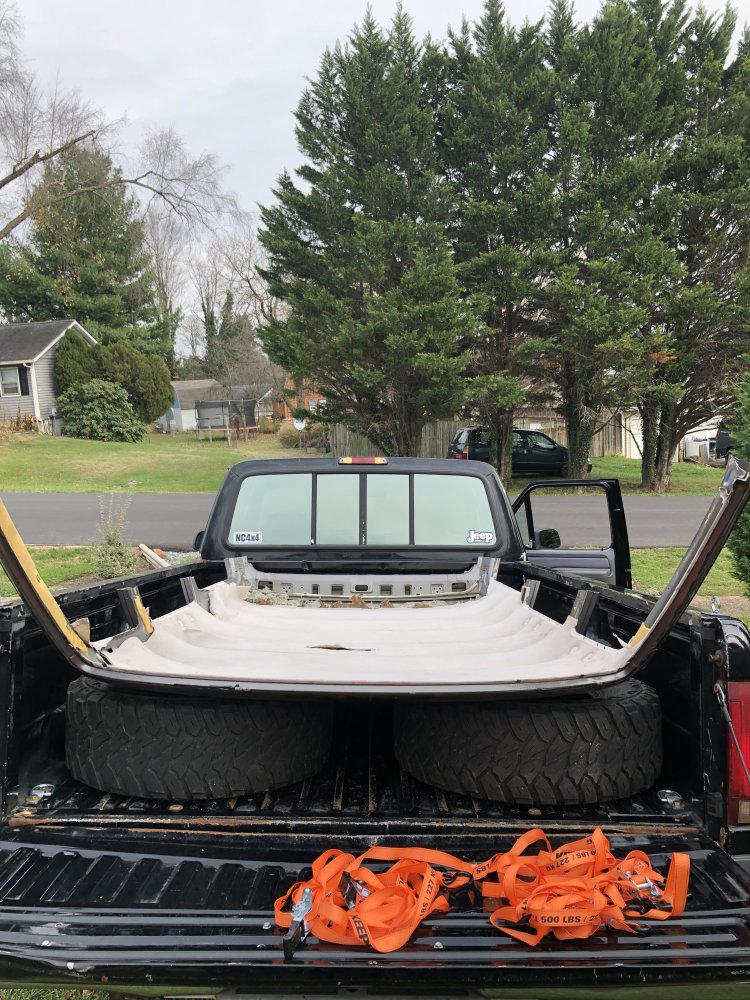

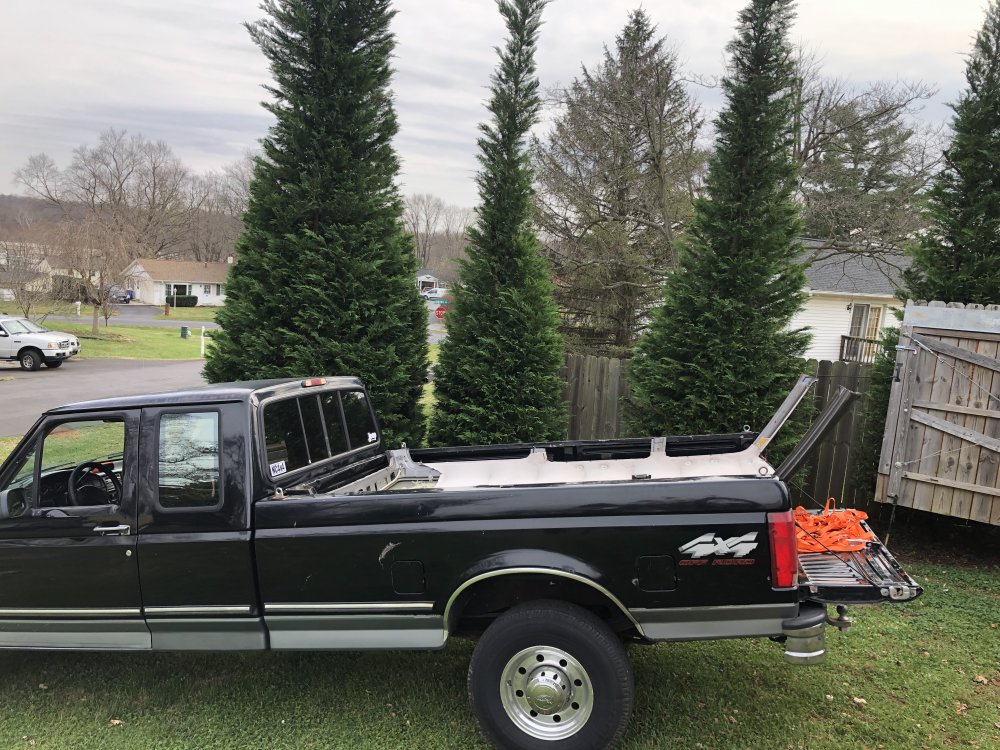

My grandpa level just went up twofold. Gave up on the rack idea and decided to just drag the adventure trailer out west with the bikes and rest of the gear in the bed. Now who wants to loan me an HVLP gun so I can spray some single stage black on it?
Bring a tarp with you to throw over the topper if you planon sleeping in it. Also consider throwing stuff on a pallet to keep it off of the floor and out of any water that leaks in.

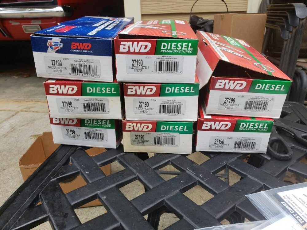

Dale shat an injector yesterday. $1500 later he has a brand new set! Runs much better but there is still air to bleed out. I wasn’t able to get enough highway time in to get all the air out of the system. The drive to Nashville on Monday should take care of that. And if anyone was wondering, laying on the core support where the hood latch stabs you in the nuts is not a comfortable position to work in.
Lucas, I just came across this thread - you're living the life! You've acquired knowledge that many only get after many more years of experience. Your dad has obviously been an incredible influence, but you're fearless to dive into things! You drove that across the country and back on basically the confidence you could fix it if it broke. And now headed west again. Pretty cool dude. Sub'd so can enjoy the journey!
Now that you have a Ford diesel, might as well invest in a truck creeper. It'll be money well spent.
The good news is I already have a platform to stand on and a step that attaches to the tire. I'm just a shrimp that can't reach the back cylinders :D I think the next tool investment will be a flamethrower so I can burn this fucker to the ground and buy a Cummins :flipoff2:
