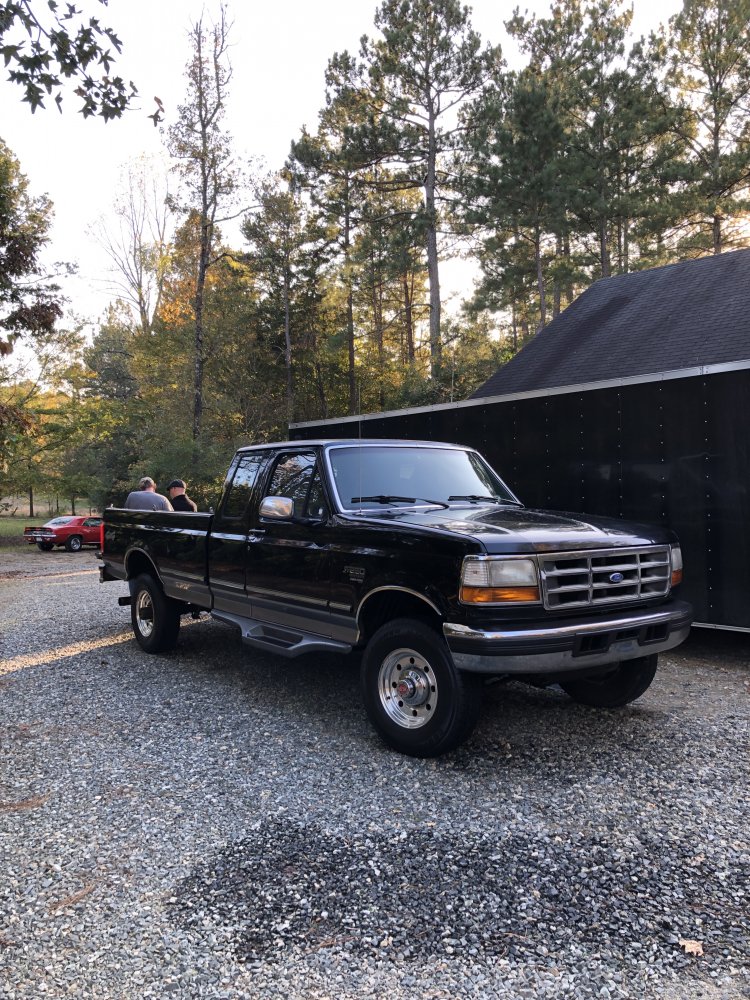

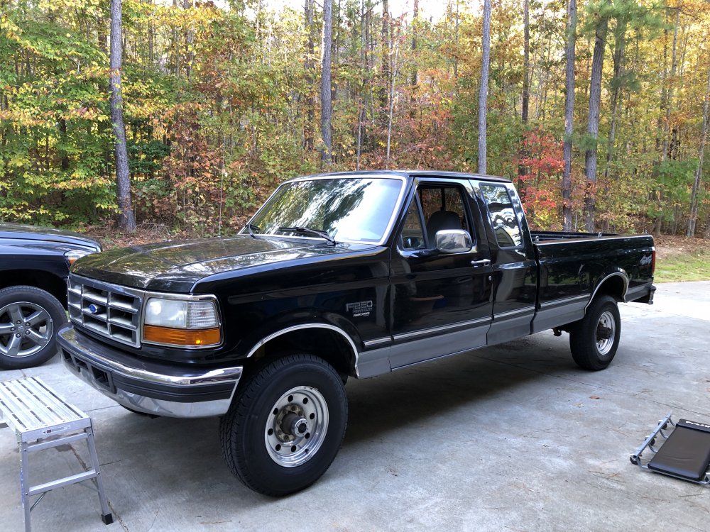

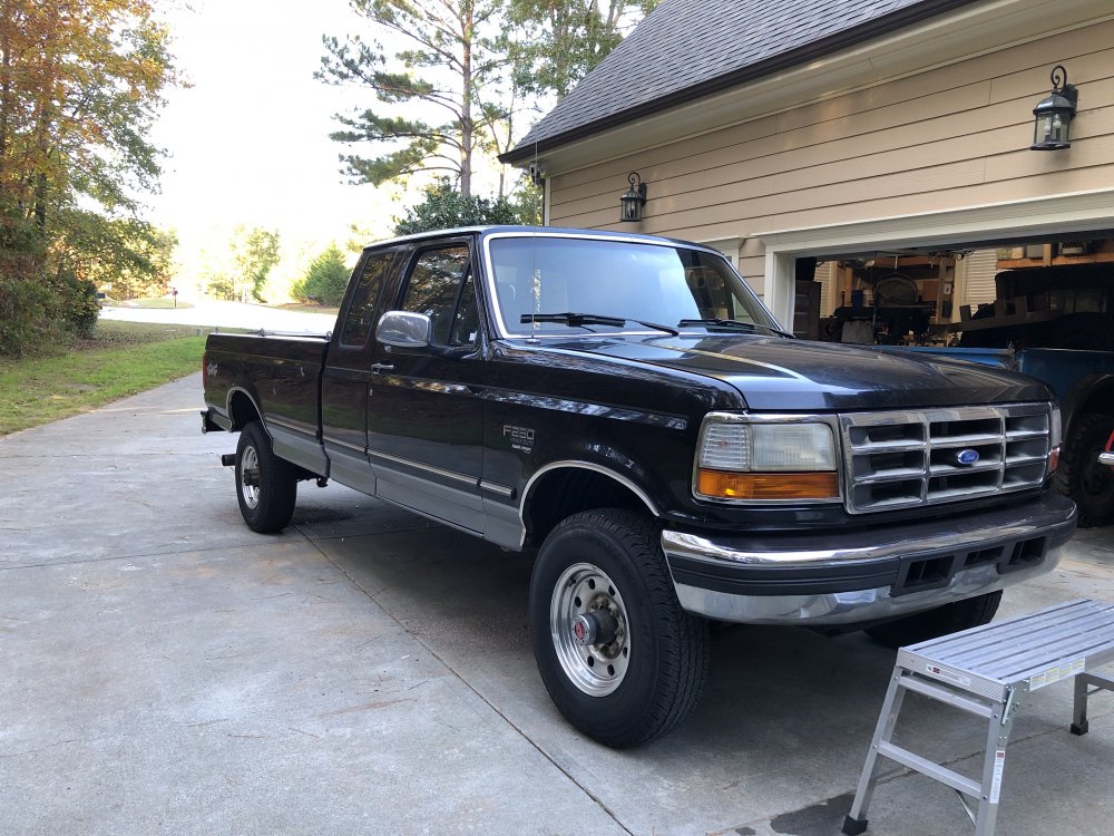

So here he is in all his glory. May I introduce to you Dale, the truck I REALLY shouldn’t have bought.
Dale is a ‘97 F250 HD with the 7.3 powerstroke and E4OD autotragic transmission. His original owner put all 379k miles on him before passing the torch onto my dumb ass. My friends named him because of the black and silver paint scheme from Earnhardt Sr’s cars, and the fact that the alliteration “Dale doused me in diesel” was pretty funny.

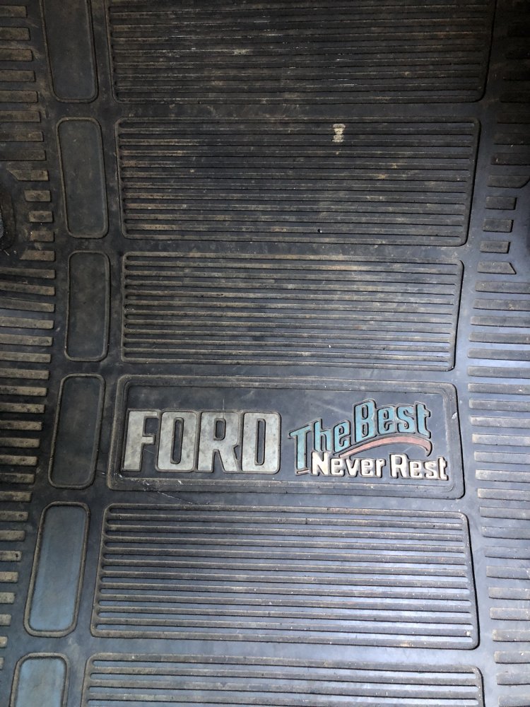

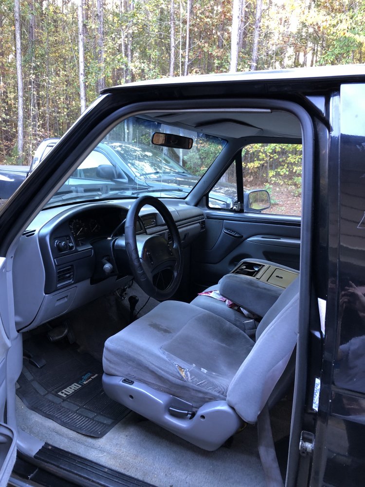

The floor mats are so cool to me. I love the old “the best never rest” Ford truck commercials. Lots of cleaning tomorrow and hopefully some reupholstering of the sun visors and maybe even the headliner.

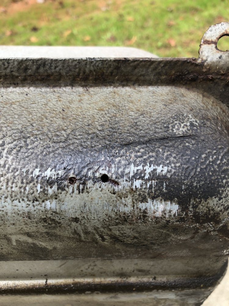

I had a fun discovery today. Pulled the rear tank out and much to my surprise the hole was not from rust. Some fuckwit before my ownership drilled two holes in the tank. My assumption is to drain it for whatever reason, maybe someone put gas in instead of diesel. Regardless, the old tank was spotless inside and out. New one is going in, but I’m not going to touch the front one for a while.
Onto installing the new tank and fixing the rear brake line.
