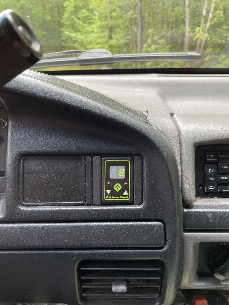

Big updates for Dale! After the compression test turned out ok I decided to order a tuner. I’m not big into lots of smoke but it would be nice to not have the truck hunt for a gear on the highway because it doesn’t make enough power to stay in overdrive at 70. 3.55 gear problems.
Anyways I ordered a PHP Hydra loaded with some tunes, nothing huge. A few mild tow tunes, high idle, and the 80hp daily driver tune. The stock size injectors in these trucks won’t flow enough fuel to make more than an extra 75-80hp. The benefit about that is they can’t squirt enough for the egts to get too hot to where it will melt down (unless you’re really doing something wrong). I’m undecided on where to mount a pyro gauge yet so I haven’t ordered one. Never been a fan of the pillar gauges or mounting it on the steering column. Suggestions welcome on that.
A friend of mine on Instagram designed and 3D printed a really nice mount for the hydra controller that goes right next to the idiot light block in the dash. The hydra looks like it was meant to be there.

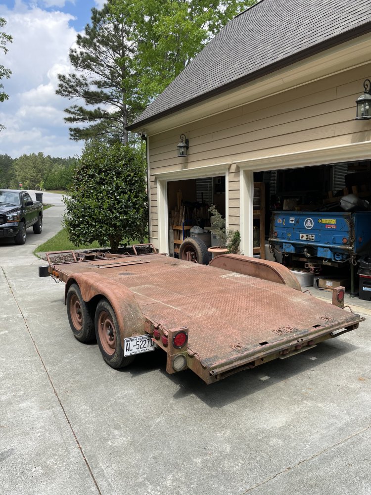

As an unrelated note, I bought a car trailer from my grandfather a few months back when he was in a bind. It’s old and beat up but just the right size to haul an xj. The rest of this week will be spent fixing it up, deleting the surge brake coupler, and painting it. My hope is to head out to see @sammi_davis this weekend and finally get my XJ hauled home so I can finish swapping the 6 speed. Anyways here’s some pics:
