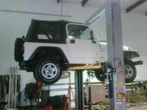

^is that gonna be the ride height? Little top heavy I'd think. :)
sye
Wonted to keep the fender's for now so that's what he had to have to run 37 38.

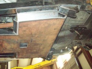

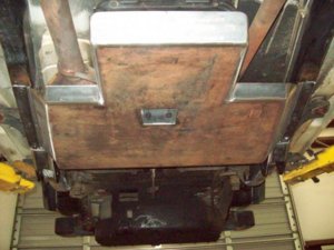

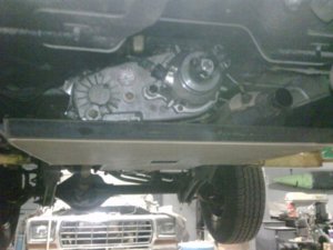

Got the sye in and belly pan done.
belly pan
belly pan

More pics of the Ford, please.

sounds good chris, btw the belly pan looks great and thks again for repairing transfer case gasket also...when u installed sye .
belly pan
Any more pics or details on the custom belly pan? Looks good.

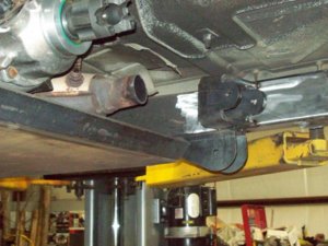

Better pics of the belly pan also has frame mount tacked up for the four link

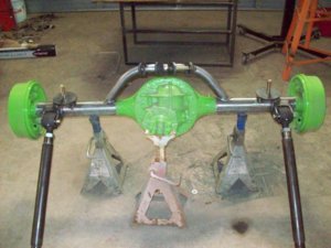

axels and lower mounts
got everything tacked on the rear end and lower arms mayde

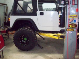

ride height
this should be close to ride height
