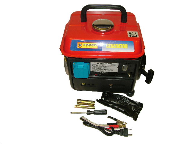

Another question is how much do you think you will need this? How often will you use it? And are you planning to run everything in the house or just a few things to get threw a storm etc? I wired my house for generator with a manual transfer switch in house. I then have a 6000 watt gas generator in shop that we use as back up for house I can run everything except a/c unit. But when we do use we make sure we don't use things that would draw a lot of power. So just throwing it out there that you may not need a huge genny unless you plan to use it all the time.
Don't get me wrong if/when I can find a deal on a nice automatic switching unit I would live to get it. But my little genny has gotten us threw many power outages and the wife can even watch directv :)
