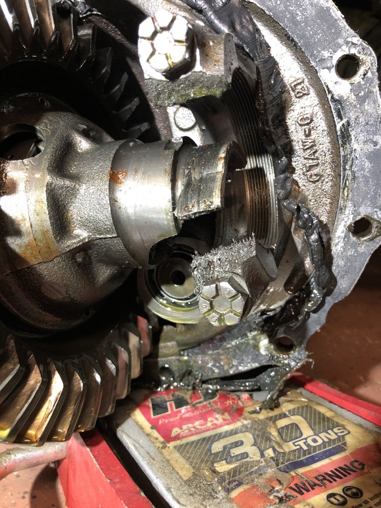

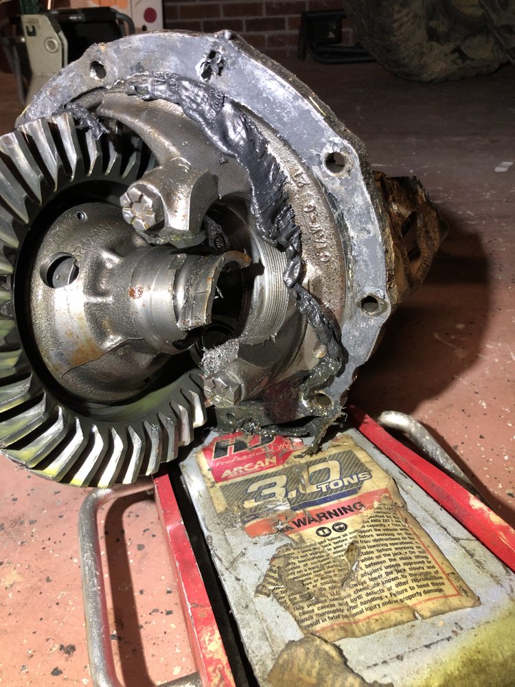

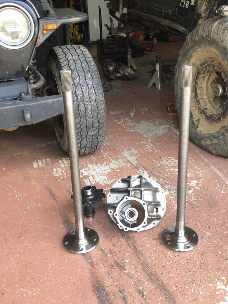

Well I went to AOP several weeks ago and broke a rear shaft 20 minutes into the first trail, wasn’t even beating on it. I found a place called Hudlow Axle & 4x4 40 minutes away in GA and went to grab a shaft. I got 2 cause the drivers side was also twisted when we pulled it out.
$150 later and lots of work I was back on the trail only to repeat the same. Passenger side axle let go instantly. I had 1541H shafts and these were all stock so they didn’t stand a chance. I called it a weekend then and rode passenger, then drive and rolled @cufor98 Jeep for him. Good times.

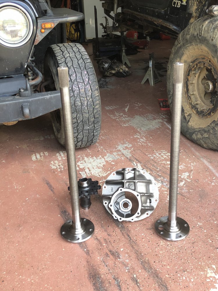

Fast forward to last week. I finally got around to fixing it and since I bought so much dang stuff recently I decided to go back with the 31 spline 1541H shafts cause I was too poor for the 35 spline and the spool I needed. ECGS was kind enough time give me the ol’ NC4x4 discount and all. But when they arrived they were 35 spline. I called and they said “our mistake, just keep them and we will change your paperwork and you get a 10 year warranty” freakin awesome right?
But then I needed the spool to go with it so they again hooked me up with an amazing price.
So then, like I should have done before hand, I take the rear apart only to find my 3rd member was trashed and it blew the caps out the back. So, the wife is really happy at this point cause I’m already $500 into this repair. I debate selling everything cause this is a stupid hobby. I mean really, it’d be cheaper to do drugs, or maybe even burn money for entertainment.
But, I dig a little deeper and pony up for ANOTHER call to ECGS and get a Yukon Nodular 3rd to go with my Yukon shafts and spool.
THIS IS A STUPID HOBBY.
I’ll be heading over to Rev Limit Fab Sunday to the assemble the 3rd, and press the new axle bearing on.

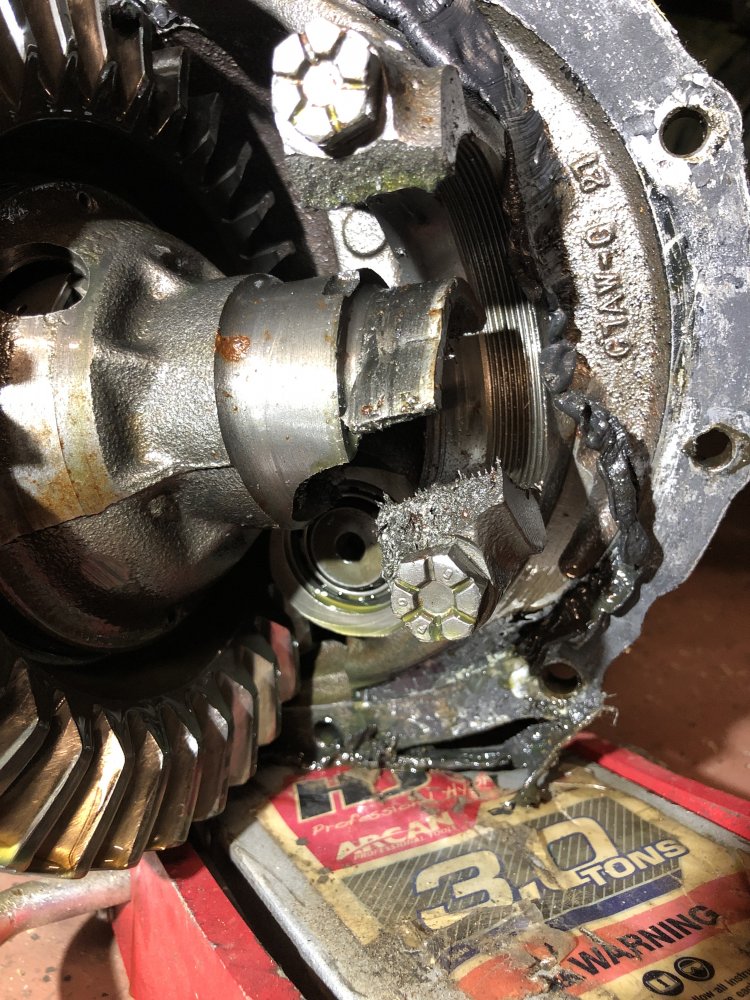

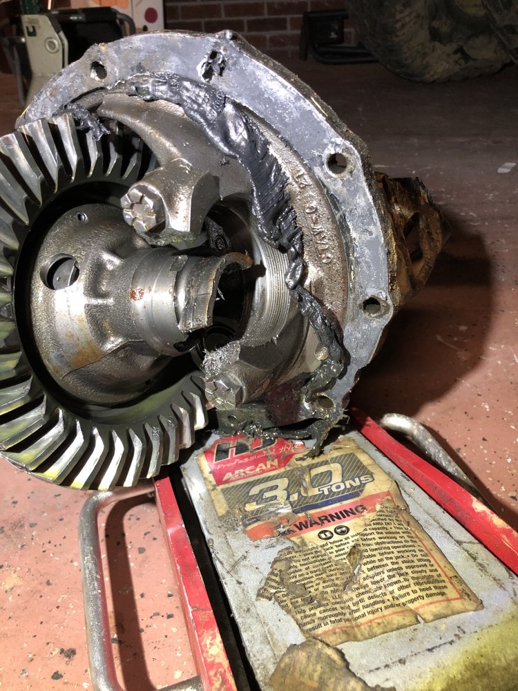

View attachment 321175 View attachment 321176 View attachment 321177

Honestly both shafts were a fluke, I've seen him absolutely be mean to that thing and it hold together. Pretty sure most of the failures were fatigue related.

They likely broken due to the destroyed 3rd. Or alteast the 2nd one did.
