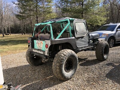

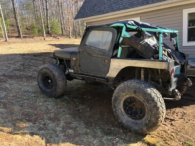

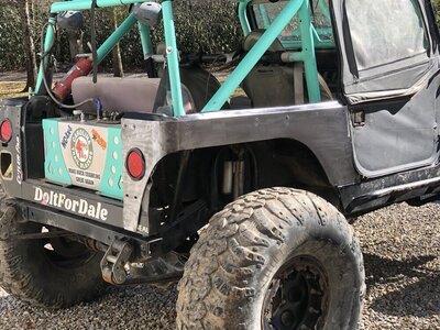

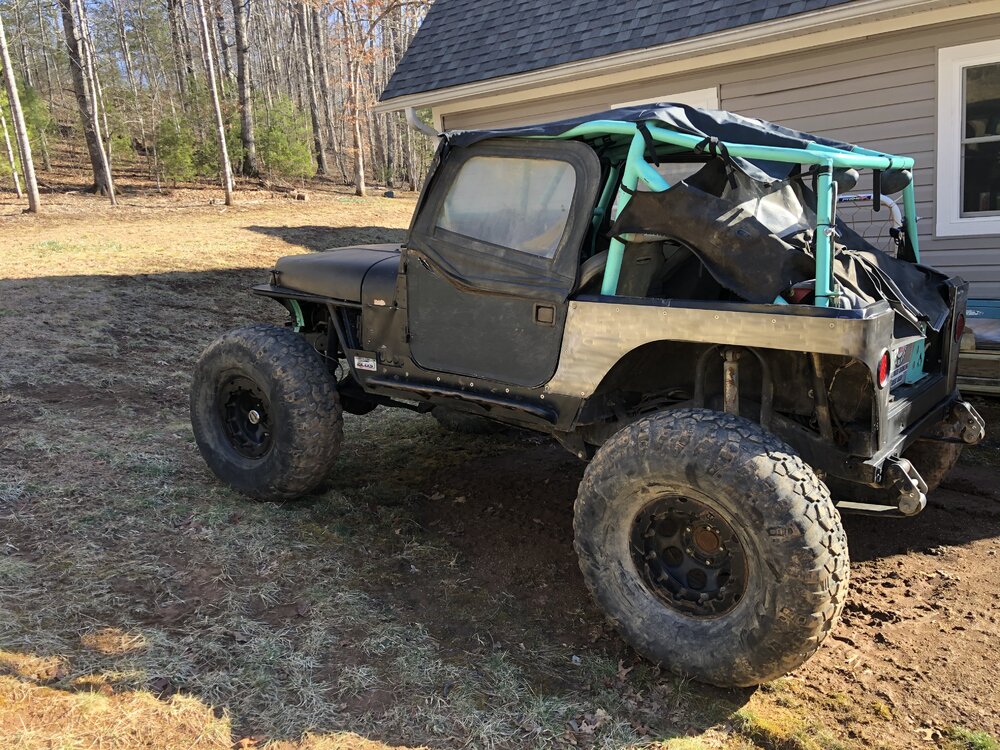

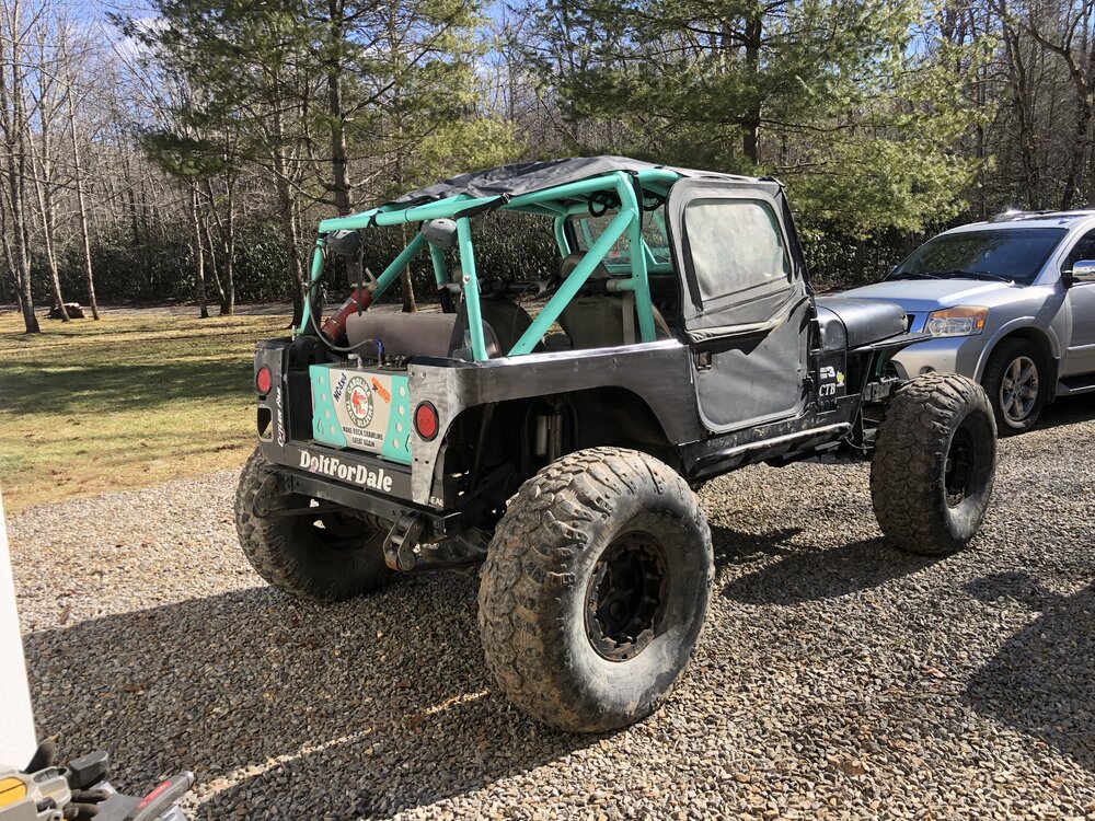

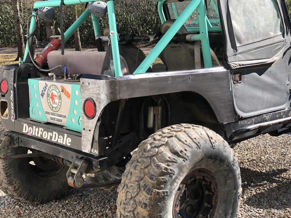

Thanks to a full day of work from @adamk this thing is back together and sitting on it’s on weight and level. It now runs XJ main leaf springs up front with some bastard mix of springs. XJ springs are super common and easy to find so it just made sense.
I have some minor things to button up and it will be posted on market place for $6500 OBO in a couple days. If anyone following this would be interested I’ll make you an NC4x4 deal. I have a touch over $7500 in this Jeep. If you’d like to have it, PM me and let’s talk. I don’t think it will last long once listed based on interest I’ve had here and there just mentioning it, but I could be wrong.
