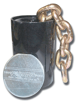

And some anchor pots:

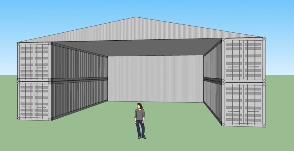

I am planning to build something like this at my land. Shop space of 30x40 with containers on each side for equipment/parts storage. My main reason for doing this is I can put the containers in place and have rodent proof/lockable storage instantly for skid steer, truck parts, furniture, etc while we build our house. When the house is done I will work on the shop. It will have a big I-beam in the center for hoisting engines and stuff (I will put a post directly under the beam so the containers are not supporting vertical load).
I will face the two upper containers backwards, that way only the bottom ones are visible from the front. I have actually thought of facing all 4 backwards so from the front of the shop you don't even know it is made with containers, I may still do it that way I'm not sure. I still have to burn a brush pile, finish leveling the spot, and build a retaining wall before I can bring containers in.
