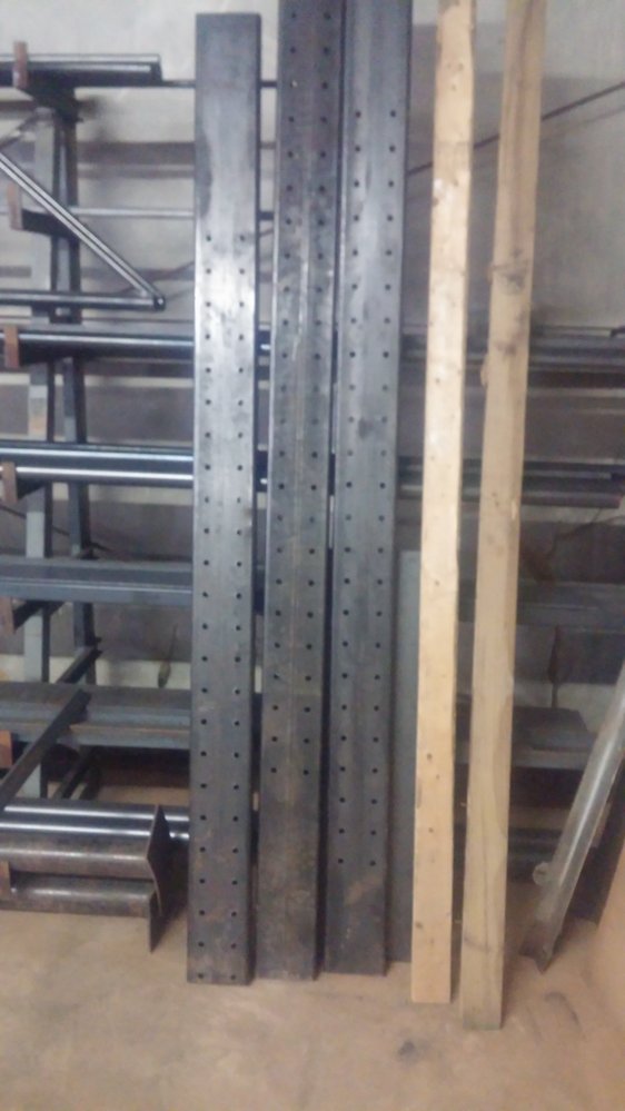

These are all through drilled 9/16 with a 1/4 pilot on a drill press. Material was 1/8 wall tube. Did not sharpen the whole time or use oil.
