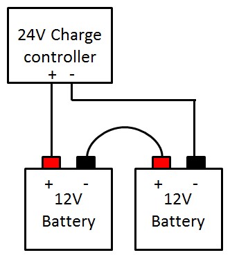

Just wire it like this. When you start with 24v it takes twice as long to drain it down to 12v.
