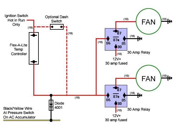

I kept going thru relays and melting wire for my 16” Spal fan, so I went with this.

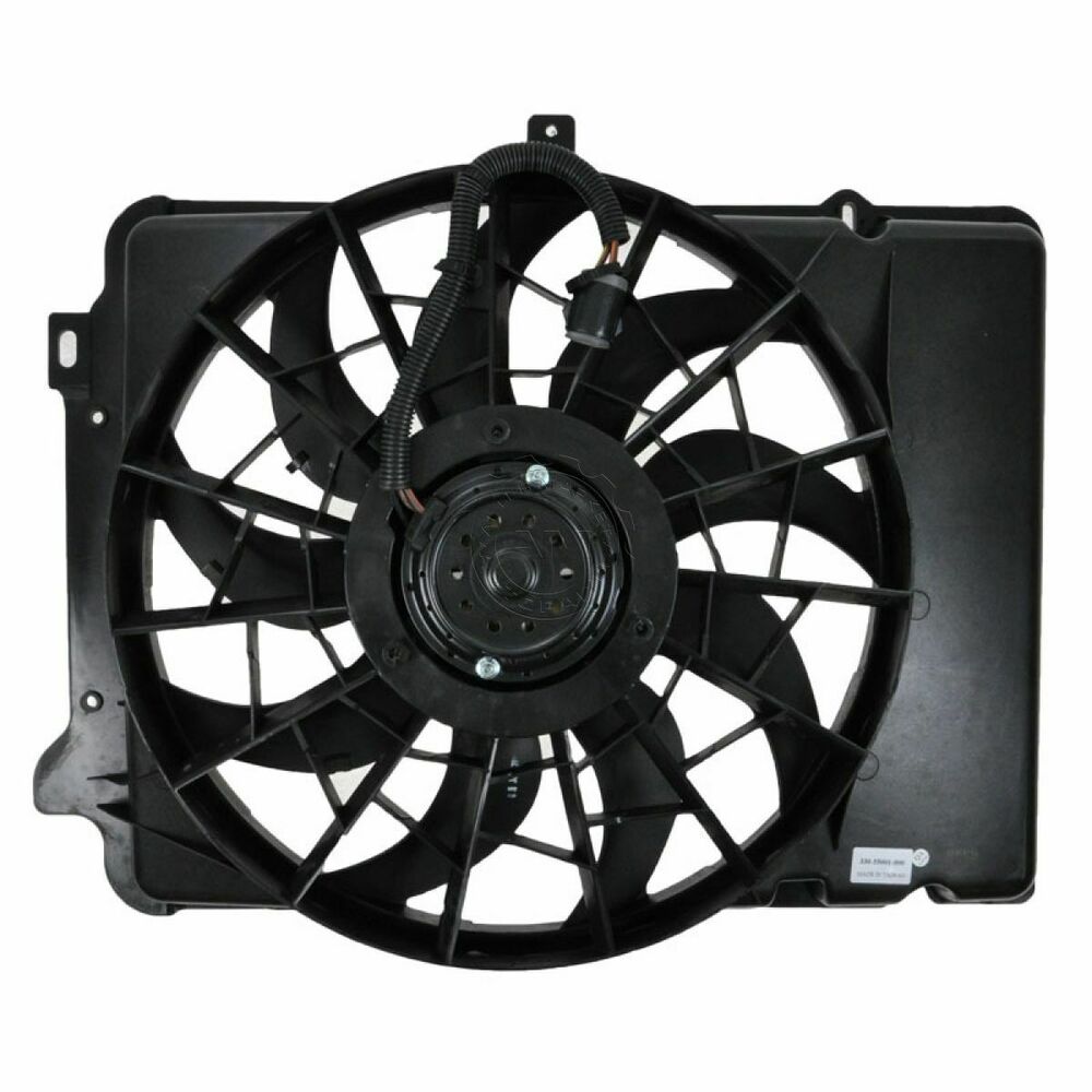

Here's a pic of a Taurus fan. Is this what you have 2 of on an XJ radiator?
Well so I thought, older style maybe? Mine look identical but no shrouds but I suppose now maybe they're not lol. They're high powered fans though, very thick wiring and keeps motor at 180 with no shrouds in place
I just looked up part number next to ford emblem and they are Taurus fans
I don’t remember the full schematic from when I did this.
Small orange and blue wire are the lo/high speed wires that are grounded based on preset temps by the gauge.
Medium orange is the 12v from ignition relay.
It took 3 relays to make it work properly, wouldn’t do what we wanted with 2 relays.
<180° no fan
>180<200 low fan
>200 hi fan.
IIRC, one relay triggers the ST85 solenoid for High Speed.
One relay is for Low speed fan
One relay shuts off low speed when high speed it triggered.
Bc it’s all done thru the ground on the gauge trigger side, it needed the extra relay.
4th relay is a spare. Plus fuses for the relays and the 100a breaker for the load side.
The trigger wires are crimped, the load side is all solder with wire large enough to handle the current.
All mounted in front of radiator behind grill so the relays stay cooler and avoid heat soak.
