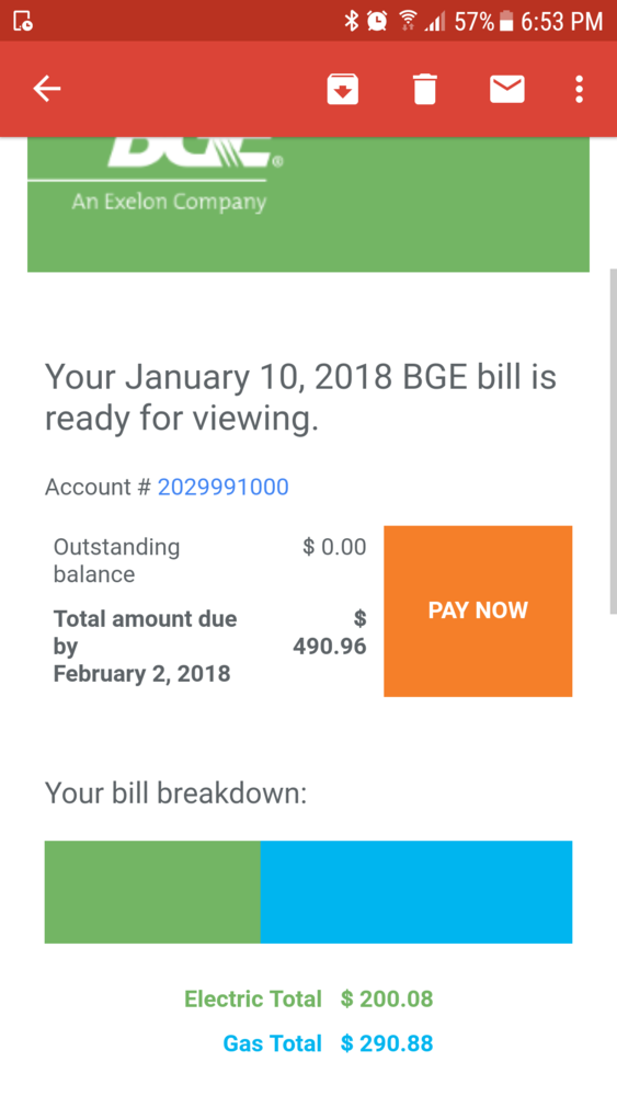

Also youch, wife just sent me this.
$100 more than normal.
Furnace was running nonstop for about 2 weeks.
