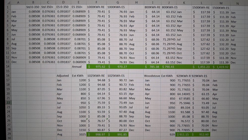

You missed that the all electric rate for energy star is 6.89c/kwh after 350 in the winter.
There we go! I apparently didn't have the patience to read that far.
So crunching some quick numbers I might save up to $32/year, or spend an additional $5/year.
Straight 1000KWh/month ES saves $5/year
Straight 800KWh/month ES adds $5/year
Straight 1500KWh/month ES saves $31/year
Heat/Cool needs estimate ES saves $7/year
Factoring in woodstove ES adds $1/year
Boring spreadsheet screenshot below. These numbers are completely speculative based on 1 warm September that averaged 34KWh per day and my own BS-timate of what the monthly KWh needs will be throughout the year. I'm sure there are better calculators, but I think it will still work out about the same. Considering the ~$500 cost of getting the house Energy Star certified (and that's assuming it actually is...), it would take anywhere from never to 15 years to pay off.
