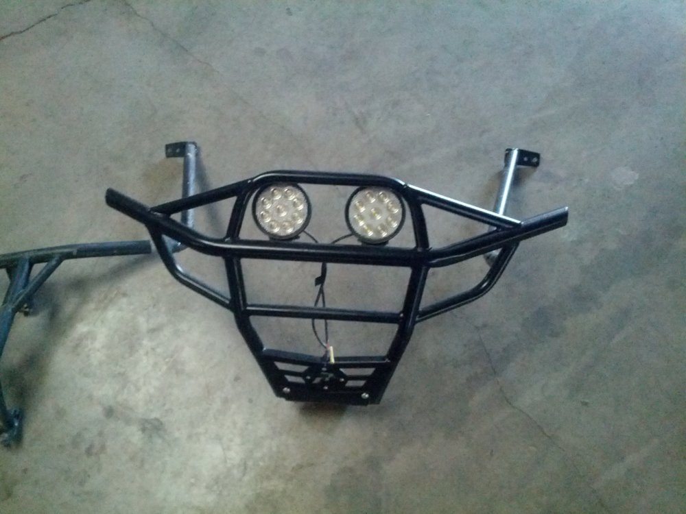

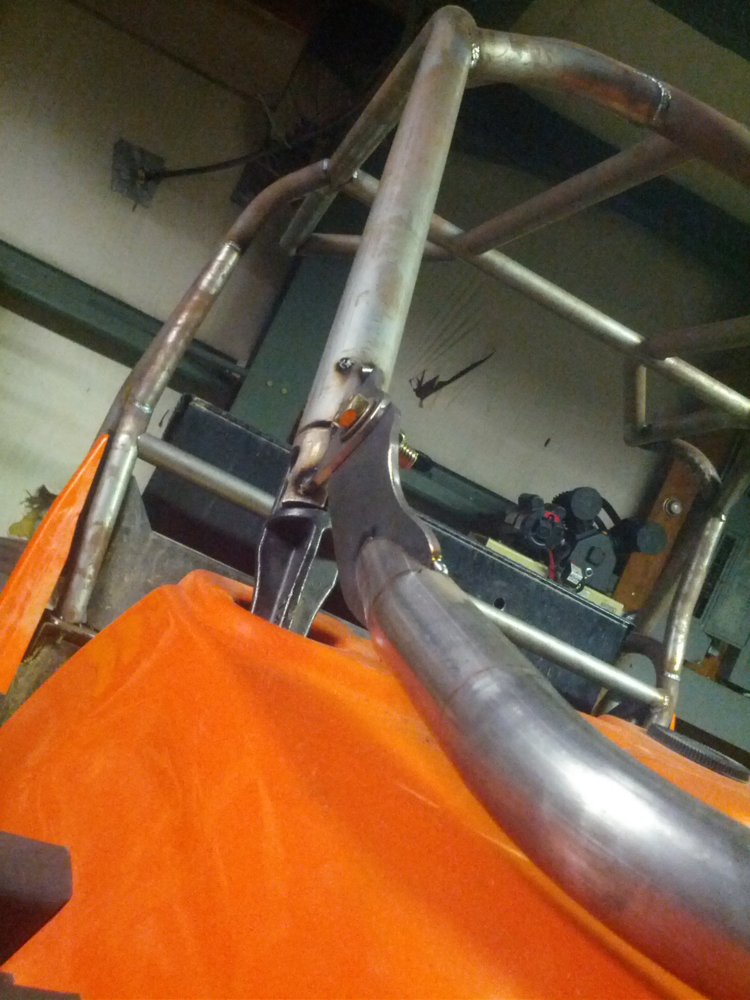

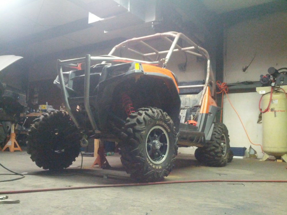

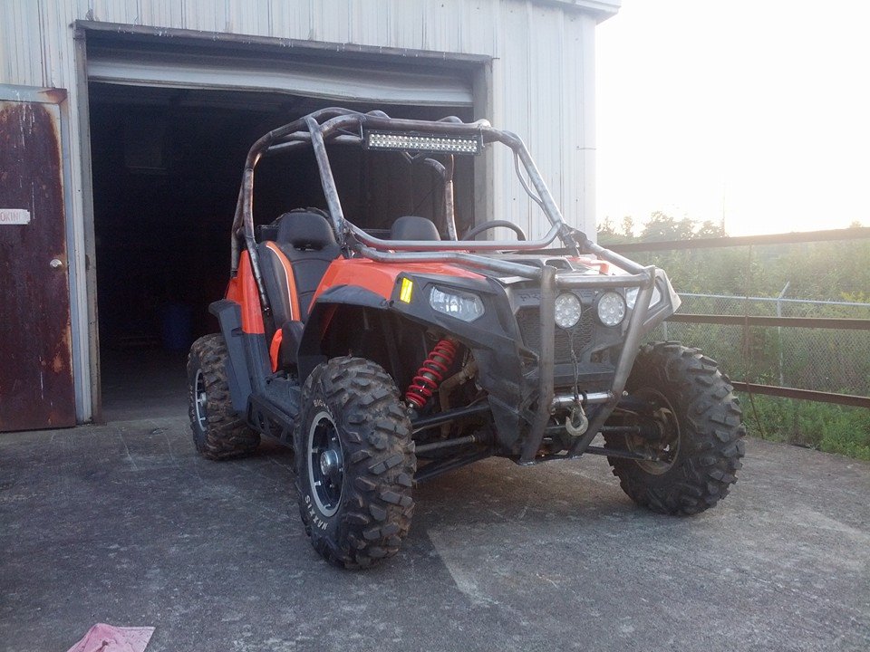

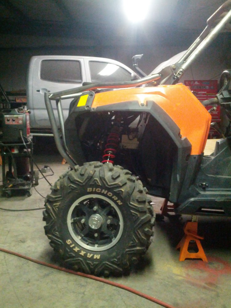

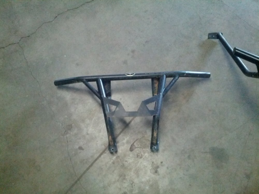

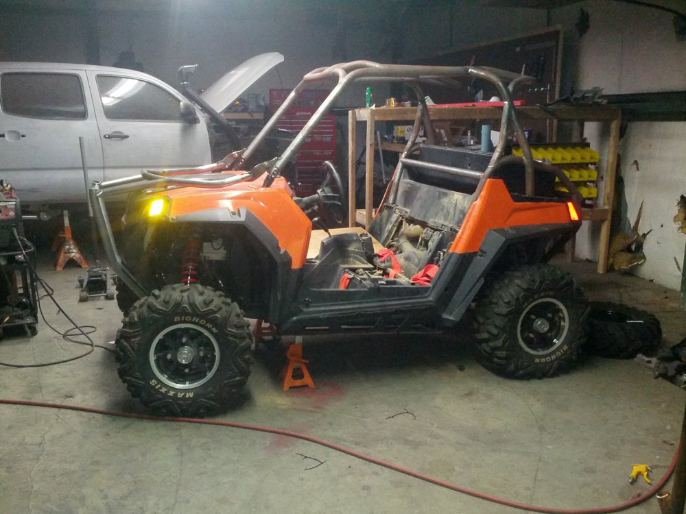

Not bashing, just saying it's a lot of weight. I'll gladly explain, no harm no foul.
Its not just the weight but the chain of effects it causes so here we go. UTVs struggle so much with weight and making the shitty belts last. When you add weight no matter how much it effects the clutching, load and grip on the belt causing loss of power, strain and heat on the belt which cuts it's life down. It effects axles and diffs which are nearly junk on all the UTVs and causes more problems. These issues are nothing like a jeep or truck but we deal with the sport market.
When Snappy called me he asked what he should look for when buying a UTV. The answer to that was check the balljoints, wheel bearings and if possible the belt because their life expectancy sucks.
So like my first words were, I like it, I like the quailty, I think if it was built with .083 fillers and .095 mains it would be more than strong enough and one of the best 800 cages I've seen. Weight just kills these things and I struggle with it on mine as well.
I hope you don't take offense to my comments. I meant no disrespect even if it came across that way.
Sorry to throw this off track, my fault, post some more pictures up.
