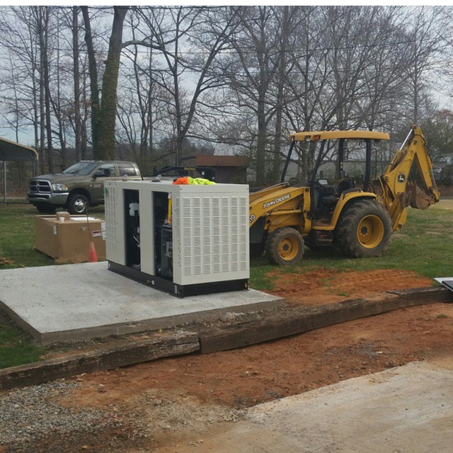

22kw is a pretty typical for size for my area. I've got a 25kw sitting on site at a new home I'm working on. Here's a 150 I set earlier this year
ai36.photobucket.com_albums_e15_ROCKWELLEDTOYOTA_Screenshot_2067ce1af91f4b42a6c98e47a434fffc7d.jpg
They don't have to have a gas meter, they can be LP or NG. That 150 is LP. I set an 8kw 2 weeks ago, it was NG and one that I fired up today was LP.
ALL GENERAC
The 150kw has v-10 engine in it. It got hit by lightning and I have to swap out the control board on Friday
Gas line is sized for the load at the furthest point. (I.e. if a rooftop is 700ft from a meter you size all the piping for every appliance on the 700ft chart). Afterthought right by the meter is cheating but for residential it shouldn't matter much as long as delivery pressure isn't in w.c.
Actually you want 6'-8' of pipe between the regulator and the gen inlet. Less can induce some weird oscillations under the perfect circumstances. More is fine, so long as the pipe is sized right.
Lotso of folks screw up generator piping because it's a (relatively) extremely high volume and a low pressure. So often times inexperienced MCs will undersize the pipe.
The protector/QT 150 line uses the 6.8 v10 over spun...where as the industrial 150 uses a 9.0 v8.
