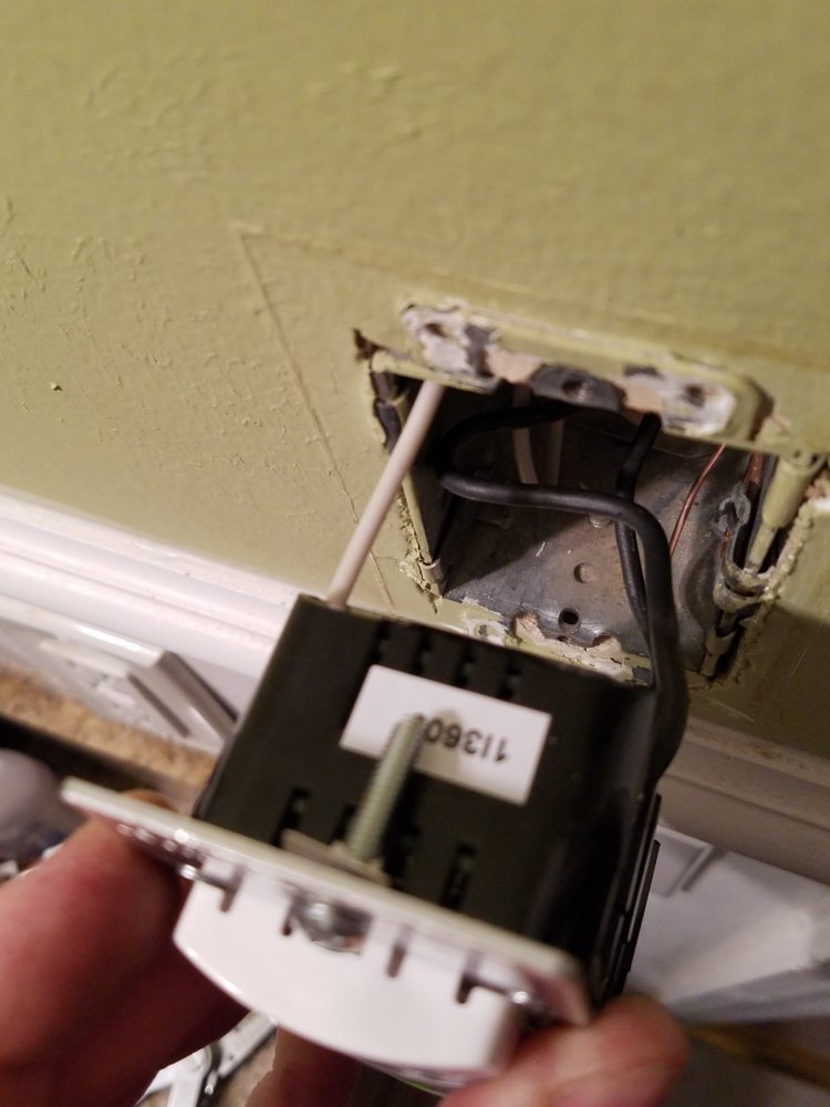

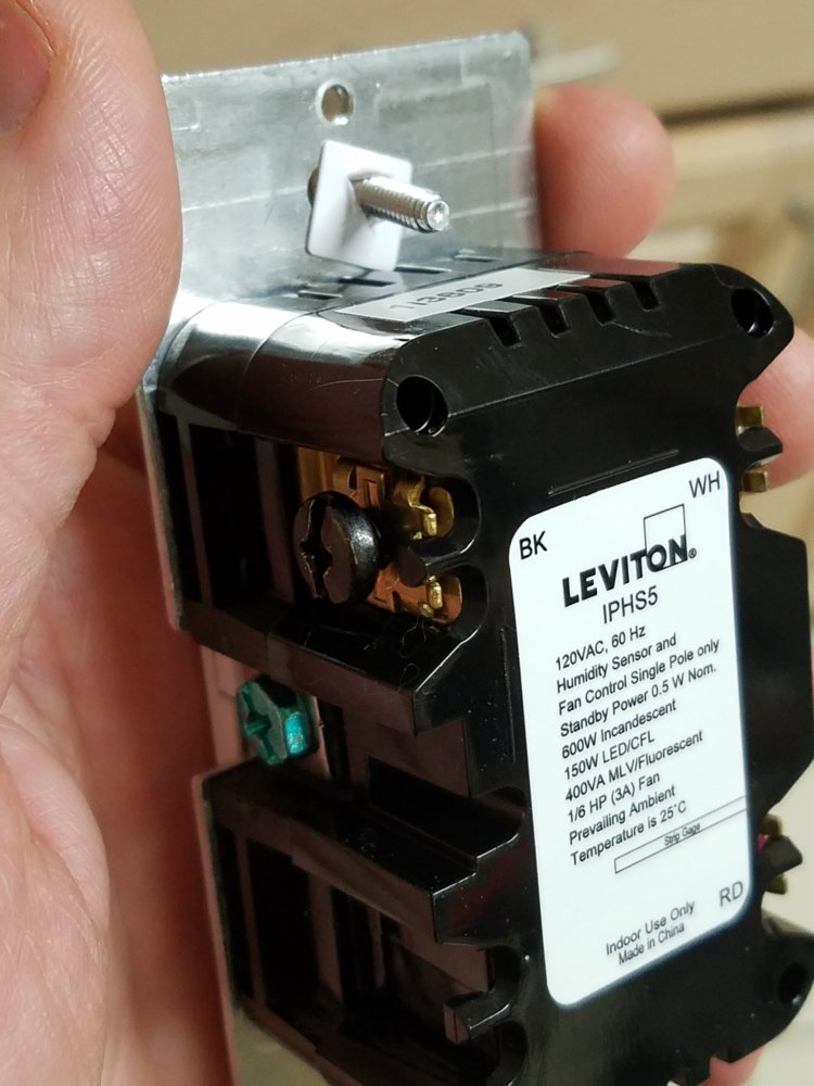

Thought of this thread. Yesterday I replaced the vent fan switch in our bathroom with a fancy one w/ a hunidistat and automatic on/off built in.
The switch receptacle has a HUGE back on it - see first pic. Note the lugs are inset to the plastic housing - but just barely.
This one had screws but it did have the push-in posts under them to slip in from behind if desired.
When I went to install it - damned if it wasn't a tight fit. Too tight really. It happened to be an old-work box, one of the old metal ones w/ the long metal braces you clip in from the sides. Of course the PO had done the right thing and grounded the box, which I tied the fixture into also - and when I went to slide it in, the fixture literally filled the whole space (see 2nd pic). seeing how tight it'd be I wrapped the fixture w/ electrical tape but it was so tight the tape even rubbed off as I pushed it in... leaving the hot terminal < 2mm from the grounded box.
I just didn't feel comfy with this, so today I pulled the whole box out, widened the hole and put in a modern plastic old-work box, just so there'd be more room.
Oh and lol in the process of doing that I found there's some random old low-voltage wire ended just a-hangin' inside the wall there... who knows wtf that went to. 20170114_213411[1].jpg 20170114_221616[1].jpg
Oh, something else that was odd about that fixture - instead of having the 2 hot wires on the same side, it was set w/ one side as hot in (on top) and ground in the middle (can see in the pic), other side was neutral on top, hot out on bottom.
