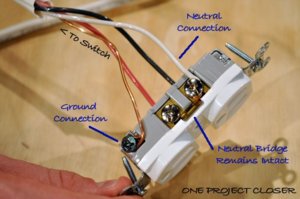

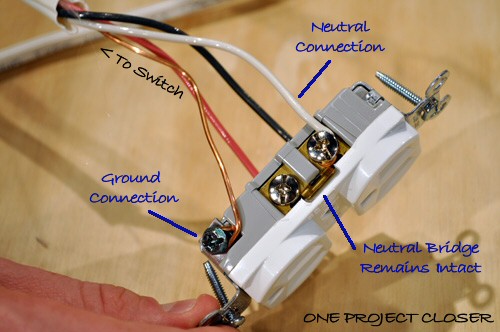

Ah. So I assumed the screw threaded into the plate. Are you saying it's threaded through the plate and into plastic behind it? I can see that being a problem.
No, the screws came out of the box with the little brass plate attached to them. But the two terminals were no longer attached to one another.
Here's the best pic I could find of it online. See the little tab between the two screws that they're calling the neutral bridge? That's all that connects the metal the screws are in. But the screws are threaded into the little pieces of metal. Also note the piss poor hook and the white insulation being under the screw...smdh.
