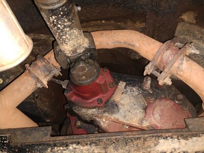

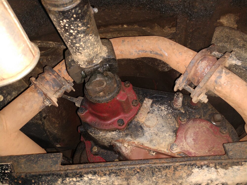

AMC V-8s have some tricky twist to connect the exhaust manifolds; least the driver side does. If you got headers, that's easier. And getting a pipe between the transfer case & frame rail, O Lord! I scrapped my dual pipes, & had my guy build a new single exhaust using the driver side like the factory did. No cat on mine. Due to my skid plate, I had the muffler man do a U, or horseshoe, over the rear tranny output, for the cross over pipe. His concoction of Bell connectors, makes it easy to take off & on!
